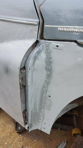

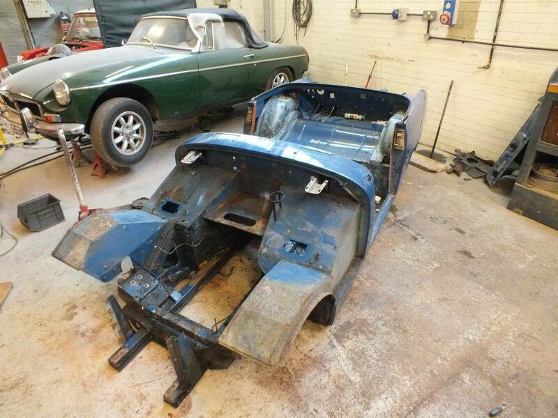

Top work going on right here it's very satisfying when it all lines up  and shuts cleanly though.
Reminds me of my battle last year I thought I had my hinge panel Bob on but I still needed to add shims behind the hinges and give the door itself a good beating to get it to sit about right.
20210215_155150.thumb.jpg.9505d012ede953ef59353d18e345b07f-1.jpg.e5cb44d72508061ef419b1e1c4c629f2.jpg
20210218_171727.thumb.jpg.1d2cb5dd08af43797465960957657970-1.jpg.82c77752446e0ec9b26b4ecd98d99276.jpg
20210403_140819.thumb.jpg.d66c006f48d63f5e55762fb9a9c0848d-1.jpg.d8a801a1c9af15501a5d674add09b72c.jpg
I had a complete ballache with the Spitfire - even though I braced it all - it had been all on the wonk from a previous 'restoration' so I ended up all over the place re-aligning it. Most soul destroying bit of the rebuild if I'm honest...... finding newspaper inner sills and chickenwire type floor patches was a honeymoon in comparison!

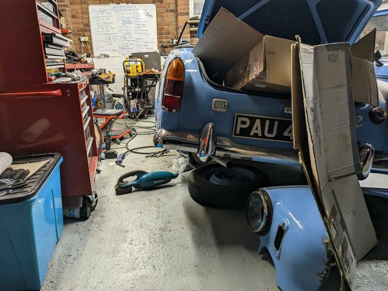

The bolt on wing I think I'll do a quick repair on the back section. Apart from it's not a structural part, the front part under the bumper is very thin and crispy. You can't get repair pieces for there and I don't want to fabricate a piece as it's quite a complex curve.
Instead when it comes to proper paint, I'll source a replacement wing. Second hand seems to be around the £200 price point. While not huge amounts, I'm trying to keep a lid on spending. The wing, apart from the rotten rear section, is currently presentable if I'm careful on the crispy front.
Fill the tank full of water and mig it up, it won't blow up.
It's more that I don't want to be making small holes on the tank into massive ones with my torch! It's quite heavily pitted and likely thin in places on top. Strong enough to keep fuel in but thin enough that it'll likely just end up with even more holes.
Time to get a tig torch and some brazing rods for the Pearl 😂
