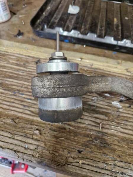

Today I've been tackling the front radius arms on the Beemer. They have a big bush at the front of the car and both mine have very obvious cracks in the bushes which Mr MoT will see and fail.
I was quite pleased with my slitting saw grinder action, surgically removing the nut after the BJ destroyed two Torx bits. Not sure I could repeat that if I tried.
Getting the bush out was predictably a bastard. Big cheater tube over the hydraulic press lever and it popped and chuffed its way out of the arm.
Unfortunately fitting it's replacement proved impossible. The press simply won't shift it, I am wondering if there is something broken inside because even though I'd tightened the valve with an adjustable spanner, it's no longer moving the arbour bit - I can hear the fluid 'hissing' so it's failed inside somewhere OR there's a pressure relief valve inside it. You can see its pressed in but still has about an inch to go which I just can't shift.
Had a go with the bench vice too but no dice. I could try heating it up but I think I'm calling time on this procedure so I've bitten the bullet and bought 2 new arms (£150). That's in addition to 2 bearings, a TRE and a rearward arm so the total spend on the front suspension is now up to £310. Bastarding thing.
Like all good* motor factors, GSF is shut this afternoon and tomorrow so it'll be out of action until Monday at the earliest.
Sometimes you're the fuckee, sometimes you're the fucker.

Probably a bit late now but when I was messing around with these bushes a heat gun made a good bit of difference, you can't use a blow torch on the ally but a hot air gun was enough to get things moving.
Link to comment
Share on other sites
I did think about this but then I decided the ball joints on the other end weren't that great so it was better to replace the whole arm. I mean they were fine, no play to speak of, but they weren't nice and stiff like newer ones so chances are they'd be coming off again anyway.
It's annoying because the motor factors is shut today, otherwise I could have got it fitted today.
I do hope to not be fucking about with the front suspension again any time soon.

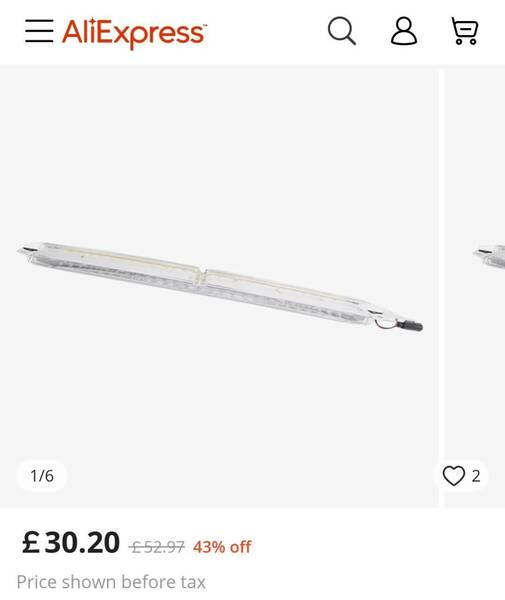

BMW news: Centre rear brake light borked, so I've investigated replacements and found an Ali Express LED unit for £40 posted.
In other 'good' news I've only just learned that the 5 Series Touring has an openable tailgate window, eg you don't have to open the whole tailgate.
In entirely predictable news, I just went outside to try it and it doesn't work.
I strongly suspect that in order to get at the brake light, I'll need to get the window bit open. There is a vid on the Tube for it which involves wrenching the inner trim off uncomfortably.
Tl;dr: More fun and games coming up to keep the needy Beemer happy.

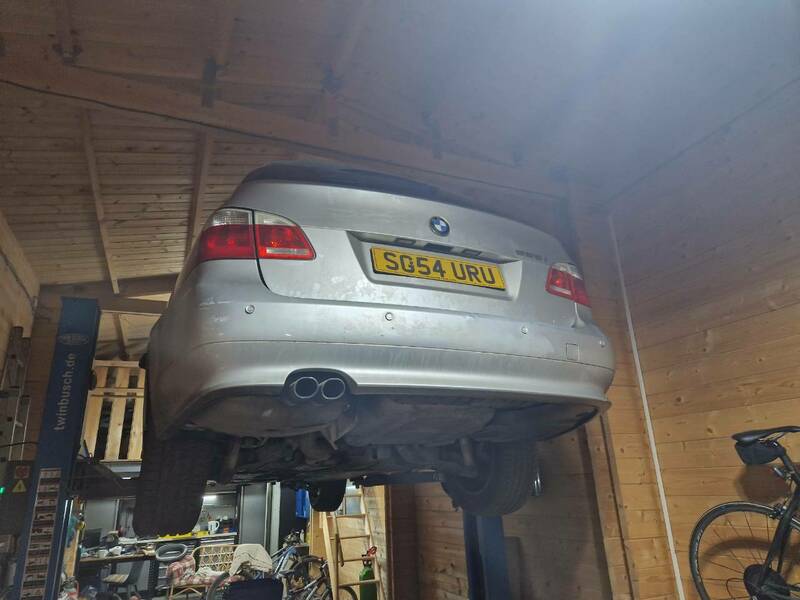

BMW news: Today I faffed about with the tailgate to access the centre brake light. Got there in the end thanks to a YT video showing me how to manually release the latch for the upper glass bit. Then the spoiler unbolts with the brake light attached to it.
Then @Cluffy helped me lift the gearbox into the boot and I drove to my mates house who has a 2-post lift.
Not much progress to report other than draining the autobox fluid; Mrs Grogee arrived to give me a lift home shortly after I'd got it up in the air.
My challenges will be with the exhaust which is supposed to come off to get to the propshaft. Although I may unhook it and rest it on something eg stepladder to give me enough room to get at the prop flange bolts.
Also the heatshield bolts are rusted to fuck but meh, I was expecting that.
I've got a used torque converter to go on as well. It has six coupling threads whereas the existing one has three but I think I'm going to chance it and hope for the best. At least the gearbox numbers match up.
Also I need to invent a way of pumping fluid into the box - the Chinese pump I bought is dead as a dodo.

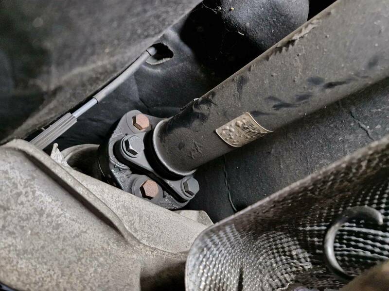

Progress of a sort. Disassembly was hampered by shitty heatshield and exhaust mount rusty nuts but nothing that the spinning wheel of destruction couldn't cope with.
I'm attempting to leave the exhaust attached - again, partly a rusty nuts thing (zorst to cat nuts) but also because it might stay somewhat sealed that way. It's an I6 not a V8 so the cat sits to one side of the box and don't look as though they'll impede progress. There is of course the risk of bending and breaking, yadda yadda.
Also had much confusion trying to turn the propshaft with the box in neutral and the handbrake on... Bellend.
I've bent up some of the heatshields good and proper because of the exhaust being (nearly) in position but it's that soft aluminium stuff that ought to bend back OK.
The torque converter is mounted to the flex plate with just three bolts - one of which I dropped into the bellhousing, like the bellend I am. No matter, it's all coming off to do the crank seal, assuming it plays nicely.
I think I'm going to lower the car so the box rests on a table while I take the last bolts out. Getting the new one back in is going to be a bit of a game I think.

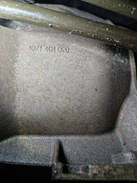

A chance YouTube video combined with a major mechanicing snag have made me rethink my approach.
Firstly, I watched a video that stated the mechatronics ECU (solenoids + electronics) is coded to the car. So bolting the other gearbox on would most likely result in lots of red lights and no go.
So having learned that nugget, I thought that instead I might transfer original ECU to new box.
Then I started attacking the bellhousing bolts. Fuck this bolt and whoever did it up... I managed maybe two turns straining and using the breaker bar before I chewed the head up. I tried smashing another socket on but it just slipped again. Considered grinding the head off but space is really tight there, I can't get the grinder in and even if I could, the chances of grinding the wrong thing are very high.
It definitely has been cross-threaded, it's not just a case of loosen then spin off. Question is - by whom? Done at the factory or by a different ape?
Now, consider the situation: if I bolt everything back together, I have a working car with a slight gearbox judder. I could MoT it then sell it to WBAC and get enough money for another whip.
If I continue down the 'box off' route I might get past the point of no return and have an immobile BMW stuck in my mate's garage.
So Plan B is to change the seals in between the mechatronic unit and the gearbox itself. Another YouTube vid I watched said these seals get hard then leak and cause many different issues, so I stand a chance of curing the fault with this method. The cause might well be too-low pressure going to the lockup clutch, which would lead to the slip I'm experiencing.
So I removed the filter pan, spilled loads of ATF on my mates garage floor, then carefully removed the mechatronics block, observing the bolt sequence. This gives access to the seals.
Interestingly one of the seals I took off was hard as rock so this might well be causing issues. I've ordered some pattern replacement bits but they don't arrive until Thurs at the earliest so I'm twiddling thumbs for a few days.

Addendum: I think I mentioned I dropped one of the torque converter to flexplate bolts into the bellhousing.
As I reluctantly decided to start Plan B, I realised that there was no way the car was moving without retrieving that bolt.
LUCKILY someone at BMW was having a good day when they designed the bellhousing. After half an hour of poking magnets down the inspection hole, I realised there were two tiny access holes on the bottom. I managed to jimmy the bolt along to one of these holes then wriggle it free. It only just came out which makes me think that's what the holes were there for!
