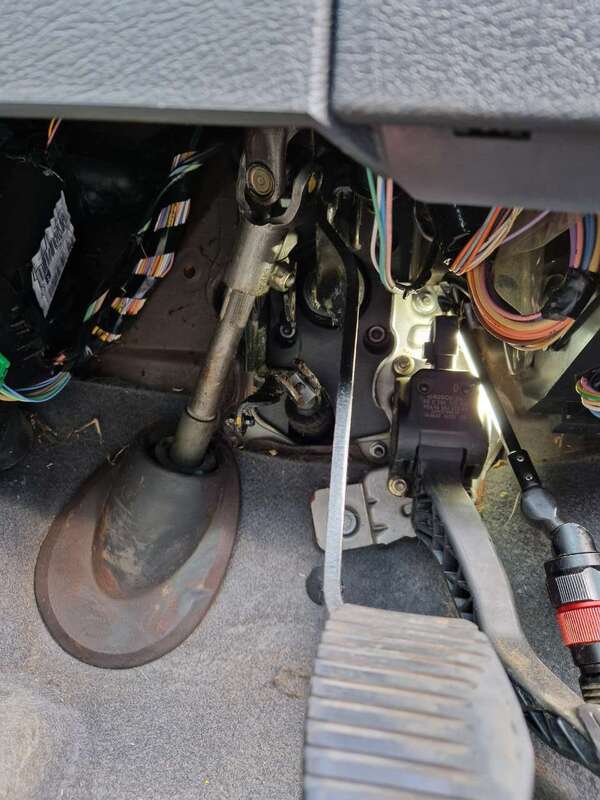

grogee Posted November 21, 2024 Author Posted November 21, 2024 Been out in the Partner. My old mechanic boss said 'do the hardest jobs first'. So I tackled the clutch pedal bush. @Jimbob McGregor alerted me to the common bush failure on these, sure enough when I checked the pedal was moving diagonally because the bushes were worn. Getting at the pedal was a bit of a yoga exercise. I decided I wasn't going to try and reach the pedals with the driver seat in position so I removed it. Once in it was a fiddly but do-able job to remove the pedal and change the bushes. Pedal movement is now properly square. Too soon to tell if it has made the pedal action lighter, but knowing it's pushing the master cylinder squarely should help matters. Then I replaced the seats I'd removed to transport loads of stuff. Then I transferred my attentions to the stereo. Rather than faff about with a steering wheel controls adapter, I've decided to just throw in a Pure DAB/Bluetooth unit. Because the OEM radio antenna is unamplified and roof mounted, I think a DAB splitter should work OK to give me DAB signal from the existing aerial. Unfortunately the one I tried is dead. I thought I had several lying about but I can't find any of them. I also had to remove the centre console to pick up an ignition feed for the radio. I've modified it so that it can go back to standard when I sell it. Anyway after about 3:30 the sun dipped below the horizon and the temperature became Very Cold, so I gave up for the day. I'll see if Amazon can deliver a DAB splitter overnight via Prime. Then I've got some speakers to throw in the front doors for a quick* and easy upgrade. Jimbob McGregor, Dyslexic Viking, beko1987 and 13 others 16

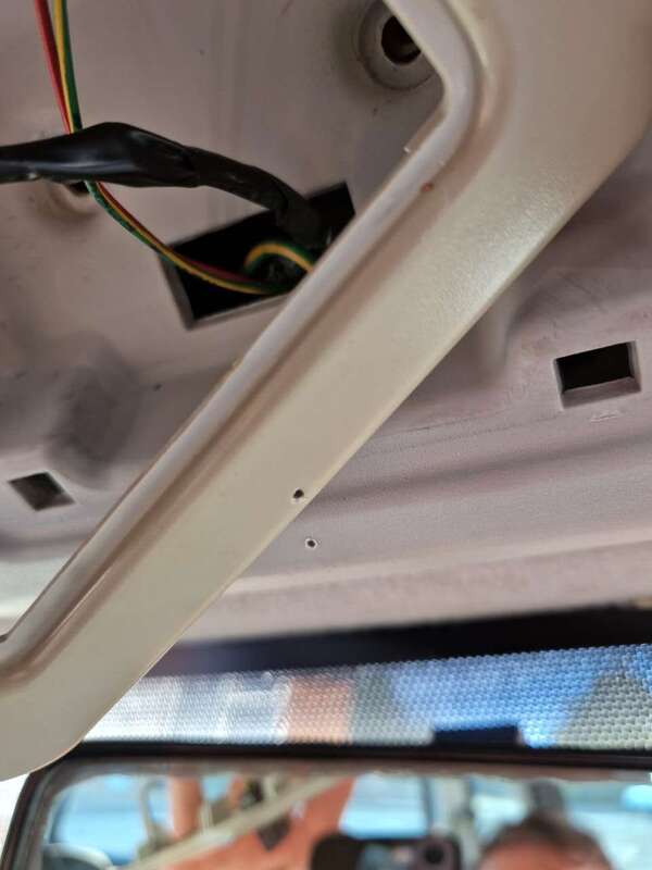

grogee Posted November 28, 2024 Author Posted November 28, 2024 Jumped in the Partner this morning to go and refill my 5l petrol can for the lawnmower. Noticed a disconcerting drip-drip from the interior light pod... So I pulled it apart to look for the source. Initially I suspected windscreen because I had a new one fitted last week. But the top of the screen is actually lower than the light pod so it wasn't that. Eventually realised it must be the roof mounted aerial. The correct way to fix this is to drop the headlining and replace the seal... Yeah, naa. I did it the incorrect way by smearing a load of brown sealant around the antenna base. The car is so bloody tall, nobody will see my 'repair' anyway. Probably 50/50 on whether it seals. So just in case I've drilled tiny holes into the plastic to allow any water to drain out. Pleased with my 'work' I then branded the car permanently into the fleet: Coprolalia, Tickman, mercedade and 6 others 9

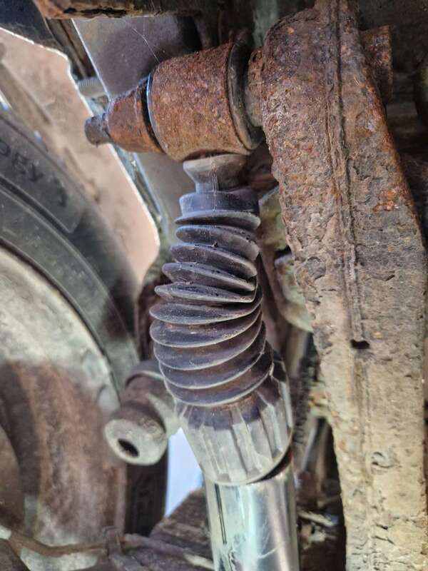

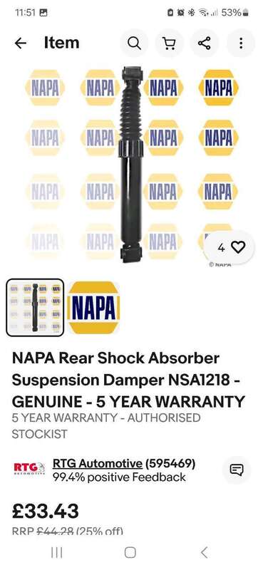

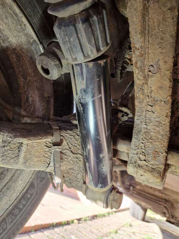

grogee Posted November 29, 2024 Author Posted November 29, 2024 More tinkering before I start my job on Monday. And it's surprisingly pleasant outside, not cold at all (at least in our suntrap cul-de-sac). Changed osr damper to even up the rear end after only one was changed for an MoT fail. The NAPA branded bit was £28ish with some sort of Black Friday discount which is super value. Yes I'm aware NAPA isn't the best and is likely rebranded Chinese cheap stuff, but it will last longer than the rest of the car which is beginning to suffer from rot. Actually while the car was on the stands and the spare wheel was out, I gave the underside a spritz with lanoguard. It makes me feel better anyway, and hopefully the mot man will appreciate the 'effort'. Usual battle with rusty fixings but nothing my big ugga dugga couldn't handle. The top shock fixing was an Allen head bolt. Because of the rust/age I couldn't really tell what sort of fixing (Torx or Allen?) even after a go with the wire brush. Initially I concluded it was a 13mm Allen which I didn't have, so I improvised with a drift that has a 13mm hex shank. But that soon slipped and once the rust was cleared a 14mm Allen went in. Also noticed the spare wheel cradle was a bit loose, which might explain the clonk over bumps I've been hearing. Hope so anyway. The rear suspension needs changing really but I'm not going to do that unless I have to. Luckily I've seen complete replacement assemblies for £260ish. That's not bad for a big lump of suspension with new bushes and bearings. And a damn sight easier than changing the existing bearings. I'll wait for MoT time and hope for the best. Sunny Jim, Popsicle, Tickman and 1 other 4
