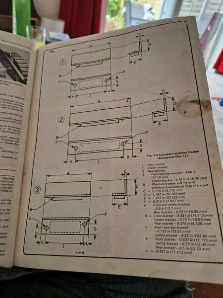

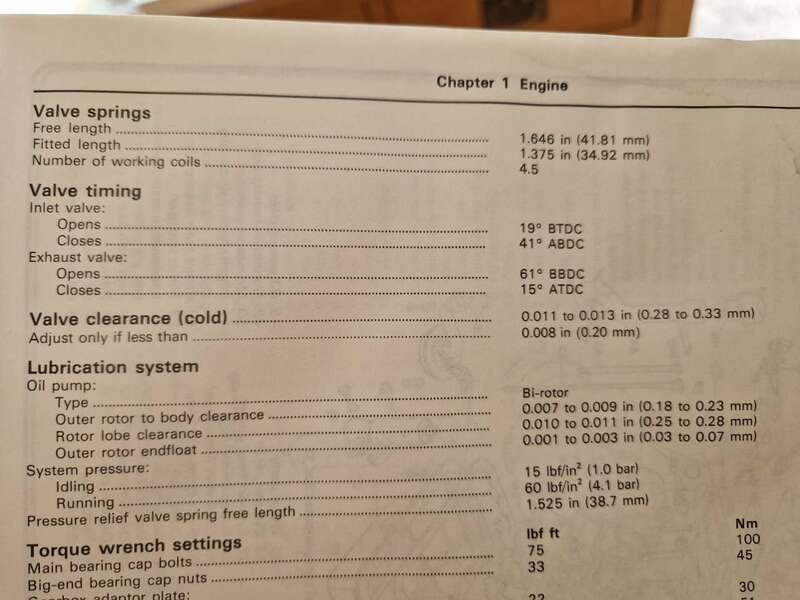

Dobloseven Posted July 3, 2023 Posted July 3, 2023 On 7/1/2023 at 10:14 AM, grogee said: Having looked at the valve clearance procedure in the HBoL, I've decided to forget that shit. Needs a special tool OR the home made one specified by Haynes which needs angle iron, plywood and a whole lot of patience. Fuck that to the moon and back. I'll take my chances by refitting the existing shims in their original positions and hope for the best! Even if I went to the trouble of checking the clearances, the odds of me finding the correct shims for all eight valves are miniscule. Fuethermore the HBoL specifies quite a tight range for clearances, but then says only change if it's less than 0.20, suggesting there's quite a wide range of practical tolerance. Made one of those camshaft clamping things when I had an O Series Ital back in the late eighties! grogee 1
High Jetter Posted July 3, 2023 Posted July 3, 2023 1 hour ago, Dobloseven said: Made one of those camshaft clamping things when I had an O Series Ital back in the late eighties! Commiserations.

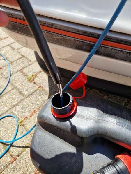

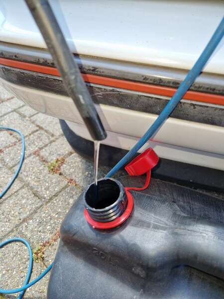

grogee Posted July 7, 2023 Author Posted July 7, 2023 I think @Geoff Smith has it cracked. I ran the fuel pump continuously for about 20 mins and it started out strong but eventually was reduced to a dribble. Then rigged up a 5l fuel can feed from spare wheel well to fuel pump (which is under the tank. I've just gone out for a drive and things seem much improved with the petrol can feed. But... My Heath Robinson bungee system for securing the tank failed halfway then tipped over on its side and Iost its contents. So now I'm walking miles to the nearest fuel station to grab another 5l and a fuel can! Trying to hitch but none of the locals want to pick me up, not surprising as I'm dressed in scruffs and probably look like a fugitive. Shite Ron, somewhatfoolish, Dyslexic Viking and 1 other 3 1

grogee Posted July 7, 2023 Author Posted July 7, 2023 The other important detail I ommitted from my jerry rigged system - the return line was squirting all my fuel can fuel into the original tank! Took a bit of working out but I finally twigged why I was averaging 1mpg, @Cluffy had to rescue me from a country road and it was a bit frantic getting home for the school run in time. Anyway I've routed the return line into the tank now so it should be OK now. Crazy day! 3 hours ago, Geoff Smith said: That’s good news, hopefully you can rig it up and give it a good run to confirm 100%, I’ve taken mine out for a run today That looks lovely and shiny. Would that I had time to do cosmetics on mine... Will hopefully get an hour or two tomorrow but forecast was for thunderstorms. I did have cause to look at mine from a distance today as I approached with a fresh fuel can, and was struck by how cool it looked. I've been so obsessed with the details and faults that I've not really had a chance to appreciate it for what it is - a curious slice of 80s hot hatch as interpreted through the lens of the BLARG behemoth. Matty, somewhatfoolish, auntiemaryscanary and 2 others 5
