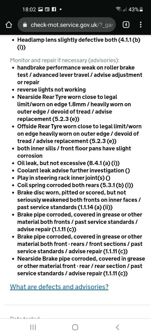

I have the chance to purchase a 2002 x type.
It's nice condition but an mot failure.
Here are the failures and advisories.

But it depends on how rotten that subframe is and how much of the advisories are just arse covering or is it a car that's neglected and had big jobs put off until tomorrow...
If it needs a boatload of brake work, new tyres, a subframe and some suspension joints then it's costing more than one with a clean MOT already.
I am not really into moderns, but I have enjoyed the X types I have driven, and they are nice cars to be in.   From what I have seen of the way they are built while doing various jobs on them, I would avoid that one.  Some of that work is going to be a right faff.  They are really not worth restoring unfortunately.  I would look for one with an MOT that you can enjoy.

It's 11% Mondeo, but putting that aside, that's a mixed bag fail.  Subframe needs work, but the sills don't?  Failing the brake fluid, when they can't even take off the cap is always sus. Just because it needs tyres and time with 163000 under its belt would make it an uneconomic fix.  Plus I wouldn't use that tester again.

The mot tester is a friend and colleague and he says the rear frame can be welded. The advisories for rust on the floors is minor and can be cleaned and treated.
