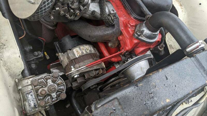

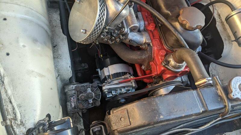

Baby steps. Made it to the end of the street.
Alternator was fine then belt started slipping. Have started work on a home made tensioner.
Great work as ever and especially seeing it moving under its own steam, I've been enjoying the updates ta.
Plan B. I could have called it an alternate plan but I didn't.
The belt squeal was due to the alternator managing to walk the brackets out of the engine a tad and go out of alignment. Predictable?
I am using the wrong alternator on its wrong side.  But I'd rather make something work than spend the money because I'm miserable like that.
Here is alternator fitting kit 2.0.
Significantly beefier bracket / cradle and I lengthened the tensioner bar by welding two together.
That is significantly better, but it's still very difficult to set the correct tension. Normally you'd jam a crowbar in and then tighten the top bracket, but because there is a thin coolant pipe there I'm loathe to get in about it properly.
Here is the game changer. Turn the nut on the right to tension it up, then lock it down.
Squeak now you bastard, I dare you.

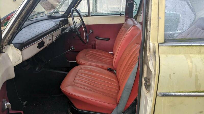

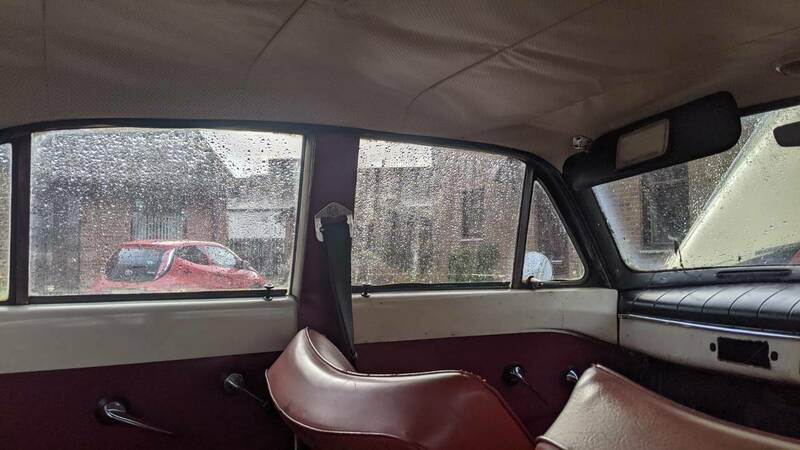

Finishing off some bits inside.
Rubber trim around the doors in place of the windlace trim. Also the new headlining installed by @MrsJuular

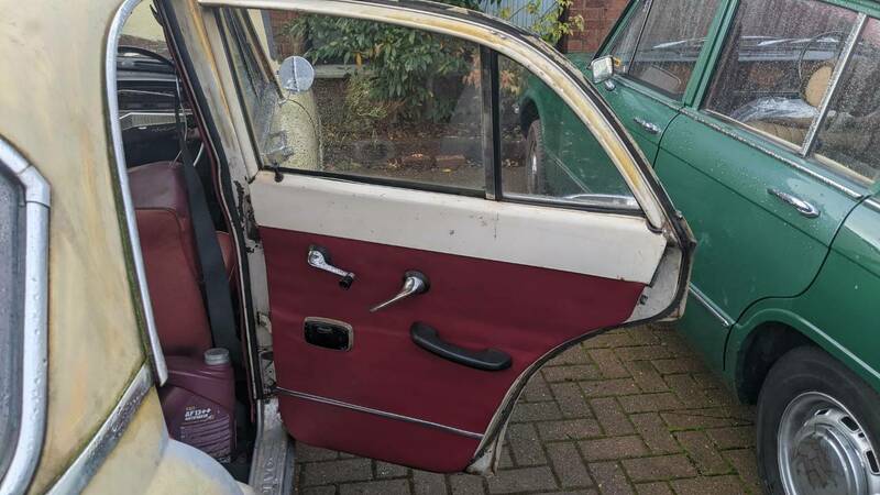

And more of her work in the new door cards.
The front ones have been upgraded with door pockets from a 240. The original stretch pockets seemed a bit useless. These will hold bottles and cans.
The seats are original but they are different from most Amazons I've seen.
Dome light and sun visors.

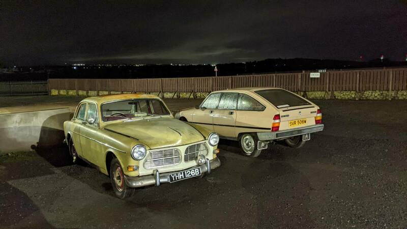

  • juular changed the title to 1964 Volvo 122S - Amazonian rustforest. Shakedown drive.
It went very well on the way home too despite the 40mph winds and driving rain, although the overdrive decided not to engage on the motorway despite working properly earlier.
Very comfy. Tremendous heating. On a winter's evening it's a very cosy place to be.
Drives lovely. Lots of grunt, I'd even call it lively.
No unusual noises. Sounds very snorty through the twin carbs. Lovely!
Rolls like a boat but feels planted and has endless grip. Steering is far quicker and better than expected despite being a steering box.
Brakes are absolutely fantastic despite being unassisted.
Gear change is slick.
Feels like a Volvo.
I love it. ❤️

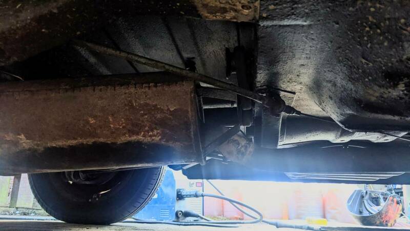

Next on the list, an obnoxious exhaust blow that started last time I drove it.
This looked decent when I reassembled the exhaust. Oh well. Out with the welder. Again.
I really, really couldn't be bothered here and the inside of the pipe looks like kerplunk.
The downside is now it's so clean it doesn't want to fit properly in the mid silencer, it's a bit loose. The solution for that was to create a new.. ahem.. exhaust gasket. Out of mig weld.

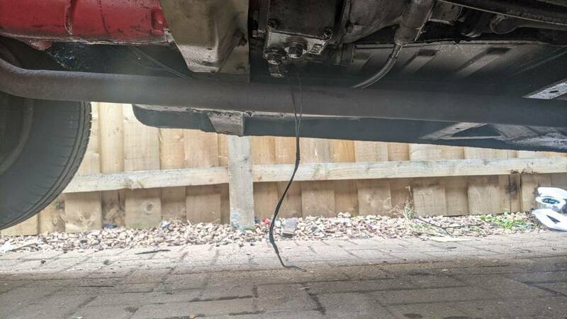

Exhaust is now less obnoxious. The downpipe started to blow at the manifold because it had been on and off so much, but that was professionally mended using exhaust paste and foil tape.

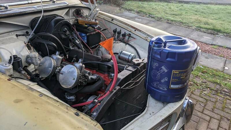

Next thing to check is the filter on the other side.
I didn't realise taking that inspection plate off caused the oil to drain, so that got messy.
Anyway, the filter was jammed full of sludge. Cleaned that out with white spirit.
Then refitted and refilled the box with fresh oil. 20/50 engine oil in these temperatures is like treacle so this was a somewhat time consuming job.
