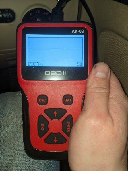

Plugged in the cheapy code reader;
That certainly is a bare bones basic code reader 😂

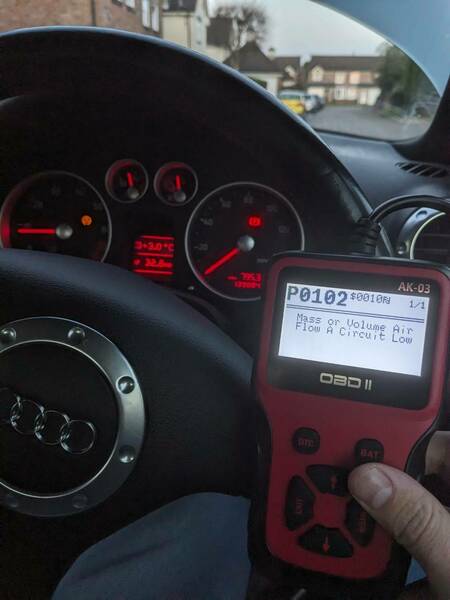

This is my more modern, emergency in glovebox £13 Amazon special and more what I was assuming it would be like.
Hey I've got that one too and it's spat out enough codes to save me money firing up the parts cannon. Most recently it diagnosed the O2 sensor on the TT. I do need a better one though.

Tried it earlier and the only live data it does is engine speed, coolant temperature and engine load. Hmm.

That tool is about as useful as a chocolate teapot 😅

That code could be triggered by you unplugging the MAF sensor. The intake air temp sensor is integrated within it.

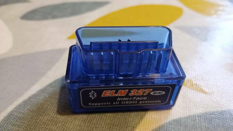

I've got that Bluetooth dongle on order already.

It just gets stuck in a seemingly infinite loop of testing the connection.
Sometimes power cycling the adapter (unplug & plug) and trying again might work. Often need to do it if using between apps.
I unplugged it several times while trying to get ScanMyOpel to work.
