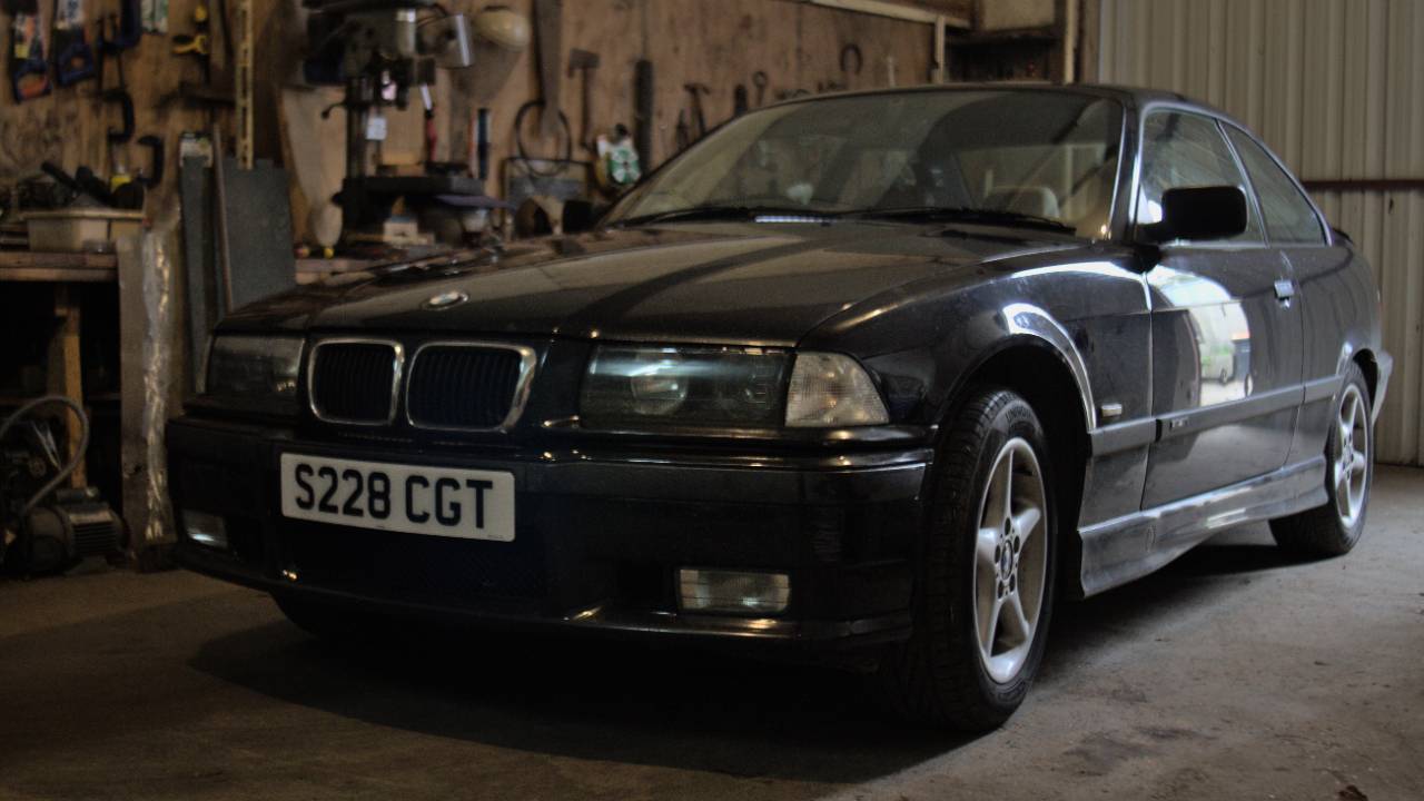

I'm bored, it's raining, and I have a 50mm prime lens. With the aperture all the way open at F2.8 it looks good.
Think of it as a better attempt at the photo from yesterday.
Still great looking cars.  Not sure how successful the side skirts look now though...
