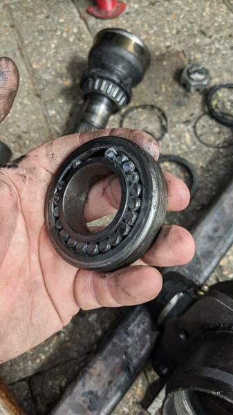

Not Montego related but I've been stripping the wheel bearing that collapsed on the way to FoTU last Saturday. Unfortunately it's destroyed a lot more than the bearing. Hub and CV have been completely ruined. CV was seized to the bearing which has spun in the hub too...
This kit had done about 50 miles and the retailer of the kit is being slow to help.

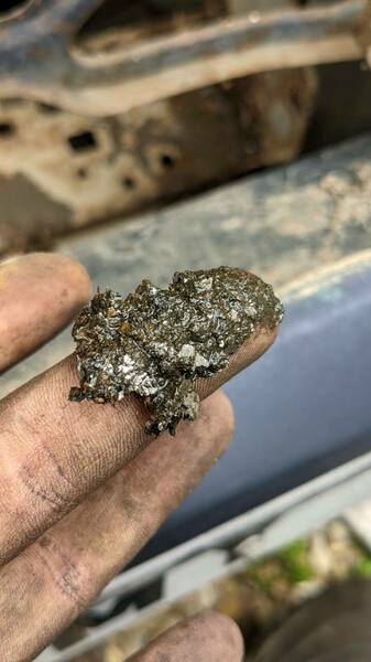

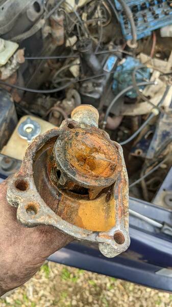

Post removal of wheel bearings from the Mini I decided to tackle the Montego cooling system. The pipes are crunchy and the water pump sounded awful and was leaking too. Took all the hoses and rad out and took the water pump off. I'm glad I did because it's absolutely grim inside the pipes! The water pump had a collapsed bearing and a leaking shaft seal so definitely toast.
Also curse the Austin engineer that designed the engine mount for the 1.3! It was a right pain to remove! You cant actually remove the pulley to remove the pump you have to slide the pulley into a hole in the engine mount then undo the pump itself.

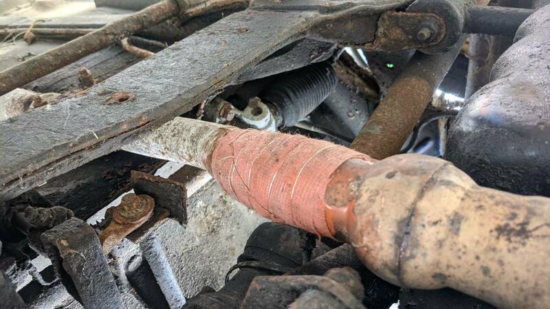

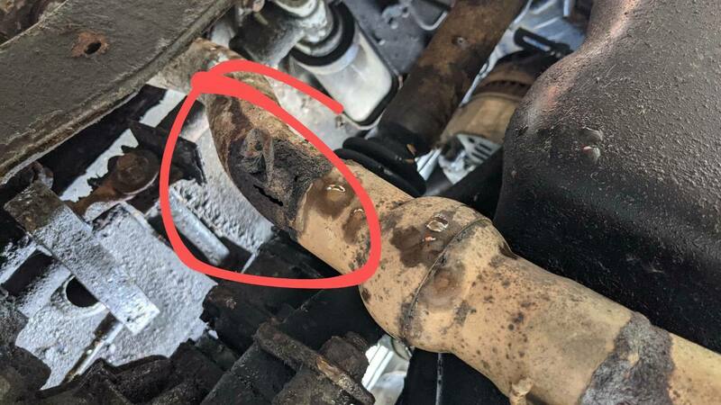

My favourite repairs are the one where someone takes it upon themselves to weld every join in the exhaust so it's impossible to replace a section easily. Especially when you have a hole. However they then take it upon themselves to hang the exhaust with coat hanger wire...
However I do now know where the exhaust blow is coming from. Professional repair definitely not involving a coke can incoming!

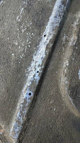

Somebody welded a sill on top of another sill. New sill is good. Old sill let go and was the one still attached to the floor. It's a fairly simple fix for MoT standard.
Someone took the AS advice of hammer a bigger one over it a bit too literally…
It's not too bad. The 'oversill' is in good condition and the floor is in good condition. There's just a big gap between them.
I've got a couple of other areas to sort too but it really isn't bad. It's mostly flat and simple shapes. Nothing I haven't done before!
Sometimes the only thing more dangerous than a question is an answer... Definitely true when the question is "how far does that rust go?"

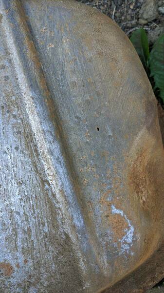

If the petrol tanks was getting an Ofsted grade I think it would be "Needs Improvement"
The petrol tank was actually the last job of today. Started off by reassembling the cooling system and putting in a new water pump having thoroughly flushed it through. The new old stock water pump was a nice find. Actually really nice quality even vs. the ones sold by higher end mini specialists.

Also repaired the exhaust today. A £2.99 Holt's exhaust repair wrap should hopefully do the trick!
