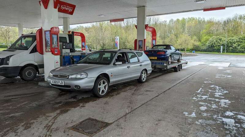

There's a list of maintenance items growing across the fleet. So instead of doing those jobs I went and finally picked up my MG. @sharley17194 kindly helped out with a tow vehicle and I hired a trailer.
We then proceeded to have a trailer blowout on the side of the M6...
The company we hired it off clearly hadn't checked the spare which was both bald and not round. It was also a different size!
We then discovered that these two tyres are a completely different size to the other side of the trailer!
This mornings job is arguing with the trailer company about the £280 I had to spend on tyres at the side of the M6 to make it safe to tow... Bald spare. Mixed sizes across an axle. Very much a liability...

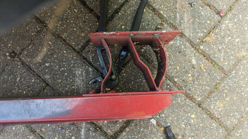

Lastly I stripped the front end off the MGF. It's had a shunt in the past and had some replacement parts but the front never sat straight afterwards. Turns out it's because it was fitted with a pre-crashed crash bar. So I fitted a straight one.
Old crash bar
New crash bar
New bar installed
Front end sits much better now although it still isn't perfect but it's good enough.
