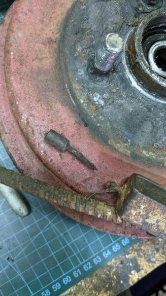

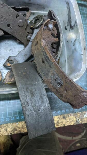

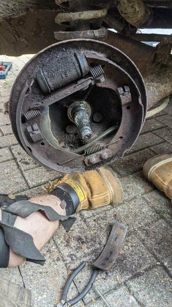

Tackled the rear brakes yesterday. I thought the passenger side handbrake cable had snapped. It turned out it was actually the 'intermediate' cable. For some reason the Montego has a handbrake cable split into four sections and one tiny piece of wire had snapped at the compensator. I suppose it makes swapping broken sections easier than doing the whole length but it is a bit more complicated a setup as a result.
The shoes were also seized on the passenger side and the liner had fallen off one of the shoes on the drivers side. I'm awaiting a middle cable to finish the job.
Also both split pins were not split...

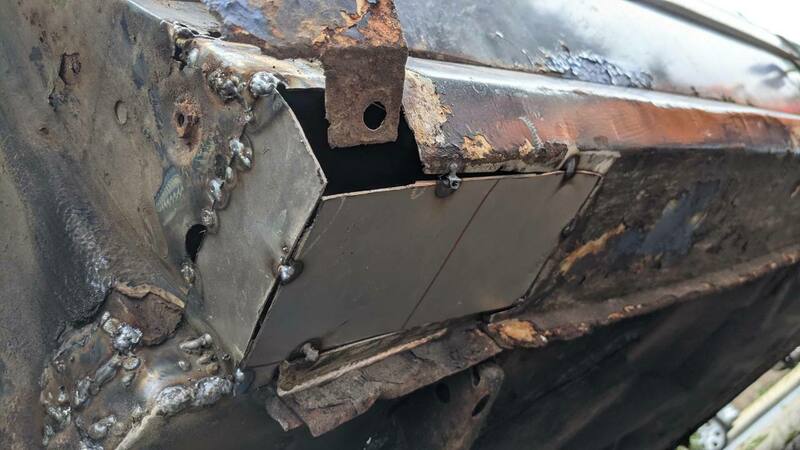

So begins the welding...
I won't profess to these welds being pretty and I may be welding to some pretty crap metal but theyre 'MOT standard'. I did find a bit more rot after digging under some filler so the plating went a bit further than I intended.
I definitely didn't just use a pair of pliers to bend round to form a lip...
Unfortunately I ran out of gas hence some of the welds look a bit shit. I wanted to get it tacked in at least until I go get some more tomorrow.

I picked up a fresh bottle of gas on Tuesday afternoon so yesterday I took the day off and did a load of welding.
Finished the wheel arch off which was basically just running seam welds. I may or may not get round to filling and shaping but to be honest @sharley17194 and I don't have many weeks till our road trip and looks are bottom of the agenda Vs. A road legal car!
Then I did some patches in the passenger rear arch where some holes were.

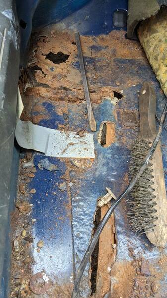

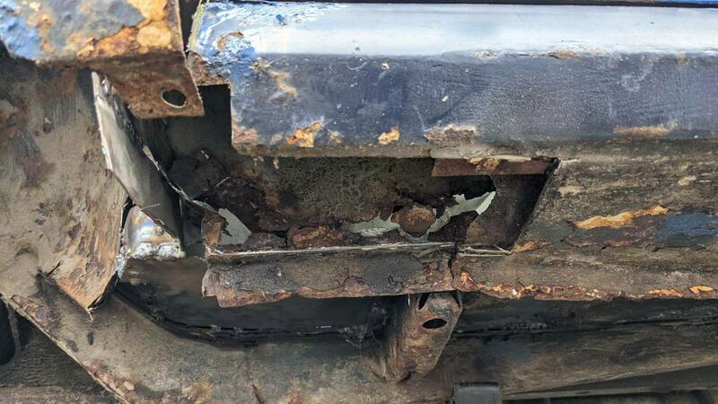

Then I found the worst of the rot. The front of the passenger side sill and some of the floor... I was not expecting to do this but when I lifted the carpet to start the sill I was greeted with this.
Which soon developed into this...
Which became this after many many hours of rebuilding the inner, outer and front of the sill.
It's not pretty no. But it's solid.
Autoshite mantra Volume 2641
1 hour ago, big_al_granvia said:
classic leyland rot, almost as good as ford rot
The only saving grace were the chassis rails being solid which I can't say is normal for all Leyland products! At least it gave me something to work off. Plus the floor was flat so a bit easier to work with.
