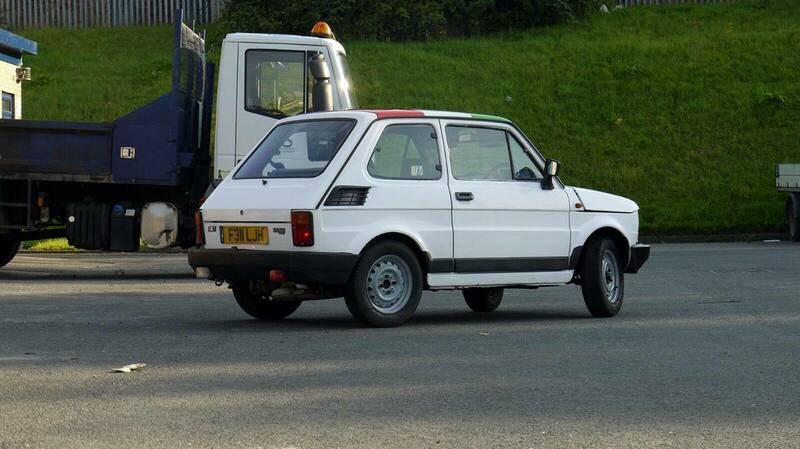

Fiat 126 purchased
On 7/15/2021 at 9:01 AM, DavidB said:
Where is this? I need that parcel shelf :)
I gave this a proper “machine polish” and it’s come up really nice. I got it running properly also (no petrol), replaced throttle and choke cables, flushed coolant, bulbs etc and drove it round the estate and it’s f@cking horrible in every way imaginable. Not sure about the no bumpers, but you can strip everything off in about five minutes.
That does sound quite impressively harsh and unrefined...much more "big ride on lawnmower" than car!
Makes me appreciate how refined for a twin pot the little Steyr-Puch engines are.
Always fascinates me how two engines which on paper are quite so similar behave differently.  I'll need to grab a video of me giving her some revs if I get a chance for comparison.  You can see how little vibration there is at idle though.  How smooth this engine is has never ceased to surprise me given when it dates back to design wise.
126 in any form though is such a downright charming little thing that it's utterly impossible I find not to like them despite all their flaws.
I think it’s horribly out of tune and both exhaust pipes aren’t tight and have no gaskets.
Sounds like it needs a tune up, but otherwise looks very solid. Congratulations on the purchase.

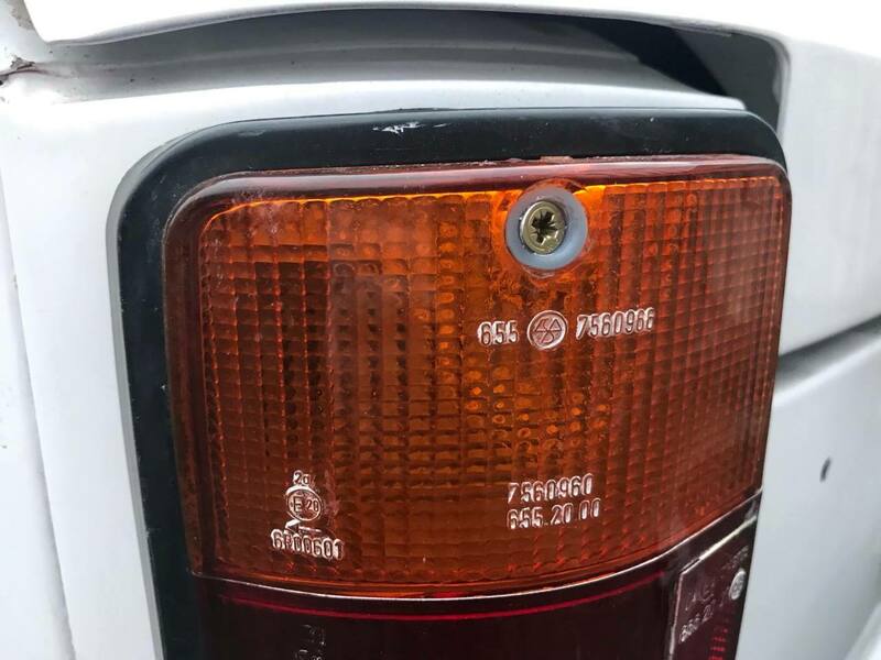

Small point: take care not to crack the taillights. BIS and EL/ELX 126ps had this newer taillight cover design with a vertical reflector stripe and they can be a bit of a bastard to find to find replacements for at times. Very easy to break tightening them up too.
Yep already done it changing bulbs!😥
you can get screws with with plastic blobs to hold them in. Everything had wood screws. I think I’ll print some plastic blobs off.

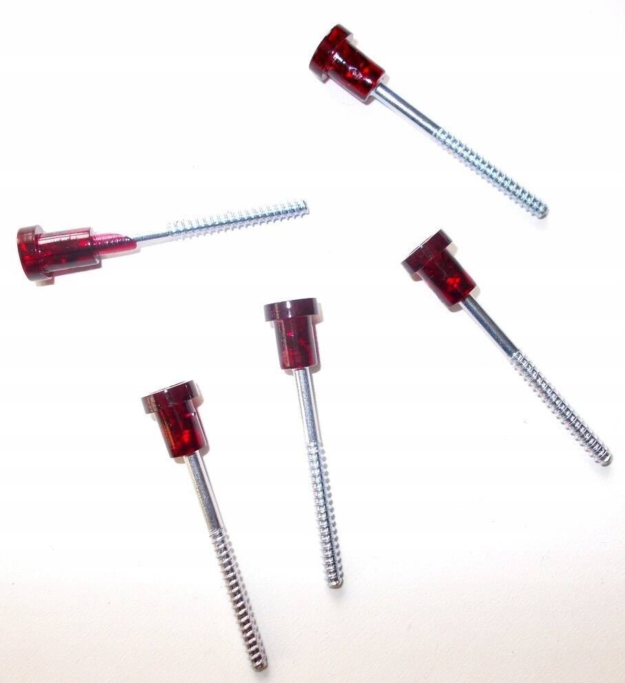

Yep, original screws have plastic heads and look like this: 7D7E338F-C159-46AB-B56A-4CEDF9351AA9.thumb.jpeg.1bf65856156515974f4b31b278bad5ad.jpegColour of the head is different depending on where exactly each screw goes. Bear in mind that these plastic heads also have a nasty habit of cracking and if they do all you’re left is a threaded pin that can’t hold anything. I happened to lose one of my taillight covers at one point due to screw heads failing. Luckily I managed to retrieve it after retracing my route and it hadn’t gotten driven over. 😅
You can get those on eBay, they’re £20+ though. I need the screws as mine have wood screws argh
They're around 20p-30p a screw on allegro.pl. Also, for a decent selection of 126p parts check out https://sklep.regmot.com.pl/. They're slightly more expensive than individual sellers on auction sites, but I still use them every now and then. Fairly sure they also ship abroad.
Just checked and they have the correct screws in stock for around 40p apiece:
https://sklep.regmot.com.pl/wkret-lampy-tylnej-krotki-fiat-126p-kierunkowskaz,3,14128,16368
https://sklep.regmot.com.pl/wkret-lampy-tylnej-krotki-czerwony-fiat-126p-1517,3,14128,16670
https://sklep.regmot.com.pl/wkret-lampy-tylnej-fiat-126p-kierunkowskazu-fso,3,14128,1921
https://sklep.regmot.com.pl/wkret-mocowania-lampy-tylnej-fiat-126p-dlugi,3,14128,1068
https://sklep.regmot.com.pl/wkret-mocowania-lampy-tylnej-dlugi-pomaranczowy-fi,3,14128,16732
https://sklep.regmot.com.pl/wkret-mocowania-lampy-tylnej-dlugi-fiat-126p,3,14128,16369

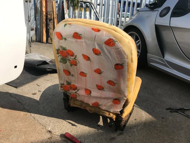

Look at the lining on the seat padding, the underside had apple print, obviously recycled material.

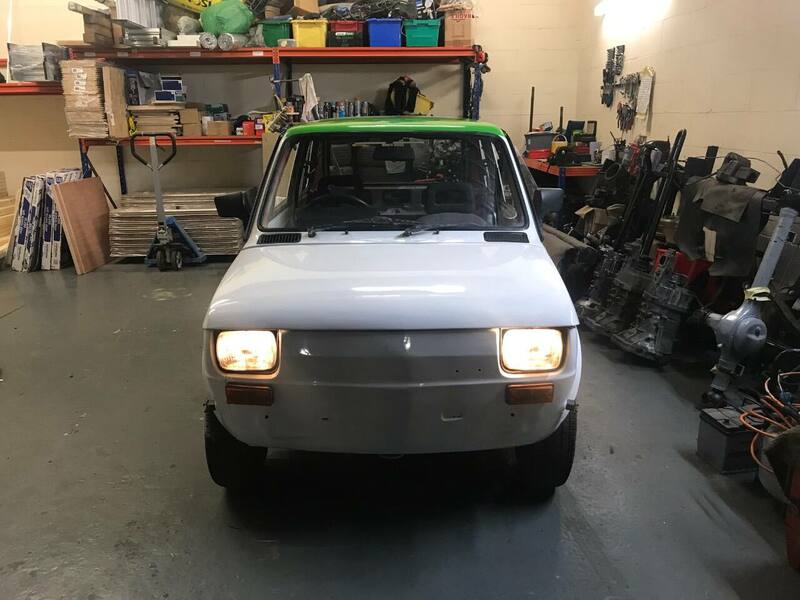

I put this in for an MOT, the drive was OK, it still feels like everything is about to fall off, but I still think it's quite cute and everybody looks at it.
The indicators failed on the way there, and the fail sheet was quite disasterous. I put it on an ebay auction - a car I paid £1450 with about 300 spent on it, and it went for £1350. 😪 The fella I bought it off had it up for £2000. I think I should have done the whole "I'm walking away" with £900 in me 'aaand.

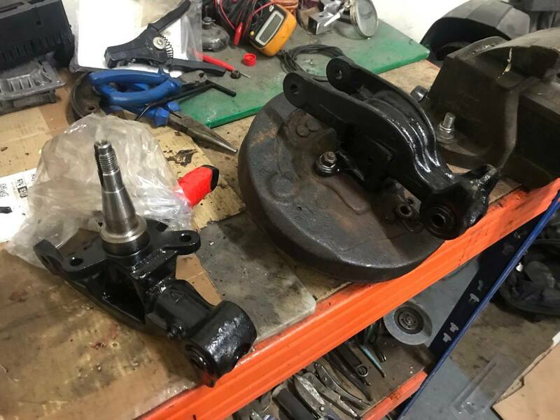

One of the things it failed on was king pins in the front suspension being loose, which is probably the most expensive thing to fix on the whole thing - I bought recon ones for £175, because they're horrible to do, and I tried. I got in touch with someone who refurbs them, and even he said he hated doing them. They had significant play in them even off the car. It took approximately ONE HOUR to remove, change bearings, refit hubs, brake components and other bits and put back on. I reckon you could rebuild every component on the car in a weekend.
I fixed the broken headlight mounts by modelling and printing out some new ones, and just make nice fitting washers for the lens where the original plastic head screws had broken. These work great, even using a crude wood screw to hold them on. I love 3D printers!

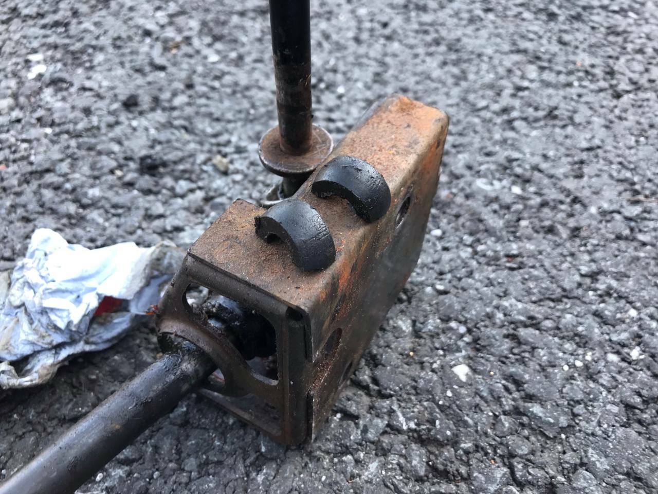

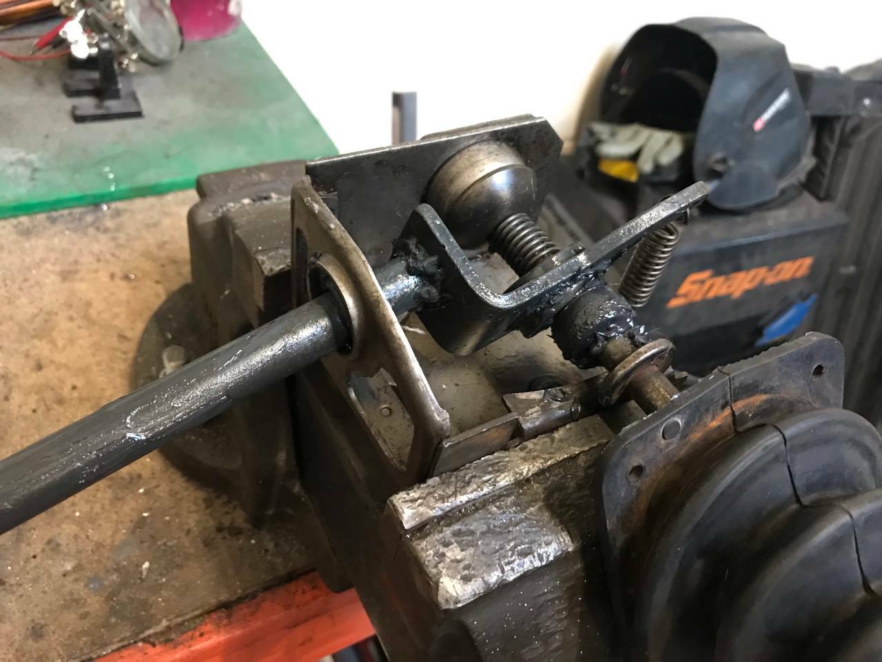

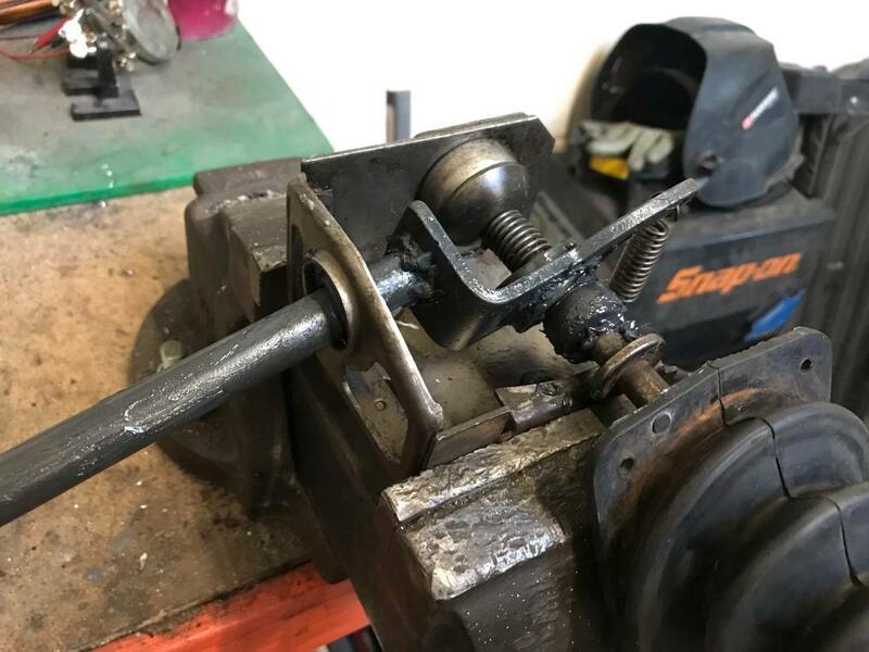

I replaced the bushes on the gear change column, which always go. I just couldn't find more than two gears no matter how much I adjusted them, it was like stirring bricks with Pepperami - taking the whole thing out (10 minute job) showed original bushes were cracked! I bought a brand new shaft with pressed bearings on and new bushes for the rest. It changes 'beautifully' now!

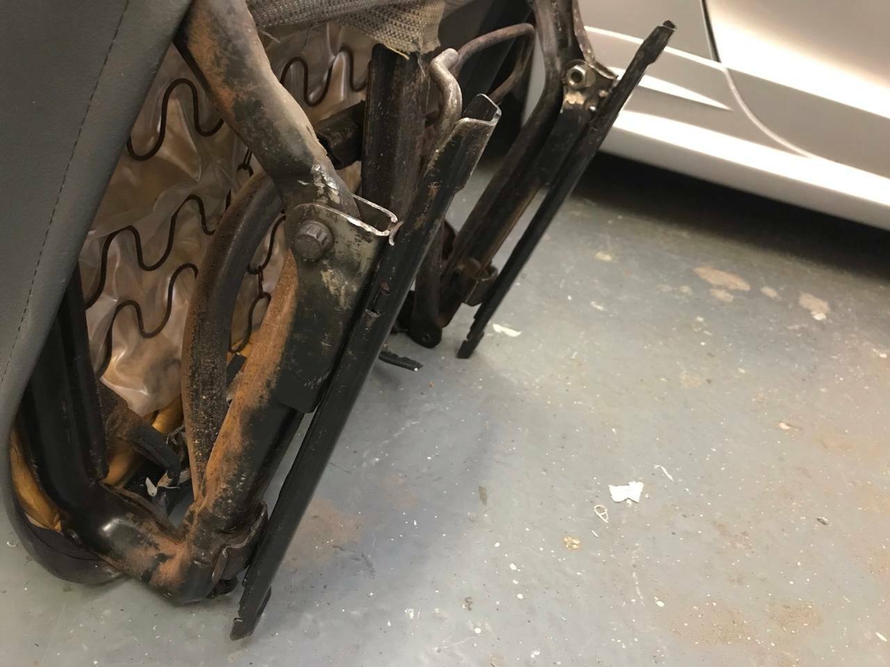

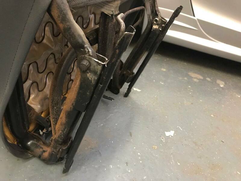

The passenger seat runners were completely seized and bent. No amount of messing would straighten them, I found a pair of ball bearing runners from my old Peugeout 106 that luckily I didn't throw out. I welded these onto the frame and the seat is fantastic now. Bolted to the floor with 1" box section.
I cleaned up the wheels and sprayed them a nice grey - they only need the wheel caps to look nice now. Also yellowed the headlights and painted the terrible front bumper with 2pk satin black.
The only thing it needs now for another test (retest lapsed today due to new parts arriving too late), is a 'boot' on the rear outer driveshaft - it a one inch wide bit of rubber. I think I'll make my own - shafts unbolt and are a synch to change.

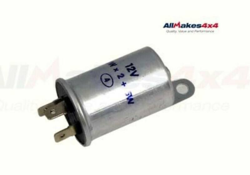

The other thing is the indicator flasher - they stopped on the way to the MOT as mentioned, and I haven't been able to cure it with new flasher relays. The old one is broken, and I'm wondering if new relays are incompatible with difference in pin order connections. It's one of those metal cylinder types, but I can't get one from anywhere local new. Does anyone know what the other ones do - the second from left is burnt out, I think it's the intermittant wiper relay.

Spent a fair few days trying to track down a relay for this. Just as a reminder it looks like this:
I think the ones on these are earthed from the indicator stalk or something. No wiring diagrams on the internet though. Visited every scrapyard and motor factor (most of whom looked at my like I had two heads) in the area, closest I got was one saying they offloaded a load to someone called Greg. Greg said it was at the back of his garage somewhere and he might sort it out one day.
I finally went to a scrappy in north Wales and bought as many relays as I could. I got it all wired up and working in about 8 hours, but the brake lights don’t work. 🥲
Only have to change a driveshaft boot which is tiny and it’s ready for another full price mot as I missed the retest.

Looks like a fairly standard flasher can. Are they NLA?
Don’t know, I had to do a rewire, different to modern ones anyway. Have tried to get the bulb on the dashboard to flash but it just spazzes out the relay if I connect to the relevant relay pin.

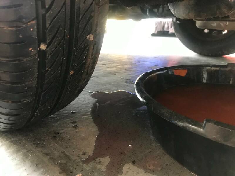

I fixed the brake light issue which was a loose connector, and then put new coolant in - it decided to wait until I did this to start emptying the contents of the cooling system.
I removed the rad and heater matrix and flushed them both out. There’s something very satisfying about flushing solid silty orange water out until it’s clear! There was so much sediment in both.
