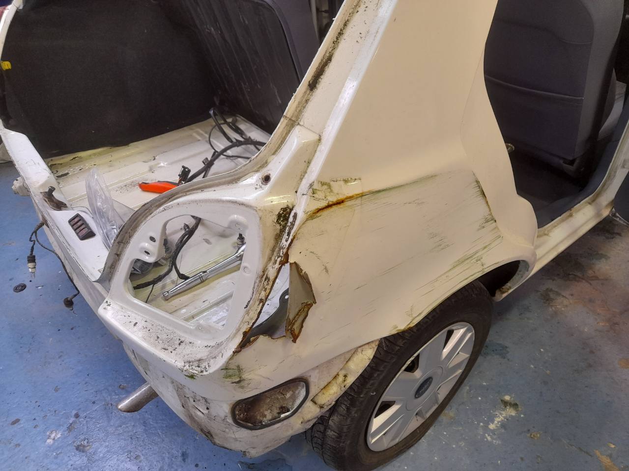

The rear quarter panel, are you going to weld it on or joddle a step in and use some panel adhesive? Less of a chance of distortion?

It does make sense really if you consider all the options. It runs and drives lovely so might as well live another day.
I shall be welding on the quarter panel so its all as it should be.

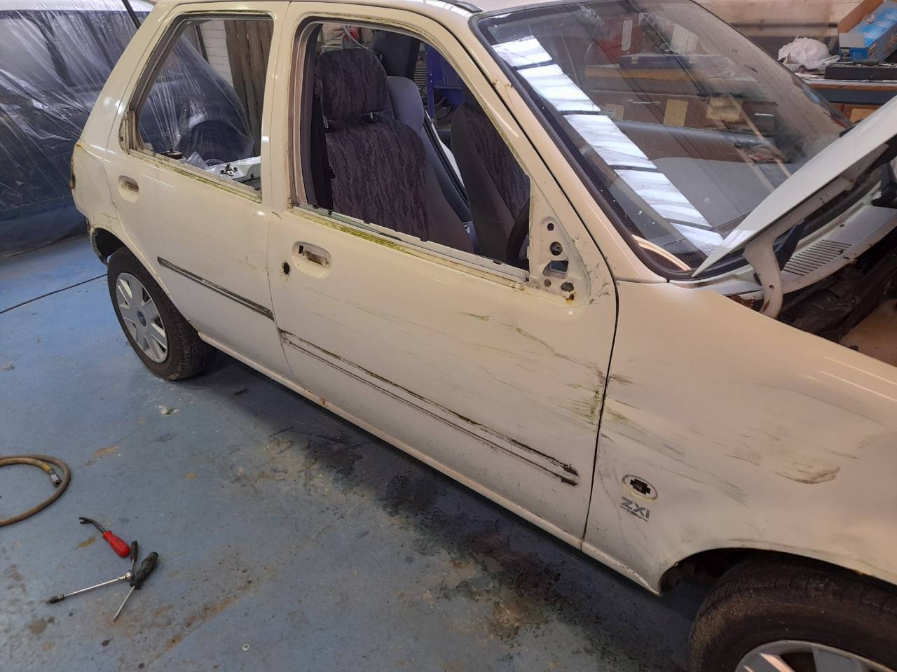

I got the repairs underway on the doors
Total time spent so far...
About 3 hours

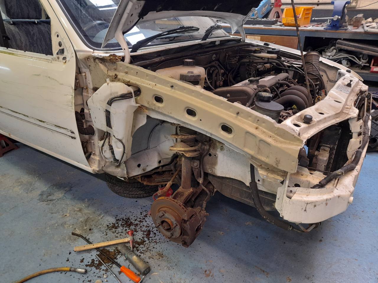

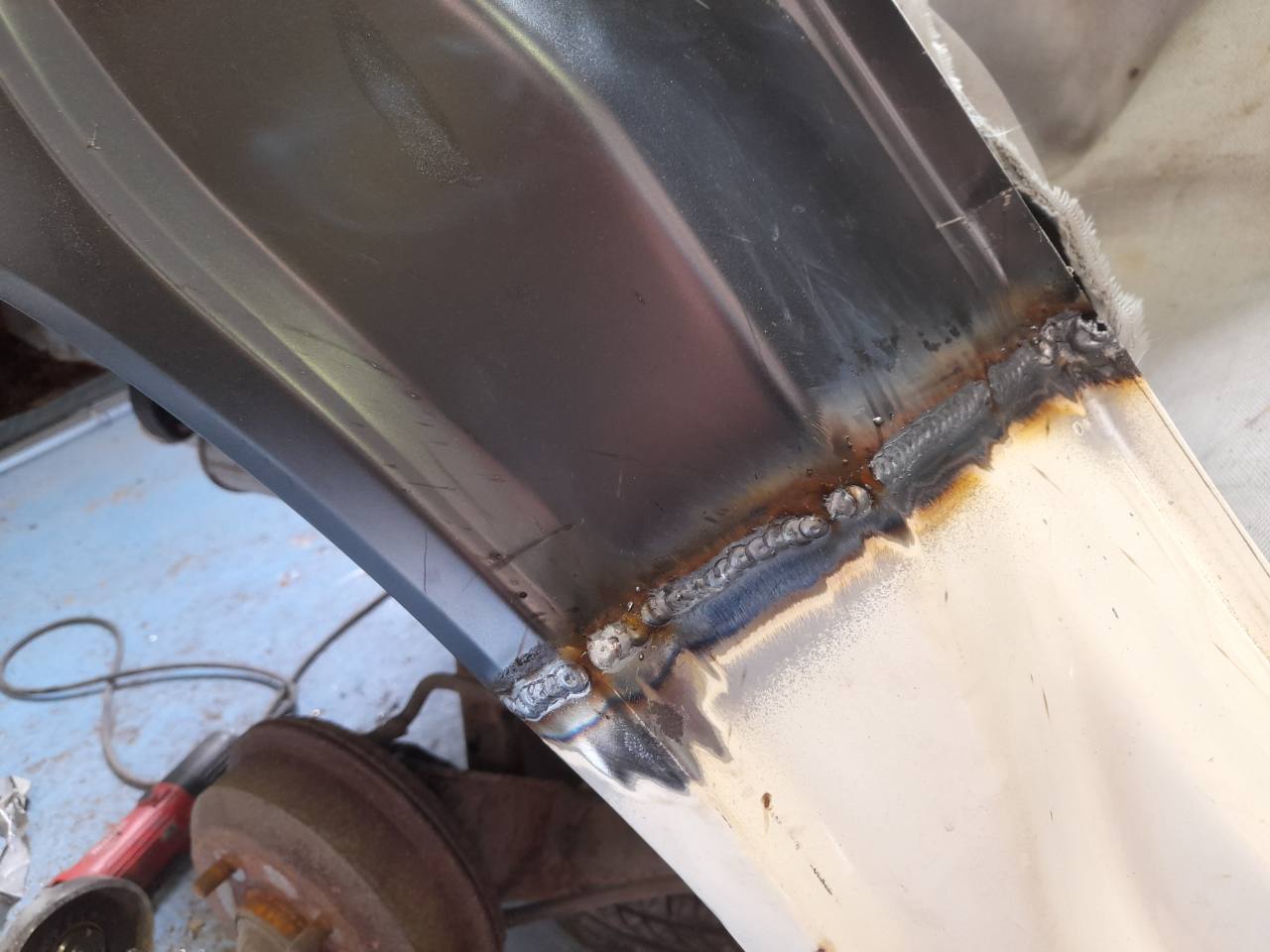

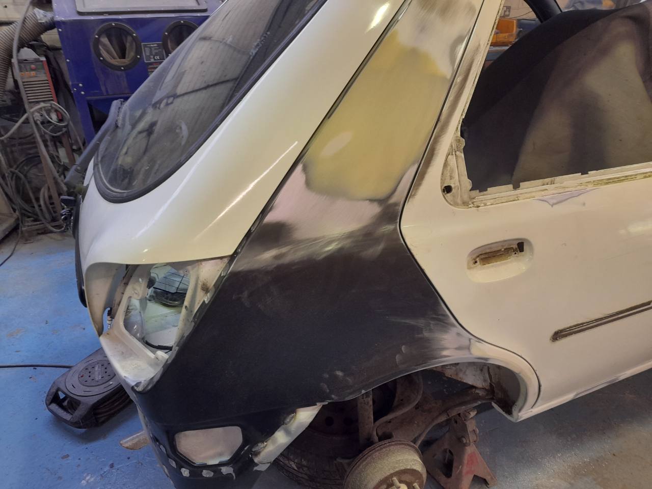

Onto the quarter panel this afternoon.
Old one off. They really went out out the spot welds!

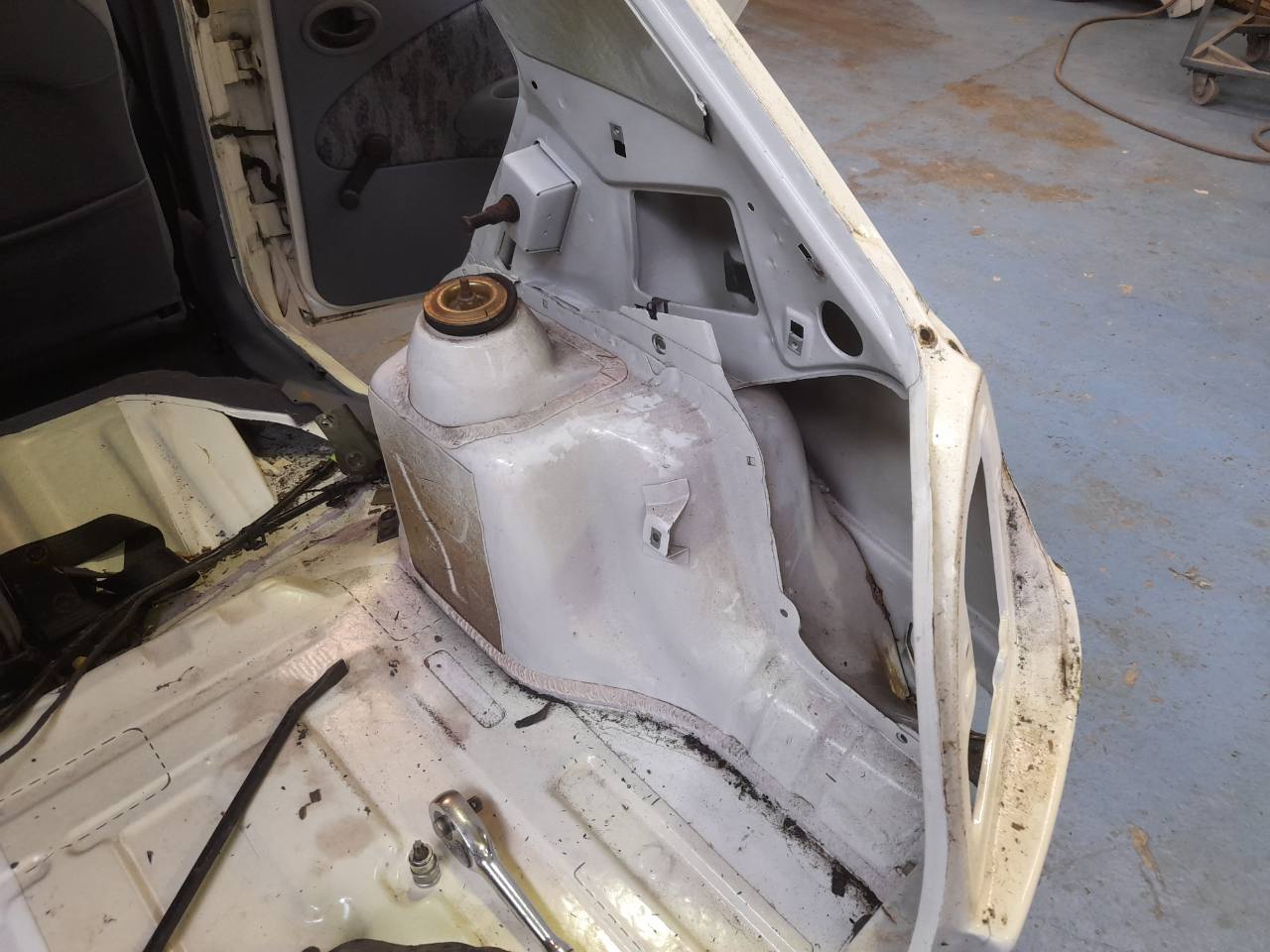

replacement trial fitted
and then all cleaned up and prepped ready to fit

It's taken so little time to repair so far that it's got to be worth it. The parts were dirt cheap and the materials and paint are at my trade rate so it will be a cheap repair, especially when compared to the cost of a replacement car.
I have noticed the undercarriage is getting a bit flaky around the rear axle mounts so I'll get that cleaned up, treated and coated whilst it's still solid.
Think I may also repaint the other quarter panel and sill if time allows as they are getting a little scabby round the edges. Might as well make it good for a while.

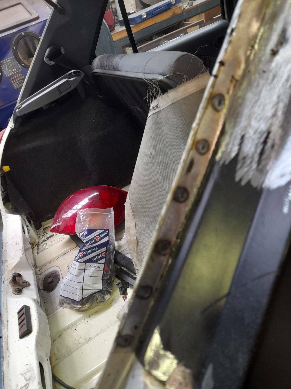

I tried the rear lamp in
it fits as well as the other side which isn't perfect but It's fine.

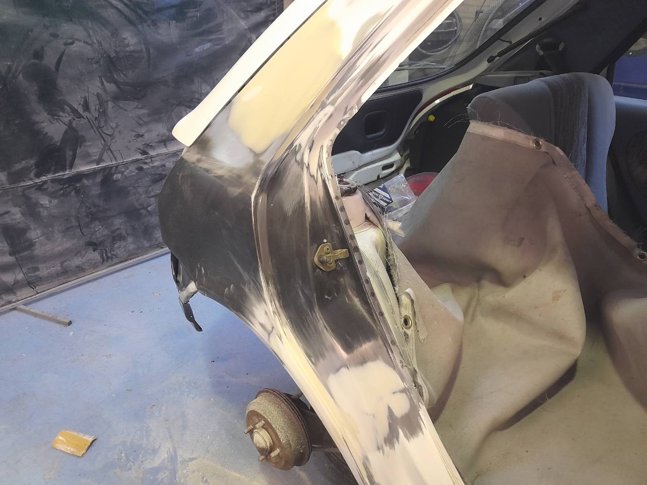

I put the spot welds back in the shuts
and the slopped some filler over the panel joins and sanded back

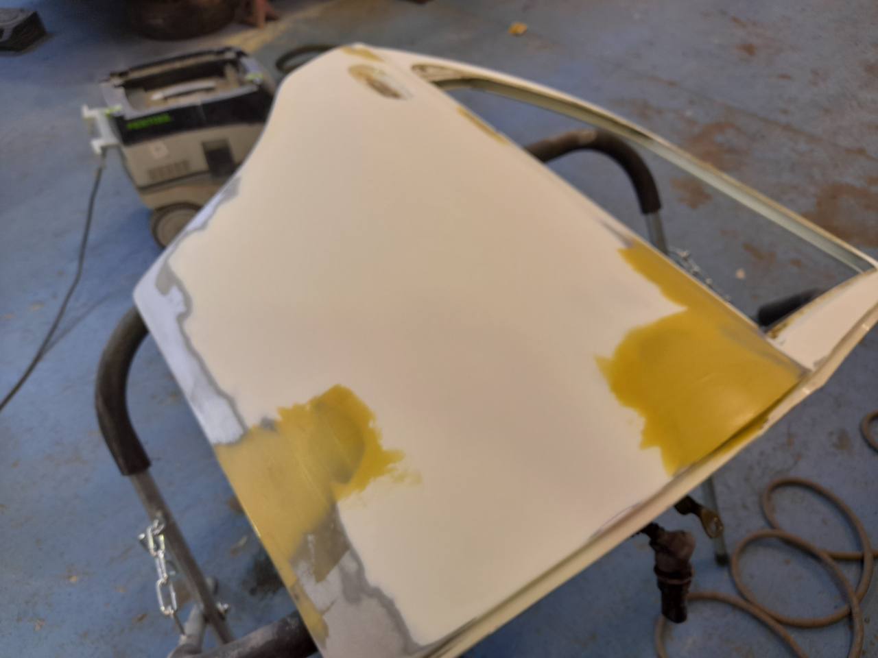

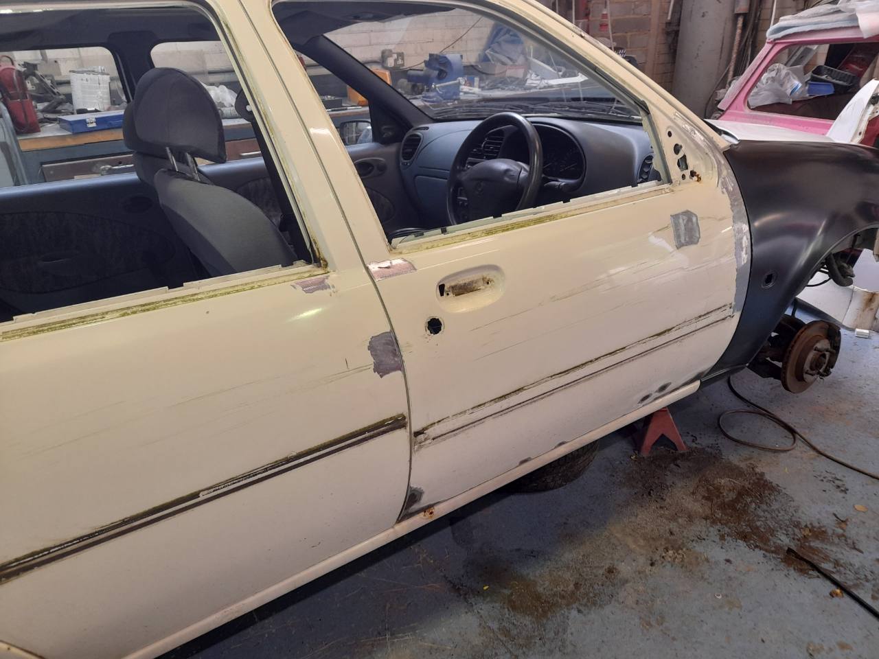

just the doors to repair now. The back knee just had some minor dents and scrapes but quite a lot of rust tracks under the paint along the bottom.
It's too late to save that permanently now as the rust will be in the fold of the door skin but a clean up and grind back should hold it off for a while.

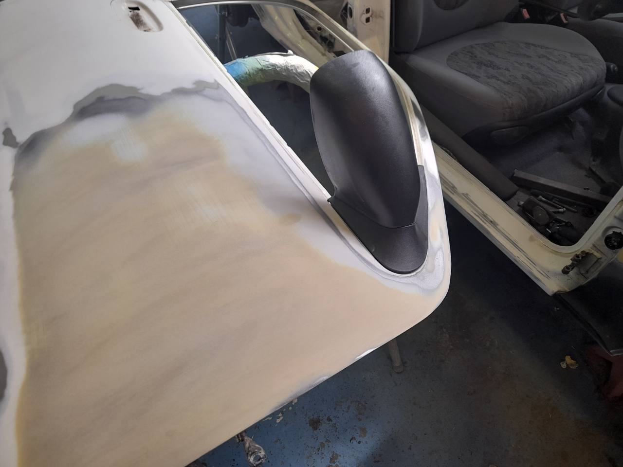

The front door was the worst damaged but nothing a quick pull and a skim of evercoats finest won't sort
the mirror is trial fitted there too as the old one was ripped off bending the mounting point. Figured I better try it for size after straightening it out.
Well that's the doors finished
the rest will have to wait till later today or tomorrow.

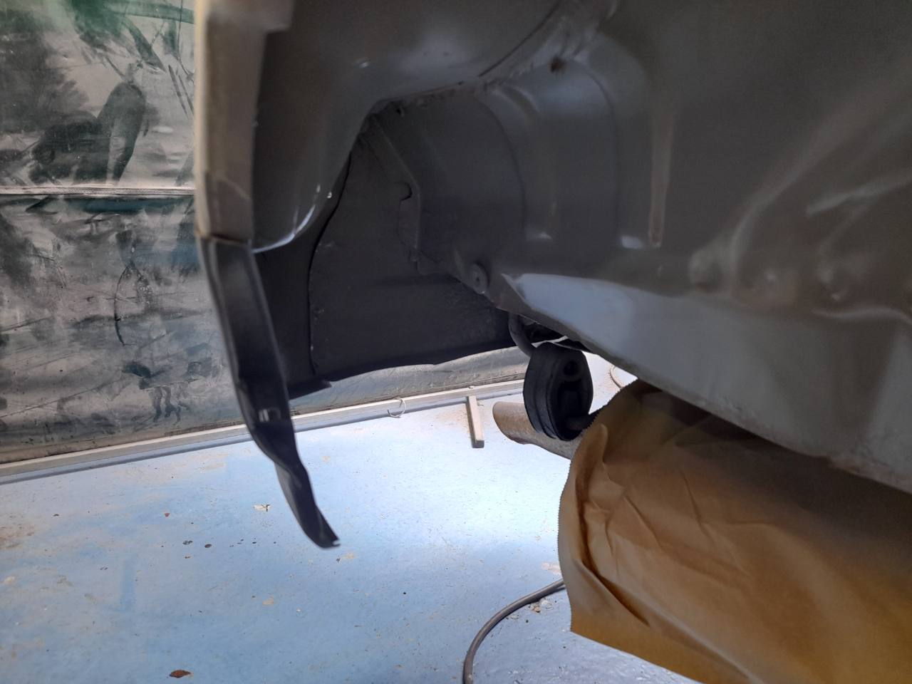

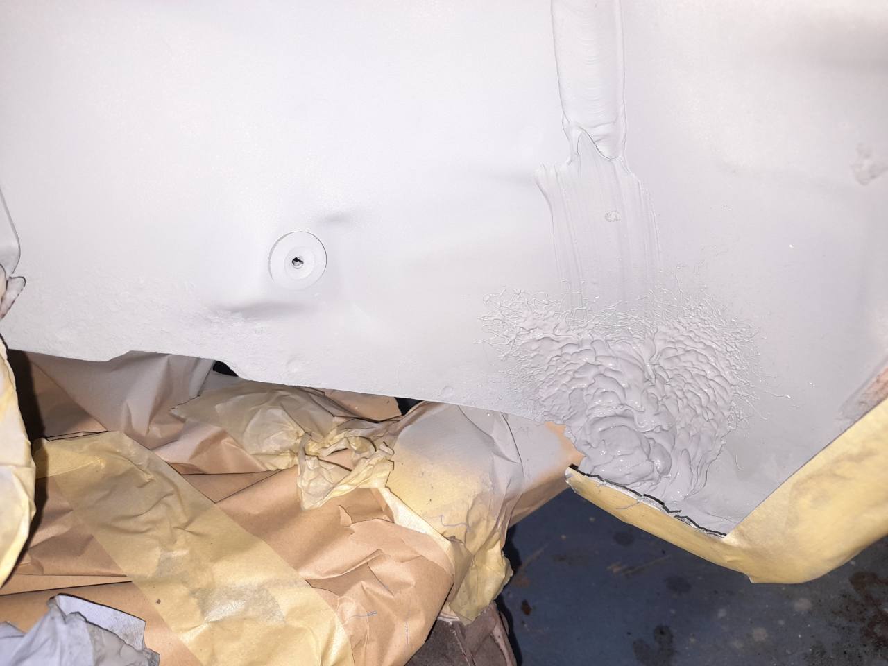

there was quite a lot of rust up in the rear wheel arch but all seemed to be surface rust so I cleaned it up and chucked some primer on it
And up on here too where the new quarter panel joined
and then sealed it all up
And a bit down here to replace the bit that came away with the flaky rust
And that's it ready to mask up for primer

Now ready for primer
