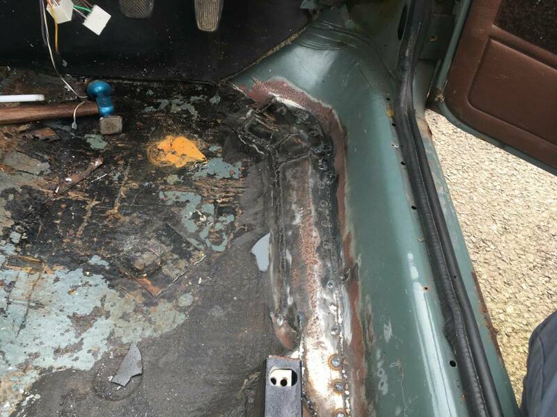

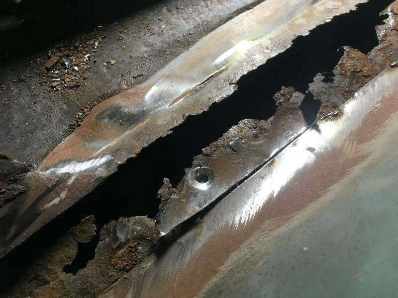

Rust Collector Posted April 25, 2022 Author Posted April 25, 2022 Zastava time then! I think it's been about a year since I pulled the interior out of this in order to check the extent of a rust hole I found in the floor pan. I've since done a pretty stellar job of putting the job off and finding other stuff to do, as I find welding one of the hardest jobs to start - you always end up having to do more than you think you will, and it takes time and sustained concentration. As a lazy, impulsive person it does not play to my wheelhouse. Still, in terms of making a show of getting something done since dragging the ZAZ home, I reckoned welding the floor up and putting the interior back in would be a good contender. So over the evenings last week I begrudgingly started to tackle this. Here's what we had then. It started as a small hole, but as we all know too well it just gets bigger and bigger as you chase solid* metal. The hole was as I'd left it after finding it, all I've done here is run a dremel round the top edge of where my patch panel will go. I drilled out the spot welds to the inner sill and then used a chisel to peel the remaining floor pan strip away. Daylight illustrates the hole best. Here the floor has been removed, and the inner sill is there in all its jagged glory: With an edge to work to I tacked in the repair panel then went back along and slowly built up a seam. The metal is not great, the usual fun of chasing holes in random areas presented itself a few times but we got there: Grind it back, find more holes: Holes blobbed with weld again, time to tack the other edges in. I then used the panel as a template to cut, then tacked as I went pushing the repair panel flush with the floor pan. I slotted the inner radius to allow it to fold in better. Fill more bastard holes with weld Peeling this away as I cut the floor pan out was quite satisfying All seam welded More grinding I really should have replaced the jagged edge on the inner sill at this point. I didn't though, as I had visions of cutting a small part out and having to go further and further to find something to weld to without blowing through. So I've cheated a little and I've left it with a view to do later* and seam seal it for now. I wasn't going to leave it flapping in the breeze though, so I set about spot welding it back to the floor pan. I decided to use the 'new' mig welder for this which from memory set me back about £40 from an old boy in Eastbourne. Once I worked out the settings I reckon it was quite nice to use The special alignment tool was used to keep everything nice and tight together whilst welding Job done, and I only blew 50 million more holes in it: Bit of zinc primer on top and chassis in a can underneath That scabby stuff doesn't disintegrate with prodding yet but I'm going to have to do something about it soon. I have a solid floor now at least! Whilst the paint was out I had a bash at this with some hammerite. Perfection was not the desired result, I just wanted to cover the orange bits: Good enough. Interior refitting time then. I needed to move the car first. Best put the spare on then... I'll put new rubber on it before it sees the road obviously, as these are from the nineties! They'll work for farm use though. Possibly. Flat tyre back in the engine bay for now, along with the filter housing: Then I could roll the car out for access to get the disgusting sound deadening in The rear bench went in next - I had a time removing it before as the release handle had come off the hook. So I set about repairing this, attempt one with a cable tie didn't work but attempt two with welding wire seems to have done the job for now. The carpet went back in at this point too. Aligning the metal strips in the door shut was fun*, as the carpet obscures the screw holes in the chassis. One problem that I've had with the interior is that the sound deadening on the passenger side bulkhead has gone saggy, and this means it falls into the glove box and looks really shitty. I tried to glue it before, but the fibres delaminated and it all dropped off again. I weighed up buying similar material and cutting a new panel, but impatience got the better of me so I came up with a much better idea... Lovely stuff 😅 That was where I left it last night, so hopefully this evening I can get the dash in and maybe even the seats and centre console. I have one small regret, which is that I didn't just chuck some of the paint from the garage over the primer. I may take the carpet up in the corner again soon if it weighs on my mind too much. Another small setback is that I've lost the only bloody key for the thing. Every other key is present and accounted for in the key box bar this one!! Fingers crossed it turns up, as I'm really looking forward to taking this for a run around the tracks once it's back together. uk_senator, ProgRocker, Shep Shepherd and 18 others 21
wesacosa Posted April 25, 2022 Posted April 25, 2022 Brilliant work. looking forward to seeing this progress. Would bloody love a 128 based Zastava Rust Collector 1
Fumbler Posted April 25, 2022 Posted April 25, 2022 Smashing work. I love that little car. Rust Collector 1
Bear Posted April 25, 2022 Posted April 25, 2022 This is where I got my Tavria's alternator regulator and brushes - they appear to have shipped them from the latest email and invoice... https://www.detava.lt/produkto-kategorija/rusisku-automobiliu-dalys/ Rust Collector 1
Back_For_More Posted April 26, 2022 Posted April 26, 2022 Great workon the floorpan......I'm in exactly the same frame of mind and with the same chasing holes doldrums...... Fair play fella it looks fine now - I need to get off my arse and get the passenger side finished. The fact the drivers side will certainly be the same, if nto worse, has me continuously putting it off..... The little V4 must sound glorious - that's something to look forward to! Rust Collector 1

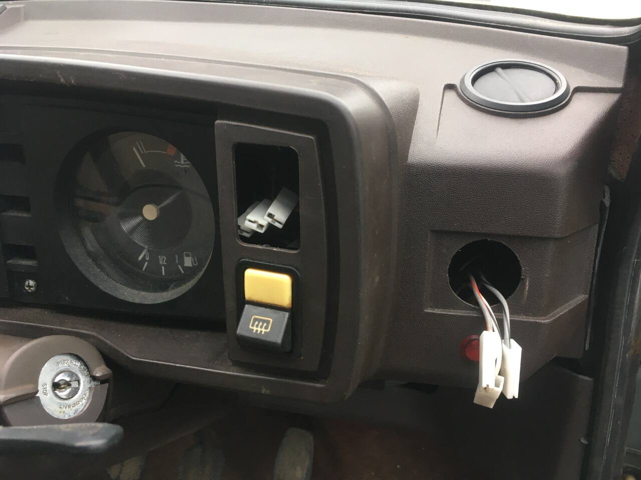

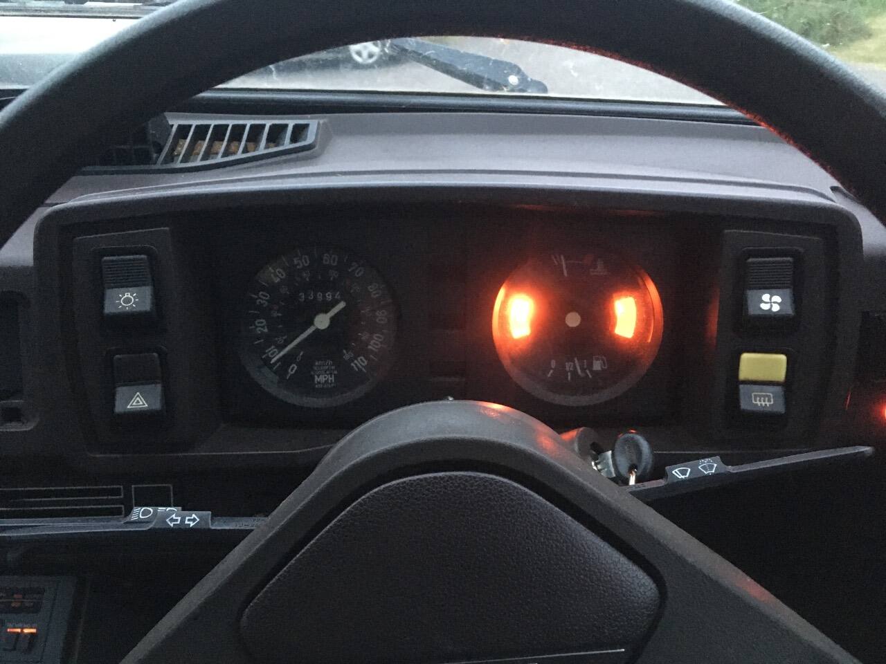

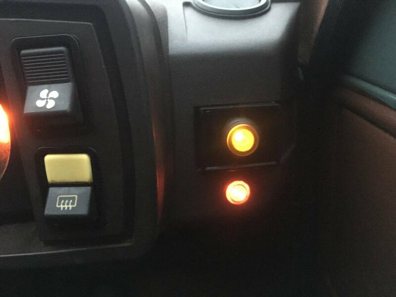

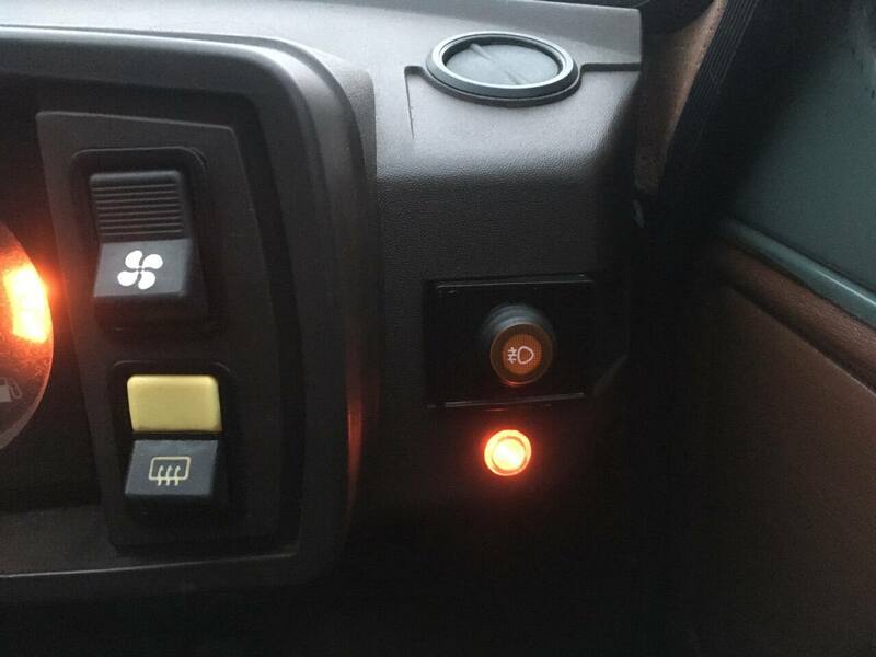

Rust Collector Posted April 30, 2022 Author Posted April 30, 2022 So back to the sustained effort to do something with the Zastava: the interior is finally in after a couple of evening’s work now. as you can see, I forgot the way a couple of the switches were wired up… that’s a job for the multimeter then. +10 points if you noticed that I fitted the headlight switch upside down also. better. When I got the car it was missing the fog lamp switch. I 3d printed a mount and fitted a similar looking switch from Car Builder Solutions. Efforts to start it were hampered by the fuel lines not priming. First thought was no fuel. Luckily my dad had just filled up the big can that he keeps for when the lawnmowers my chod collection need petrol. naturally the hose was missing… safety first! With that added I tried to prime the system by running it on easy start for a bit. A can later and we were still nowhere. I was at the point of disconnecting the supply hose to the carb and sucking out a nice drink of petrol, when I remembered that I had a vacuum pump in the garage designed for this type of thing. A few pumps and petrol was spraying all over the place, great success. With fuel in the lines she fired right up. After a little bit of time lurching it round the drive and stalling it, consensus is I need to clean, refurb and adjust the carb again, I should probably replace the points with the new* set I have, and I want to compression test it because I have a niggling thought of OMGHGF being the reason it got thrown in a barn in ‘96. LightBulbFun, RayMK, Dyslexic Viking and 14 others 17

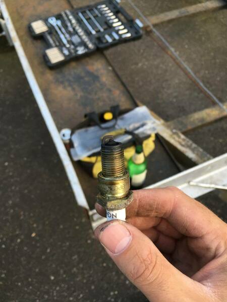

Rust Collector Posted June 7, 2022 Author Posted June 7, 2022 Right then, time for this thing: For ease of viewing, here's the spark plugs consolidated in the order that they came out: And the readings in order from the cambelt end: Oof. Number 2 looks a bit sad. With some oil down the bore it was no better either. I'll be pulling the valve cover off next to have a look at the hydraulic cam followers and make sure all the valves are doing what they should. However, tomorrow I'm at a trade show (for a change), in the evening my mrs is doing open mic night so I'll be at that once back from Watford. Thursday night I'm hopefully buying the Audi 100 so that evening is full. Friday night I'm off to pick up a second child seat and isofix base for impending babygeddon. Saturday and Sunday will be filled with Mercedes W211 fun*. So it probably won't be until next week that we see more of the Zastava sadly! At least we have an idea of why she runs so lumpy now... mitsisigma01, Fumbler, Dyslexic Viking and 7 others 10

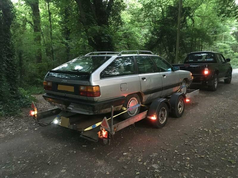

Rust Collector Posted June 10, 2022 Author Posted June 10, 2022 Well, maybe not quite 100 reasons, but it was cheap, local and I wanted one! As some of you may have seen in the news 24 thread, not long ago I was chatting to a mate about the best* family cars. I settled on a 100 Avant as being my ideal choice of family chod. This made me remember there was a cheap one locally advertised at some point. A trawl through my saved items in Facebook revealed that the listing wasn't marked as sold, but it was a fair while back that I first saw it! Amazingly, when I messaged the chap it turned out it was still available and I could go have a look. Viewing the car was a formality, as I had already bought it in my head when he said it was still for sale 😅 I need to go back and trailer it home next week, so I'll get better pictures up then, but for now here she is in all her glory: As it was so cheap I didn't waste much of his time whilst viewing it - he tells me it starts and I've taken his word for it. I had a half hearted look underneath and it looks pretty solid. Oil smells alright. Coolant is growing stuff. It has a boot full of spare lamps and hub caps. It has the roll out luggage cover which wasn't shown in the ad. He seemed a decent chap, and apparently the reason he hadn't sold it yet was because he didn't want it going to scrap. Apparently he had been asked a few time 'has this got the original cat M9?' and he's too attached to the car to send it off to be pulled apart. It went on ebay once, made £380 and then the buyer bailed. I'm setting myself a deadline of having this on the road by the time the baby arrives, stay tuned to see me focus on literally anything else but the task at hand and miss the date completely. Coprolalia, fatharris, wesacosa and 18 others 21
Dyslexic Viking Posted June 10, 2022 Posted June 10, 2022 Great choice of family car. Rust Collector 1
Back_For_More Posted June 10, 2022 Posted June 10, 2022 I love these estates - a local quattro version came up from a farmer I know but it needed a clutch doing and I couldn't face forking out the price he wanted and then another shedload on a clutch replacement...... The fact it had spent years as a farm vehicle didn't inspire me too much either TBH. Looking forward to the progress....... How's the Zastava getting along? Rust Collector 1
stuboy Posted June 10, 2022 Posted June 10, 2022 last time i saw one of these it had reversed into my mk2 cavalier sri, crushing the wing and headlight Eyersey1234 and Rust Collector 2
Rust Collector Posted June 10, 2022 Author Posted June 10, 2022 Cheers folks 🙂 I was really pleased to track this down as I was convinced it would have gone. My grandad and uncle used to run Audi 100’s when I was little so the nostalgia is huge for me with this car. 1 hour ago, Back_For_More said: How's the Zastava getting along? It’s down compression on one cylinder, so this weekend I’d like to get the valve cover off to check to see if there’s any problems with the valve train before biting the bullet and pulling the head off the engine. Once it runs smoothly I just need to give the brakes and front suspension a once over and then I’ll get her in for a ticket. If she passes, she’ll be put on daily duties to give the Insight a rest 😅 Dyslexic Viking, mk2_craig and wesacosa 3

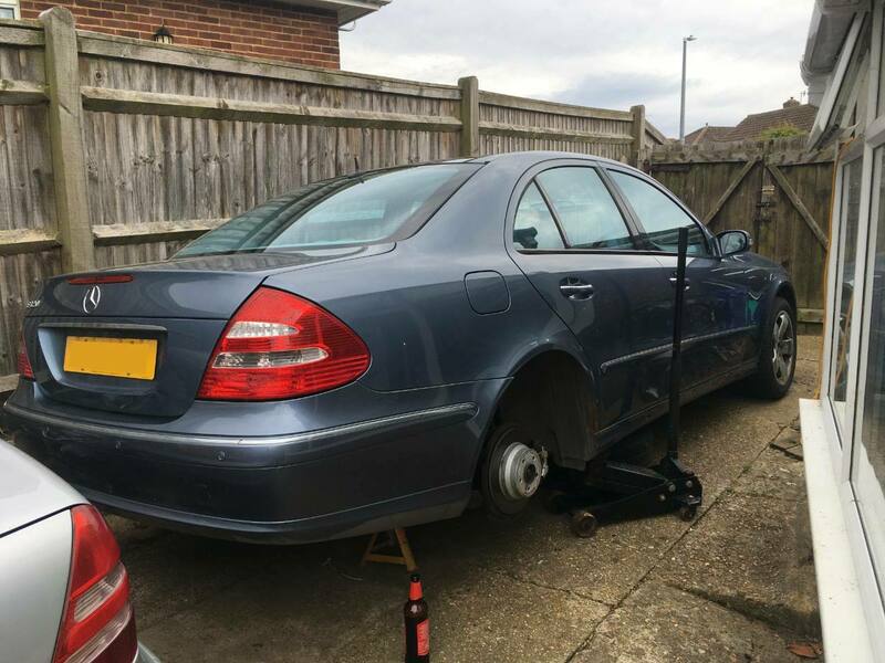

Rust Collector Posted June 16, 2022 Author Posted June 16, 2022 Right then. First a brief recap of where all my time has been lost to; my Dad's Mercedes W211. I've now replaced all 4 brake lines on it, and I just have the welding left to do. I have managed to dump it back up at the farm, and I've also tucked the Subaru up in the corner, meaning that I've managed to do the old switcheroo and leave an additional car up there unnoticed*. I of course have not got around to taking the valve cover off of the Zastava. I did go over to the Surrey Hills last night to collect this vehicle of outstanding natural beauty. The chap's house was in the middle of the woods, he was a nice bloke and he said he'd owned several of these. As I mentioned previously, he explained that it had been advertised for so long as he didn't want it going for scrap, and he hadn't had any buyers for it as a project. That should probably tell me something 😅 Loading was fun. It wouldn't fire up, and I didn't want to take up too much of his time so I just moved it on the starter. With a seized rear wheel. Progress was slow and lurchy. Add in the rad fan that runs constantly when the battery is connected and it turned into a fun game of 'will we get loaded up or will the wiring catch fire'. A mix of winch action and starter motor abuse got her in place, and predictably just as I got towards the front of the trailer she fired up and tried to lurch off, luckily I was half expecting such luck so I was already hovering on the clutch and brake. Unloading was even more fun. To avoid owning up to my excellent purchase, I was taking the car to the tool shed I share with a mate. Whilst trying to unload, the starter bogged down and I couldn't get her to shift. Bad memories of the grounded out blue BX of recent trailer misery started to resurface. Looking underneath I could see that the mid section of the exhaust had dropped down and was trying to wrap around the trailer chassis. No photo I'm afraid as it was dark and I was shouting swear words at everything. Obviously this was when my partner called to ask why I wasn't home yet, which raised my spirits greatly 😅 Second best course of action then - park everything close to home, go to bed, deal with it in the morning. Sounds good to me! Got out of bed early this morning, called work to tell them I'm WFH as my partner had her 20 week scan today and I wasn't going to the office for an hour just for the sake of it. Best put everything on the driveway then. You can't see so well in the picture but the opening is about a foot wider than the trailer, the driveway is an incline and the road outside is a curve. From memory I've only chucked the trailer in here by hand whilst it was empty before, but despite a little apprehension (the fence belongs to my neighbour and I feel it would be bad for relationships if I smash a trailer load of chod through it) I reversed it in happily enough. Not got loads of pics yet as I'm in the office now, but here she is in all her trailer stranded glory I love the rear roof line on these, they look ridiculously proportioned just like all good* estates should. At some point I'm going to chuck a couple of ratchet straps under her to get the exhaust pulled up enough to remove her from the trailer. I'll probably pull the BX out the courtyard and then use the length of driveway available to get the Audi off the trailer and behind closed doors. Not sure if I'll get anything done this eve though, as a) I need to spend time with my partner to make good my most recent misdeed and b) I need to have a few beers in the garden to de-stress from last night. And I want to put it on public record that this is absolutely, definitely, possibly the last motor I buy without getting clear of something else!! Shep Shepherd, Fumbler, AnnoyingPentium and 8 others 11
