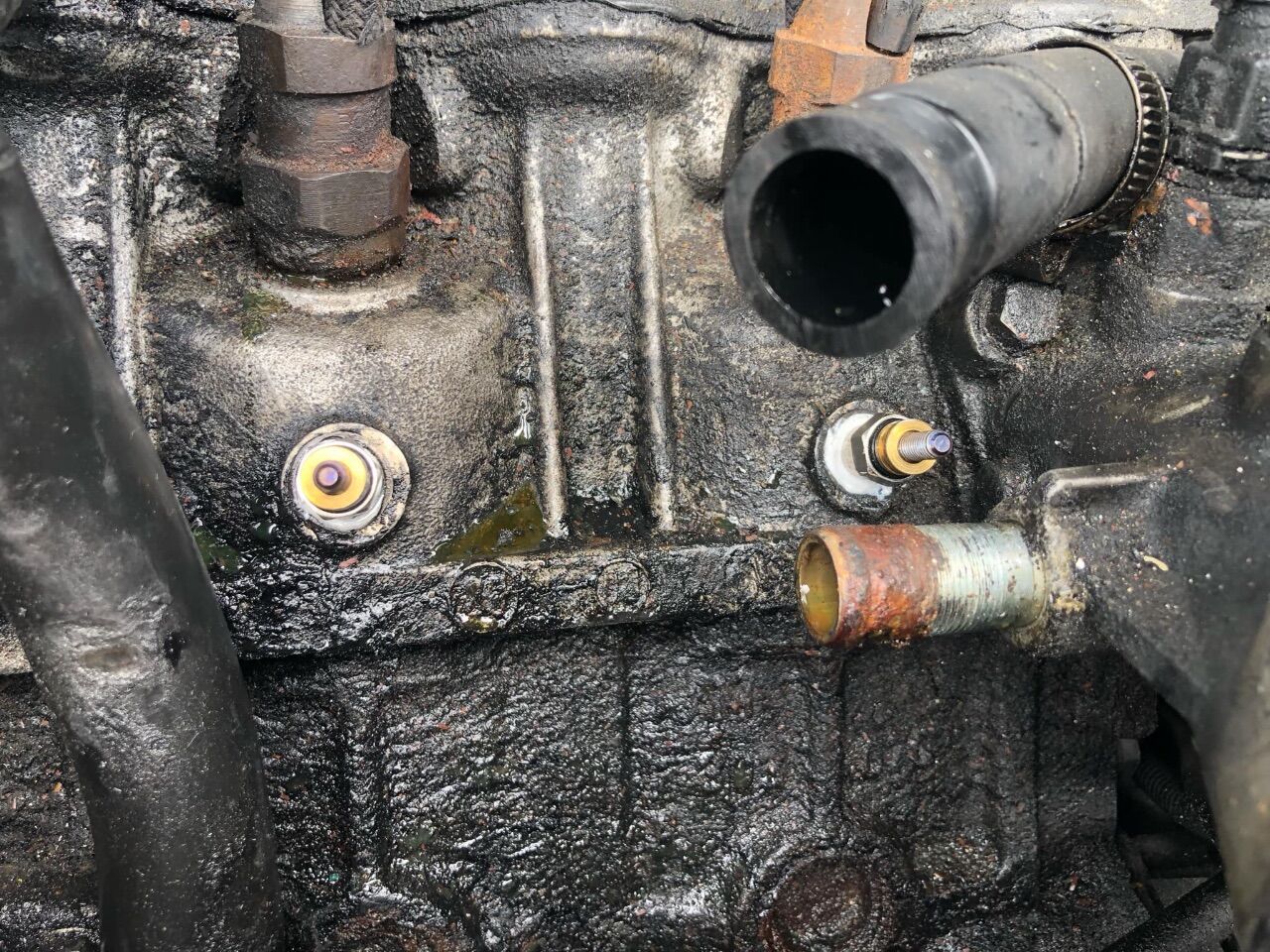

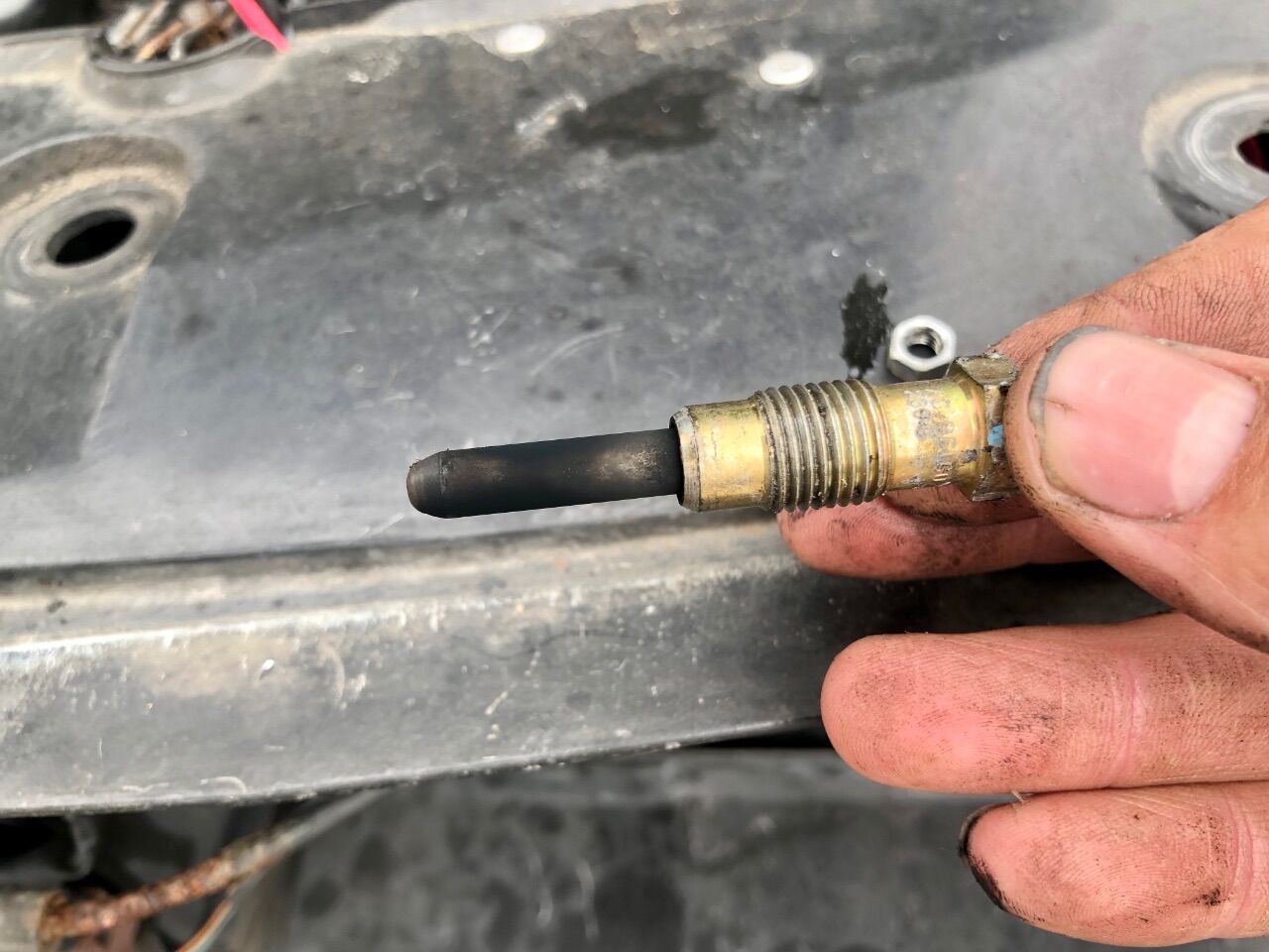

Whilst I had the XM’s engine largely stripped down I took the opportunity to go a step further, and removed the glow plugs and tested them. They’re marked as AC Delco and weren’t the cheapest, but I suspect they were knock offs now as they are shite, 10 seconds of 12v and they’re barely red. Either that, or the bad pump timing killed them.
I had another cheapo unbranded set in the garage - not ideal, but would do in a pinch. I tested them, and they all glowed cherry red at the tip after about 5 seconds. I chucked them in, with some ceramic grease in case the next owner needs to pull them back out.
Over the course of the evening I threw the car back together enough that I could start it. I’m so used to stripping this down and putting it back together now 🤣

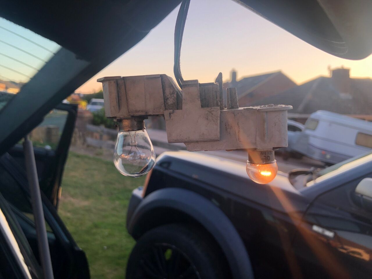

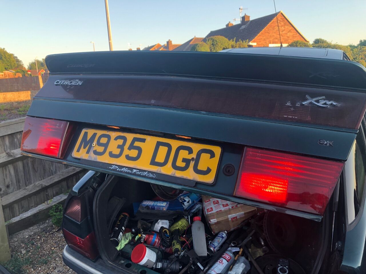

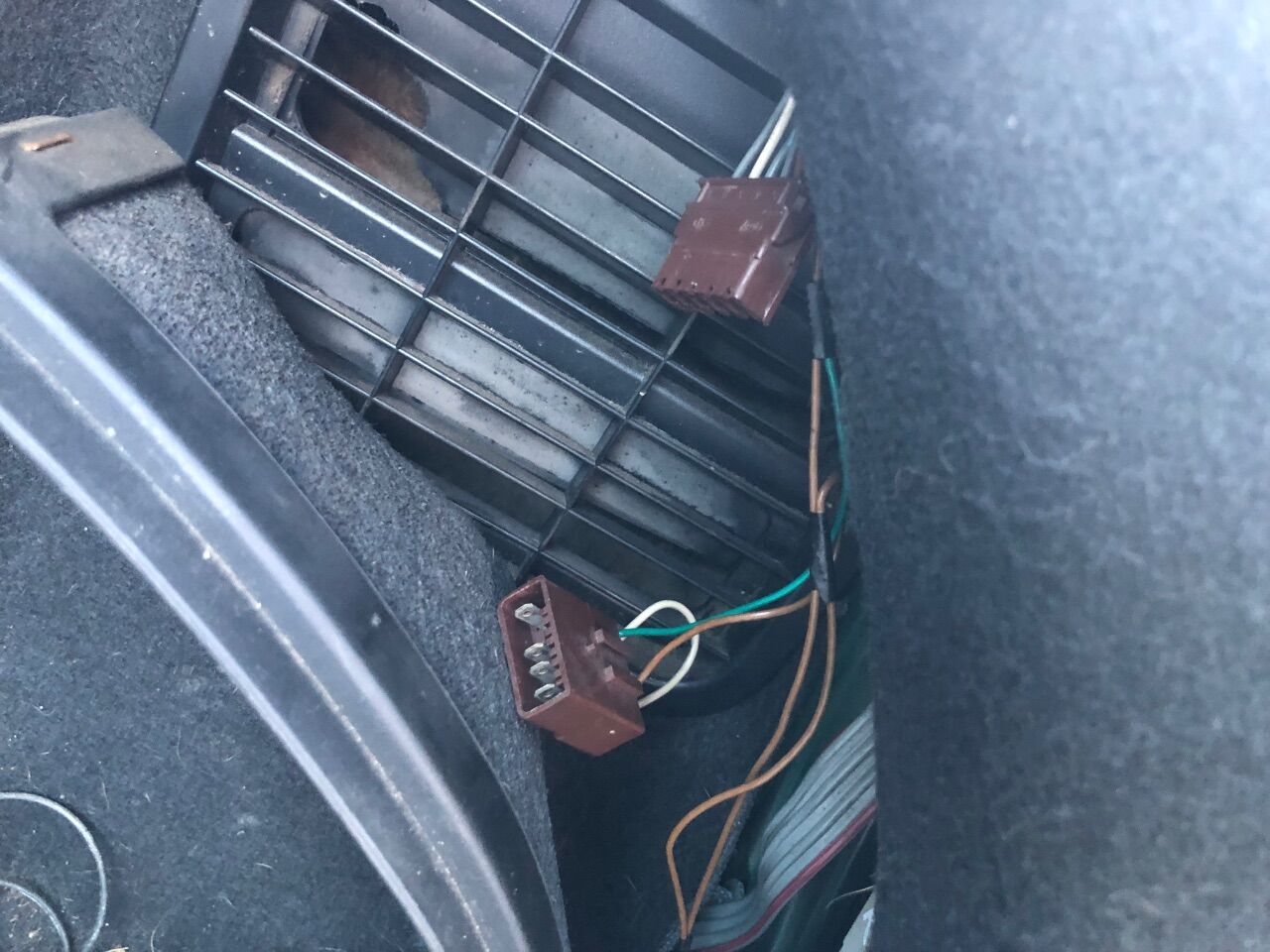

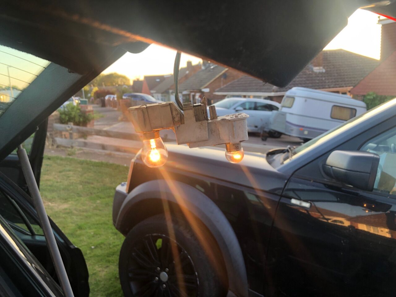

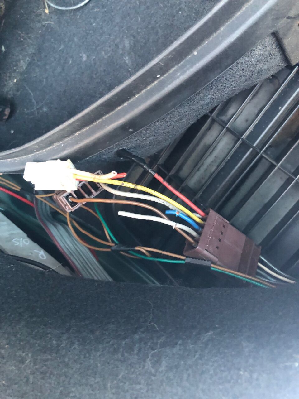

Today was an office day, and then I had to look after the kids up until their bed time. I wanted to get something done though, so I had a pop at the fog lights.
A bit of prodding and poking revealed that the switch worked, the tell tale on the dash and switch were on, the fuse was good, but both fog lamps were not illuminated.
We can of course discount blown bulbs, as it wouldn’t be that simple and they’re never used anyway so the chance of them both burning out is slim. A poke with the multimeter confirmed that we did not have 12v at the bulb holders.
Must be a problem in the loom then.
The go-to would be either the flexible section near the boot hinge, of the tow bar wiring. I remembered that the tow bar wiring was spectacularly shit, and I had ripped a lot of it out.
So I went to where the tow bar jumper was still plugged in.
That doesn’t look good, does it. Using the multimeter I was able to determine that the broken blue wire is the fog lamp feed, and it should go back on itself through the grey cable.
I pulled the jumper loom out and plugged the original plugs back together.
Thats more like it.
Job done:

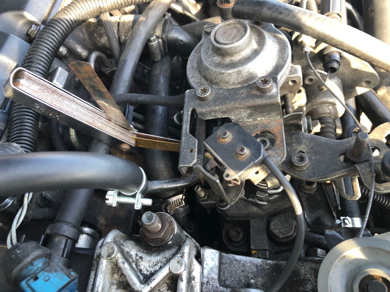

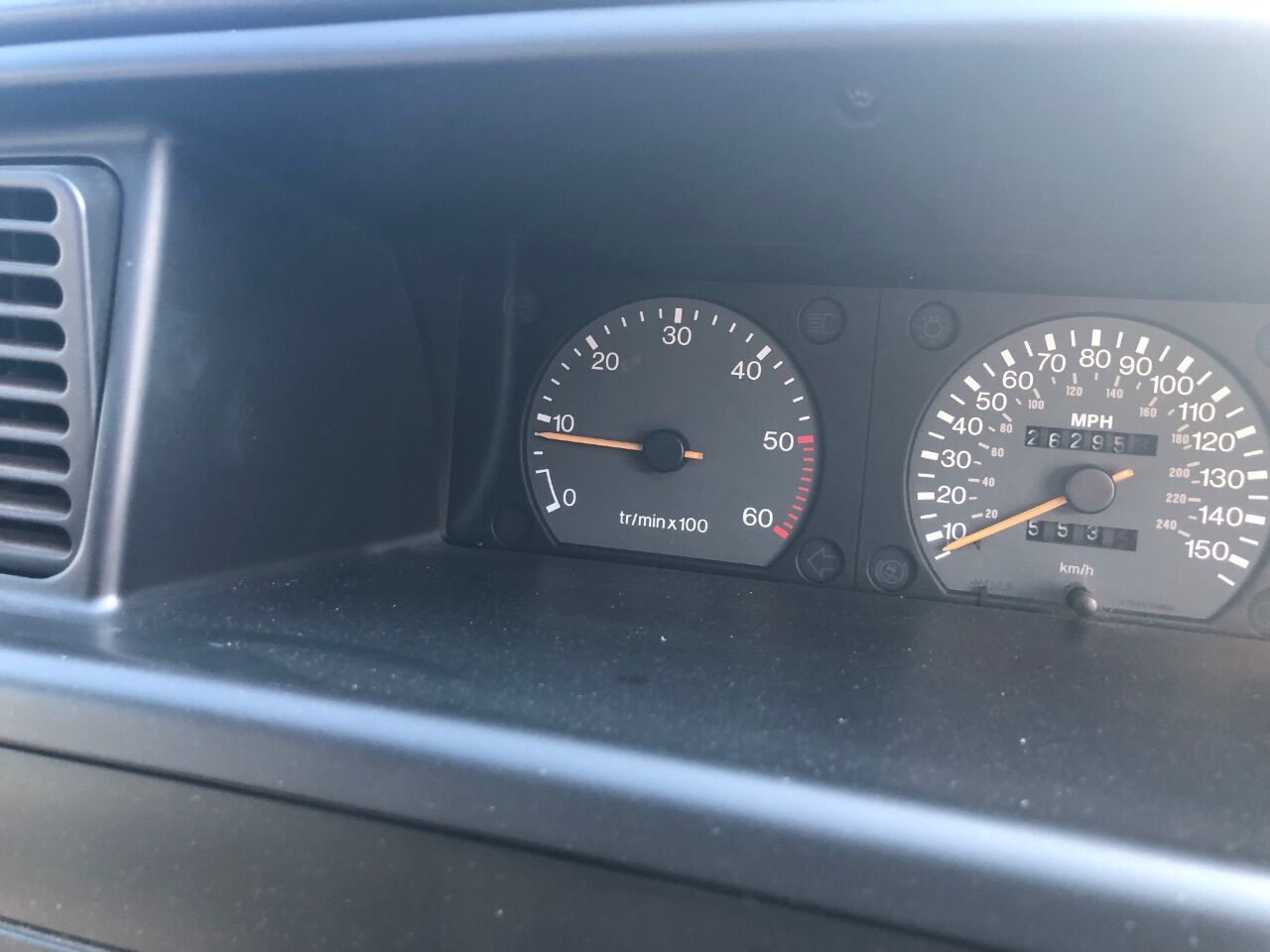

A bit more tinkering has been achieved this evening.
I backed the anti stall screw right off, removed the throttle cable and wound the idle screws out. Then I wound the ‘max fuel’ screw out until the engine was struggling. It’s not exact but it gave me something to work with as a first go.
I then set up the cold and warm idle screws to get to roughly where the service manual says it should be - warm idle pictured, cold idle is roughly 1,000rpm
Setting the anti stall screw requires a bit of fucking about with a feeler gauge.
Apparently a 1mm shim between the anti stall screw and the throttle lever should give a 20-50rpm increase.
Looks ok to me. The puff of smoke on startup is gone, and the engine sounds a bit smoother. I can’t make any noticeable smoke by blipping the throttle. The throttle response feels glacial compared to how it was setup before though.

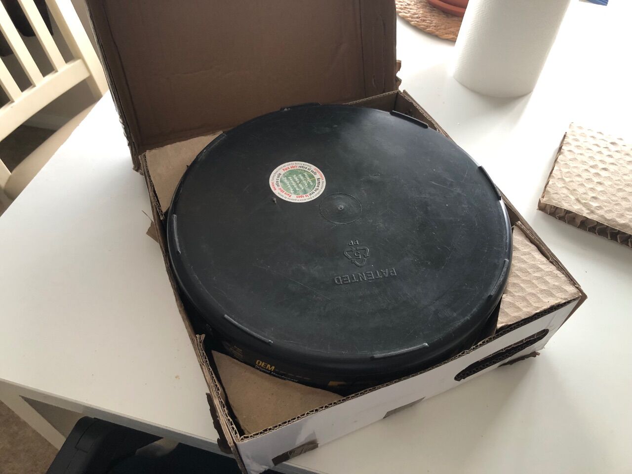

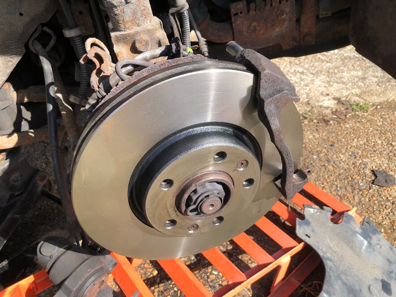

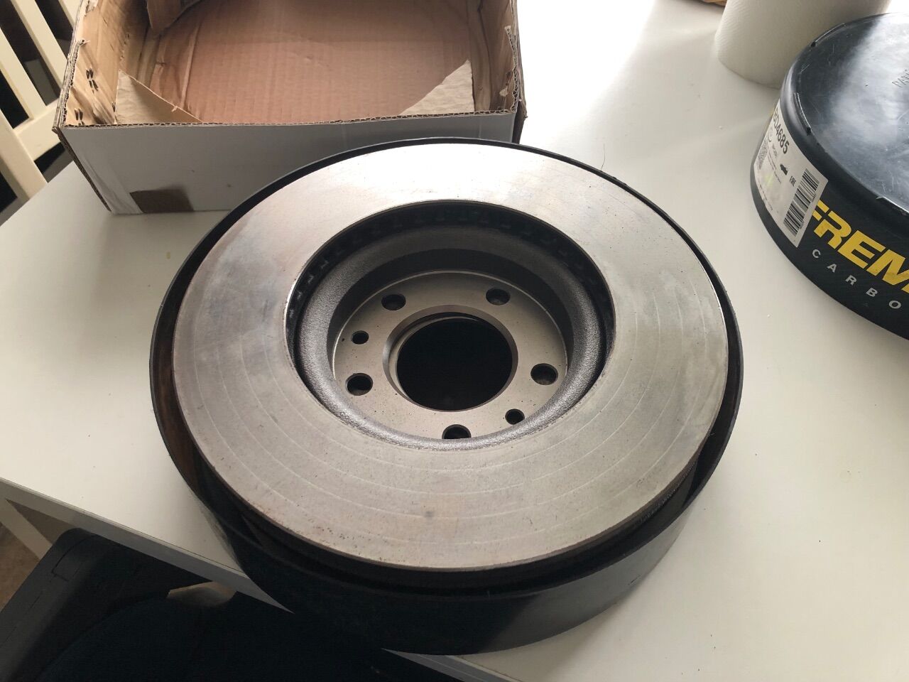

The brake discs have landed. Fingers crossed that I got the right size this time.
I’ve not seen them supplied in a plastic tub before!

I finished the brake work off yesterday - no pictures I’m afraid as I was just in a ‘get it done’ mindset. I also adjusted the parking brake cables whilst I was there, and the parking brake seems a lot better. I won’t mention it to the tester though, as fuck giving the car another opportunity for re-test disaster. Here she is back on her wheels for the first time in a while:

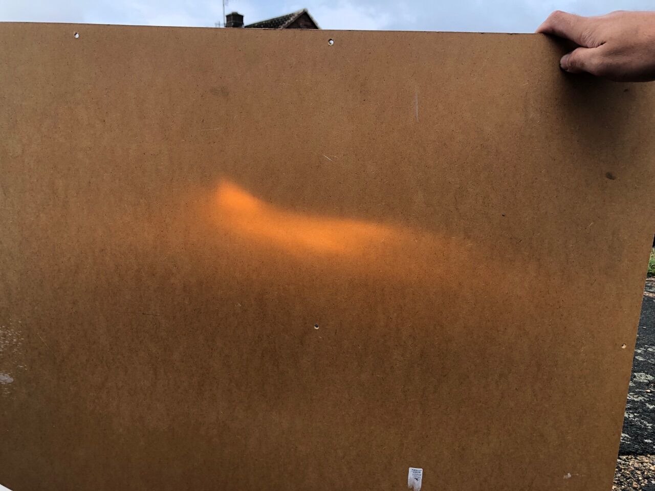

You’ll notice it has no headlights still, this is the last piece of the puzzle. The one which I didn’t manage to break the beam pattern lens has gone back together, and is on the car. Beam pattern* is as thus:
It has the kick up, but it’s still properly wank - I hope it’s good enough. I may try new bulbs, just in case the old filaments have sagged or shifted perhaps. I know XM’s do have a rep for absolutely shit headlights though so I don’t know if I’m just pissing into the wind.

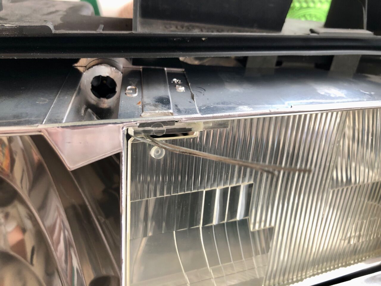

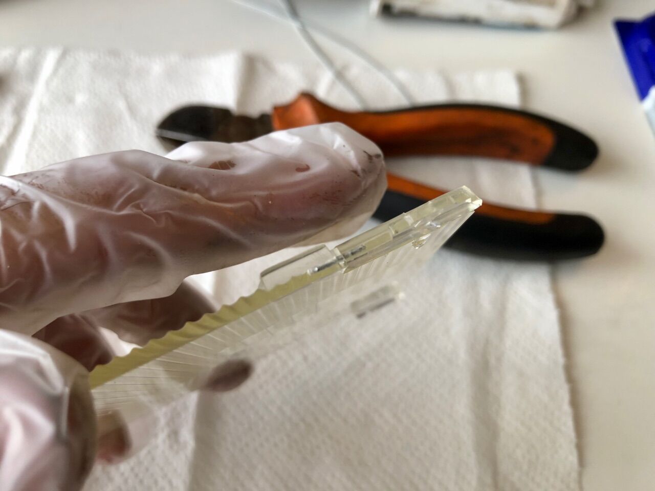

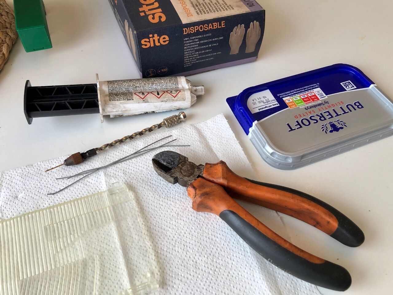

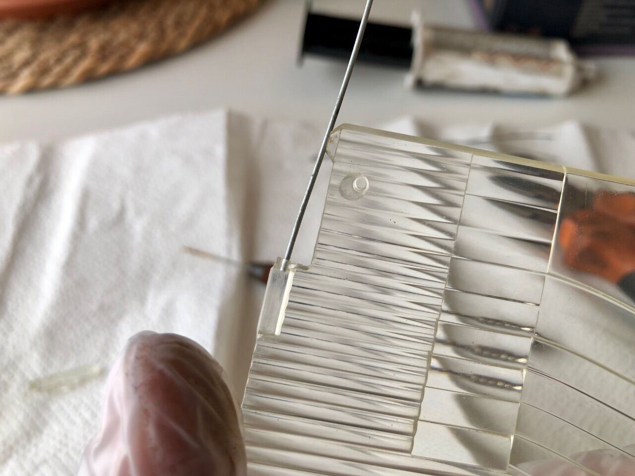

Moving on the lens I broke then.
Can you see what I’m thinking?
Ive carefully put some araldite into the hole and joint. The purpose of the wire was twofold: registration and strength*.
I decided to fit the lens whilst the araldite was curing, and I’m glad I did as it revealed the need to adjust the spacing of the tab a bit so it holds firmly to the lamp unit. I’ve left the wire in whilst it cures, hopefully that will allow it to set in the correct position.
The downside is now I have to wait for the bastard stuff to set before I can put the car back together.

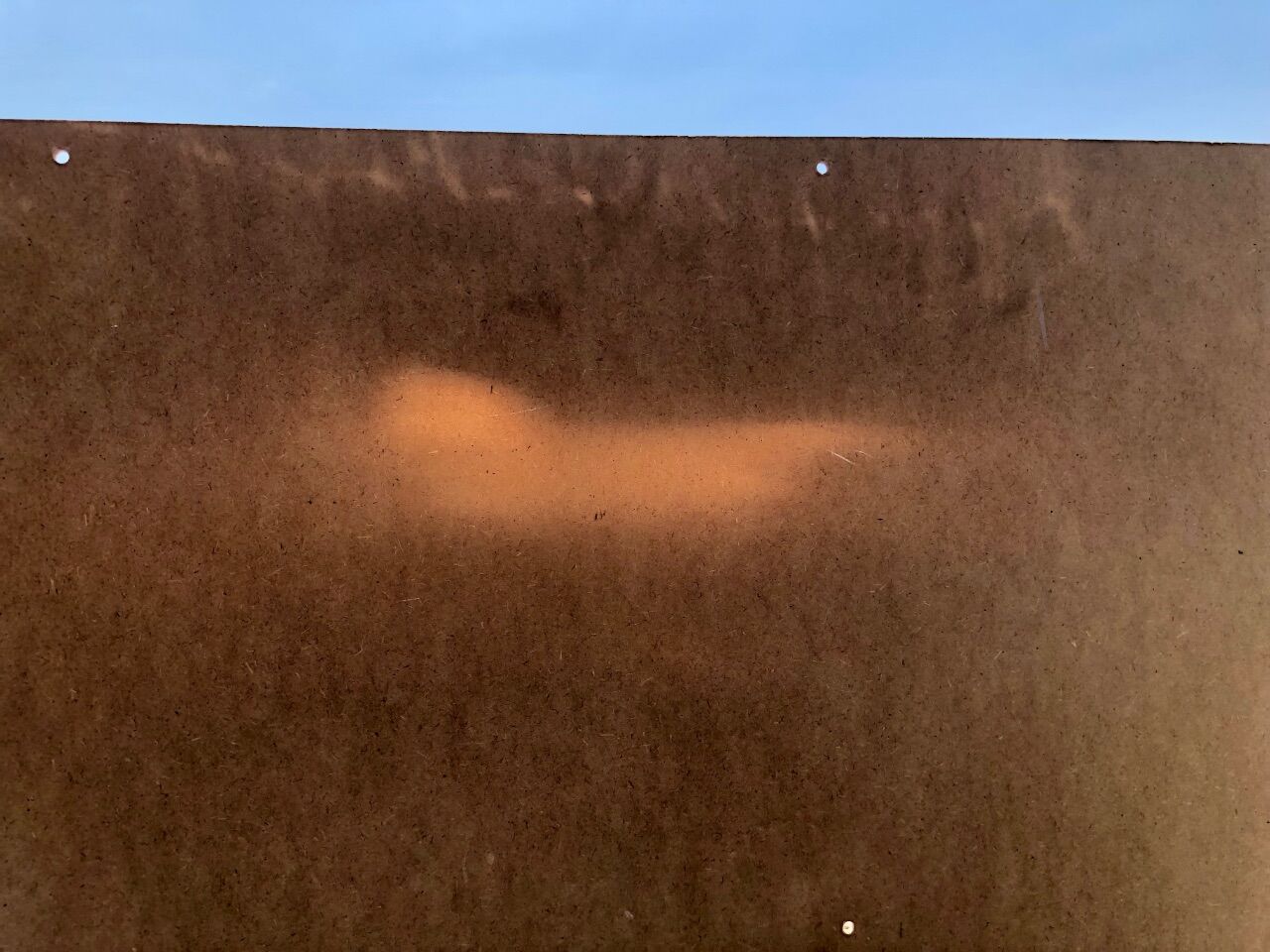

Beam pattern* on the side I repaired.
Again, no idea if it’s good enough. Fingers crossed.

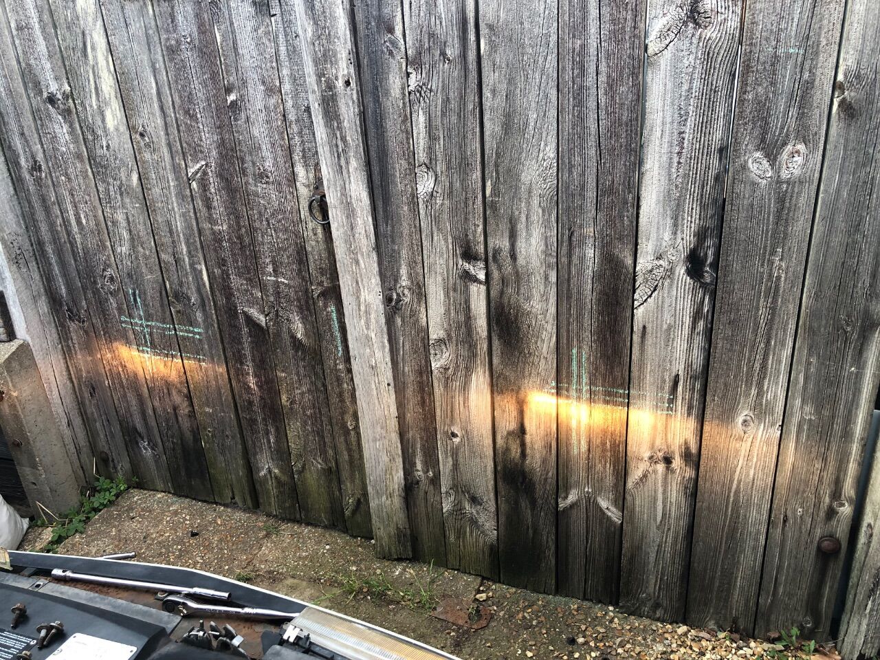

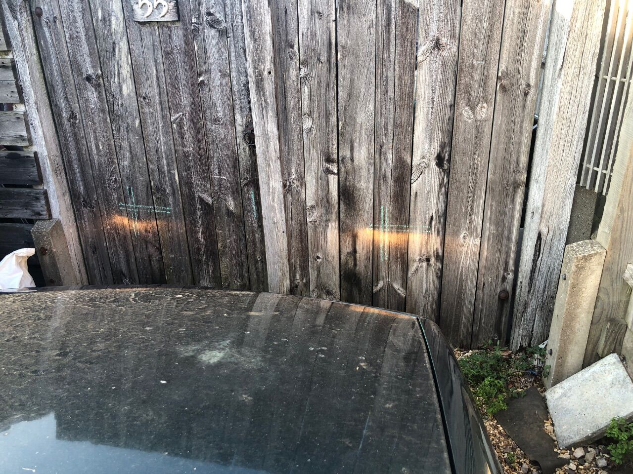

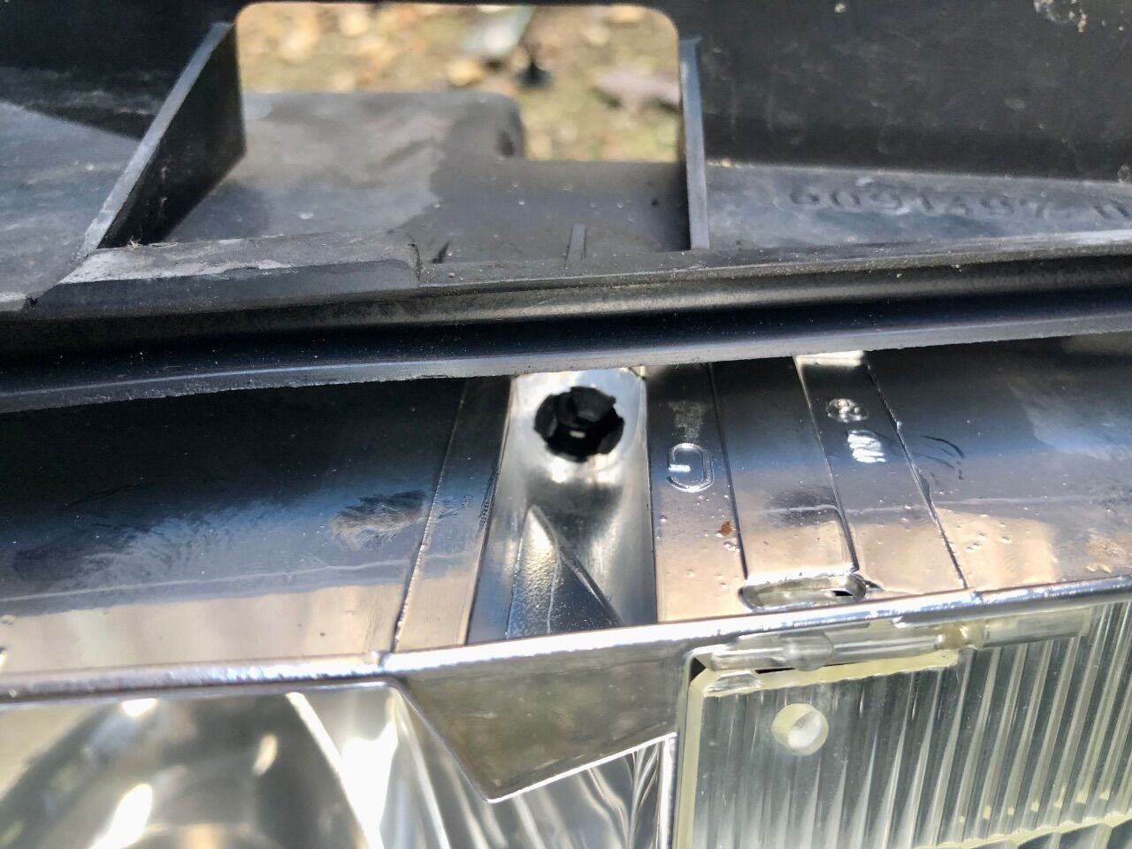

It’s MOTmas eve here at chateau rust, and the last job on the XM list is to check the headlight aim.
Luckily I have high tech alignment equipment at my disposal.
It’s lucky (I’m unsure if that’s the right word anymore) that I did this, as it revealed that the passenger side had a lazy eye due to the adjuster popping off.
That meant taking the front end off for the millionth time, taking the headlight apart for the second time, and putting it all back together.
I then did my measurements PROPERLY, like I should have done the first time around, and noticed that the two sides of the car aren’t level. I’ve allowed for this, and now after much drawing with my children’s chalk we are set to somewhere that is possibly correct... ish.
I mean it looks like there’s a pattern, so I’m fucked if I know what can be done with those it fails on the lights again.
