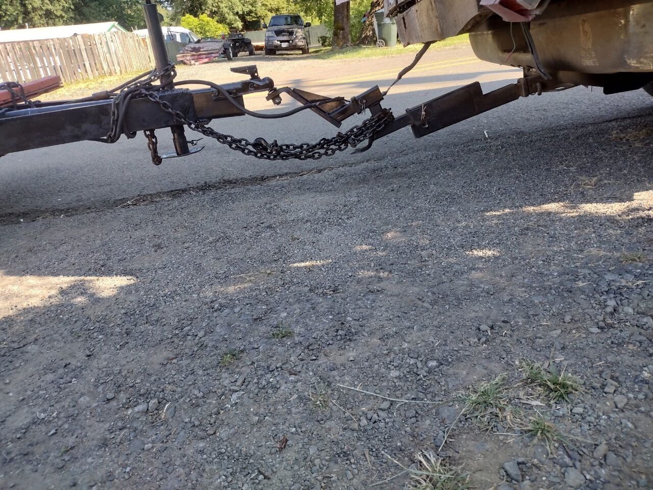

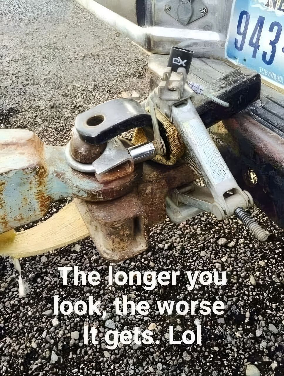

Three Speed Posted June 8, 2025 Posted June 8, 2025 horriblemercedes, Barry Cade, Dyslexic Viking and 5 others 8

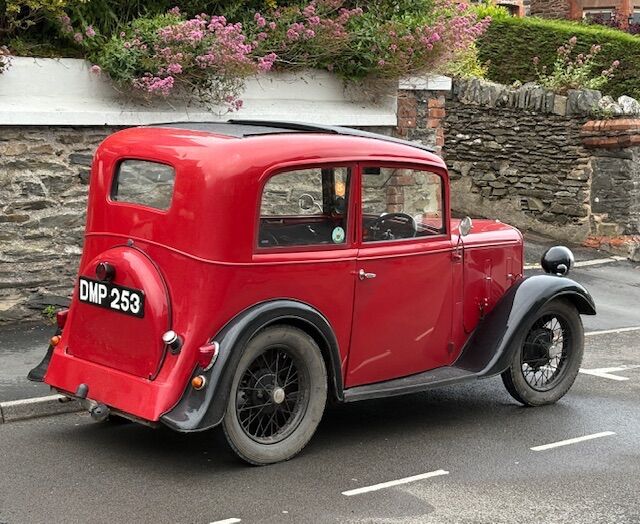

groovyboovy Posted June 8, 2025 Posted June 8, 2025 spotted whilst on holiday in Malta Barry Cade, sdkrc and High Jetter 3

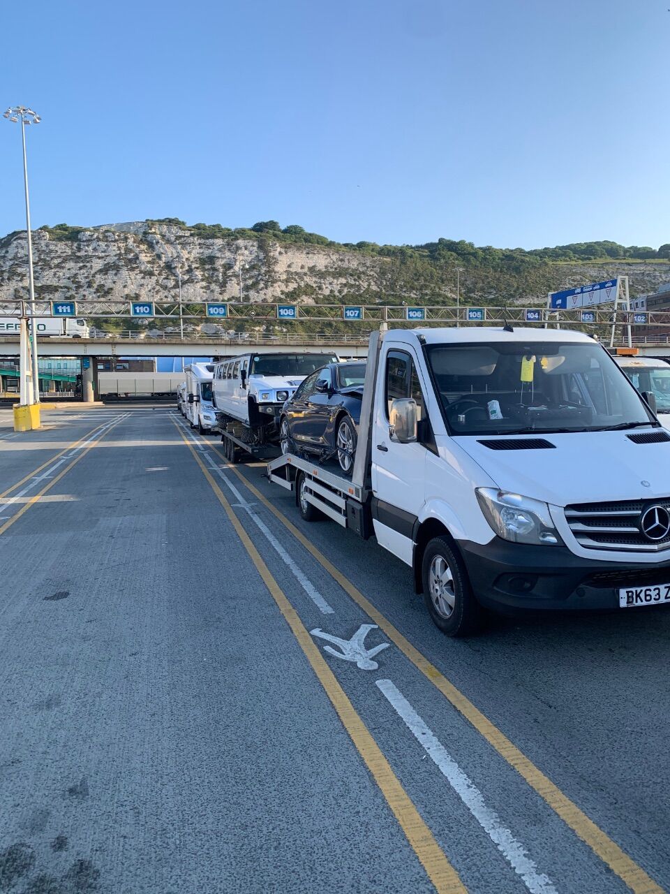

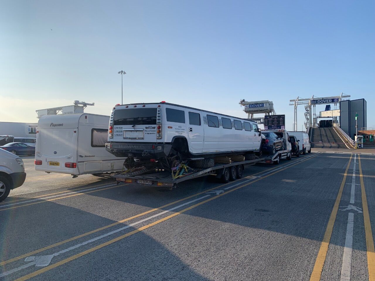

St.Jude Posted June 15, 2025 Posted June 15, 2025 Possibly not for here, but this is in front of me waiting to get on the ferry. Dyslexic Viking, sdkrc, Barry Cade and 4 others 7
Rocket88 Posted June 15, 2025 Posted June 15, 2025 1 hour ago, St.Jude said: Possibly not for here, but this is in front of me waiting to get on the ferry. That’ll get about 4 yards on British soil before being stopped by plod
St.Jude Posted June 15, 2025 Posted June 15, 2025 4 minutes ago, Rocket88 said: That’ll get about 4 yards on British soil before being stopped by plod This is in Dover leaving the UK! Rustybullethole 1
Rust Collector Posted June 15, 2025 Posted June 15, 2025 5 minutes ago, Rocket88 said: That’ll get about 4 yards on British soil before being stopped by plod I’m pretty sure that’s a picture of it leaving British soil. *Edit - beaten to it!
Rocket88 Posted June 15, 2025 Posted June 15, 2025 2 minutes ago, St.Jude said: This is in Dover leaving the UK! Blimey…. I’m amazed he got that far! Don’t know what Les flics will make of it! St.Jude 1
