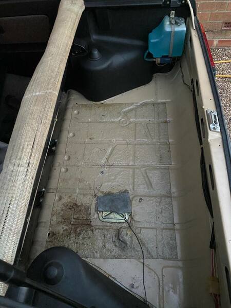

Only just caught the MoT result, and it's good to know it's as clean underneath as it is up top.  Disappointing on the old emissions side of things but I'm sure you'll get that sorted out.

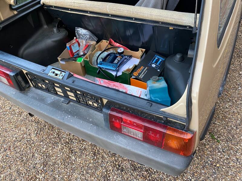

It has genuinely only done 1,000 or so miles - any problems with it are due to 'minor mishaps' or 'age', like the tyres which I will replace before using it in anger, or the gas strut hole in the load cover that I am sure will have happened like this:
Open boot. Won't move because strut is stuck. Push. Strut pops out of cup and hangs free. Get on doing other stuff. Jammed strut suddenly and explosively deploys, piercing the parcel shelf and thankfully not someone's body somewhere.
I know this because said strut did something very similar to me - I removed it compressed, put it down on the floor, forgot about it, and it suddenly catapulted itself. The new struts mean the boot closes and opens really nicely, too.
