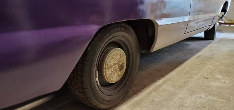

Just found 3 of these in the undergrowth.
I'll keep looking for a 4th.
I have a pair of 1980s Plymouth dog-dishes left over from my Gran Fury.  Sadly only a pair though.  Not much help, sorry.
I have a feeling that's the case with these. 3 there because one's gone.
Buuuuuut, it does show that look is a good case of "yes please". Shame, those ones are aluminum and would polish up nicely.
Phil

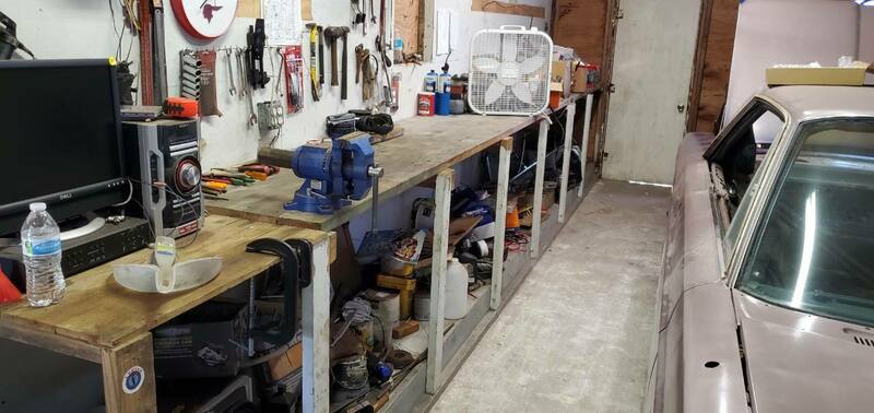

Just tidied all that mess up in the garage. Ready to make more.
Phil
