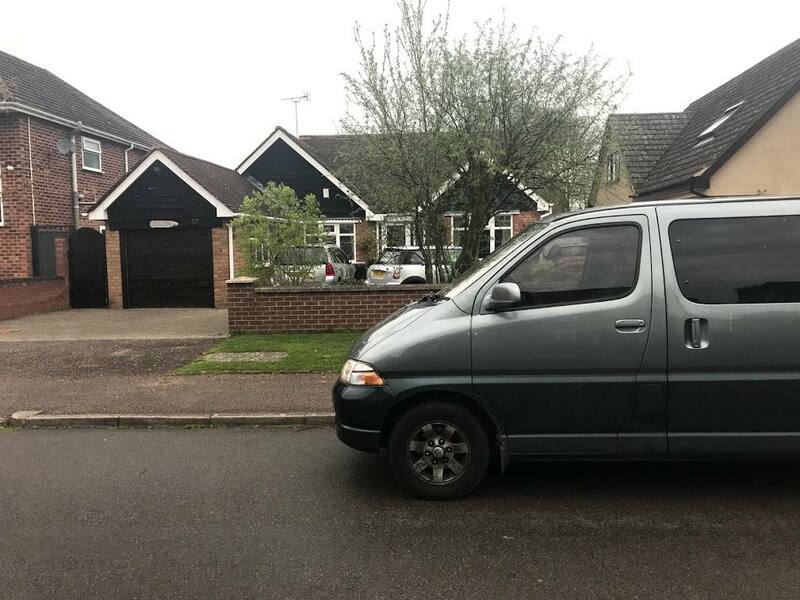

This is ours when we bought it back in 2014.
And, quite randomly, outside Hyacinth Bouquet's house.  You're welcome (!)

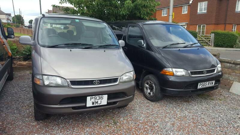

This has got to be a rare sight two of these old girls side by side.
