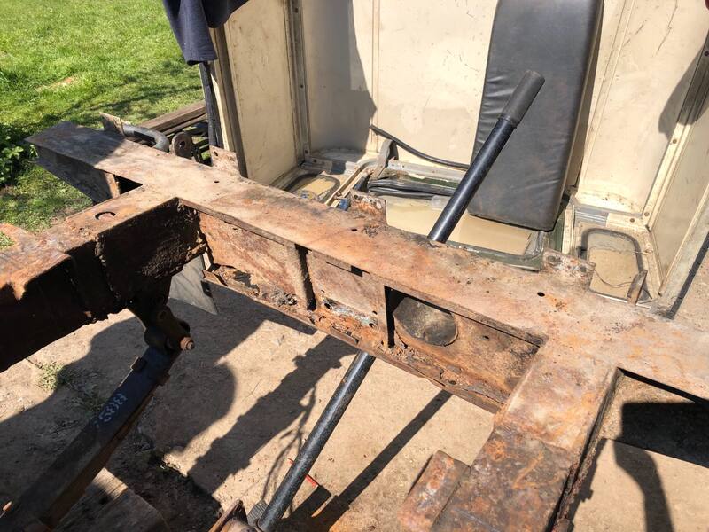

My Land Rover is MoT exempt, so I am responsible for its roadworthiness. I was aware that the chassis was getting a bit crusty, but it seemed strong enough, it towed a two ton trailer earlier this year, retrieved a Hilux Crew Cab out of a ditch and towed my Dad's Land Rover to the menders (see Ask a Shiter). This last expedition, undertaken unwisely using a tow strop rather than the more mechanically sympathetic (and legal) towing bar spelt the final straw for the rear crossmember. See below, note the angle of the tow ball.
The bottom of the crossmember and the last four or five inches of the main chassis on one side were also dubious. Luckily one of my bestest mates is an car bodywork repairman, with elite welding skillz so we decided to give the whole thing a closer examination, just to make sure a new chassis wasn't required.
Things started sensibly with the removal of the roof, which thanks to laziness and previously snapped bolts was held on with only a handful of fasteners so took about ten minutes to remove. We then got a bit carried away.
Surprisingly the chassis wasn't that bad. Bear in mind the last time the chassis had seen the light of day, the Beatles were busy breaking America and Cassius Clay hadn't changed his name yet. We did find some comedy welding though which I'll photograph for posterity.
I've ordered the replacement chassis parts and a few odds and sods, but it should be a quick* and easy* repair job. I might tart it up a bit with some new parts too and respray it to annoy those annoying people who use the word patina a lot.

To be honest, I did toy with the idea of a new chassis and may well acquire a galvanised chassis and bulkhead for mine when I have room to store them, but I reckon I can squeak another 30 years out of my current arrangement, by which time I can probably have it modified so that it can fly like the cars in Back to the Future 2.

If I had a pound for every time I've taken the body tub off a Series land-rover to do chassis work like this...       I'd have most of a tenner.
Still, massively easier than welding up frilly car bodywork.  S2 Chassis are beautifully easy things to work on, even if you need to break out the grinder for every. single. fecking. bolt.
Be aware of cheapo chassis sections.  I've heard stories of them not fitting very well at all.  Most of the work I did was fabricating my own repair sections, so fit wasn't an issue.  The comment above about re-fitting the body tub to get the alignment of the tub correct is a very good one.  It does then mean taking the tub back off again to weld it properly, but that's relatively straightforward and worth it to do the job properly.

The worst bit of the chassis was the rear crossmember. It looked shit as did the welding. It has to be said the welding showed no signs of having failed despite having been done back in the mid 80s. Anyway, having unbolted the rear springs and done some perfunctory measuring the grinder got broken out and the 35 year old crossmember got dispatched to the scrap heap.
The crossmember was replaced by a quarter chassis which also got rid of some dubious looking welded plates on the main chassis rails. As recommended the new part was tacked in place then the rear tub was refitted to see how it all went together. At this point my mate who was actually doing all the welding decided to fix sixty years of Landrover tradition and insisted on adjusting the doors so they closed like the doors on an Audi.
My mate also moved the front tub mounts which someone in the long distance past had welded on the piss.
This was the chassis at the close of play, although the underside hadn’t been welded yet.

He’ll be most gratified to hear that. Such a super bloke, and a bit of a renaissance man, he designed my house extension too.
Update. The welding on the rear of the chassis is complete now moved onto the passenger side bulkhead outrigger. In the meantime I got excited and started removing more bodywork, mainly to access the chassis but also to see how ropey the bulkhead was.
There were some rotten holes in the bulkhead but they seemed very localised and the structural bits were sound so a bit of stitching and a replacement footwell should do it. 8EC5A259-7088-41CD-960F-BDB7F2666F97.thumb.jpeg.41ec84f5e196f9ca4fa9fb05b14bd411.jpeg
The metal of the main chassis had become locally weakened due to the state of the old outrigger so a new plate was butt welded into the underside of the rail. A big hole was cut in the chassis rail to accommodate the outrigger and the mounting plate which was then spot welded in and seam welded.
Looking good! Now for two localised areas of rust on the opposite rail and that’s the chassis all done. Easy when you know how. Luckily I know someone who knows how.
