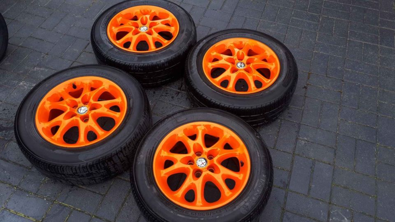

djoptix Posted April 12, 2021 Author Posted April 12, 2021 Might sell the wheels to recover some funds and put these on it, thoughts? DON'T WORRY, I"M JOKING The Moog and Marm Toastsmith 2
