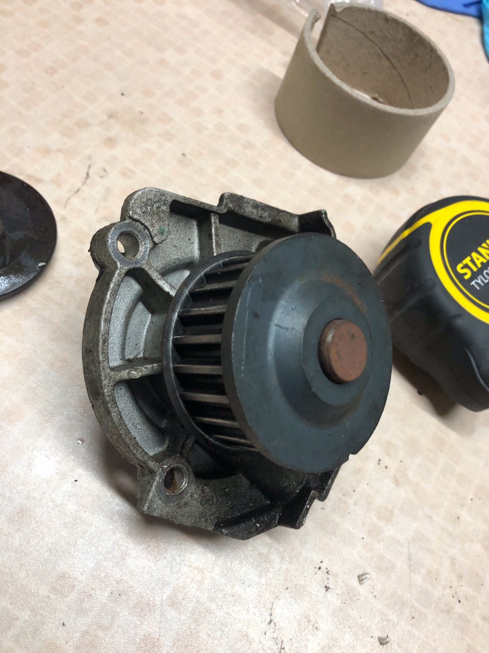

The car itself is in actually good condition for an Italian race car however the main issue of noise and a lack of heat was due to something quite interesting.
Ladies and gents - I produce for your viewing pleasure, the water pump from it.
54951808-A47C-459A-836D-8BA3C54D3DC3.thumb.jpeg.77a55b672f28b3dbad1e23b597e2d265.jpeg52FE55EF-742B-4A06-84F2-019A81A3EBA5.thumb.jpeg.3e900723110535172e1633e7a7be8e85.jpegD6A98889-EF9D-4B1B-93A0-1643A48B7624.thumb.jpeg.b0f01dd1e04316364f4b5eaa0d931b6c.jpeg
I’m astonished it wasn’t overheating..
heres the new and old beside side each other for comparison.

Yowser.  How badly scored-to-fuck is the pump housing?
Funnily enough it’s fine looking. I think it’s been like this for some time. When I drained th me coolant I couldn’t even see any debris in it. I dread to think where the remains of the water pump are tbh
That deserves a place in some special museum of automotive WTF, seen the impellers crack and/or slip on the shaft but not wander off and grind themselves to death.
Was the old one metal or plastic impeller? Did you investigate where the rest of it ended up?
I’ve had a quick root around and flushed some pipes but nothings coming out. I suspect when I get round to re-filling the coolant I’ll find out if the matrix and/or radiator is blocked. Unfortunately I’m a jubilee clips short of sealing the coolant system at the moment.  (up yours weird band style water hose clips)

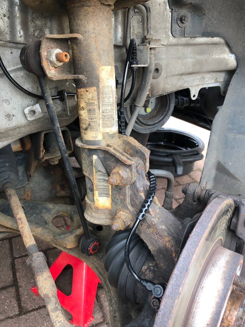

Good news on the abs front. Suspecting it was wiring I stripped the plus at the abs Ecu and the plug in the wheel well. Everything was fine.
The abs sensor on the wheel hub had the audacity to literally come straight out with only minimal swearing and no drilling. Shocker.
New ABS sensor fitted (Bosch oem) and we have readings again at that wheel and no fault codes.

Jesus, how does a water pump even get like that!?!? Those faces are nicely ground
I know.
Predictably the coolant has gone dark very quickly. I’ve flushed out what I can. Given nothing clearly been circulating for some time I’ll let them run it for a month or so then drop it back in for another coolant flush and a service.

The type on the right, with the smaller impeller which sits 1/2" proud of the pump body, seems to be the more common. They obviously don't need much cooling.
Impellor looks to be aluminium or pot metal alloy, so the shavings will have anodically protected* the insides by dissolving.

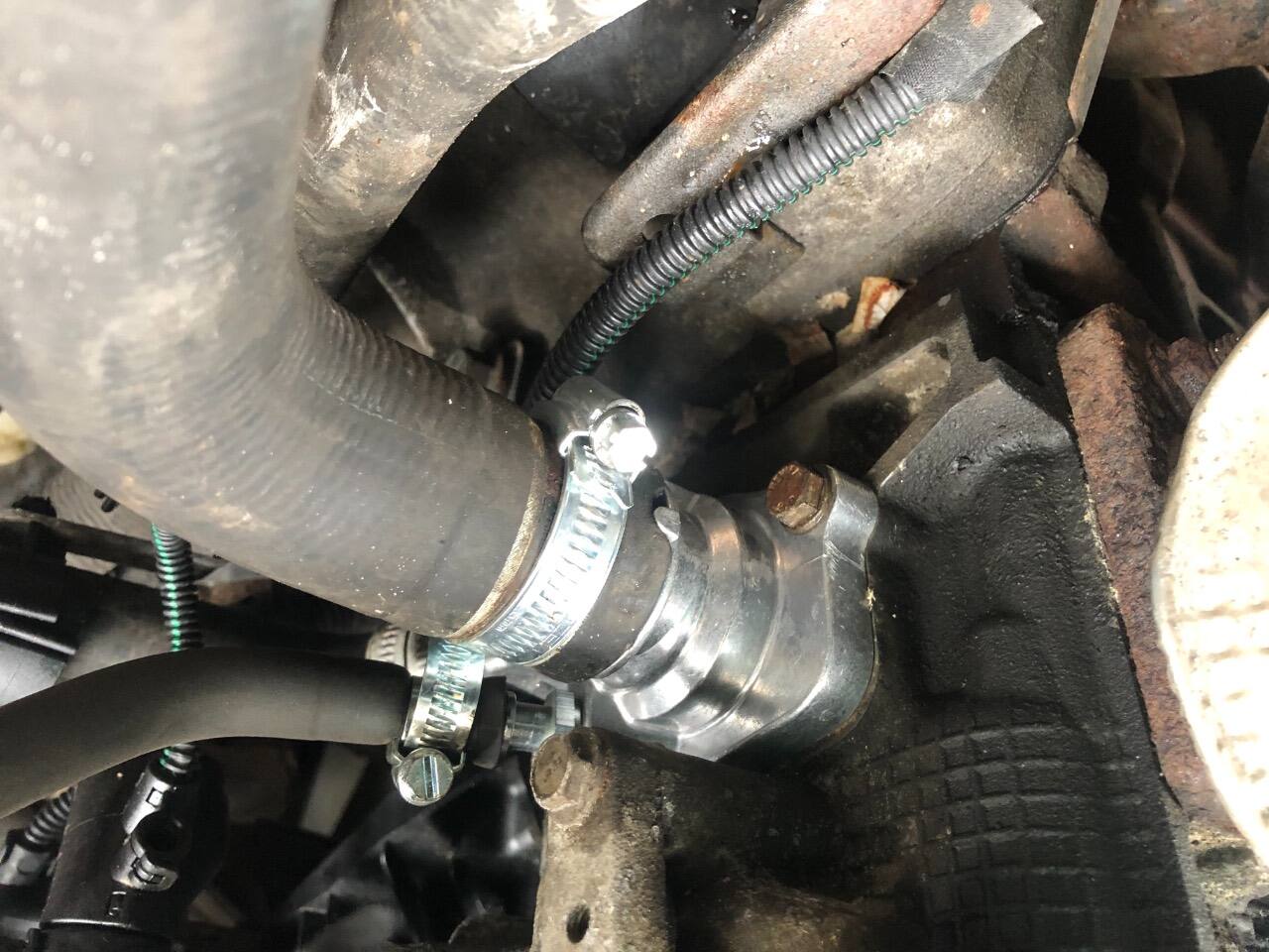

That water pump looks more fucked than the local prostitute 🤣
6D68024A-1CEE-4E51-B195-EBEEACB9A557.thumb.jpeg.7a77106defaa95206694d3c0baed195b.jpeg9F125DC1-CC5F-497A-A52C-4CF6768C0F89.thumb.jpeg.a236941bfb9d937c972f4454802a350f.jpegAnd here she is all cleaned up nicely ready for wheelies and the like.
We’ll see how long she lasts before she returns to cowboy motorsport for more tinkering
