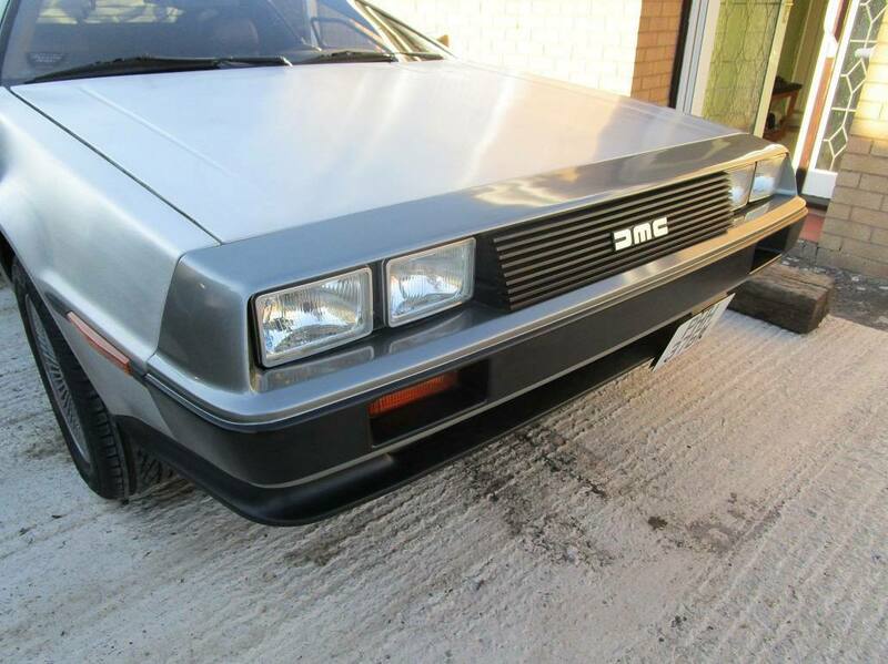

Justwatching Posted July 17, 2021 Author Posted July 17, 2021 Transmission fluid and filter changed and rebuilt governor computer installed. It drives much better (i.e. not holding onto gears), but it's still misbehaving. It's actually quite erratic. Transmission appears to slip in second gear, but only sometimes. I don't understand it. It climbed a long and steep hill with no slip at all, but when I tried accelerating from 30 MPH to 50 MPH on flat road, it slipped big time. I have to either back right off or hoof it harder to get it out of the slip. Also seems to have 'episodes' of shifting up and down repeatedly when rolling down after hard acceleration. Help! Oh, and here's some pretty pictures. Ian_Fearn, Dave_Q, Scruffy Bodger and 12 others 15
Justwatching Posted August 17, 2021 Author Posted August 17, 2021 I've been driving the DeLorean and learned a bit about more about its problem. The transmission is fine when cold, first problems show up after about 4 miles at which point the shift from 2nd to 3rd become more pronounced. After about 10 miles, this turns into slippage between gears (2nd to 3rd). Another 10 miles or so and it starts slipping in gear (3rd). I drained the fluid because it had turned coffee colour. Not good after only 150 miles. I put new fluid in with Lucas Stop Slip (because I'm desperate). Well colour me surprised! It stopped slipping. How long this will last is another matter. I think we're looking at worn clutch packs or a crack in the drum they sit in (known weakness of the Renault 4141 transmission). Either way, I can see a rebuild in the future. mercedade, Scruffy Bodger, Dick Cheeseburger and 2 others 5
Justwatching Posted August 25, 2021 Author Posted August 25, 2021 Further driving has seen a return of transmission slip on long journeys or when accelerating suddenly. I think the DeLorean will have to be limited to semi-local use only until I get the transmission rebuilt. Any recommendations? Ideally Shropshire or North Wales area. Just inspection and further touch-ups of underseal today. Found a grease fitting on the upper ball joint, so topped that off whilst I was in there. Cento16v, tooSavvy, Scruffy Bodger and 7 others 10
Justwatching Posted September 17, 2021 Author Posted September 17, 2021 This ticking noise has developed during the course of my ownership and is slowly getting louder. First thought was valve chatter but I can't hear anything in the rocker cover using a stethoscope. Sounds like its coming from the rear of the engine. It gets faster with RPM and louder with load (so, quiet at idle/light load, loud under acceleration). Thoughts? I'm currently thinking flex plate.
