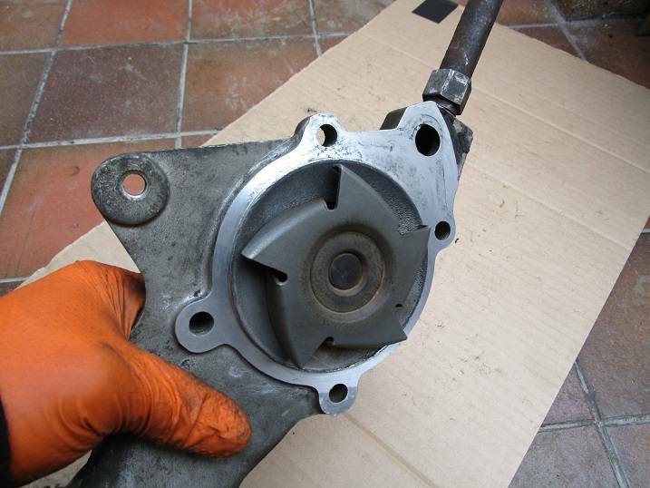

Update on the Jeep... Got the water pump reinstalled with a new gasket. Upper and lower hoses replaced with new. New thermostat + gasket, too. Decided to put the recovered coolant through a fuel filter and reused it as seemed a waste to throw away new coolant. I order a new idler, but reused the existing one as it's in serviceable condition. Received the wrong serpentine belt, so the old one is back on temporarily. Changed the engine oil and filter. Also changed the front diff, gear box and transfer case oil. All fluids replaced except brake fluid at this point. Started it up and got treated to a new problem - high idle (about 1,100 rpm compared to 800 previously). So, I started spraying around the engine bay looking for a vacuum leak thinking I might have dislodged a vacuum line or something. The only leak I could find was at the intake to cylinder head join near cylinder 4, which wasn't what I was expecting (or wanted). The intake and exhaust gasket are one piece, so both have to be removed. There's also a lot that needs disconnecting and moving out the way first, but eventually I got the fuckers out. And guess what - no gasket here either! No wonder it leaked. I'm just surprised it didn't leak worse. The car has been worked on by a right bodger and the invoice history actually suggests this was done professionally*. Mechanics are such crooks - don't think I've met an honest one in my life. -

Replaced the the rear shocks on the Mustang. The shocks were used but in better condition than the ones on the car. It made a noticeable improve to the ride, so I might bother myself to do the fronts too. Also treated the Mustang to a new throttle position sensor which got rid of some low RPM throttle hesitation I noticed. Much nicer to drive. The Jeep's thermostat came out in pieces, so suspicion confirmed! I found a mystery piece of metal behind it. That, combined with the rusty condition of the coolant, gave me enough concern to get the water pump out as well. I've flushed everything out with the garden hose. I ordered a new thermostat and water pump pre-emptively, but think I'll actually reuse the pump as I can't see any impeller wear/damage and the bearing doesn't have any play at all. Also saves me trying to get that pipe out the top. -

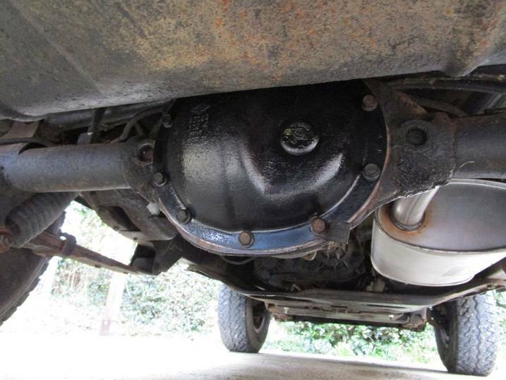

Long-term leak on the Jeep's rear diff. Luckily still had oil in it. Scrubbed the cover with a wire brush and petrol, then a quick coat of paint. Re-installed with a new gasket and oil. No more leak! Next leak was the rocker cover gasket*. Turns out, there was no gasket, just silicon sealant... The sealant didn't adhere very well which made it easy to scrape off. Reinstalled with a new gasket (which came free with the car - bonus). Haven't run it yet to test for leaks as I'm mid-way through addressing cooling system issues. -
