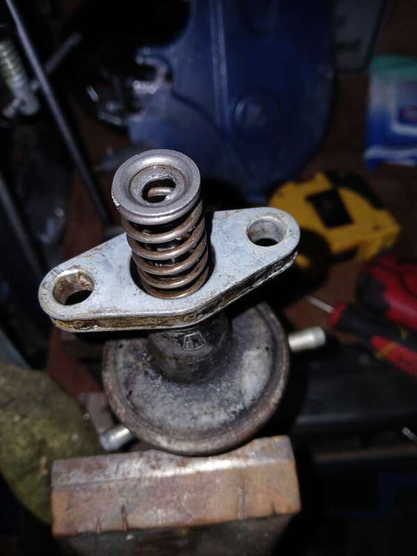

Fit new pump and put 'old' one in boot with tools for epic 'roadtrip' ...
Old pump off.  New one in.
I think it needs priming, damn the whole "going to work" malarkey have had to leave it for now.
Fucksake. No luck with the new fuel pump. Took it off and... it's fucked. The pump rod is jammed inside exactly how the other one was and the washer that sits in the notched bit of the rod, at the end of the spring, was punched through. See on the right. 20250213_211633.thumb.jpg.419b1b4e92e8ade92f030a1585c513aa.jpg
The old pump... that was working OK just weak... on the left, can't get the spring/washer assembly back together to refit it.
really not sure whats gone wrong here again. It's a QFP88, that's the part number for a pinto fuel pump there doesn't seem to be any different ones for different engines... and yet as soon as I fit a new one to my engine, it fucks it up. So I've got two pumps, sixty quid of parts, that are just scrap, and one old pump that won't go back together.
Fucksake. Fed up now.
