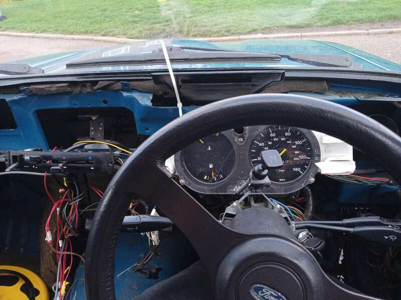

That's the dash out, IMG_20221018_212322_8.thumb.jpg.f68af622b31604cbae4f7d48d0f6858a.jpg
Looking somewhat different, although legally drivable if I put the clocks back up (which is one multi plug, a Speedo cable and probably a cable tie to hold it in place).

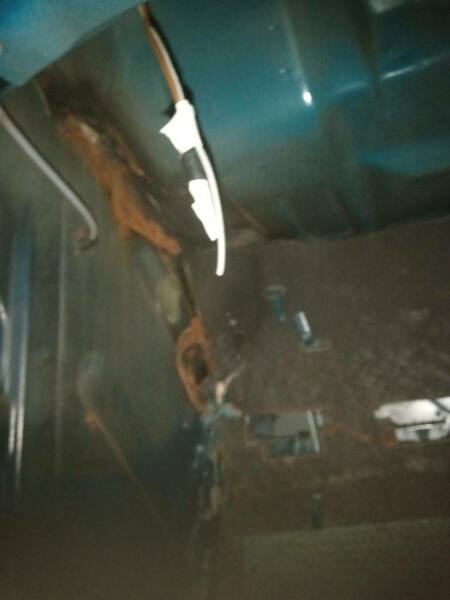

Grot both sides of the A pillar.
Some cable tidying and re-work to do (there's a few temporary repairs and splices that I'd like to sort properly), also the air ducts are mucky and could do with a good wash out I think.
I'm not sure whether to replace the blower and wiper motors whilst I've got access. It would be incredibly annoying if I did all of this and then had to do it next year if one failed (both original as far as I can tell).

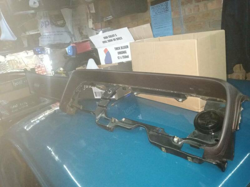

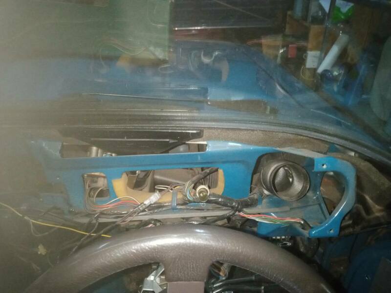

Been trying to expose some of the areas needing work.
I've also been looking at the dash top. Whether it can be tidied up where the splits are. IMG_20221018_212433_6.thumb.jpg.04a6e57a0c73855300662b9793117887.jpg

Dash brought back home to live indoors for a bit.
I went for a drive around town in the afternoon, a nice little pootle in an empty and rattly car.  Clocks held on with a cable tie for legality reasons!

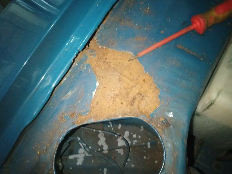

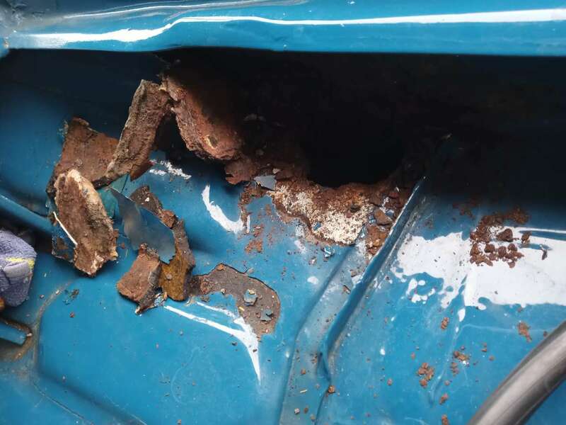

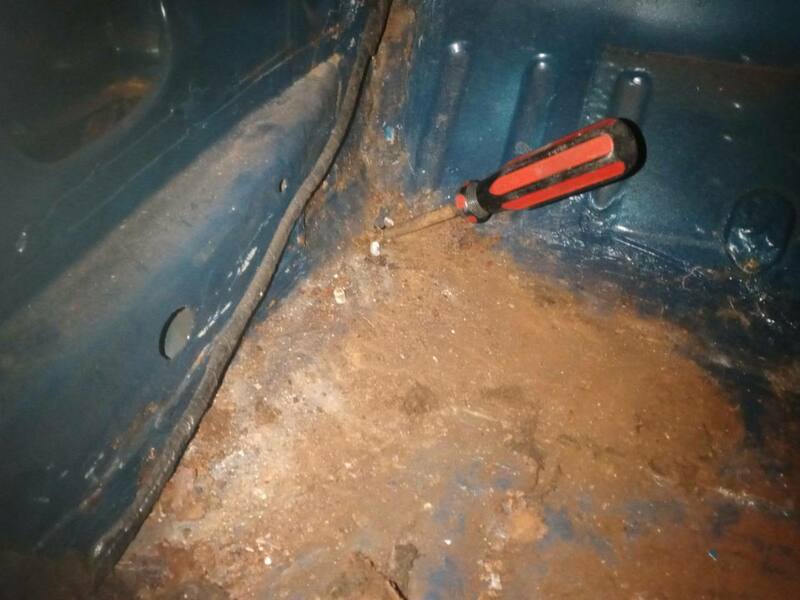

There's some underseal/waxoyl type stuff under the drivers foot area, presumably as part of a previous repair. It makes removal of the sound deadening a right pain though!
You can see there's been a patch put in before that's rotted away.
The big screwdriver also attacked the inner wings. Holes happened.

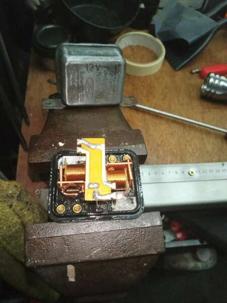

I took the main beam relay off to clean it out, it was a bit lazy in throwing which meant that the reliable way of getting the lights on involved popping the bonnet and a tap of a spanner in the right place...

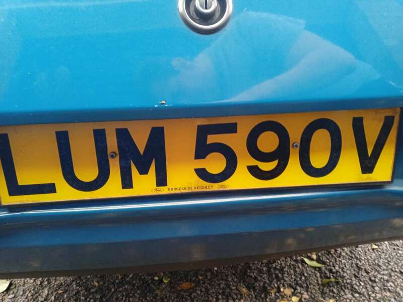

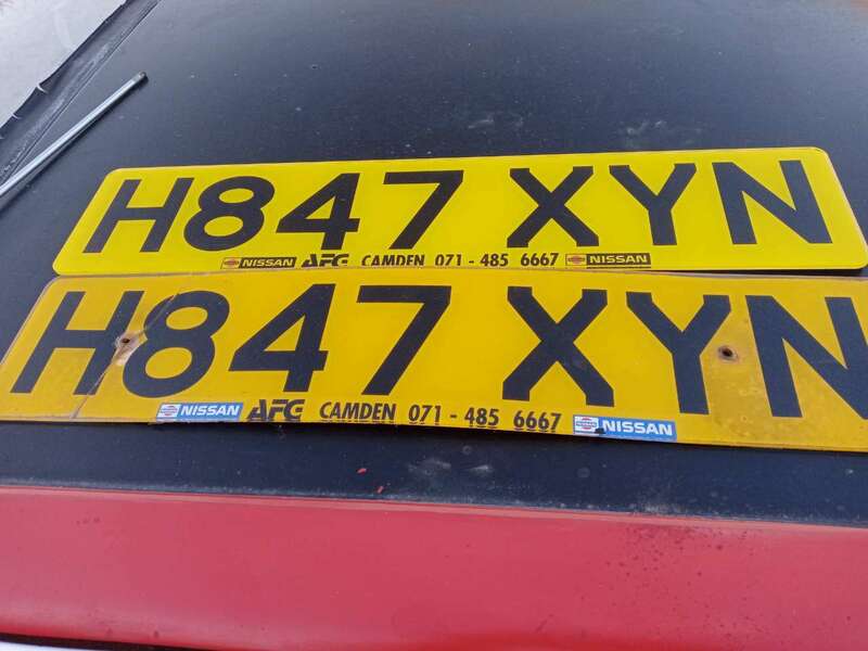

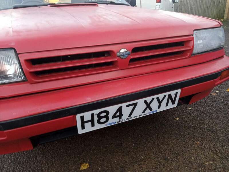

The postman arrived with some shiny new number plates.
See the reproduction Vs the original. Spot on. The original was actually in two pieces when I took it off!
The front has always had a motorfactors plate, so it gets a treat.

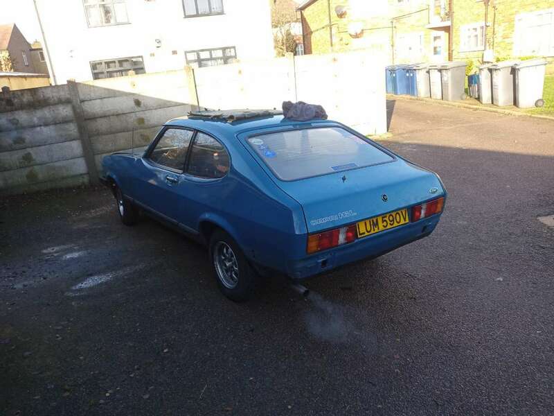

Yesterday presented the first opportunity in a while to do anything down the garage, when I both had the time and it wasn't freezing cold.
Bluebird exhaust bolts nipped up and general check over before MoT. Capri got down off axle stands, pootled around the yard, let it warm up and run for a bit.
It certainly left a mark

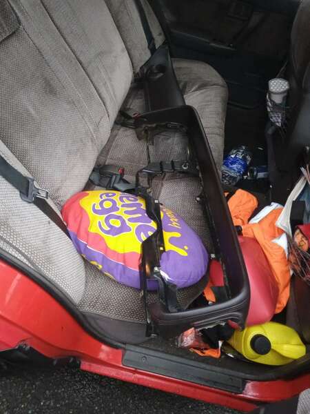

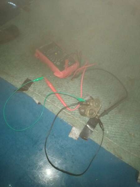

Mondeo door switch I think is faulty - it's been sensing the door as being open intermittently. This results in interior lights staying on all the time which is sub optimal. Pulled fuse until I get a chance to have a poke.
Door switch off, no continuity at all. Although, randomly, a bit later it seemed to go the other way and be stuck on.
Replacement £6 off eBay ordered. I think that's probably where the battery/electrical issues I had last month stemmed from, if the footwell lights were randomly staying on. In view of the rain, and my tiredness, I didn't strip the unit down, but once I've swapped it out I'll have a nosey.
