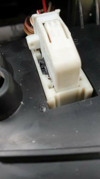

HELP
Trying to remove cluster to send off for IPK fix.
Someone has been here before me and snapped the locking tab on the wiring plug, when re-installing cluster.
How the hell do I get this off now????

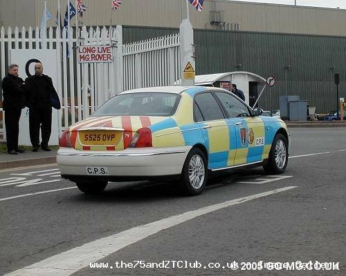

Anyone familiar with the 75/ZT forum will recognise this as one of the pre production test cars. It never left the Longbridge site until they went under in 2015 apart from the odd TV job dressed as a police car.
And here still wearing police colours but also an MG Rover logo, like Longbridge internal police.
