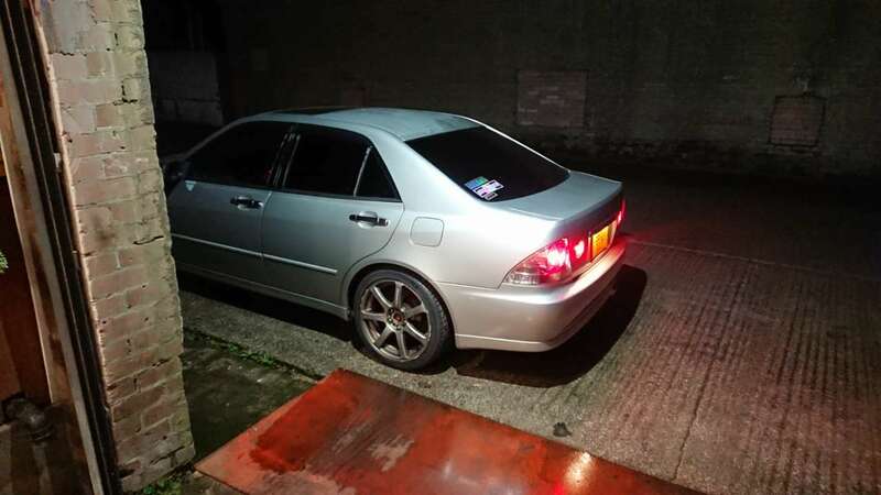

Couple of things happened this week.
The Altezza got some number plates fitted.
Then I took it for it's first run.
Nervous as all hell, which was for nothing. As it goes very well. Comfortable to be in and with a big plus of the engine and drivetrain being in rude health. No odd noises from the suspension either.
Clutch release bearing is howling though. So that'll be sorted, I have found these have a dual mass flywheel and there is no ill effects from fitting a solid (and lighter) flywheel. So I'll change the lot while I'm in there.
Overall I'm chuffed to bits with it.

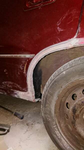

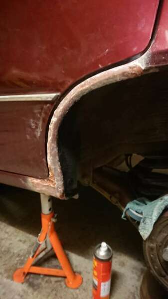

Actual progress made today.
Inner and outer are on. Starting to smooth out the welds. Wee bit of bodywork to do. Better than rusty shite before.
Had to bugger about as I had trimmed the inner repair panel too short. But it's on.
Made a start on making that wheel arch look good at 50 yards.
Please don't laugh too hard. As I'd feel bad if there was an injury caused upon viewing this quality.
Joking over. First layer is the ole P40 just to seal over where I had welded and shape up the arch. Looks crap, but that'll be knocked down. Then once it's closer, skim of bog to finalise it.
Inside of the tub is done.
The fresh areas have been sealed with tiger seal. Not been mean with the stuff either. Makes a great coating as its tough as hell. Smoothed it off by brushing it over with thinners. Makes for neater finish. Then a coat of stone chip.
Good enough for me.

Nexia wheel arch. After a wee rub back.
Good enough. Slapped some red oxide on for now. Good test for the brand I use. When the weather warms up a tad. I promise* I will finish it off.

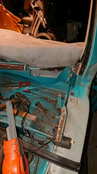

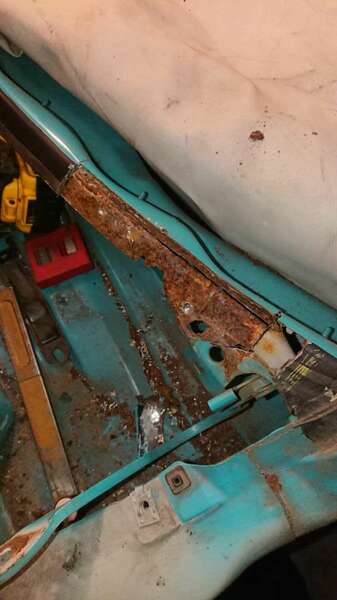

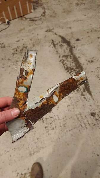

In the meantime. Was thinking about that windscreen scuttle on the Corsa. Wonder how bad it is.
OK. Not great at all.
Well keep cutting until you find solid metal.
Nice. That's a fair chunk out.
Yep, reckon it's been like that for years.
So not as sad about windscreen cracking. As I'd of been annoyed if I found it later on after I got the car back together.
I'll start chopping up the clean section I cut from the donor Corsa I broke earlier this year. Save me a heap of fab work and it'll be not that bad to weld in.

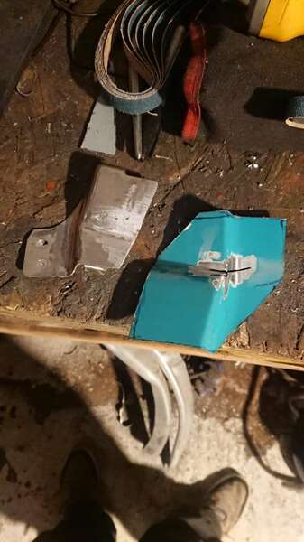

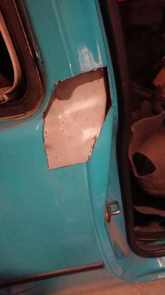

Just got back from the unit now.
So while I neck a beer. Here is what I accomplished on the Corsa.
First. I hacked up the donor section. Then separated the two skins that make it up. The lower piece was let in first.
Then quick lick of Bonda primer.
Prepped the outer skin and welded it on.
That actually looks not too bad.... I think!?
Wasn't that bad to replace this. As it's mostly straightforward when you have the panels. Helps when you're not scratting about the floor too, ended up enjoying doing this for a change.

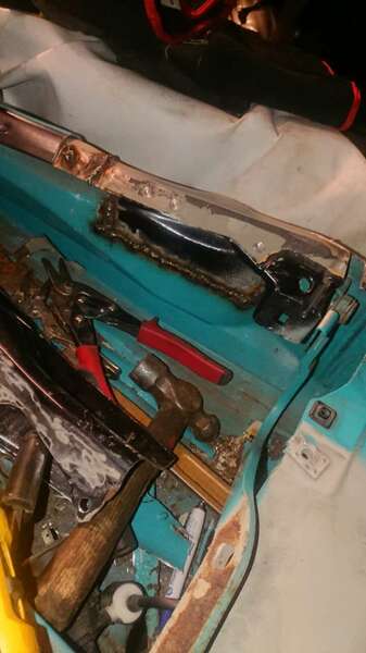

Holy moly!
More welding done!
If anyone is familiar with Corsa B's. You'll know the early Pre-97 cars were prone to cracked B pillars. Mine was cracked on both sides.
Pondered on how to fix it. I might of went a tad overboard?
Wasn't worried if I had taken any strength out of the shell. As it's just an outer skin.
Then same donor Corsa I took cuts from was a Post-97 car. These cars were fitted with reinforcement plates to stop this issue.
Ground the cracks out of the plate. Save any issues with fit. I fixed them and attached the plate. You'll see how they fit in the next post.
GM just used two spot welds and black PU mastic to attach them. So cleaned everything up, tiger seal on the same areas and tacked up the holes.
Dab of primer applied. Then flipped over and welded the cracks up. Made sure to tack into the plate too. Light clean up after that.
Hot snottered the area back in. Once the welds are knocked down it'll look just fine.
I'll repeat this on the passenger side soon.
Glad I did it this way. As some have gone through the inside to get to this area. That's at least three layers of metal to chop through. Seemed daft to do that. This way means I can fix it on the bench.

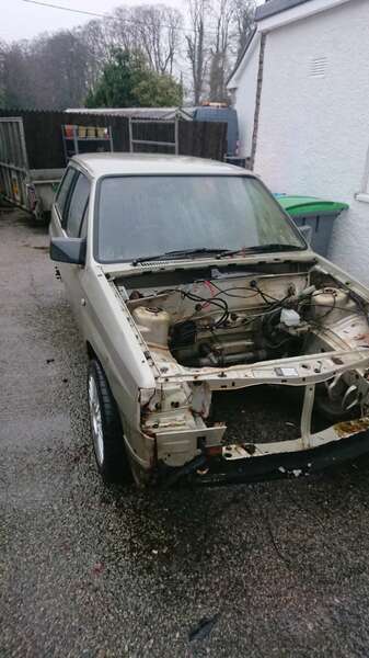

You know actual progress. Then spot an F20 gearbox for sale local. Excellent!
Was at a good price too. Aye, I'll hae that! Awa doon to fetch it.
Started chatting to the fella. Turns out he was having a clear out and would I be interested in what he had sat...
Now own another Nova.
MK1 Merit on an F reg. This time with a V5. Last white one didn't and wasn't able to get one either.
Shell is pretty good considering it's age. Needs some welding, standard Nova really. With a good stash of spares and I have a 1600 8v that would be right at home in it.
For now it'll be thrown in a corner. Badly want to tear into it, better not though as there is other cars need done first!

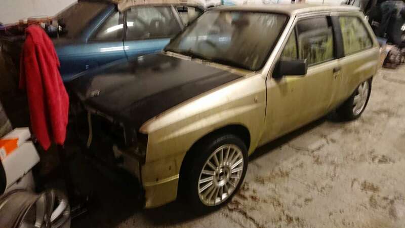

Oh boy.
Well this happened.
Nae moving pics or anything to say on getting it back.
Other than it was soggy as fuck the night and the collection day was brought forward massively to tonight.
Anyway. I've got it. Happy as owt. It's actually more soild than I thought for a shonky Spanish shopping trolley.
I have put the Corsa up for sale on here. Only reason, because I'd been after another Nova for years. I wasn't passing this up. Because they are only getting more expensive I've found now.
This weekend I'll clear a proper space for it. Because it can wait for now.

Have made a little progress on the Corsa today.
Have started scrubbing down the scaldy inner arch tubs. Rust killer acid, Bonda red oxide primer, then seam sealed and soon to be either gravitex or raptor'd...
Which ever is cheaper in spray tins.
*sigh*
Bought four friggin bottles. But it'll be easier and quicker using aerosols.
Might give the hubs and associated shite a scrub and paint too.

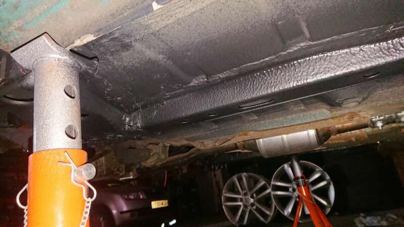

Sounds daft.
But I was very happy with this on the Corsa.
Couple of areas to touch up. But that's the rails and front inner arches now coated in Gravitex. Used PU18 instead of Tiger seal for the seams. Works well and cheaper too. Four tubes for £20 delivered iirc.
Once this is all dry. I can start putting parts back on.
