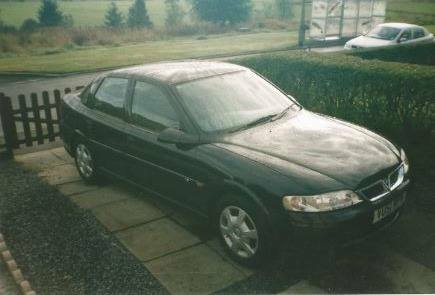

Long story short. I have too many. Plus after looking over the Vectra. It's not looking great.
It's more rusty than I forseen. Just keep finding areas like that. So have called time on it. I'll strip what I can off and get rid of the shell. Sucks, but it's a decision that had to be made.

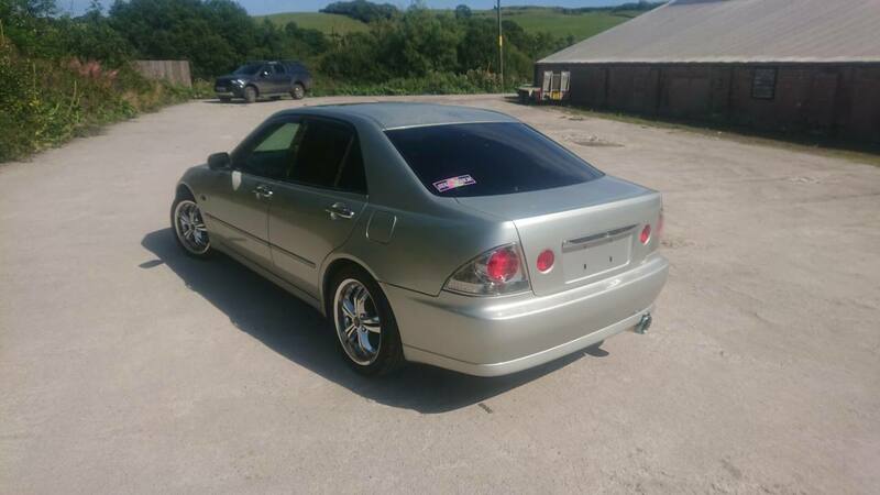

It's not totally bad though. As I've bought a car to replace the Woo and the 306.
Ignore the Lexus badge. It's an Altezza RS200. Went down the fresh import route. Does need some paint and the wheels thrown tae feck. It should do the job of both cars in one. Have to wait on it though, as it's still on the boat.

The Altezza I had mentioned was finally delivered to me yesterday.
It's better than expected. Roof and bonnet need painting as they've been burnt with the Japanese hotter weather. Rest is clean and been told it runs just fine that pleases me as a good 3SGE BEAMS engine isn't cheap to replace.
