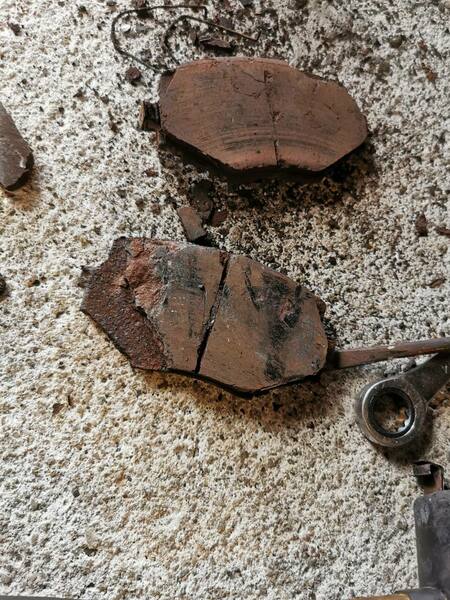

So away it went for an MOT and it failed for a binding front caliper.
New caliper, pads and a re-grease of the sliders saw the old girl roadworthy for another year, straight into daily driver duties.

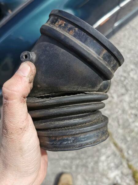

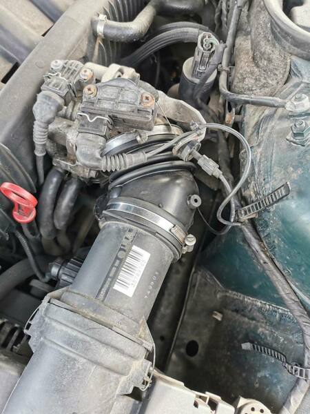

Herman's new intake tube arrived, which was a relatively painless swap.
Turned out to be worse than the initial inspection:

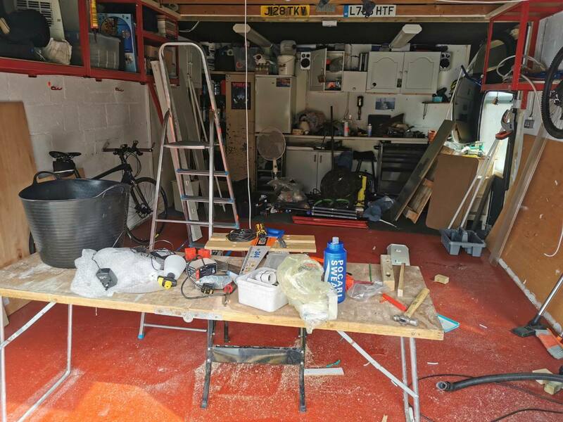

After all this work, I finally turned my attention to the garage (again).  Last year, I did a major re-jig to the layout, as detailed in Page 1 of this thread. Whilst having the workbench at the back was definitely the right way ahead, the working area floorspace was too narrow for working comfortably on cars, even small motors like the Beat. Swinging the trolley jack about and crawling underneath proved to be a pain in the arse.
So, the aim of the game was to get as much floorspace back as possible. First step was to mount the bicycles to the roof rafters:
Relegating the boys' bikes and garden toys back to the garden shed did help things as well.

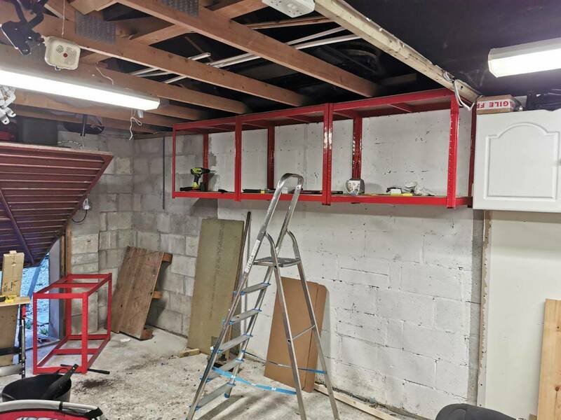

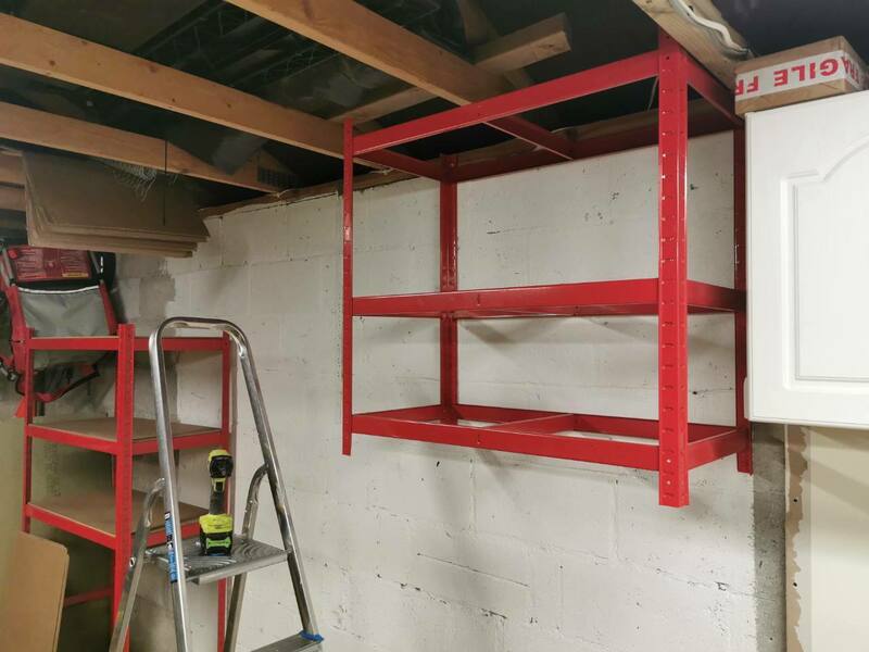

The biggest cause of floorspace intrusion was the floor-mounted racking.
Having had these since we moved in, these were essential in storing the absolute hoard of shite Mini parts. Nowadays, they were a lot more bare. They stood at 1.8m tall and could split in half, height-wise too.  A rough plan was hatched. The racking was broken down, and the separate 90cm vertical sections were reduced in height by 15cm. This height was chosen to allow it to stay roughly in line with the adjacent cabinet already fitted, and allow room to move underneath it.
The test fit of the first unit looked promising:
So the work continued.
Eventually, after a couple of evenings, they came together nicely.
And with the fourth and final unit fitted, I could properly secure the units for good. The rear vertical sections screw into both the wall and the roof trust mounting beam, the units were secured to each other and the front vertical sections were mounted to a section of timber secured to the roof beams.
This resulted in a very secure storage space that also allowed for full use of the floorspace underneath.

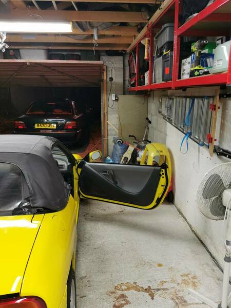

The following evening, all the shite that resided in the way was stowed.
Look, I can open the door fully! The ladder and workbench were also wall-mounted at this stage, accounting for the log storage near the front of the garage. The boy's toys came back in for a few days as I had other plans elsewhere.
I think it worked out pretty well.
And then, the Beat was parked on the other side of the garage, just in case! It's been nearly a month and it hasn't fallen down so I think that's a win. Work beckoned for a while after that, so this took a back seat.

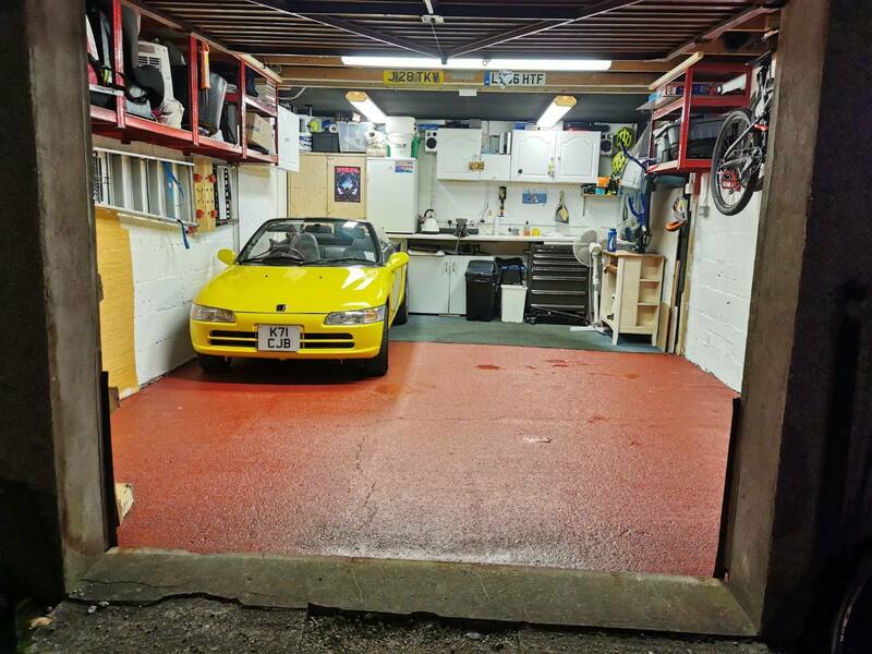

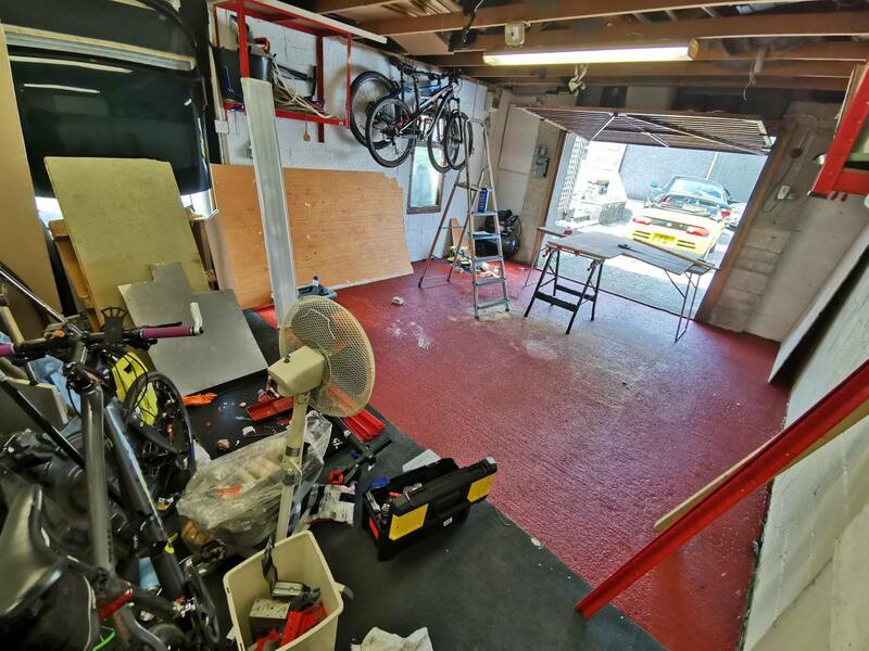

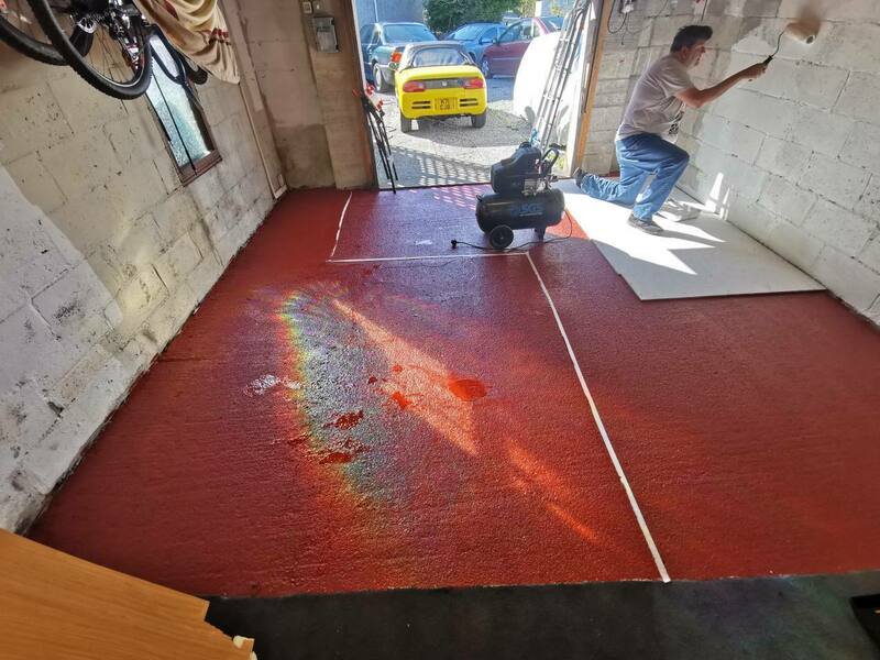

Finally, I got back to it though. In our old house, I'd had to buy a tin of garage floor paint to repaint our porch floor as it was ruined. The tin had been sat in the garage, gathering dust for seven years since.
Seemed daft to let this opportunity go to waste, eh?
I ended up applying this paint with a tiny roller - I needed to apply two coats, and I didn't want to end up having to buy a new tin, so minimising paint wastage in big rollers was the aim of the game.
Whilst in between applying the coats, the in-laws came down, so I got the FiL busy applying a coat of white paint to the walls.

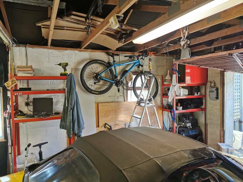

At this point, we wall mounted 1 racking unit onto the wall, and relegated the other one to the shed, which was another ballache in itself!
Next, a toolboard in the corner of the garage was made up to accommodate the air tools above the compressor. Some corner shelves were also made and fitted.
One of the garage bugbears I had was a dark spot in the garage - a Facebook freebie of another florescent light was gained and wired in.
It got quite messy with all these simultaneous jobs going on!

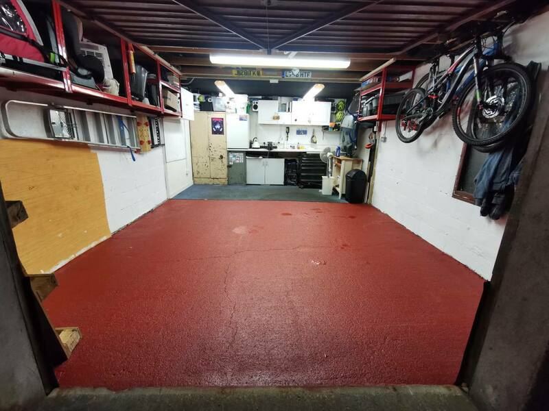

But the work has its dividends, and a few hours later, the garage was ready.
You can see the corner shelves and extra florescent light in this one.
The Beat looked positively dwarfed in the new-found space.

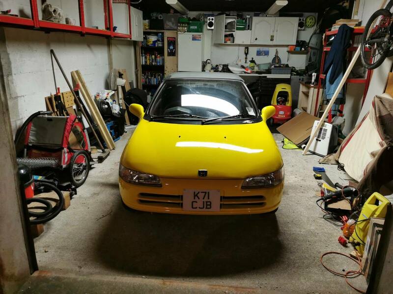

So naturally, I had to test out a theory:

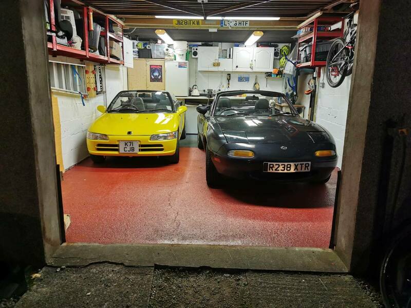

Yep, this will now become a 2 car garage for the winter months.
There was a surplus TV stand in the rear corner of the garage, which I had to avoid when parking the Mazda:
So with that moved out of the way, how far could we go?
Well, as it turns out, quite far.
It's a bit of a squeeze, but both cars drove in with minimal fuss, as long as the Beat is as far back as possible. Theoretically, Herman  /should/ fit in there alongside the Beat, but I really don't want to find out the hard way that I'm wrong.
So I finally have a clean, wide space to work without a dusty floor to ruin my day. Best thing was, most of the items used in this project were surplus items from other projects, so I spent just over £25 on the whole project.

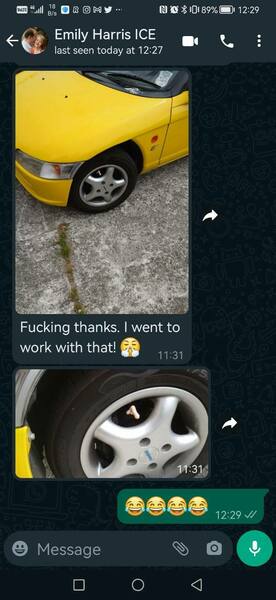

And remembered that it was 30 miles away, and I didn't have a spare wheel fitted to the car. Thankfully, I swung by Tony's place last weekend on the way home from a wedding in Bristol (Laguna got 40.8MPG) and picked up the spare tyre mounting plate.
Unfortunately, the wheel securing bolt has gone walkies, and as it was a Sunday night, I had to be creative. My friend had left a section of M8 threaded rod in the MR2 when I bought it and I never threw it out. Mercifully, the rod fitted, so I cut a section of timber and used a hole cutting drill bit to reduce the thickness. When it was discovered I had no M8 nuts left, it fell to Dad of the year to cannibalise two nuts from his old bicycle. His face was a picture when he attempted to ride it after.

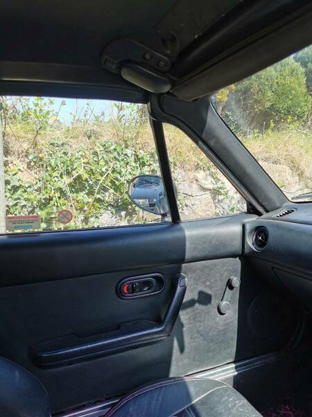

As mentioned in a previous post, the lock barrel fell into the door after I repaired and refitted it, typical of those spring clips.
Removed the door card:
And found the little beggar hiding at the bottom of the door. Seven months it has been down there!
Eventually, after way more fiddling and faffing about than I'm proud to admit, eventually the barrel clip went on and stayed on.

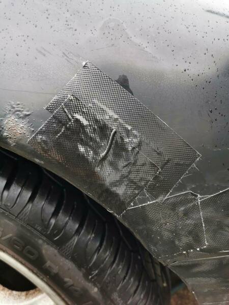

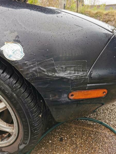

With all the 'big' jobs done, it was time to tackle the one annoying aspect of the car with a budget of zero pence.
Spot it?
Yes, it's this little fella.
Bit of duct tape and some white paint to make it a Kernow cross until I come up with a permanent solution of new plates
The paintwork on this Mazda is looking absolutely appalling, so I think this will end up recieving a roller paint job - it's already a write off with visible body damage so preserving the value is not a concern to me, but having it all one colour would be quite nice.
There's a fella on Facebook selling NATO green vehicle paint for £25 a tin so that looks to be the winning idea, once I get some replacement wings of any colour for it

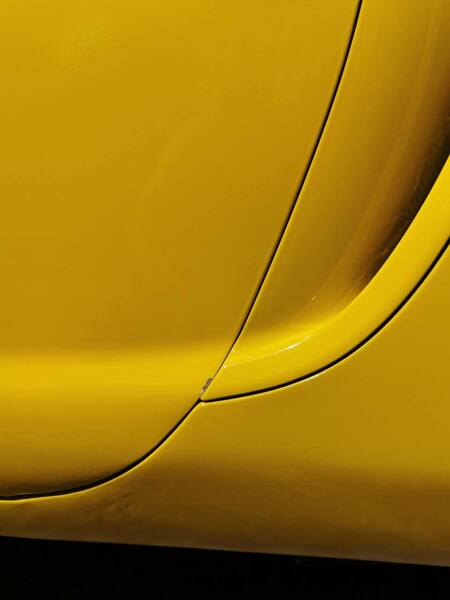

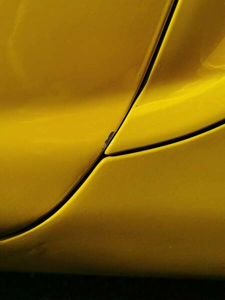

Annoyingly, I noticed a while back that the doors were fouling the intake grilles, so I attempted to rectify that:
This side worked lovely with a bit of fettling.
The other side, less so.
It had already taken a chip out of the paint so I wanted to get it sorted.
After 45 minutes of sheer arseachery, this was the best I could achieve:
Nowhere near perfect, but does clear the grille now. I went to a local model shop to purchase a tiny tin of enamel model train paint that matched the colour of the paint chip I picked off the door. Colour match was pretty spot on, but I didn't notice the tin was fucking satin finish, not gloss. Oh well.

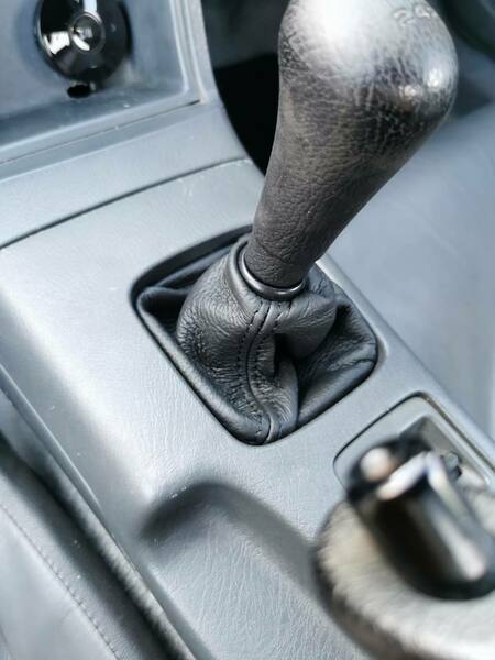

And whilst the centre console was out:

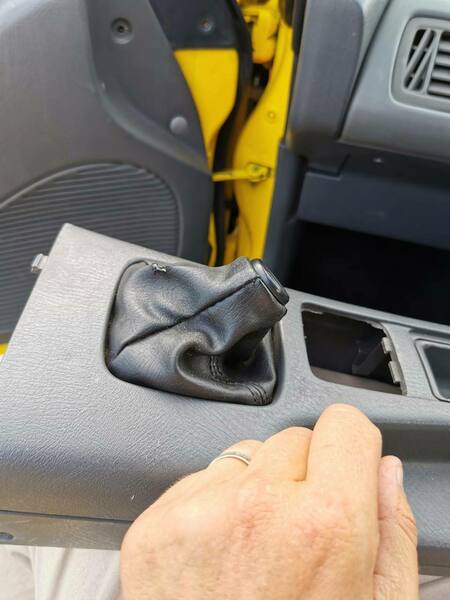

It made sense to change the gearshift gaiter. The old one was pleather and had a hole in it.
The new one was a real leather one for a Renault Laguna 3 (so god knows why I have it) and fitted rather nicely in its place.

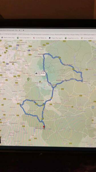

I was in charge of the route for the convoy so I made sure our route capture the Nant Y Moch reservoir, Elan Valley and Pen Y Pass, with all the adjoining mountain roads.

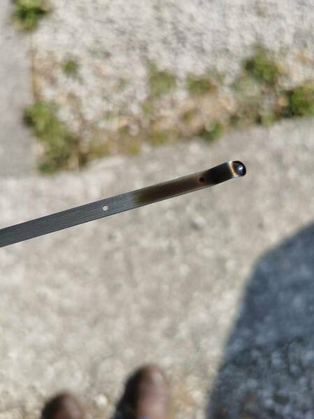

One thing I did notice was I must have forgotten to secure my oil cap during a top-up at a stop, which was now long gone - DOH! Luckily, it was a remove filler tube so not having one didn't affect it and I actually had a new spare on at home.

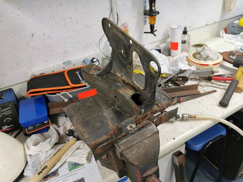

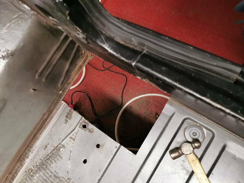

The right rear boot floor corner was an absolute mess. A sea of patches and in dire need of replacement, I decided another patch wasn't going to cut it this time.
Time to cut the lot out.
IMG_20220530_221726.thumb.jpg.5b1858dbefb7bf2fa8fc542db875b128.jpgIMG_20220601_145009.thumb.jpg.fae7c0d26cf716f28c46572e7c8fc4b3.jpg
It was only when the removed section was actually on the bench and visible, was the true extent of the bodgery revealed.
IMG_20220530_221734.thumb.jpg.cc5424d0dffd2f467fd877701e64a4ae.jpgIMG_20220530_221737.thumb.jpg.b9bf90655c0f60a6572ac90f704d04bd.jpg
And just how thin the metal had gotten in some places.

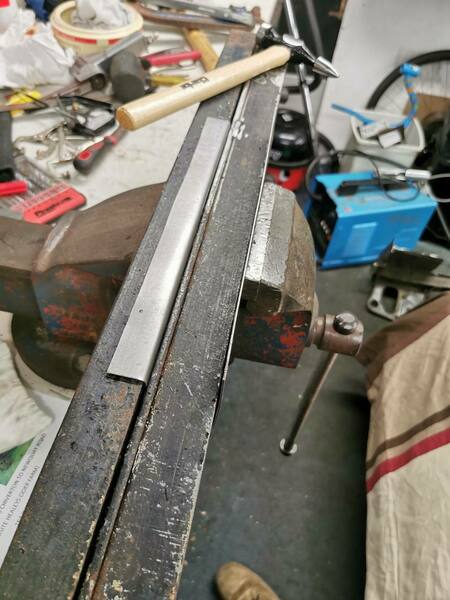

This time, I wanted to try and use thicker metal. 1mm came out, 1.8mm was going in - that should at least last a bit longer.
So, all marked out:
And shaped. First thing I noticed was just how much harder it was to shape 1.8mm compared to 1mm. With just a bench vice, some angle iron and a hammer, it was going to get tricky.
This time, to ensure good penetration, I held a flatttened section of copper pipe on the underside of the sections I was welding. Weld doesn't stick to copper, so it allows the weld to pool without burning through to reduce the risk of blowing through the metal. Worked a treat, too.

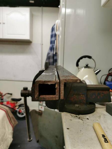

Making the rail was a bit of a challenge. 1.8mm is a tough bugger to bend, and I was going to have to make tight box sections.
To get around this, I noticed that the internal dimensions of the rail were the same as pushing 2 of my angle iron bits together to make a box shape (Pic shows what I mean)
So, I welded the angle iron bits together to maintain the box shape.
Measured out the required dimensions
And started twatting it into shape. A rubber mallet proved to be the best non-damaging method to getting the metal bent over.
The 3rd and final bit of angle iron was then brought into play to allow the tabs to be formed.
IMG_20220601_220723.thumb.jpg.96476d946ced33ffa332f19b458a1e5c.jpgIMG_20220601_220727.thumb.jpg.512bbba182773a94baa9b4955aeaf3ce.jpgIMG_20220601_221204.thumb.jpg.36135fc2d5be427051068d6fc63d76f6.jpg
Until eventually I got the rail shape I was after. Almost dimensionally perfect to the section still fitted to the car, but I'm confident it'll be fine.
IMG_20220601_221728.thumb.jpg.1f8734ae00b036fc2b75ccd74e788ea7.jpgIMG_20220601_221733.thumb.jpg.125481ebeb44d030f9285b31ca2b6465.jpg
After that, it was a case of removing the reinforcement bracket from the old section. Took a lot of hacking and slicing to free it! Eventually, it came off, and was cleaned up/ ground down ready for welding.

Once thing I did do yesterday was have a quick go at the bumper corner scuff with some scratch remover. Obviously I'm not stupid enough to think it'll undo the deep scuff, but I was pleasantly surprised at how much of the other little bits of damage it helped with.
IMG_20220723_141705.thumb.jpg.b0632290f85b1c5e8cb9511c5876316d.jpgIMG_20220723_142053.thumb.jpg.631ca1a89db7c725e3bd21a3a3eaeb2b.jpg
I'll be working on this sort of task every so often. The car itself does still start and drive although it is very fume-y and smokey. Possible consequence from not turning a wheel in in anger since early 2021?

Helped a friend in need of assistance. Their '08 Fiesta was making typically horrid wheelbearing noise on the rear and a chuffing noise up front.
First thing I noticed when I took it home to my garage was how hot the OSR wheel had gotten.
So wheel off:
Which confirmed that (a) the brake was binding slightly, and the wheel bearing itself was on the way out. The wheel bearing on both sides was replaced, handbrake adjusted and sent out for a test. Same problem. Once back to the garage, I took the drum off for another check and found one of the brake cylinder pistons had seized slightly on.
Mercifully a quick fix.
Once replaced, the handbrake was adjusted again and all was good. Ended up saving time during the handbrake adjustment by leaving the drum attached to the alloy and just pulling it off and on for quick adjusts.

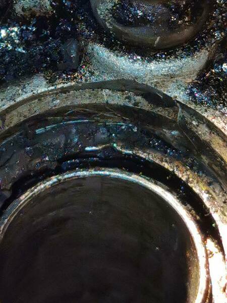

Next up, the chuffing. Found to be one of the injectors.
Lots of faffing ensued on my part, having never changed injector seals before.
After a bit of time, the injector came out.
Lots of scrubbing of the injector and the surrounding area followed, along with cutting the injector port mating face.
Had loads of trouble removing this seal in the head - eventually it transpired that I've taken the top face off the seal and was trying to prise out the seals internal metal ring.
IMG_20220609_214047.thumb.jpg.4ad9bfd48dbccabfb4bf9aa4988aa9dc.jpgIMG_20220609_215414.thumb.jpg.343418239f8c8c6879f5b7603a636962.jpgIMG_20220609_215654.thumb.jpg.2e6b46f2ec01d896a479cbff3462fb74.jpg
Up yours car.
After much faffing and cleaning, the new injector seals were fitted. A long test drive to drop it off with my friend proved that all was working once again and I've heard no complaints since so I guess I did all right. Got a nice bottle of port for my troubles :mrgreen:

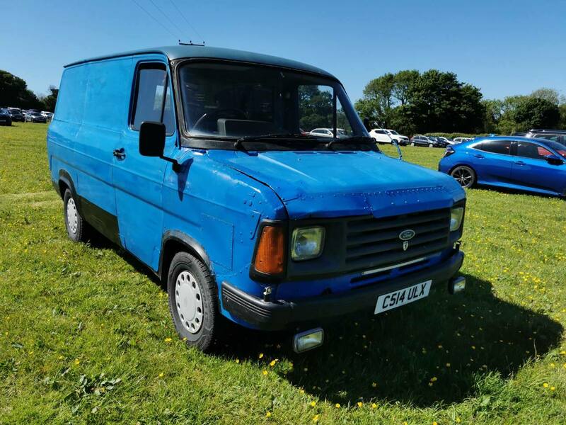

Spotted at one of the shows.
Looking for an argument against rolling 40 year MOT exemptions?
Step this way Sir.

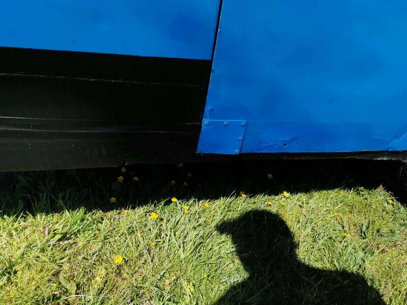

IMG_20220528_152907.thumb.jpg.ff54d19a96f4e7104f107522631a32bb.jpgIMG_20220528_152916.thumb.jpg.e60f645856b7be4c2a111c0a96adfb19.jpg
IMG_20220528_152920.thumb.jpg.2a7f256dbd244559a73bdca9c926afef.jpgIMG_20220528_152928.thumb.jpg.84f051f8b8a31e6909191494cc7f67a3.jpg
IMG_20220528_152930.thumb.jpg.7a5d8782a2349fe7b2027cf8339953de.jpgIMG_20220528_152943.thumb.jpg.f1253bff6631879d52d35874d32caf42.jpg
IMG_20220528_152947.thumb.jpg.41921ea3a3480ff9f5ed2adf65f5cde5.jpgIMG_20220528_152959.thumb.jpg.2751d3da10c68779a60dc7b5126baaa6.jpg
She's a cornucopia of bodges. Remarkably, three weeks before this photo was taken, it received a clean MOT pass. Almost impressive :mrgreen:
I cannot fathom how you would prefer to spent 14 weeks drilling holes and putting on pop rivets rather than buying a welder from Lidl and trying to learn how to use it, you've got to admire the tenacity

Finally, I started looking at the issue I had with the watertight integrity of the roof. The roof skin had shrunk terribly over the years, and the previous owner had tried to compensate for this by over tightening the latch hooks, causing them to bend.
Both sides were straightened in a vice and screwed in to a sensible length, the roof seal mounting frames were straightened with a hammer, and the car parked under a hose to see if there was any progress being made.
It was still pooling in the footwells, so the screen frame seals were checked and unblocked - the previous owners appeared to have stuffed some foam in the middle of the drain tube. Whilst there, I re-installed the seals correctly, as they were displaced and slightly twisted.
The car was parked in a downpour earlier and there was a few small drops in the cockpit so I've got a few more ideas to try when some parts arrive.

The winter got really rather cold and so I hit up Facebook marketplace and got a bargain infrared heater:
It was naturally cheap, so it was a bit ropey - it was covered in body shop detritus and overspray, and all four of the caster wheels were hanging off.
So, time to give it a bit of a spruce up:
The caster wheel mounting frames we re-shaped and braced inside with wood before replacement:
The reflectors removed and polished: ae7c91ca41f8a821c7af87d7ec6aac82.jpg
As were the bulbs, which were covered in overspray. The cable was also replaced for a much longer one.
It's still rough, but it is better that it was!
And all working:
Unfortunately, whilst it was lovely heat, once it was off, the heat disappeared, as is its nature, so it was time to move in a different direction.
I made some enquiries with a neighbour and got put in touch with a fella that was living off-grid. He worked as a builder/roofing guy and had recently refurbished a local pasty kitchen - he had all the removed foam roof insulation for sale at super cheap prices.
For £110 delivered, a deal was done and the insulation arrived on my doorstep that evening.
As expected for the price (it was looking to be about four or five times as much to buy it new!), It was in pretty poor shape - it had been in the rain, it was soaked in cooking grease and covered in dirt.
A morning of pressure washing and scrubbing them with parts cleaner yielded items that were clearly second hand, but didn't smell.
This was placed in the garage with a dehumidifier to allow it to dry fully.
It was a tight squeeze!
Eventually ( I was working on this when the kids had gone to bed) after a few days, I had cut all the boards down to their required sizes (you can see it in the background of the IR heater refurb photos) each roof joist void would get 6 bits of insulation to cover the entire area.
I used a combination of nails and steel wire to hold the insulation in place. Took a few weeks of faffing about, but it shaped up nicely:
Doing the joists above the plastboarded ceiling was a pure ballache - no space to move at all, and dirt constantly falling in my face
The benefits of the insulation demonstrated itself during a light snowfall halfway through the insulating:
And it's worked! Last night the outside temperature dropped to 2c, garage stayed at around 8c.
The garage ended up being an absolute nightmare to manoeuvre around during all of this:

I would be working on the drivers door, which would require the door card to be removed:
Which exposed this mess.
I was warned about this by Tony when he did the work package on the car back in '21. He did say there was a lot of sealant in the cavity to make up for the rotten bit, but this still resulted in a lot of lateral play in the window, which I'm hoping was causing a negative effect on the sealing of the windows.
After a bit of faffing, it came out relatively easily.
As demonstrated by the photos, the old one was completely ballbagged!
You can see the difference in the guide slot too.
As it had disintegrated internally and split into two pieces at the time of the rebuild, it was filled with sealant in an attempt to keep it going. Buggerance to clean off though.
A little bit of fiddling and manual adjustment was required, particularly on the lower adjustable bolt thread, which was pointing ever so slightly upwards, affecting the lining up of the remaining bolts.
Eventually, it all came back together fine, and the window appears to have less play in it now.
Will it provide a better, dry solution?
Well, we'll have to find out in due course, preferably not during the salt season!

Quiet day today, so I pottered about the garage. First job was fixing a puncture on the boys bicycle, then reattached the head on ol' faithful. Bit wonky now, mind, but still sweeps
After that, it was onto more jobs around the garage, firstly greasing up the garage door mechanism - a job I've forgotten to do for years, but makes a huge difference.
Finally, I looked at the garage door frame. The bottom of each side had rotted away over the years.
The entire frame is probably due replacement soon, but I had some spare wood of 'roughly' the same dimensions, so it was time to chop the old rotted section out.
Naturally, the world's worst camera doing stellar work today:
Not perfect, but it's better than a gaping hole.
The other side was starting to go as well, and I already had the tools out, so it made sense to do that one too.
Like a metaphor for my cars, it's a lot worse on the bits that were out of sight.
Last job of the day was fitting another layer of insulation to the garage door, and sealing as many drafty bits as possible. Again, budget of zero and trying to use up stuff from previous DIY projects over the years, so it's not a flawless finish but hopefully it'll make a difference.
The foam was secured with screws and penny washers, and I'll get some glue on there when the weather warms up.
All in all, a pleasant day had

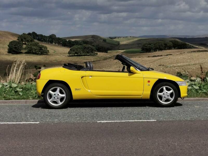

Polished and waxed the Beat.

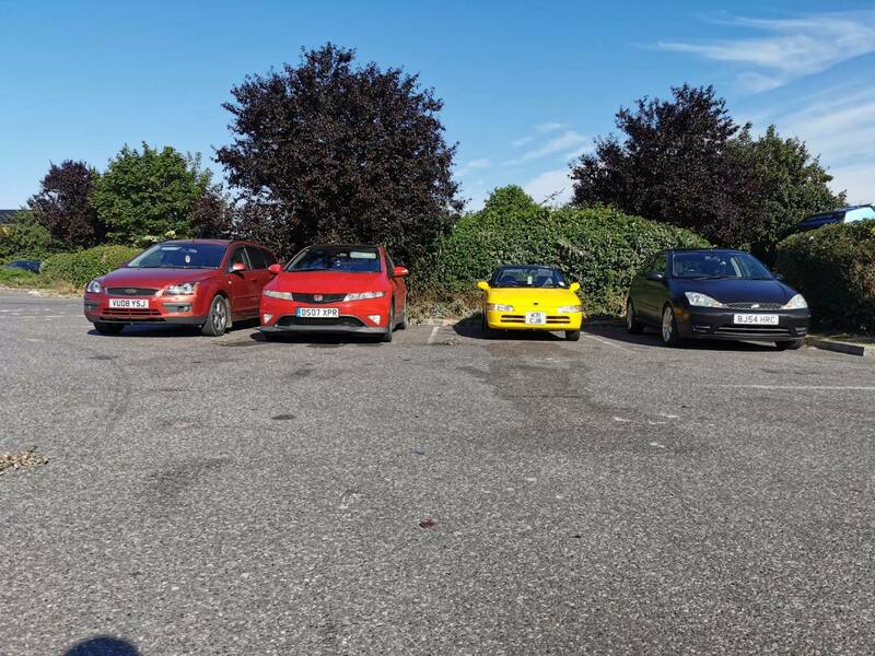

Got up at a very unrelaxo 0430 alarm, picked up my mate in Plymouth:
And headed up the line to Somerset for the Haynes Museum breakfast meet - we'd registered for a spot in the paddock as part of the '90s' theme.
There was a decent mix there:
