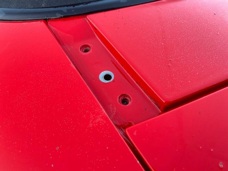

New boot is getting paint protection film for the boot rack clamps (was part of the original kit) and also this area. The boot weighs less than some 1980s car ashtrays, I swear - aluminium.

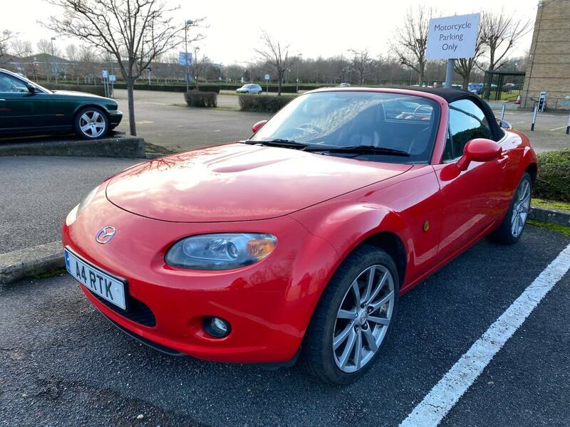

MOT passed! Condensation kindly left enough headlight clear it seems - poor thing hasn’t been used since September and lives outside.
Also the underneath is apparently better than I thought - I thought the jacking pads may be questionable but apparrently they just need a cleanup and new underseal.

That rot on your MX-5's boot lid looks very familiar.
I had a Mk2 MX-5 back in 2012-13 and it was going in exactly the same spot. It got so bad the numberplate lights were held in with duct tape.

Are Mk 2s steel or aluminium? The new lid looks good so I have /crudely/ used some spare paint protection film under that lip and will fill it with more waxoil in the cavity.

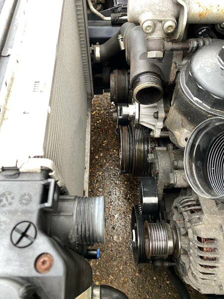

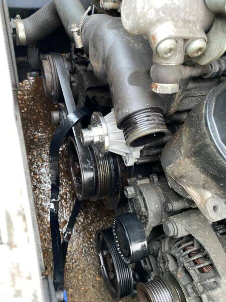

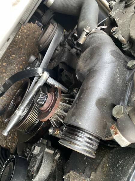

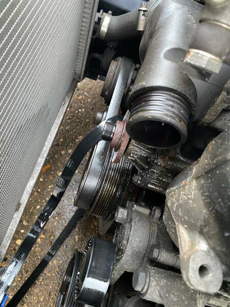

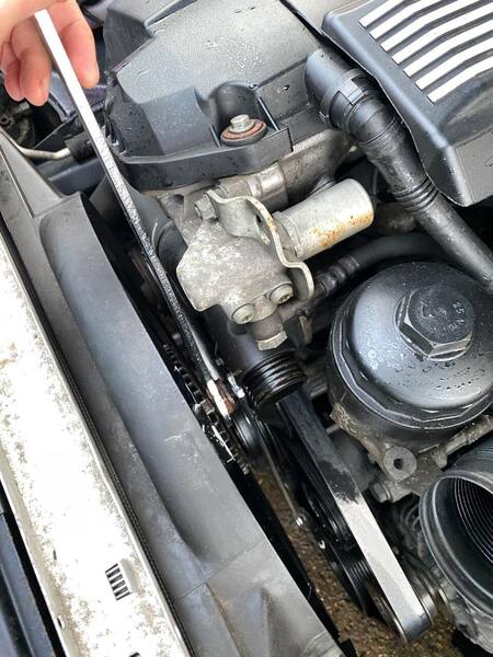

Christmas Eve apparently. Having lost a day to feeling like crap from the booster jab, today seems very different. The tool arrived for the viscous fan, so...
Which reveals...
So how did this bastard of a job go?
Fan came off with just one pull and then spinning, easy as.
10mm pulley bolts, same.
Pump nuts? Yep, you've guessed it, easy...
Remove pump? Two of the pulley bolts into the threaded holes, spin, pump is pushed out. Needed a crowbar to nudge the last mm - longer bolts would make that redundant.
Pump shaft bearing totally shafted.
New pump - pushes in just enough to show a couple of threads. Fit nuts, tighten crossing over, done.
Remove belts and clean contamination - think I will replace as they looked recent but feel crunchy.
And now paused as I need a pulley - the old one is chipped around the edges. But done in an hour or so total and totally furious with myself for not doing it sooner.

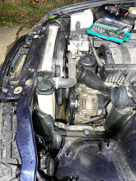

Due to Christmas timing, the BMW's fixes won't be finished until next year, but:
New water pump (fitted), new pulley, new fan VC, new drive belts. Total just under £100 excluding the coolant that I'll finish refilling when I've put the pulley on, as the VC and fan shroud can be done with the top hose refitted. Nearly all parts Febi apart from the longer belt being Continental.

Got annoyed waiting for aux belts so used an old one to start refilling the coolant and bleeding the system; for all the horror stories it went well and got full heat across the whole radiator, good flow, and clean coolant.
The engine-driven fan is not critical on these anyway, but I really want the new viscous coupling for that "vrrrrr" on first startup.
