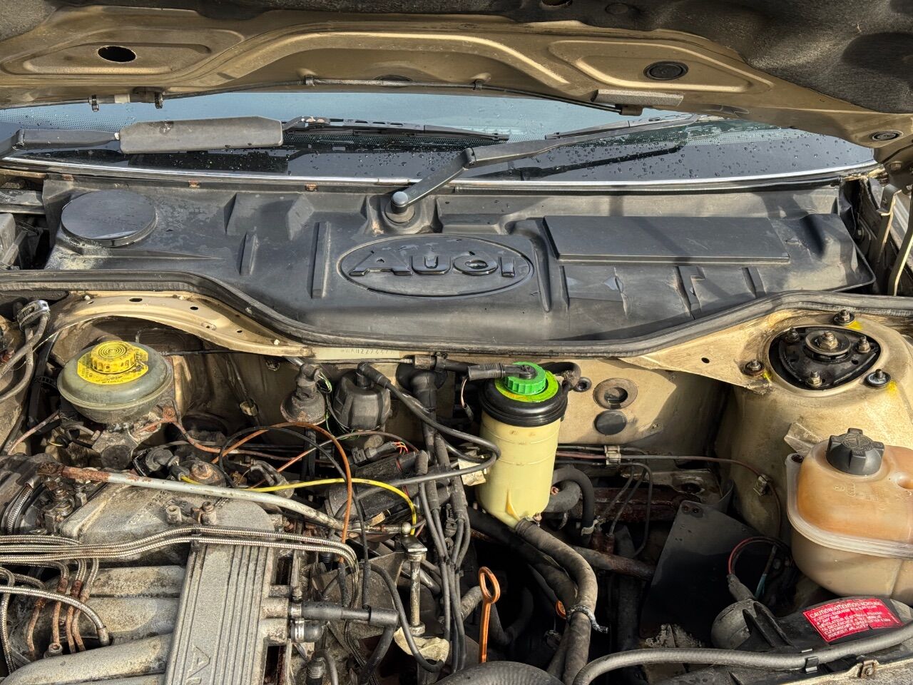

The loose plenum/scuttle cover was annoying me so I fixed it. And gently cleaned a couple of spots prior to the clear waxoyl explosion.

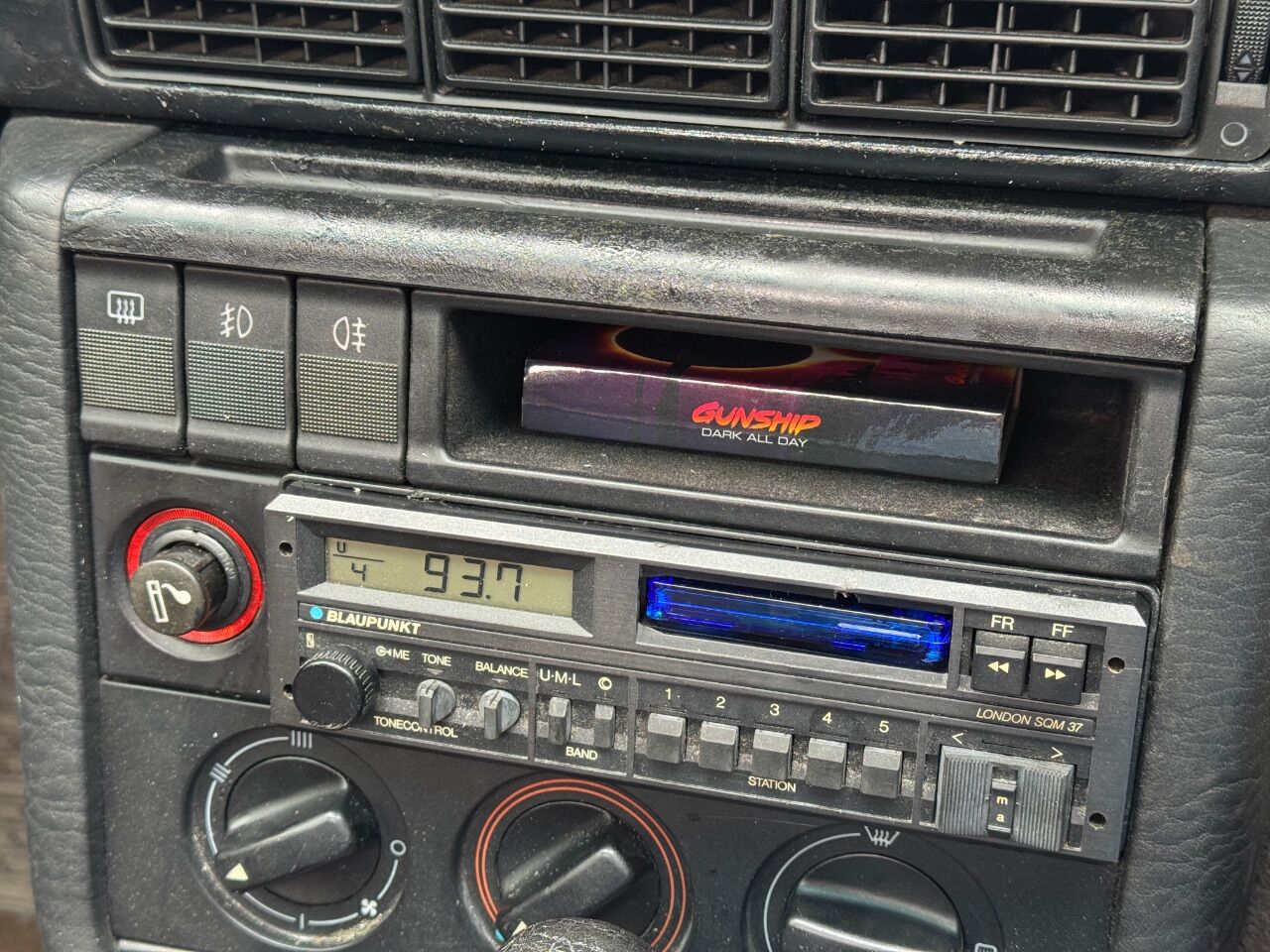

Also, cleaning the tape deck has improved the sound immensely. Just need to fix the auto tuning/manual tuning switch.

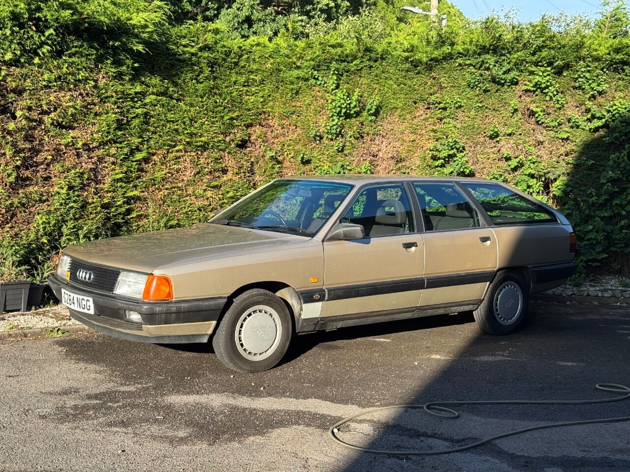

So, the 24 hours test (nearly 48 hours) report for the Audi 100:

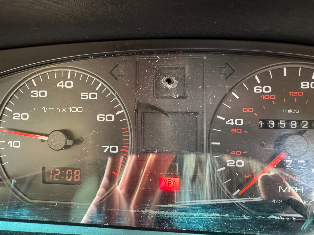

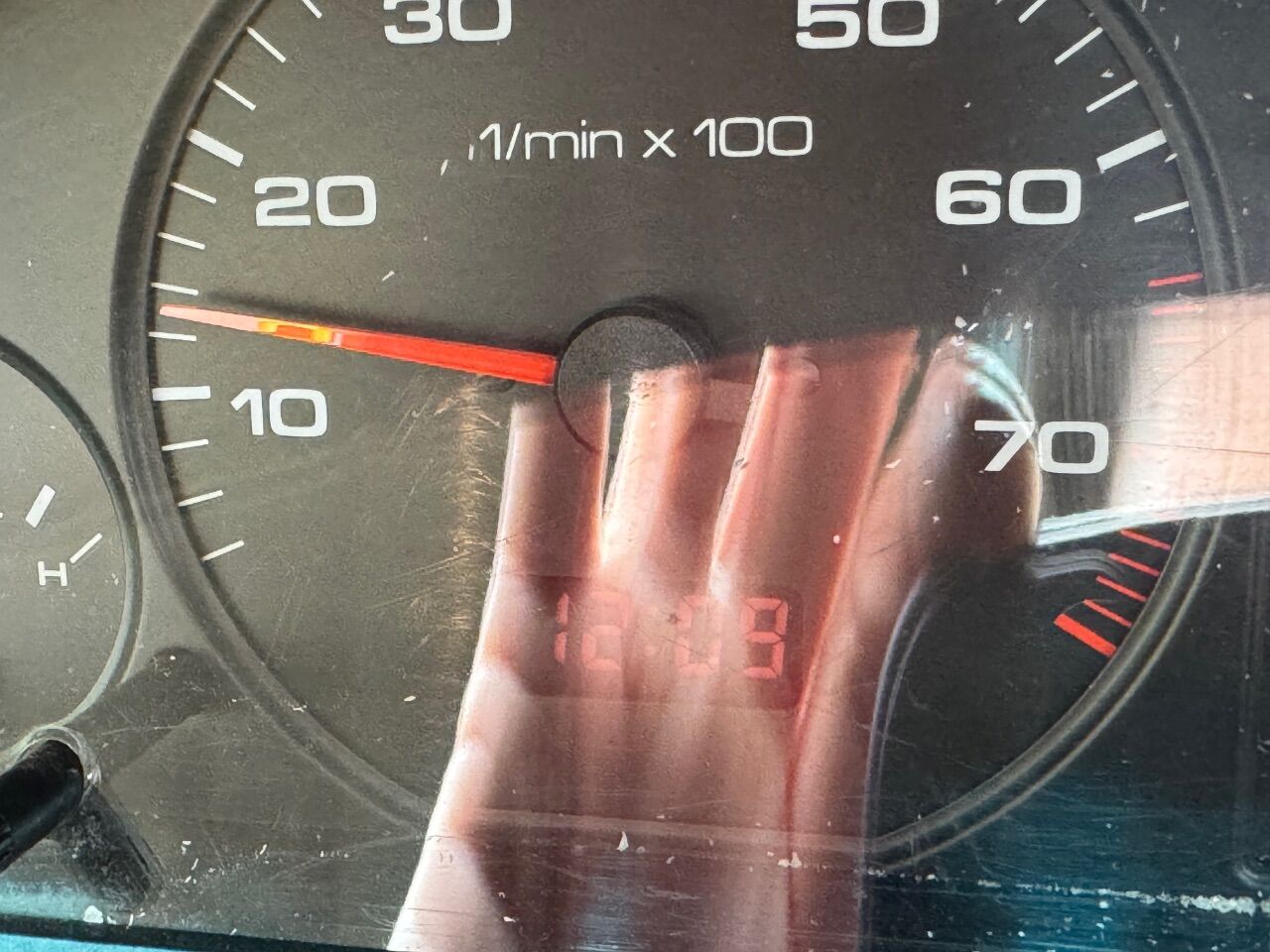

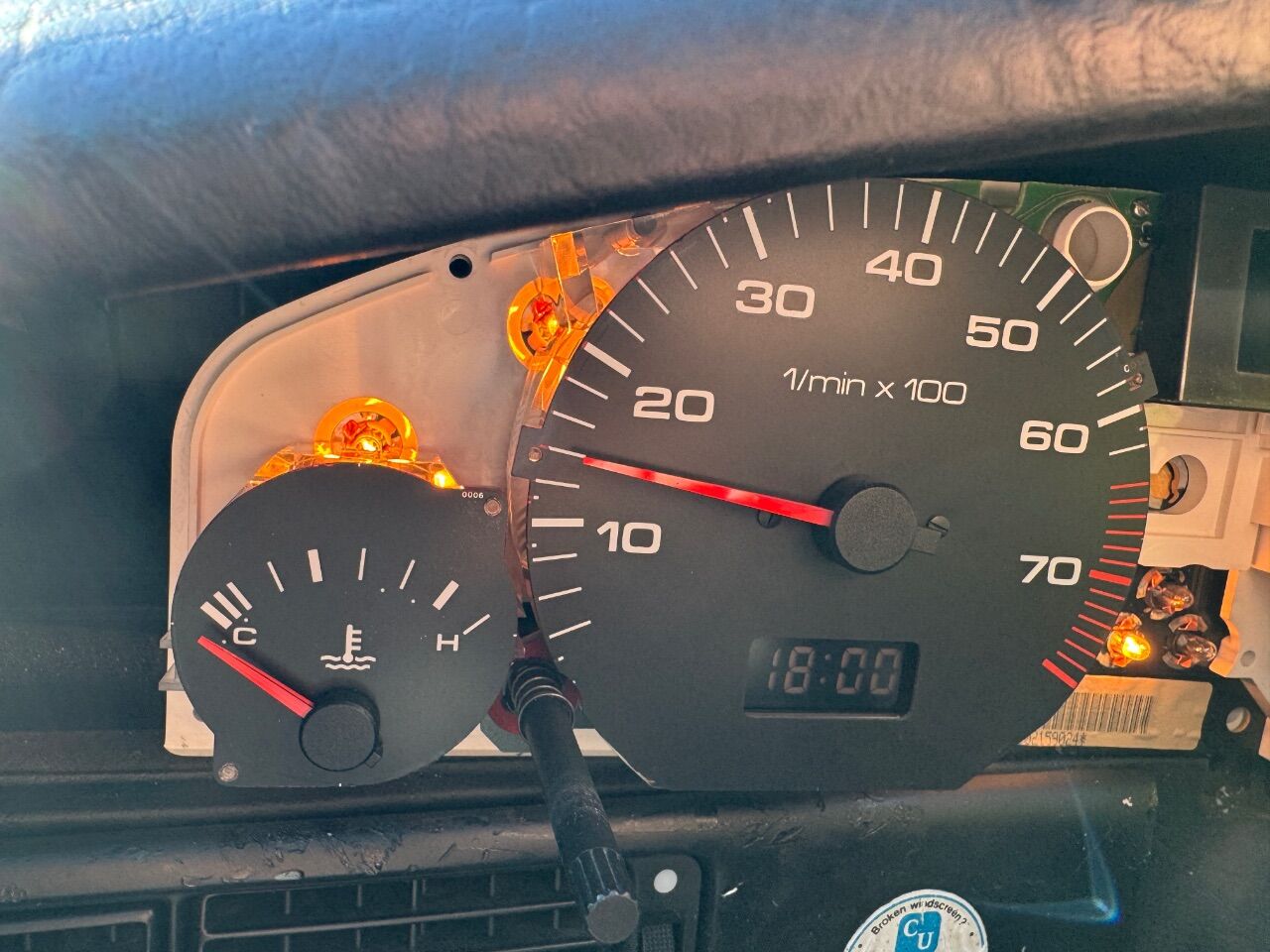

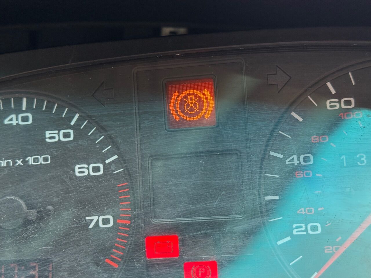

Today, I appear to have no rev counter.

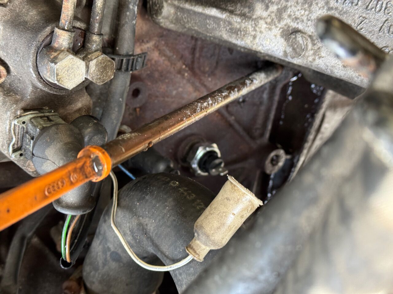

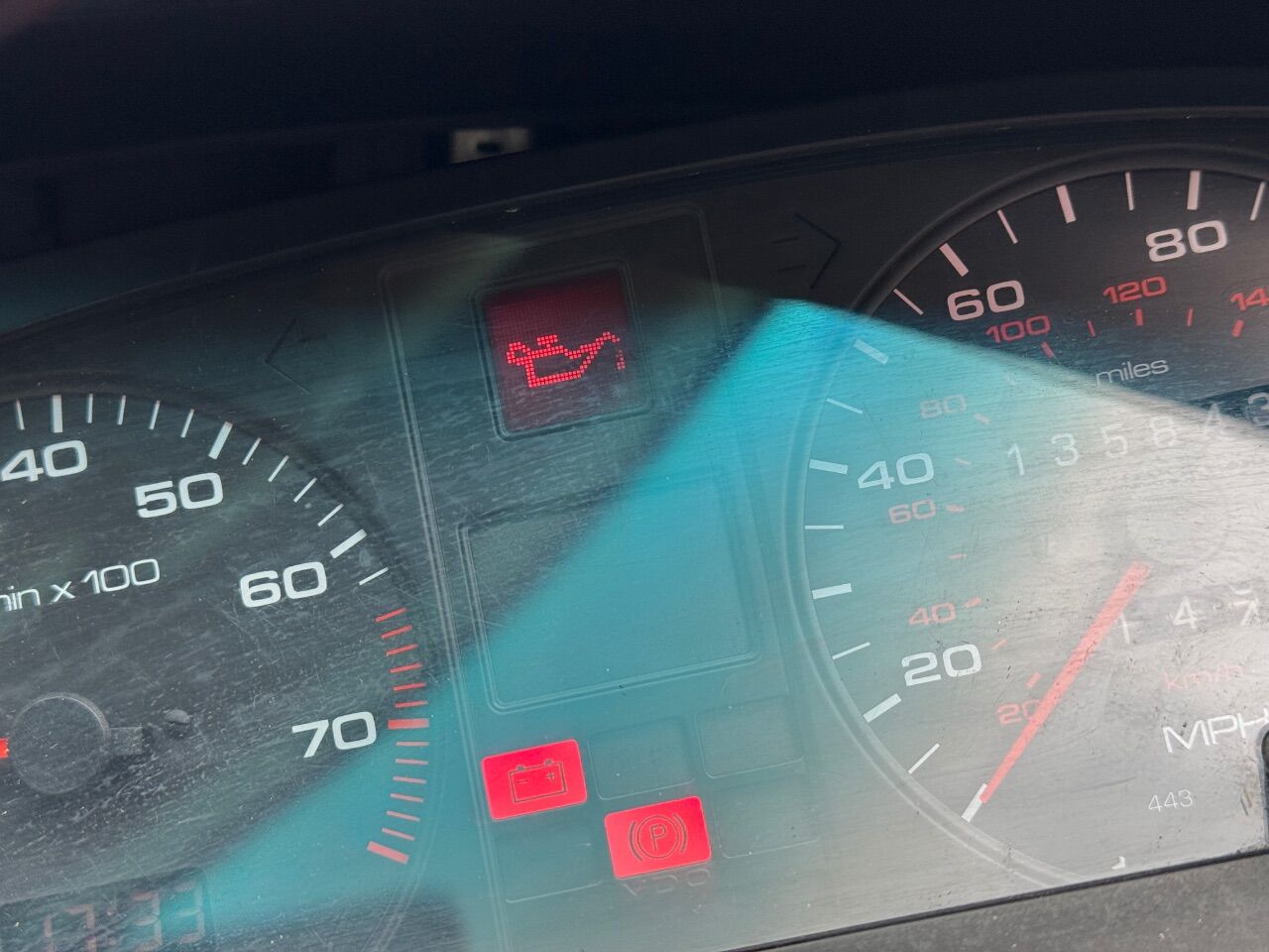

However, I have been poking wires, and reconnecting the weirdly-joined-together oil pressure switch wires. The oil pressure switches are new, the blue (upper) one is for idle, the white one is for 2K-up RPM. However, the white one appears to be a black switch instead, so I've ordered the 1.8-bar white one that belongs there.
It has started every time I want it to.
It has not scared me or made weird noises, but it beeps a lot because of the Autocheck system. The autocheck system has been neutralised with force...
The coolant is low, I do remember these being an absolute pig to bleed, but the fan's working and the temperature gauge does wake up sometimes. I suspect thermostat may be absent. Not like it's hard to work on.
I have found some rusty bits near the rear valence, like a reinforcing bracket. Very tempted to get this fixed properly if I don't find anything else worrying.
The seats are comfy, and the seatbelts do seatbelt things including adjustable height which is why my dad should have got one of these and not a Passat.

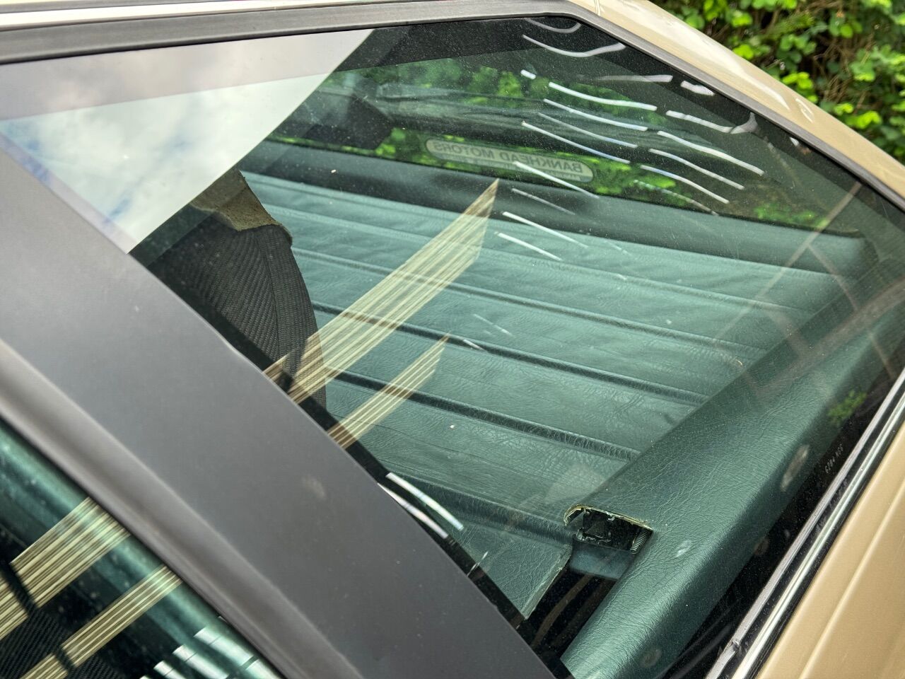

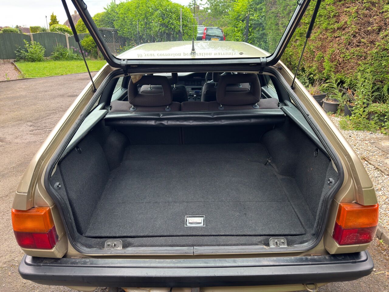

The sunroof opens and closes easily, and would be perfect if give a new seal that stays stuck on the edge - and the energy-efficient windows are excellent, working even with ignition off :) The central locking works and is a proper blast of nostalgia watching all the pneumatic lock pins drop.

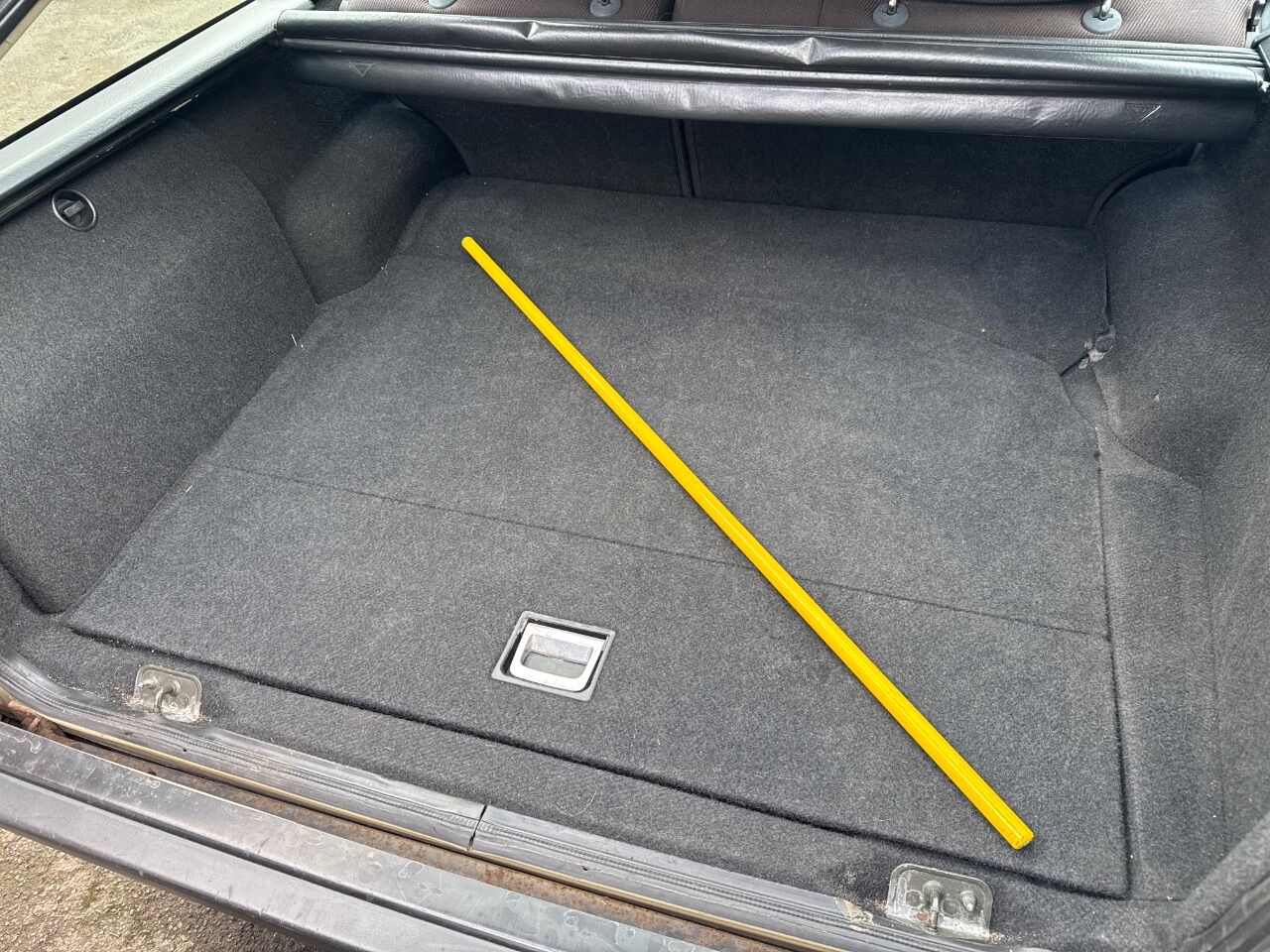

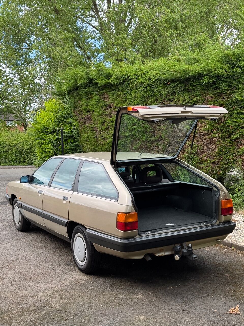

The tailgate is very heavy when you want to put shopping in and can't manage the BRIGHT YELLOW STICK OF DOOM to prop it up. I have two new gas struts on the way.
The engine bay seems to clean up quite well and it only tried to close the bonnet on me once. New struts in basket, but not ordered yet. Weirdly, I keep finding rust flakes/pieces that appear to be totally unrelated to any part of the car - like, it's been driven through some rust and it's all piled up, but you can sweep it off the inner wing or chassis leg and find a perfectly good painted panel there.
It has a secondhand electric mirror on the way from Lithuania and a new (pattern) mirror glass on the way in case the shape of a LHD passenger mirror is different to a RHD driver mirror.
The non-torch key seems too worn to turn the ignition.
I keep leaving the lights on.

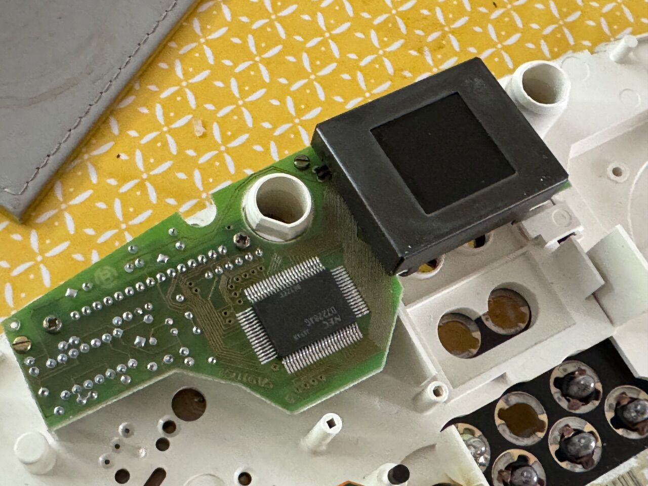

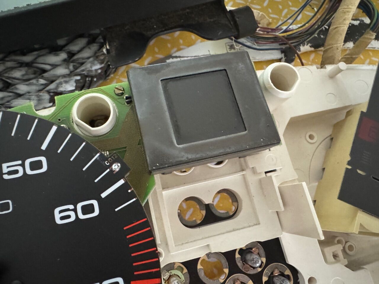

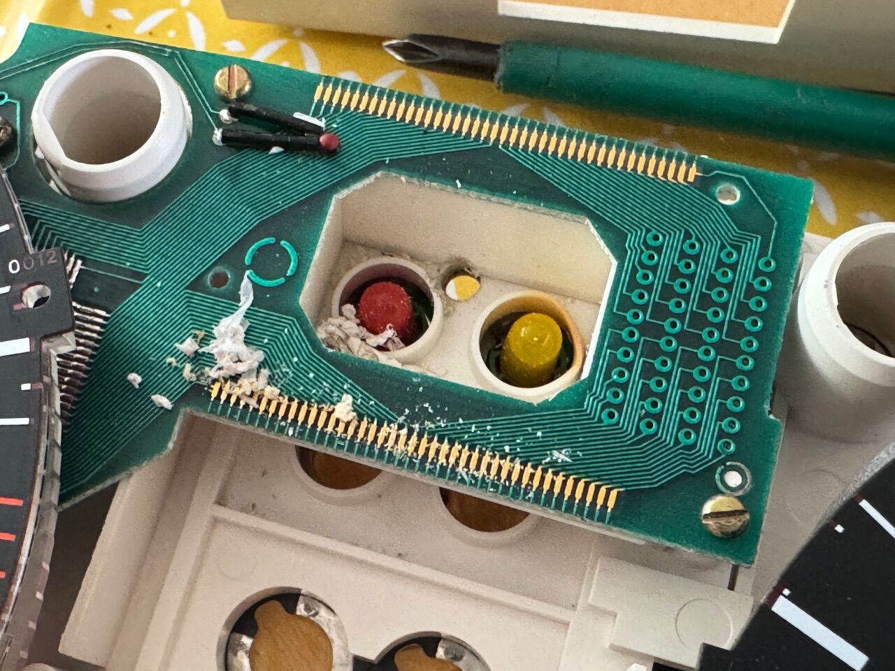

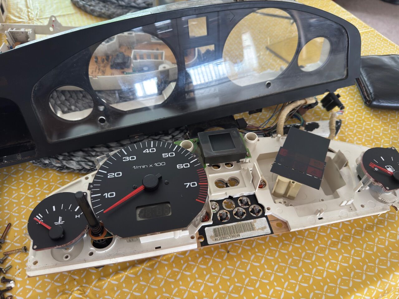

Secondhand dashboard acquired to see if I can repair the warning light system (this one has been physically abused ) and find out what the beeping alerts are for. Current candidates are:
  • Low brake pads. It definitely seems to complain with beeps after braking.
  • Low coolant. It was low.
  • Low oil pressure. There are two new sensors on the engine. The wires were joined together rather than to a connector, which just makes no sense. However, when I reconnected the sensors, the rev counter stopped working - now it just jumps to 1150rpm and stays there even when the engine is running.
  • Low temperature. It hasn't warmed up until parked in traffic.
  • Y2K error. I mean, it's possible.

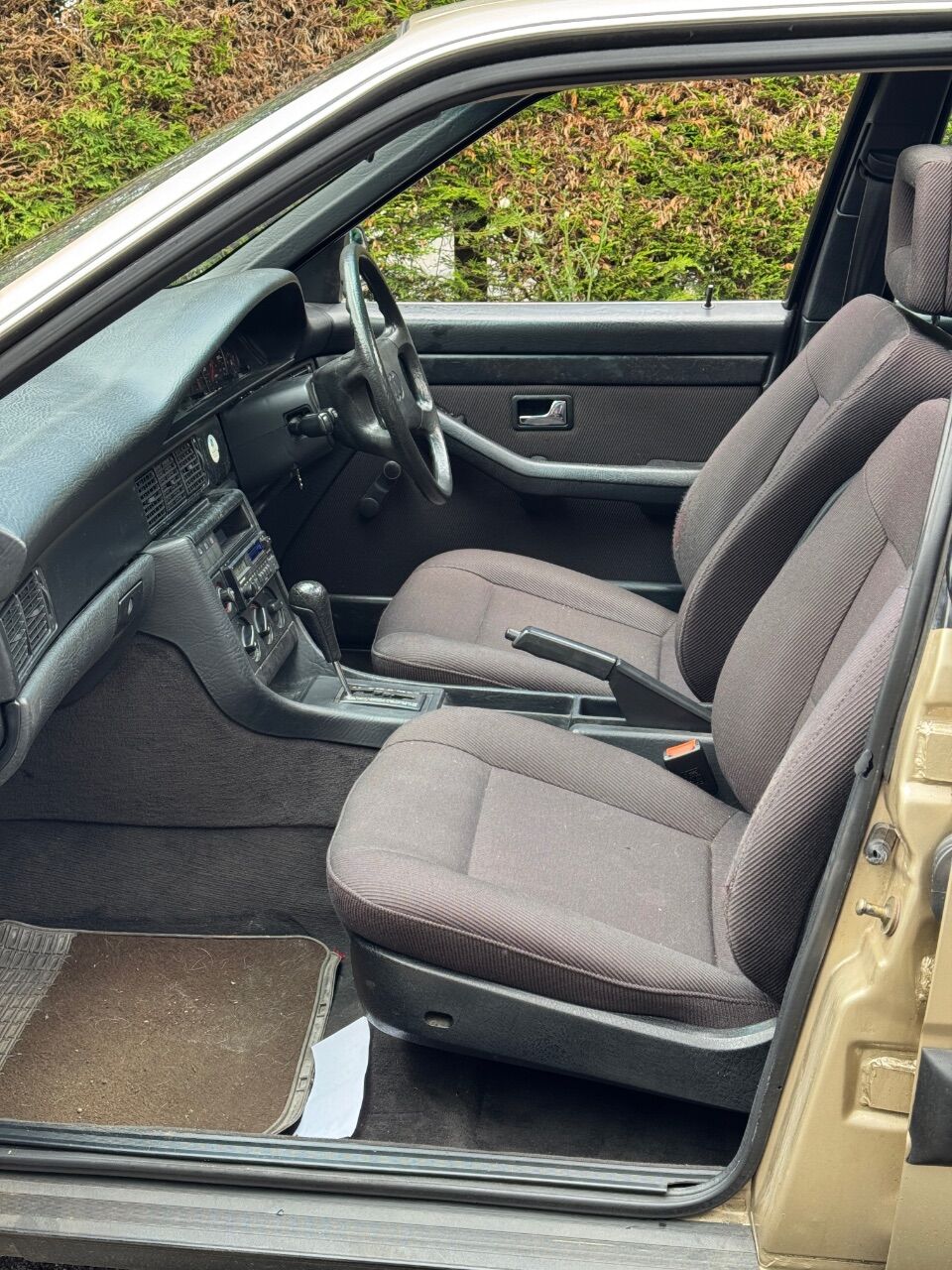

Would love to see some shots of the interior when you get the chance
Just went out for some hydraulic fluid and degreaser, so...

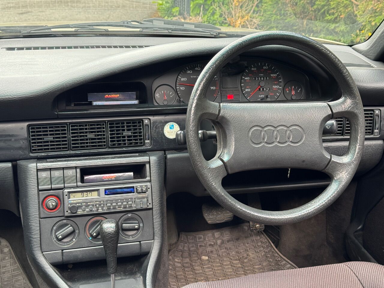

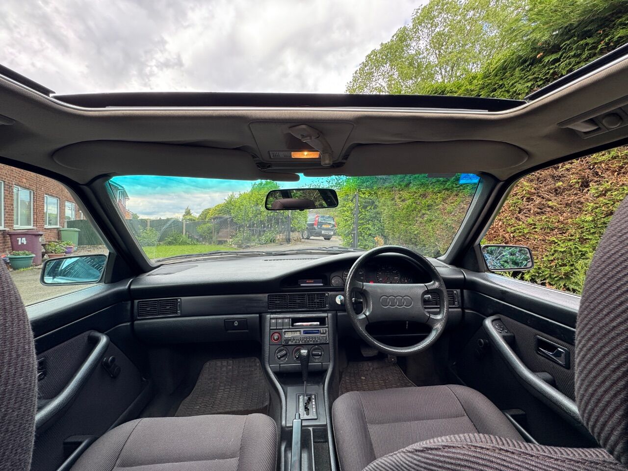

Enjoy the expansive basic-ness of a 1989 Audi...
If it hadn't gone all sticky with the strange soft-touch coating failure on that centre strip, the dashboard would be really nice.
Radio needs a new m/a switch, pen holder is disgustingly sticky AND I broke the remaining tab trying to clip the front edge down. Ugh.

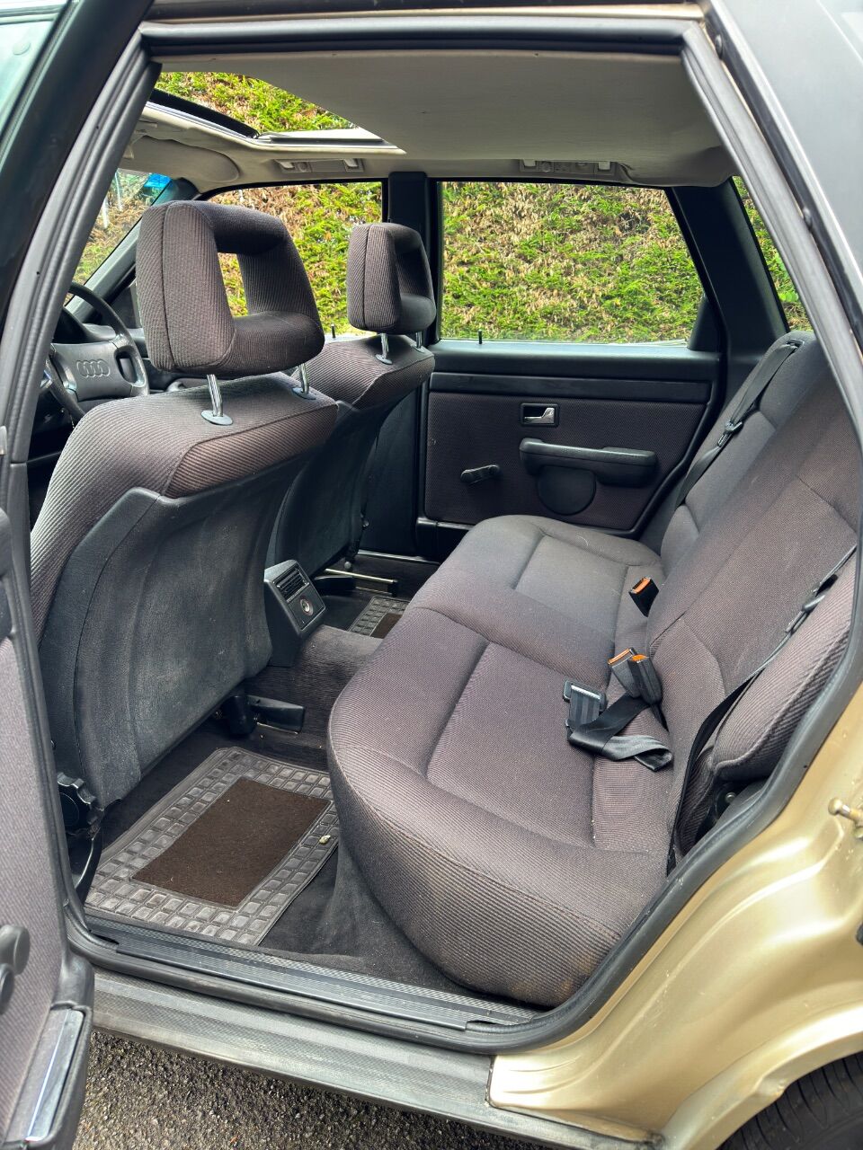

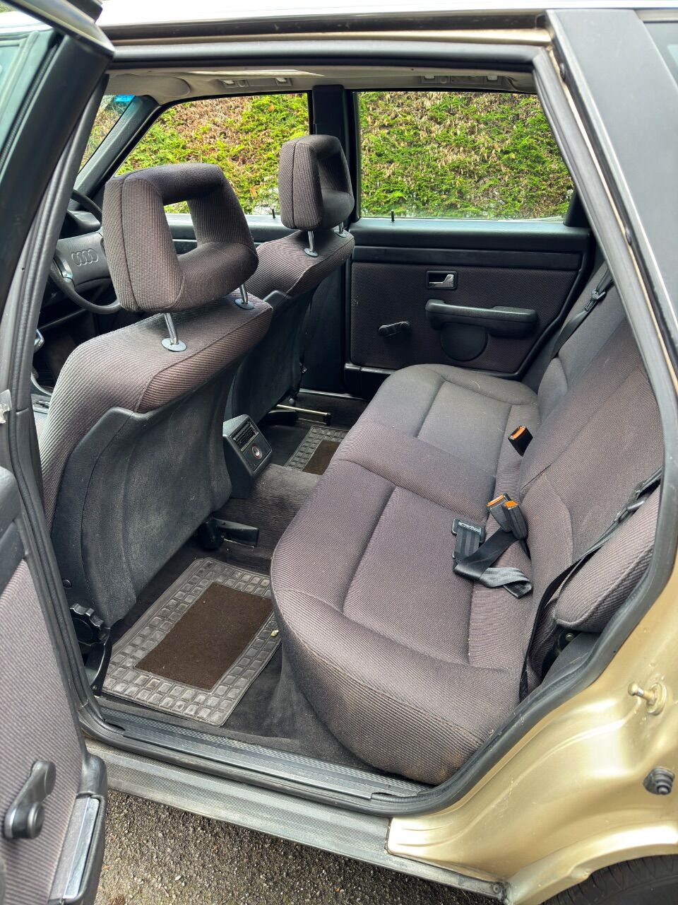

Seats have aged well...

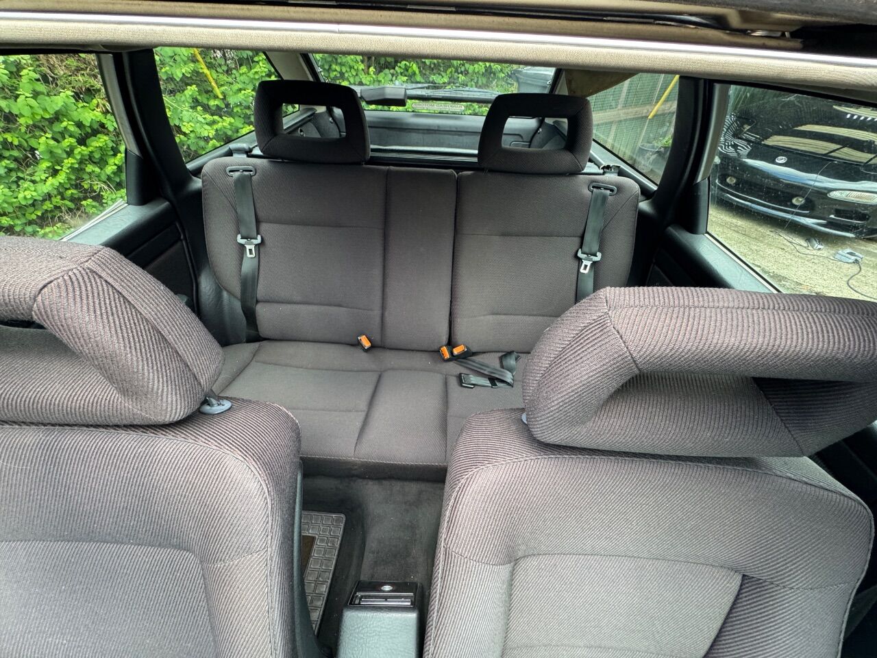

Centre lap belt for maximum sibling fight potential. HUGE amount of legroom!

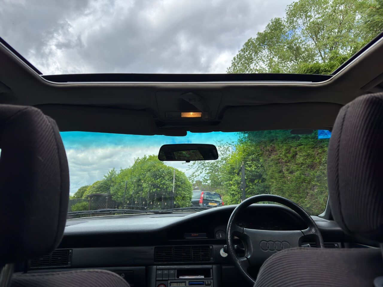

And the sunroof is nice for people in the back too, even if it is small and metal.
I like sunroofs.

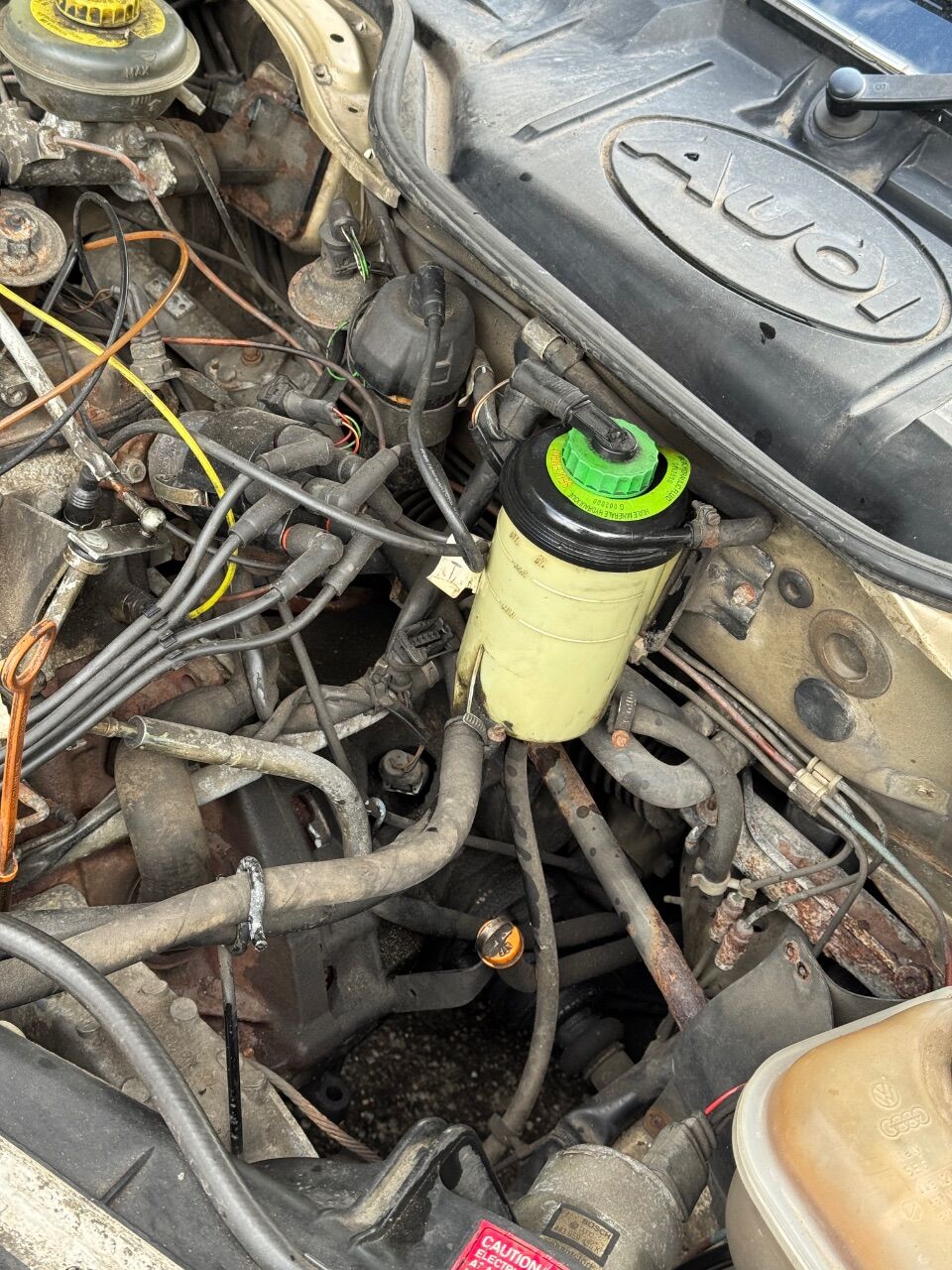

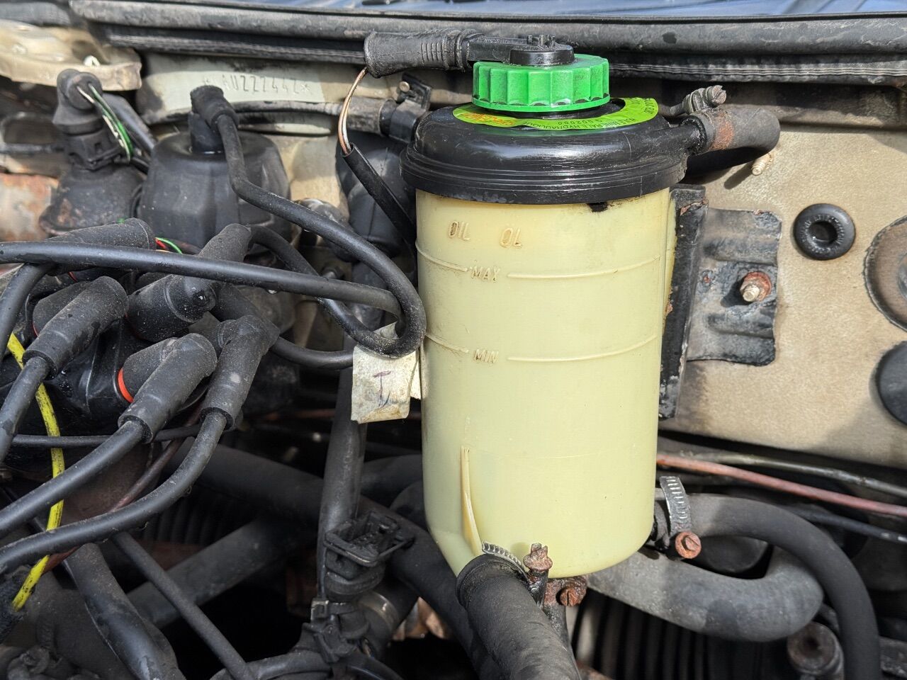

One possible warning beep eliminated - the power steering fluid was low. I am sure it went somewhere and I'll find out where soon enough.
Fixed a clonk when opening the bonnet by moving the fuel filter across and away from the bonnet strut.

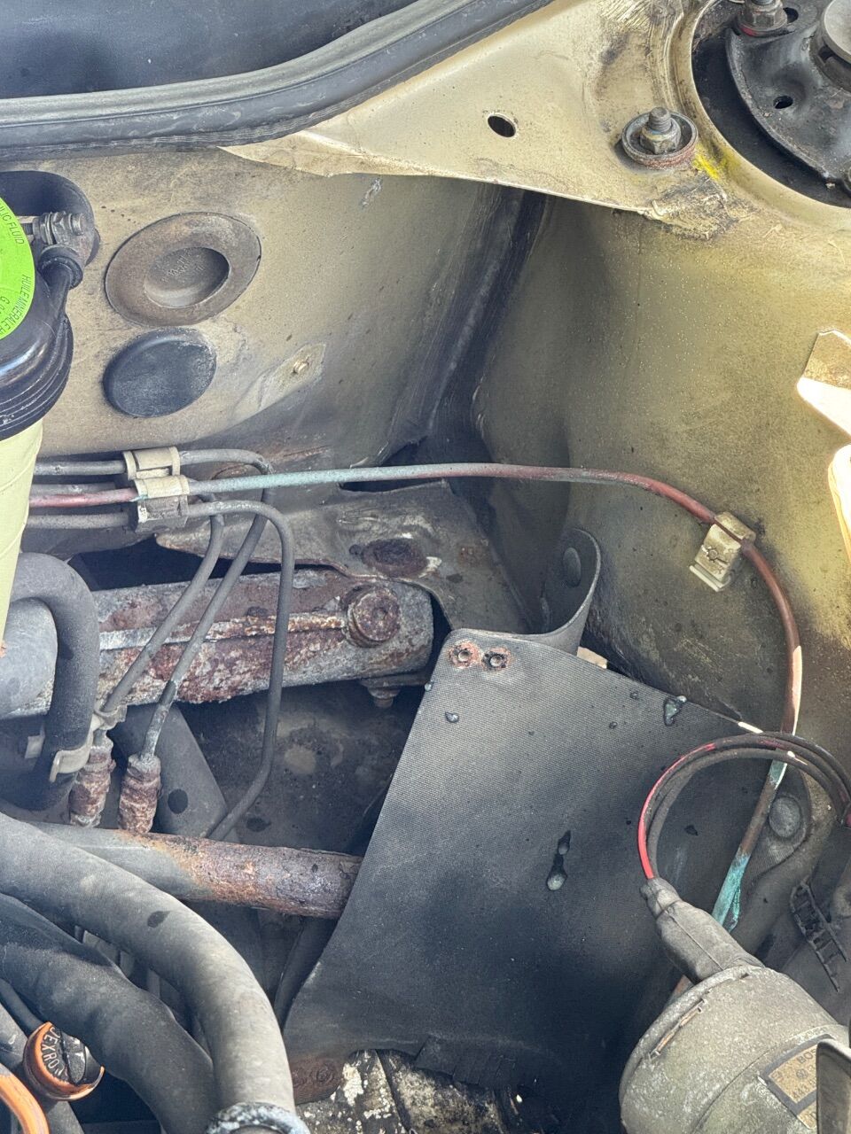

Grubby, but not rusty. I'm cleaning these places then applying loads of waxoyl as I go along.
I reckon some of the rust flakes I found are from that steering arm.

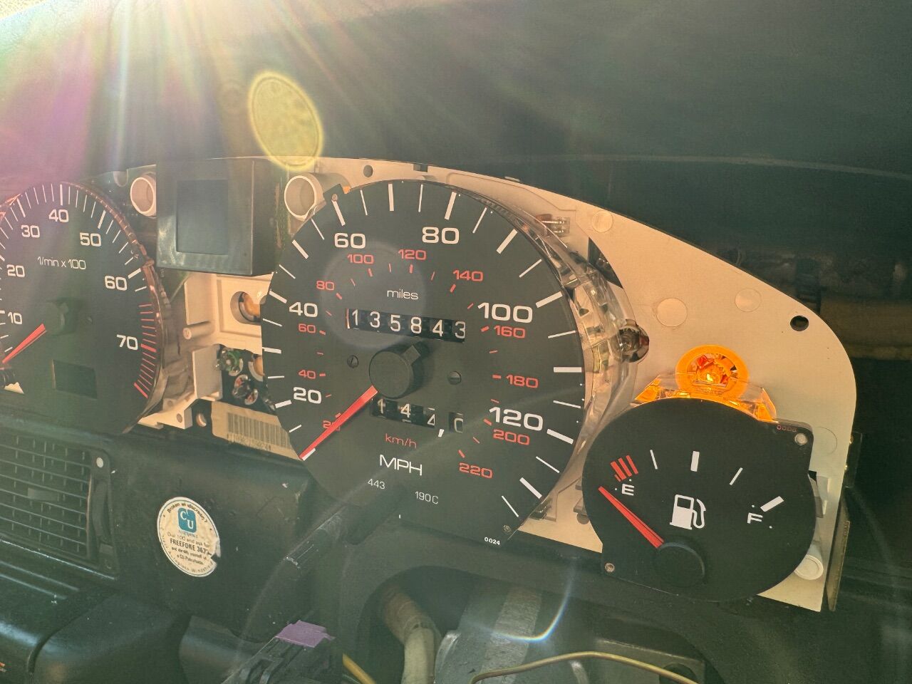

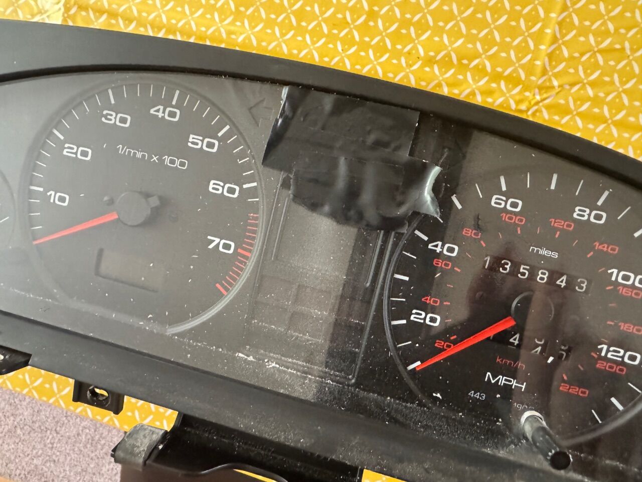

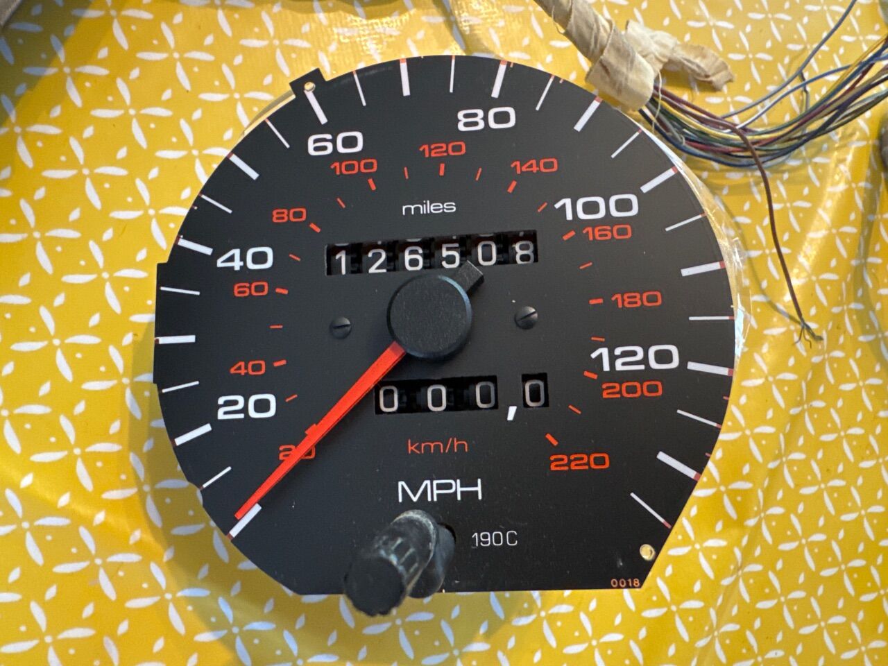

Dashboard light small ones because I can't make them go away after uploading them in this post to use in the one before!
That is a thing of beauty.

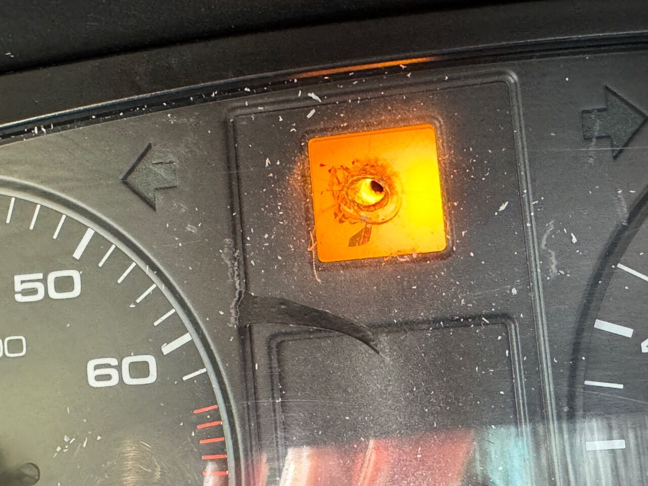

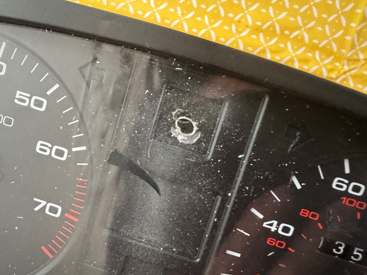

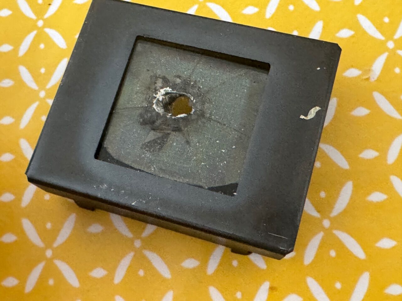

Apologies if missed in the above, but any ideas why the drill hole through the main dials?
(Aware I did that on a Xantia years ago to fix a rev counter, but was a much smaller hole and hidden :) )
I suspect a very persistent warning light and an attempt to kill it in frustration, since it is quite distracting. It's why I've bought a whole secondhand instrument cluster to try and repair it, rather than just replacing the display on the autocheck and going over the board for bad components/solder issues.
My 80 would suffer from a flaky rev counter... A smack on the dash top resumed normal operation for a couple of months.

I will be happy to fit a white sensor here tomorrow and put that wire back.

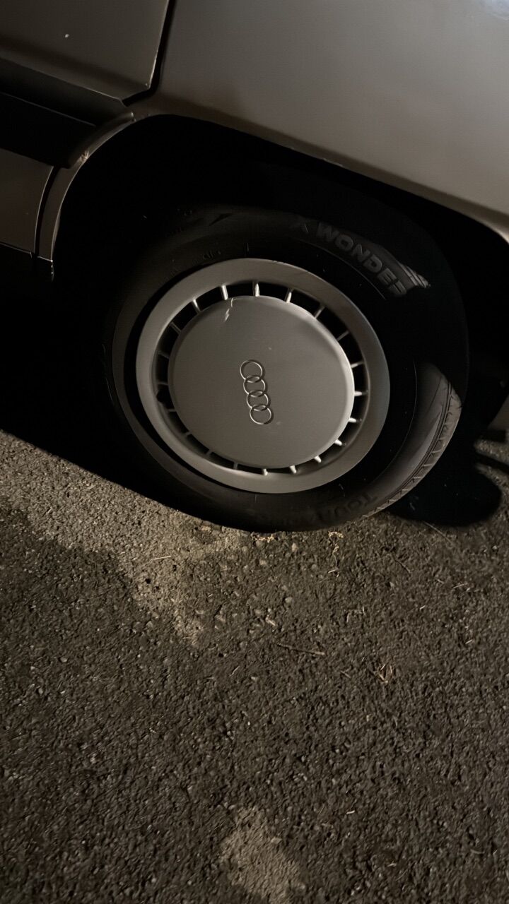

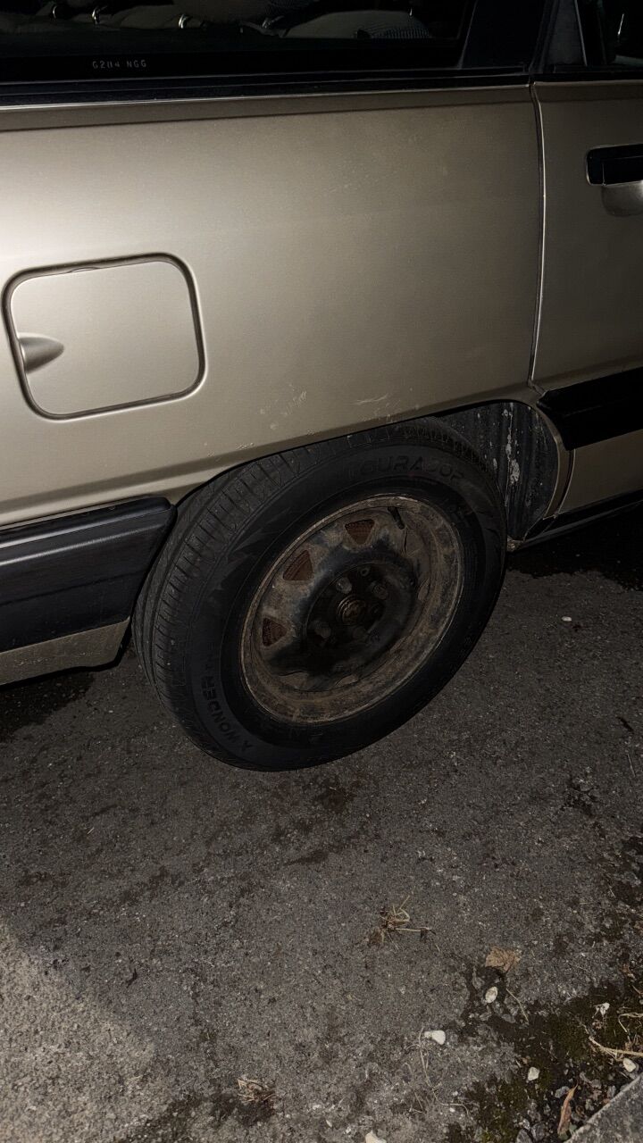

And... you know when you see American cars shed a hubcap on a drive?
NSR now:
OSR...
I think a really bad set of rippled road in Teversal is to blame, not that the car got jolted or anything - I now need two of these, because I noticed the OSF one is just a generic trim 😂

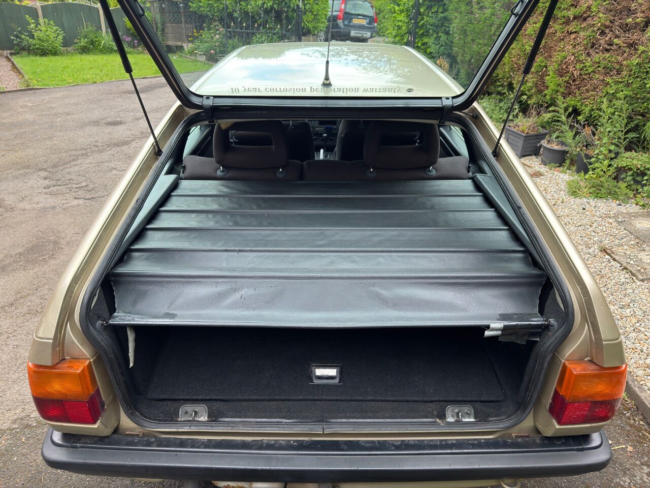

So, all this Avant action, and no money shot?
Too risky. I could lose my head.

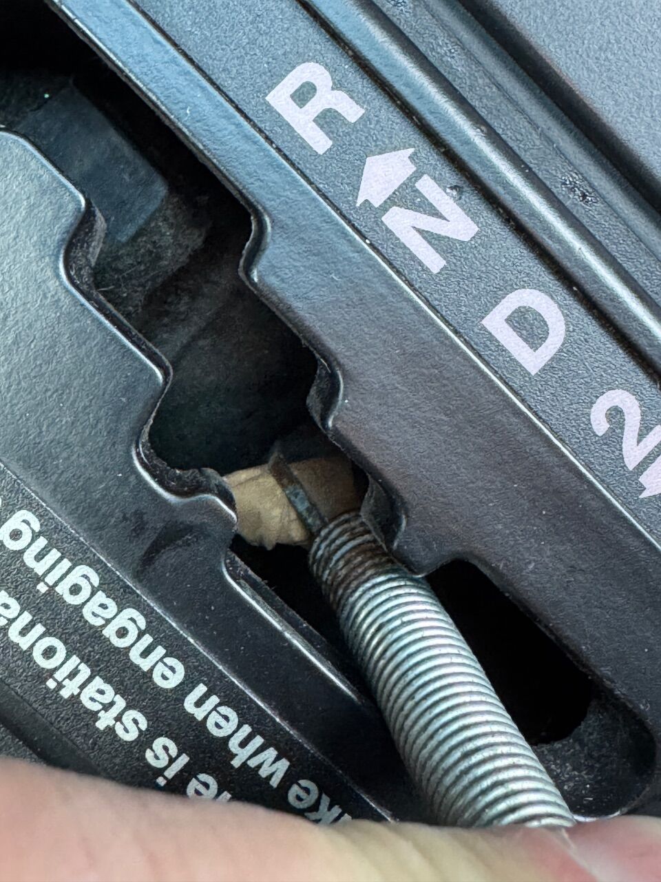

Final silly distraction of the day - you know the grabby claw games?
Fishing cigarette butts out of the gear selector 😂

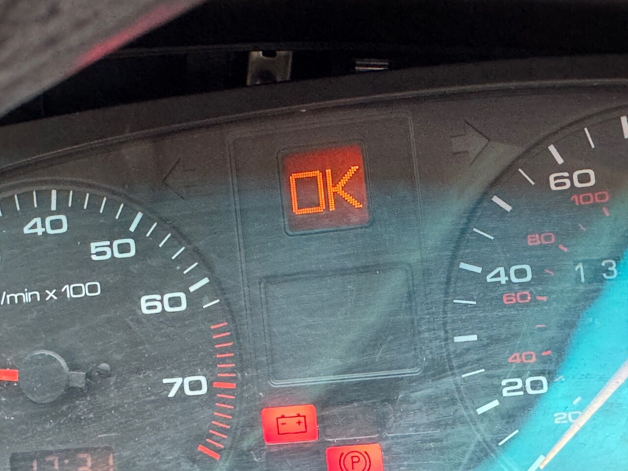

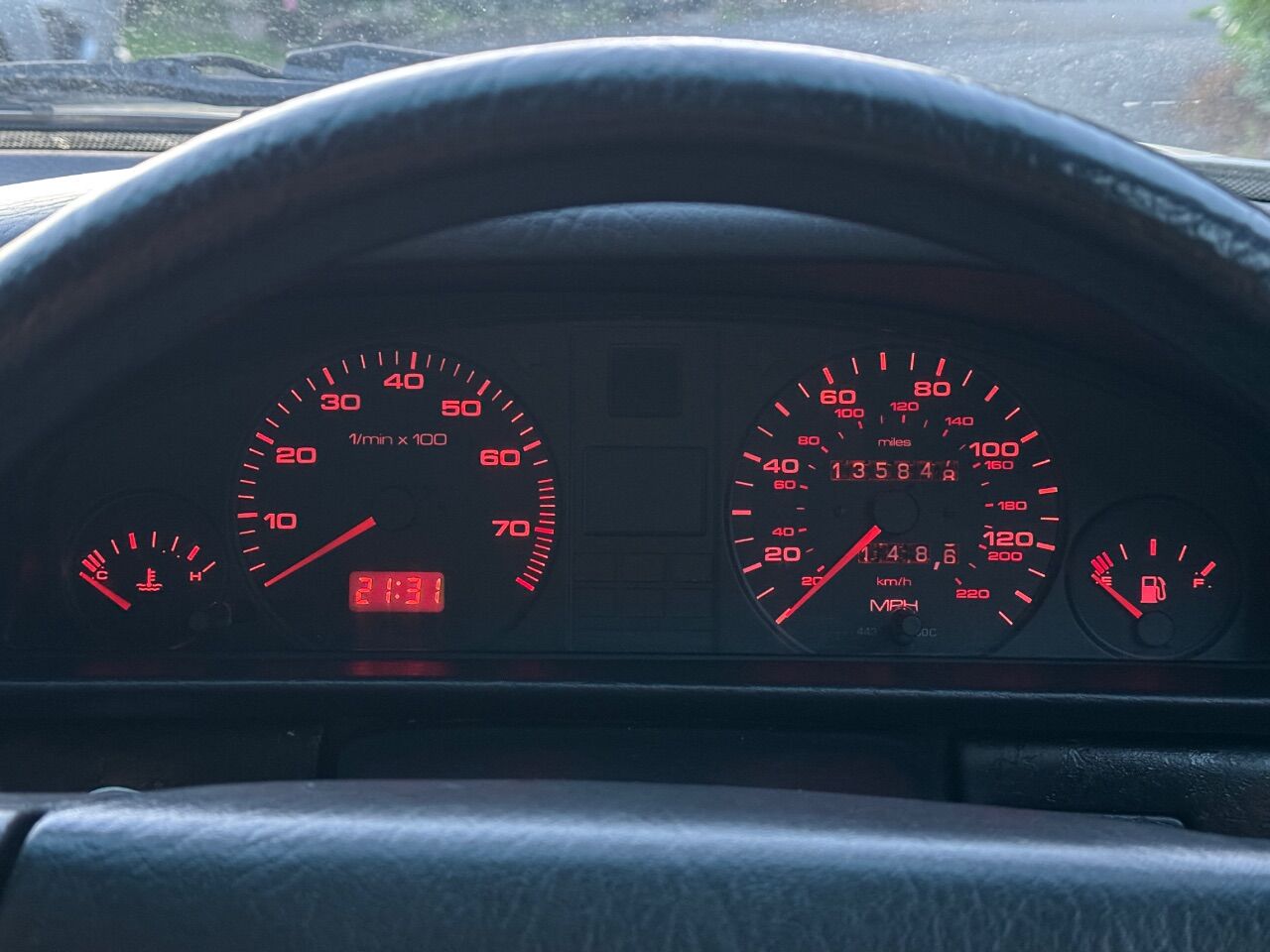

Oil switch swapped, wires wiggled for foglight, Autocheck unit went dark and stayed schtum! Also the lights-on buzzer has woken up. I didn't even know Audis had those...
