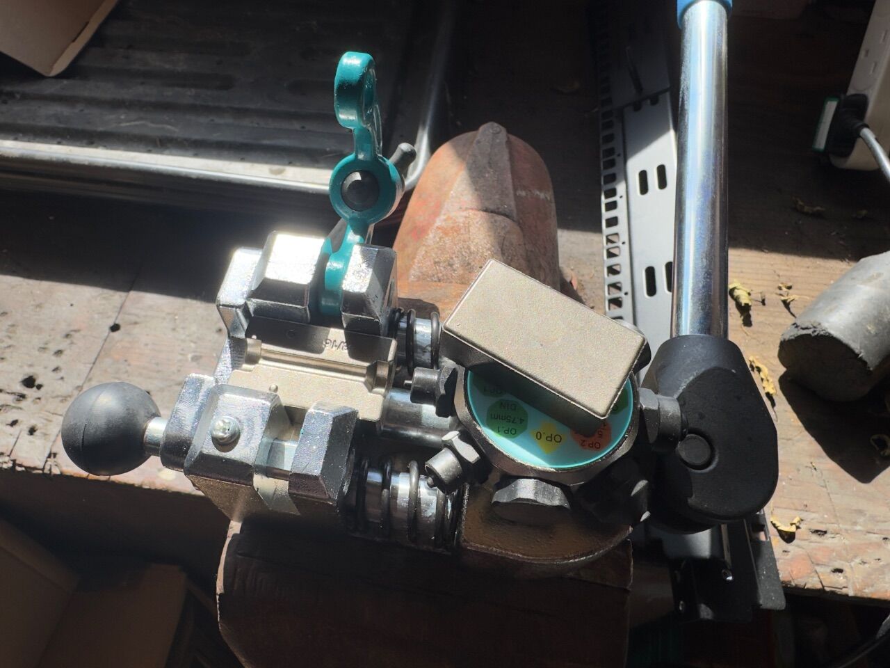

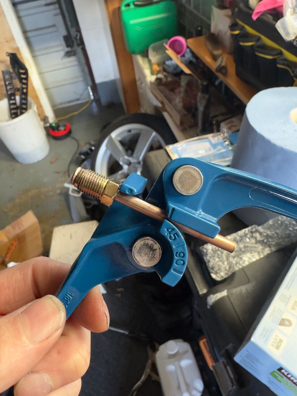

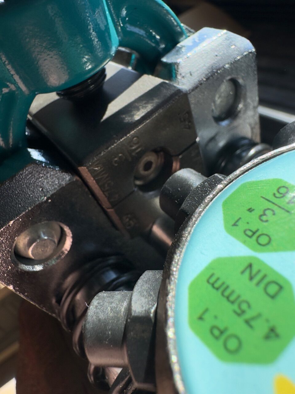

A little bit of flair (re)

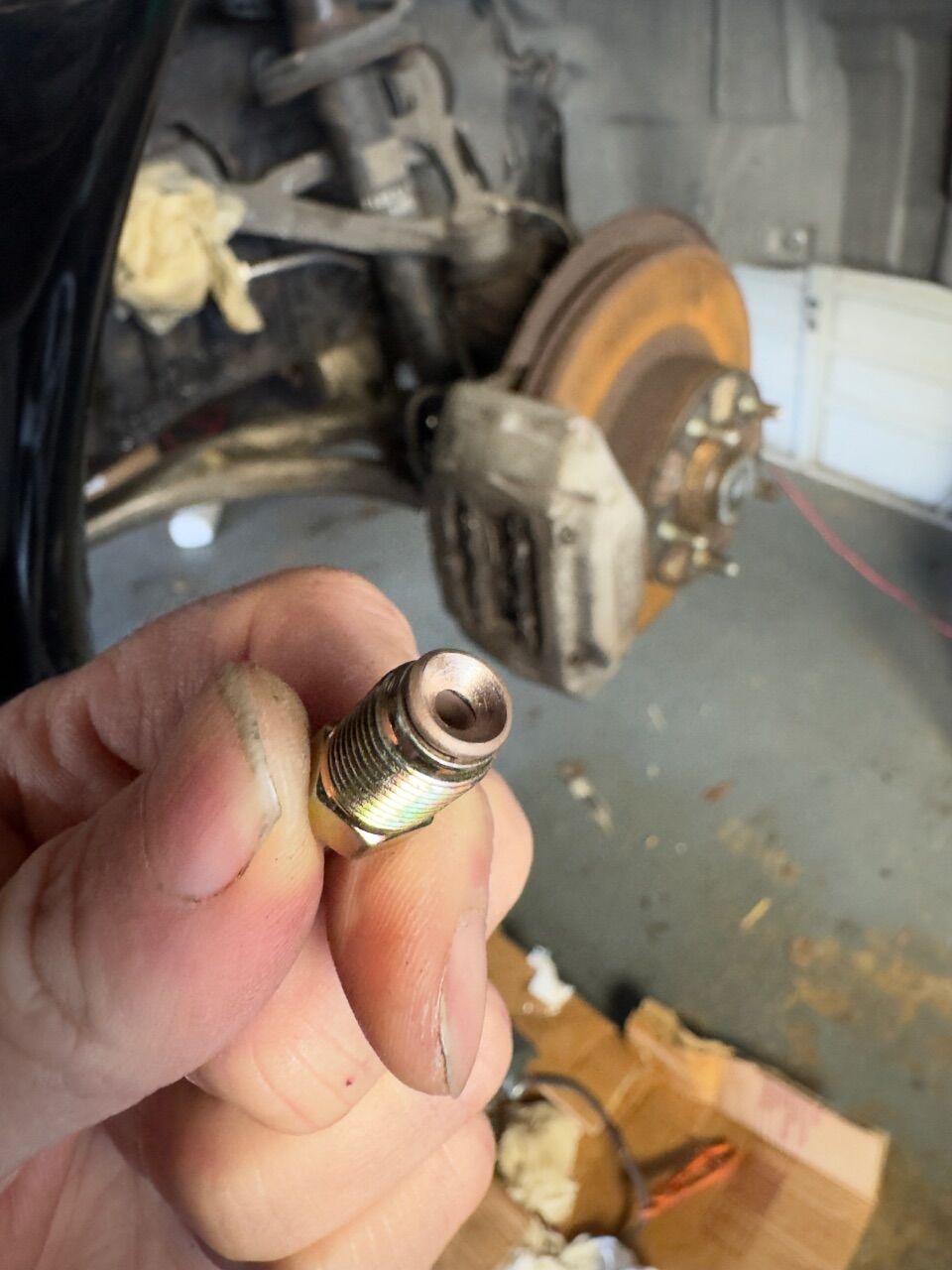

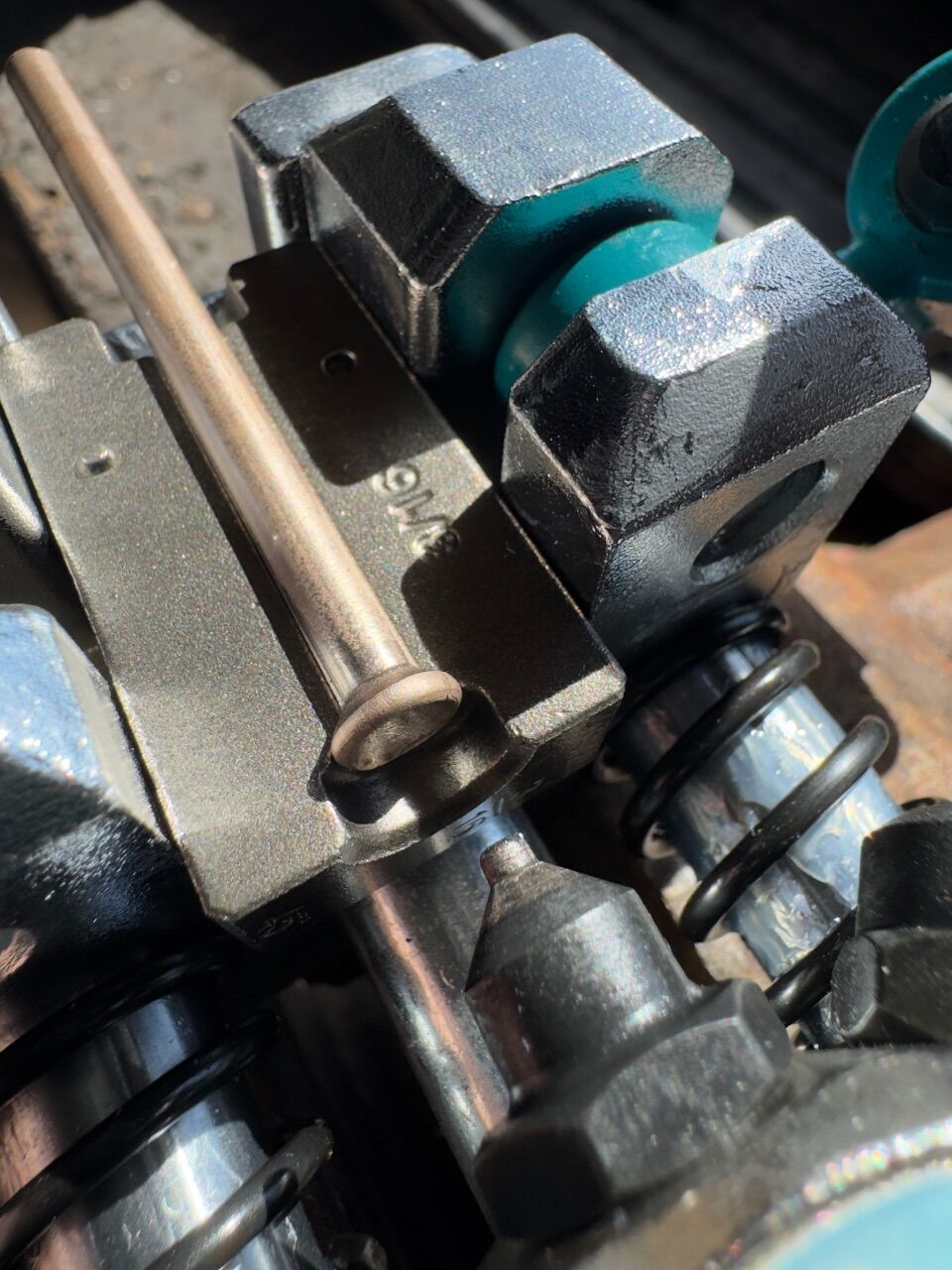

Try it out... Cut a little bit of pipe...
Put it in the die and guide, set using the "O" stop tool and it's flush, tighten clamp...
Select OP1 for the desired double flare, squeeze and get this...
Spin the turret for operation 2 and get...
That looks promising!
Try it in the hollow nut.
Yep, very promising...
Try making a bend (though this pipe is easy to bend).
Yep. I can make some replacement pipes I think.
Not perfect, but good enough for rock start and roll (and stop, hopefully).
That flaring tool looks bloody useful and a million times better than the one I have with a thousand pieces which I always manage to lose at least one of halfway through a job.
I'd quite like to redo a couple of the ones I made for TPA as I think I hold myself to higher standards than I did back in...2018 (eek!).

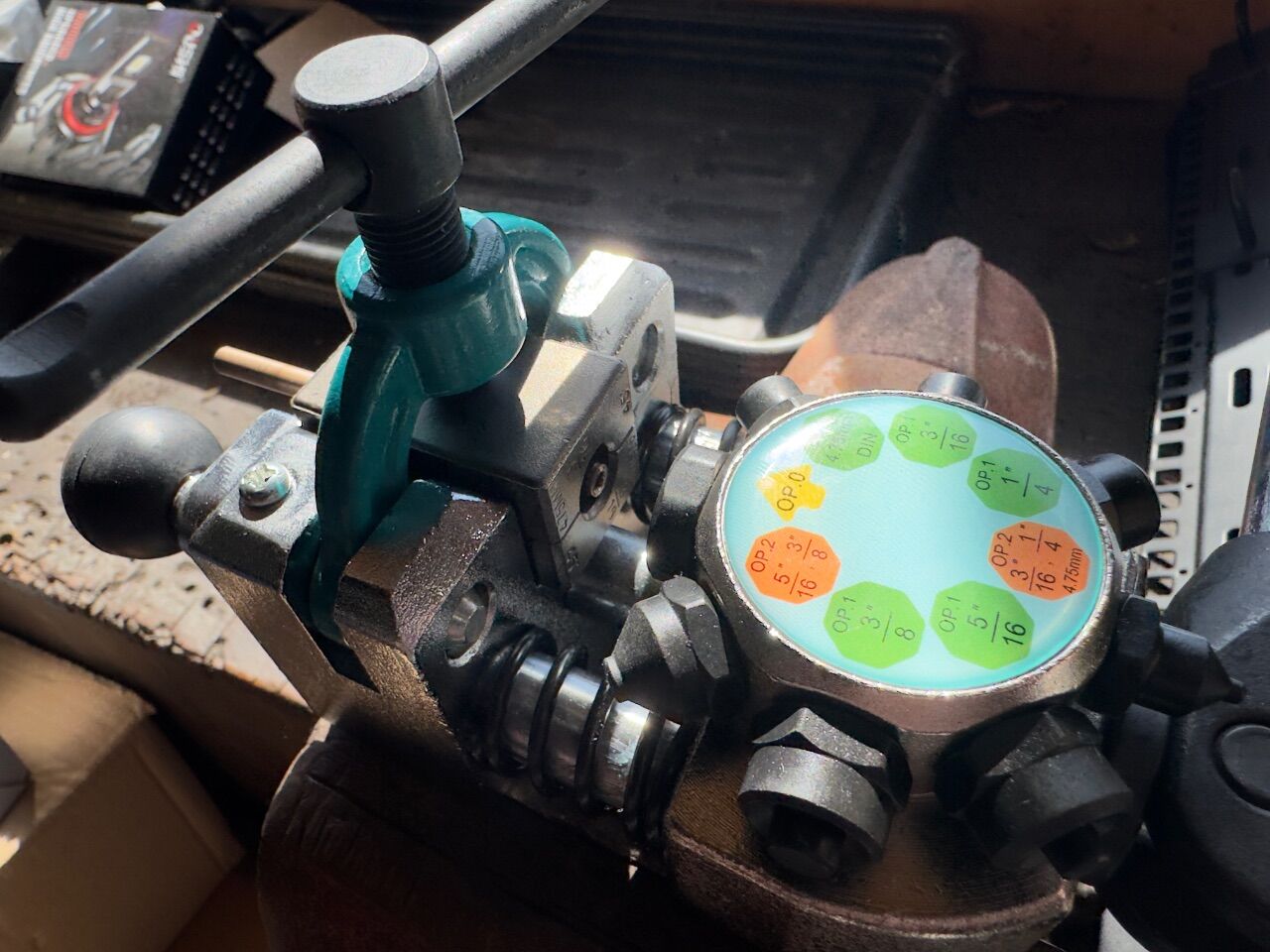

Well, you can use mine if you want, or they're sold under a million "brands" as dropshipped Amazon stuff...
This was the cheapest price and the next cheapest showed a pipe roller cutter but not next-day delivery - this one had the roller cutter in the one I got.
(The sponsored one is £79 and there is a more expensive package with extra dies).
"Zyncove" brake pipe flaring tool - £66 on Amazon
Works really well - drop pipe into the former, close the hinged clamp, set pipe distance with the flat tool + pull lever, then tighten clamp, then for the 45 degree SAE double flare set tool to OP1 pull, OP2, pull, done. Seems very neat.
I got a pipe cutter with a deburring tool as well, and the deburring seems to be the stage people have missed when using any flaring tools and getting shit results. I read a lot of reviews before buying anything - mostly because I wanted cupronickel pipes and Amazon is full of copper-coloured steel ones being sold as the copper alloy.
Does need a vice, but it was this or a weird Laser one with a chunky handle that I couldn't work out how to use easily and was nearly twice as much.

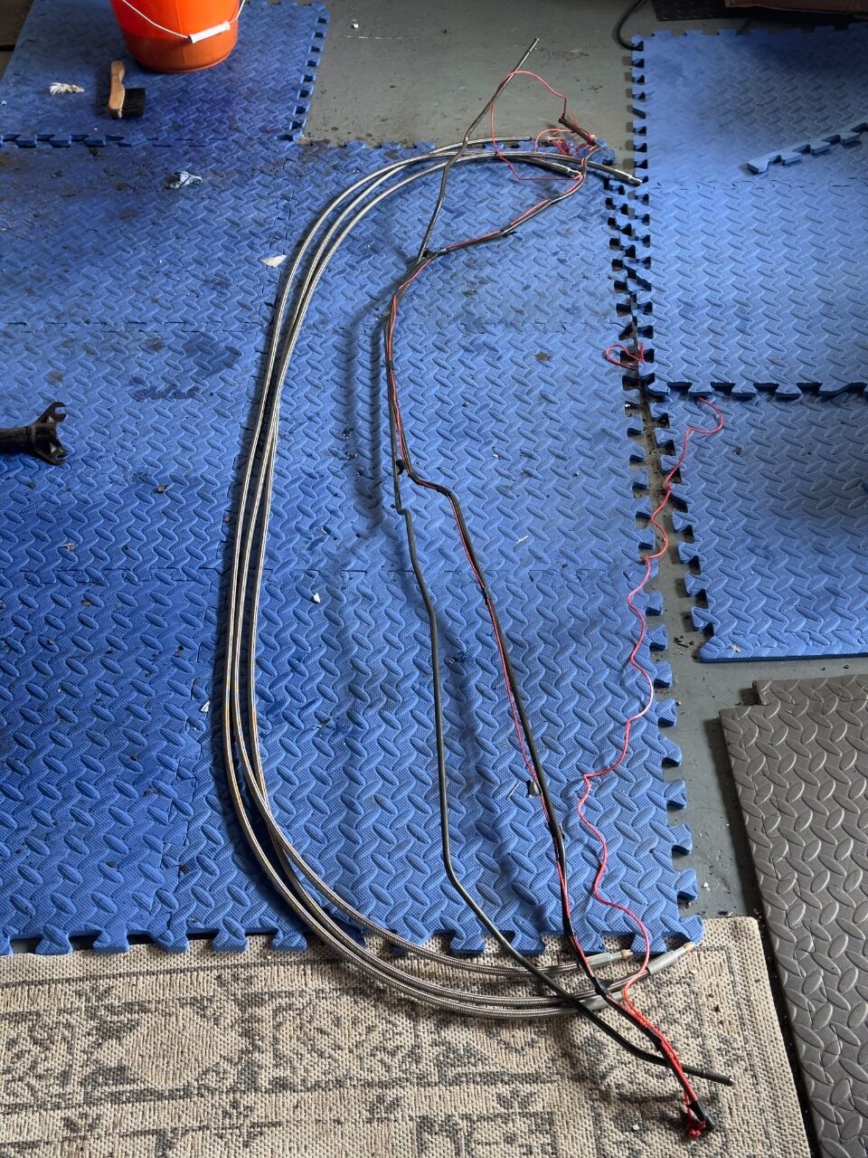

One more pipe done when I needed a break from the screen. Would have been a very quick job if the nut for the hardline had dropped into the thread properly, but for some reason that always seems to be a ridiculous faff.
Dreading the last pipe, but mentally preparing myself to replace the hardline from ABS block to front left and not undoing anything until I have clear mental space and time to do it.

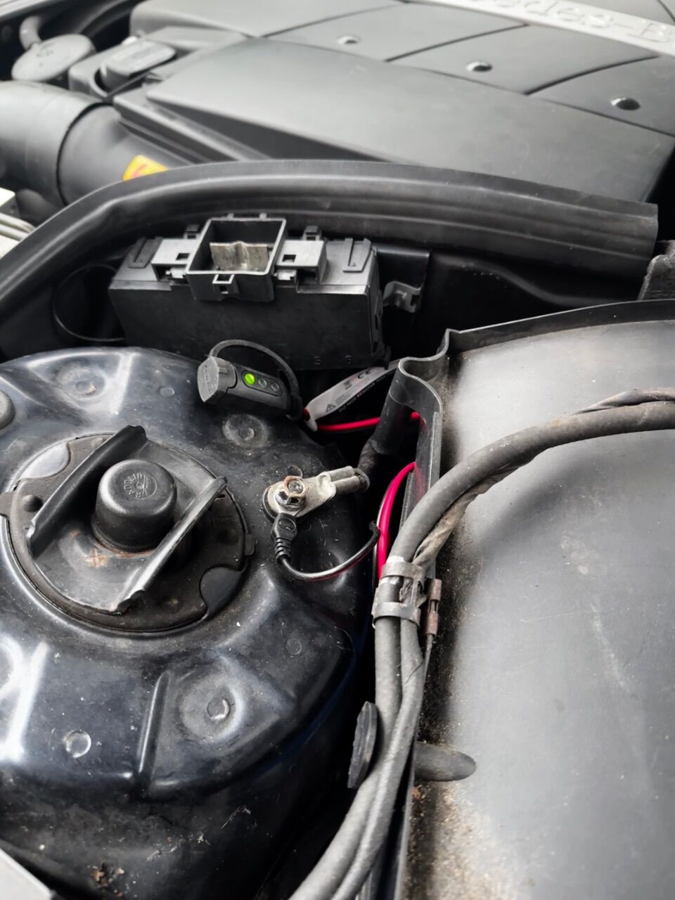

Still puzzling the Audi wiring. The headlight monitoring unit shares the same pin as the tail light one, but the missing line on the relay is a ground.
Now... could that earth knock out the dashboard? I do wonder if it could prevent the oil pressure switch from having a clean ground from the dashboard, if the relay is trying to find a path to earth for a signal.
Really wish I could shrink it into a Matchbox and get it out of the way until I've solved other problems.

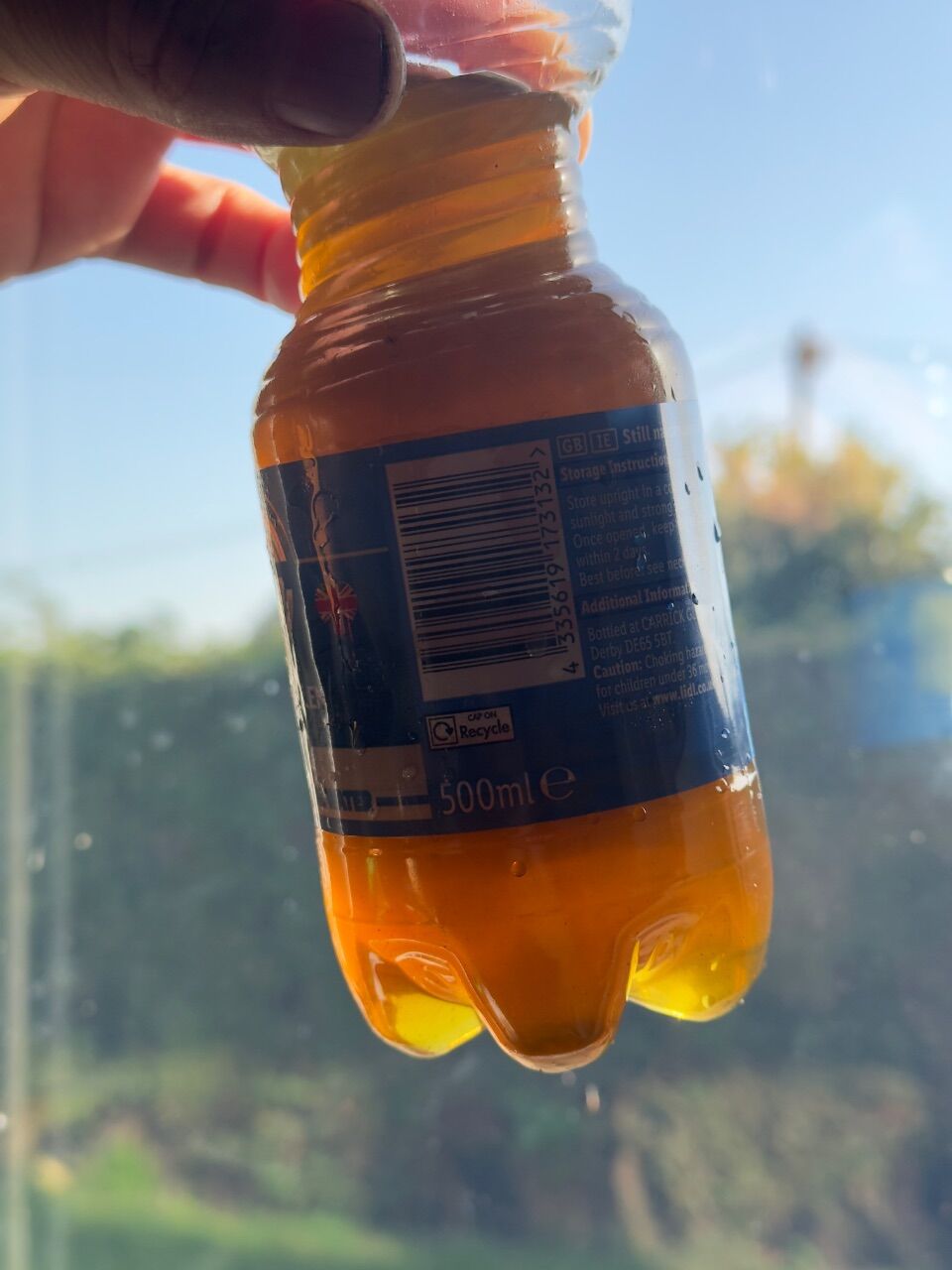

I hate doing anything with brake fluid, the pressure bleeder always spits some and I'm worried about paint or plastics.
But it needed evicting.

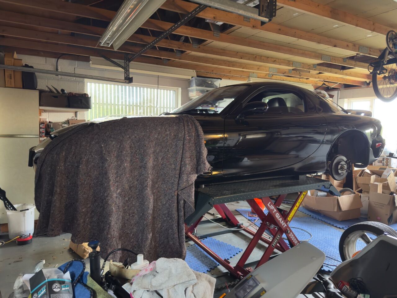

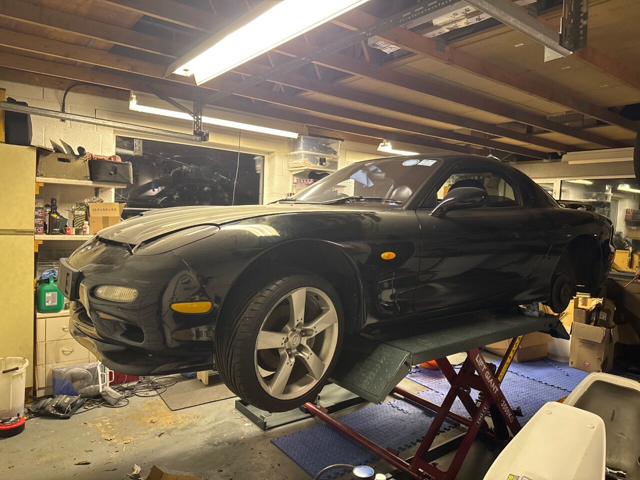

So...

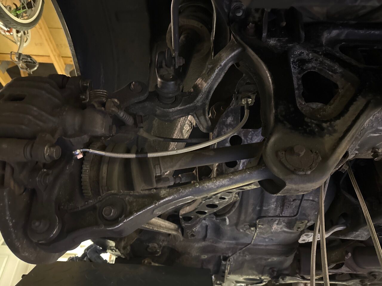

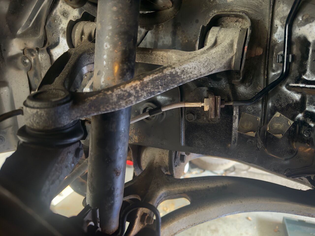

Front wheels back on.
Upside down phone...

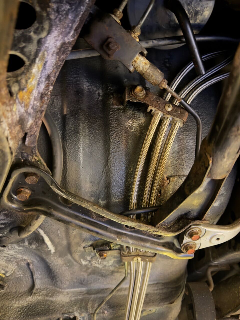

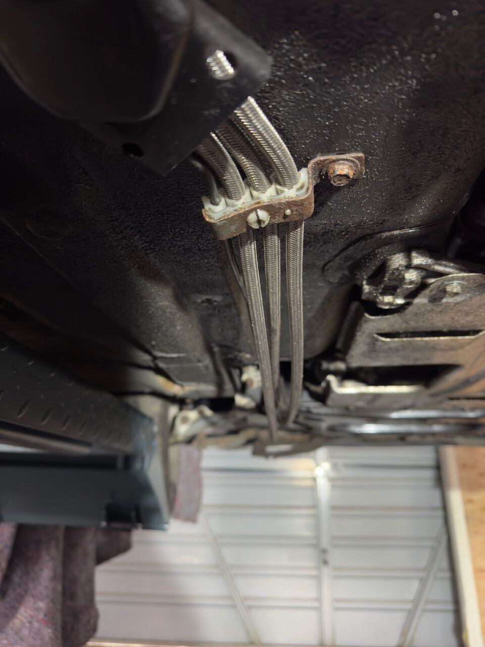

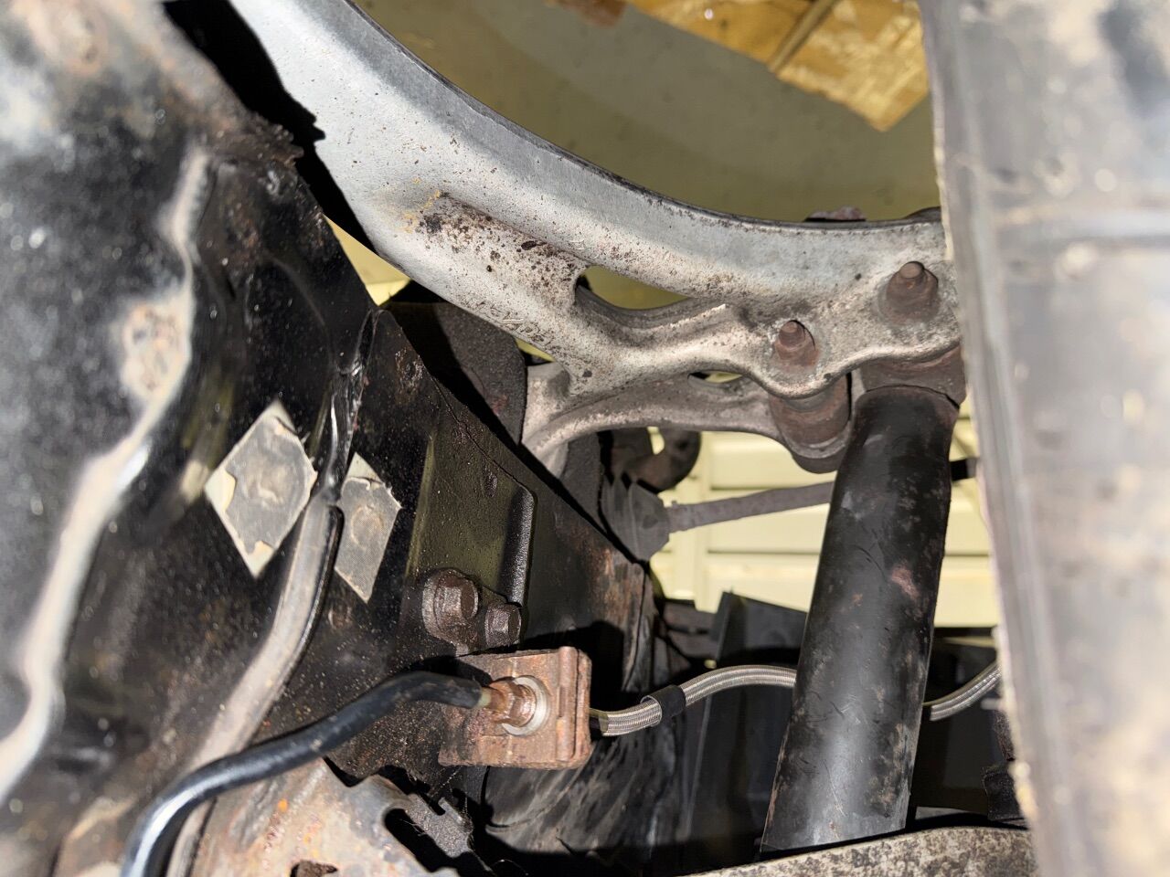

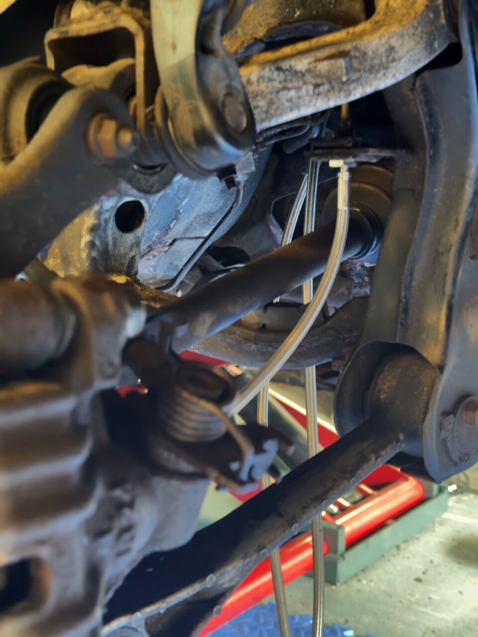

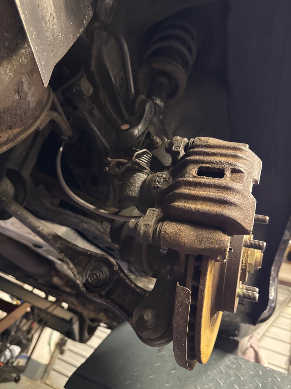

But new flexis and one new pipe...
Rust treatment after I know the car is mobile.
This challenge remains...
Refit the fuel filter bracket. Where?
Sort of up there...
The arches get a clean up, some loose paint knocked off and wire brushed then covered with rust gel stuff until I can do properly.
New flexis at the back looking okay. Brakes need removing, stripping and lacquering.
And before it sees a road properly I want a full set of EBC discs and pads.
Though I'm not sure it'll want to see a road, it bears all the traumas of a mid-2000s daily driver from London 😕

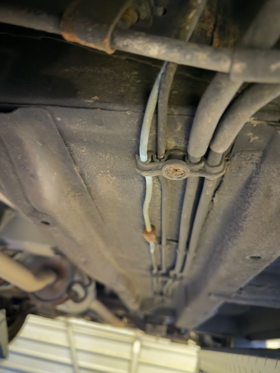

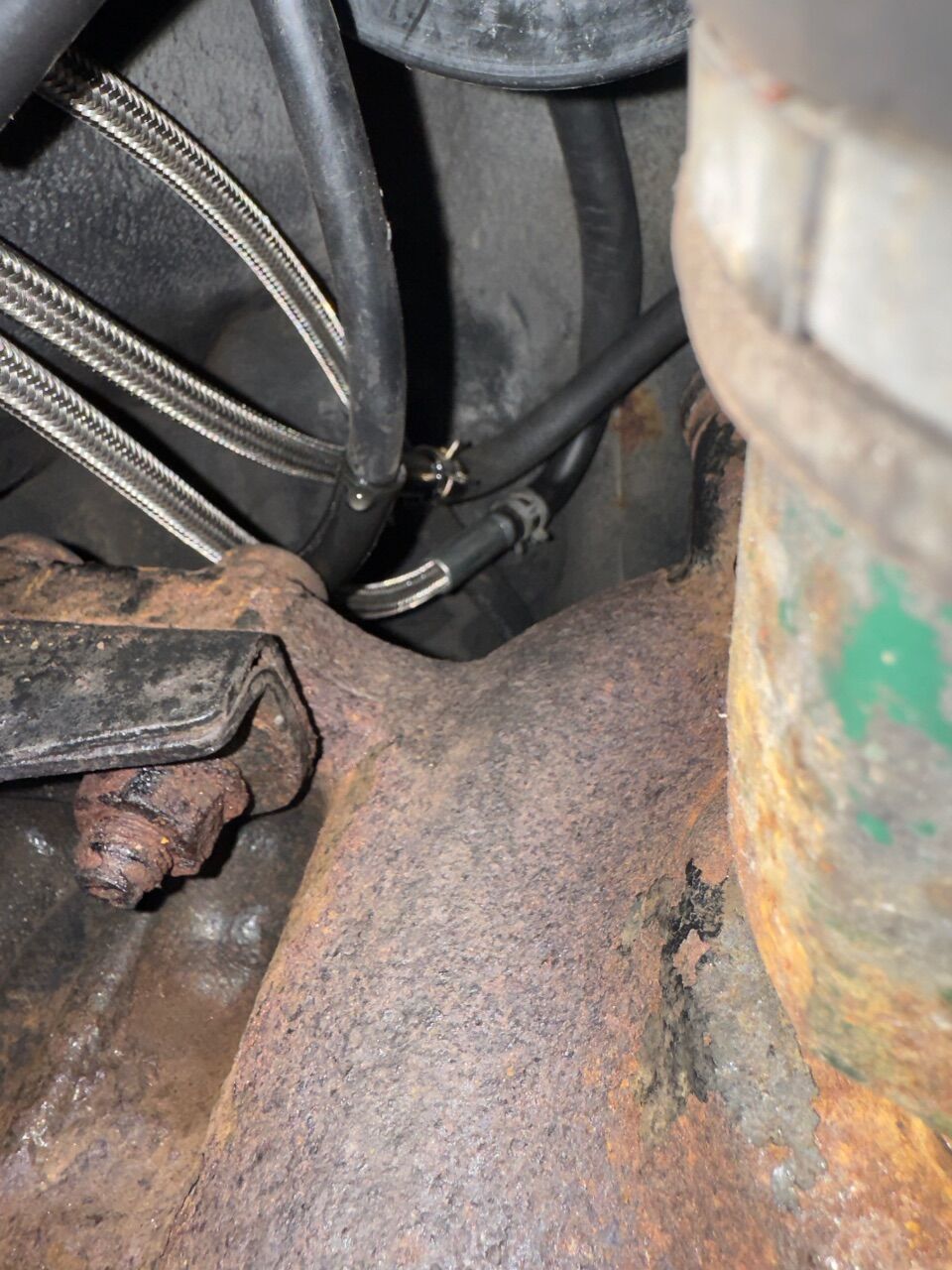

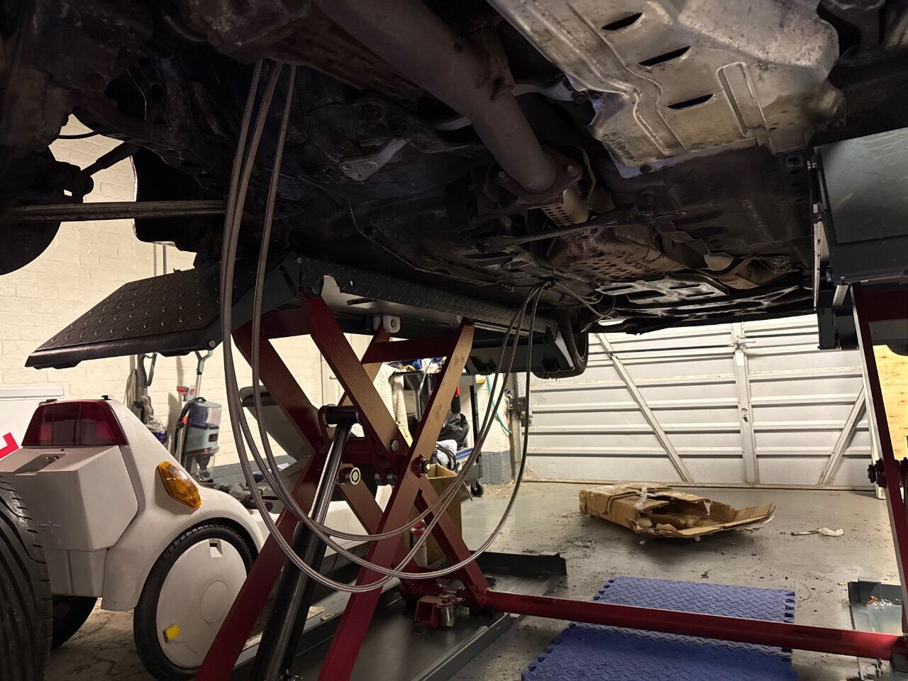

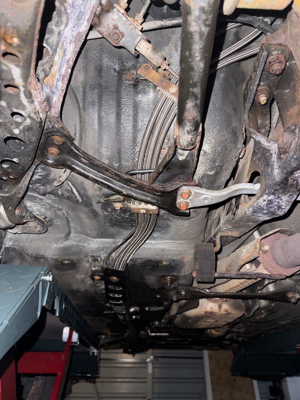

Progress. Though somehow, after fighting brackets etc. I got the wrong one and it's the short one.
These lines are really heavy to move around.

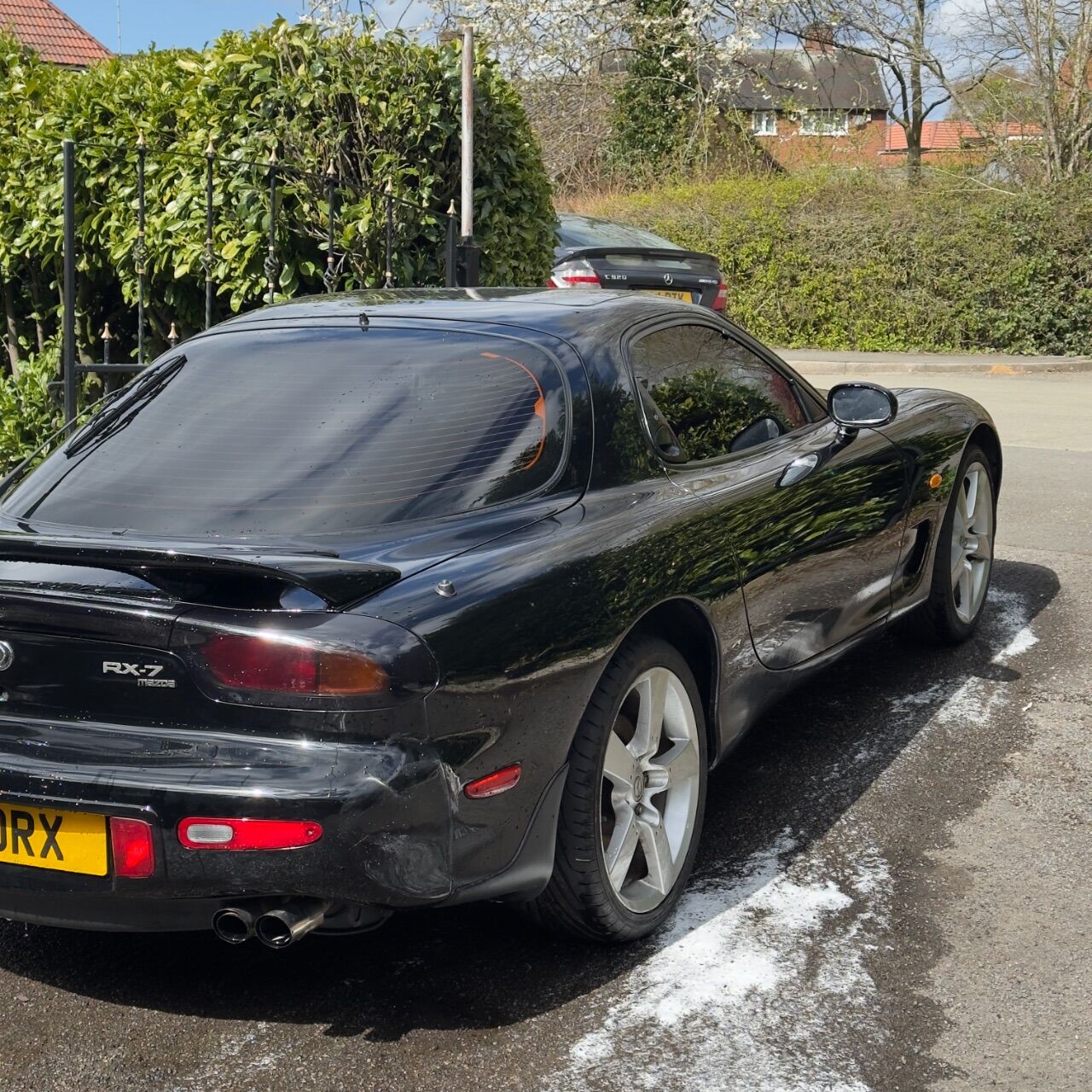

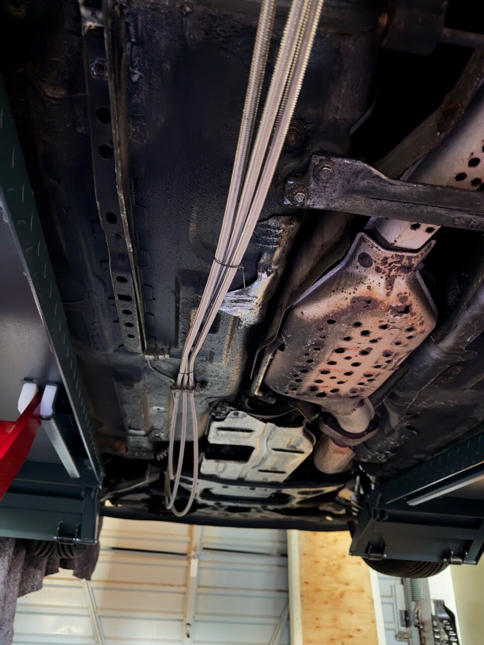

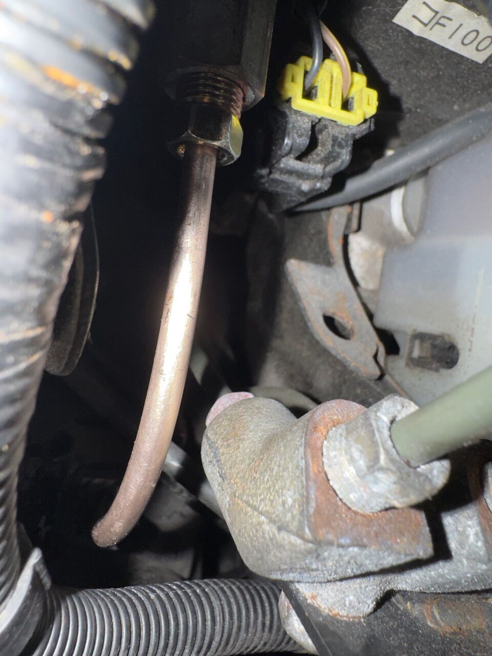

Final stretch. I'm not a huge fan of these pipes, you can see the distortion on the brackets not just from the diameter (I have reamed the clips a bit) but the weight).
Let's try...
Do I smell petrol? Why, yes I do...
*swearing ensues*
Can't see it, but the clip on the fuel supply from filter was a bit on the flare. I suspect the pipe is a little generous and I need a jubilee clip type.
But good enough.
All the cleaning up sprays from working on the brakes baking off the engine looked impressive.
But the smoke from trying to start it with low fuel pressure and therefore, just oil injectors cleared...
Looking promising...
Get some garage dust off...
Yes okay Audi I know the birds have been using you for target practice.

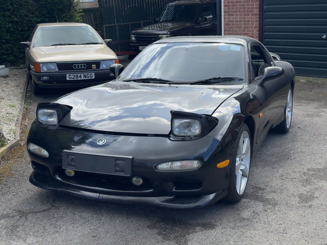

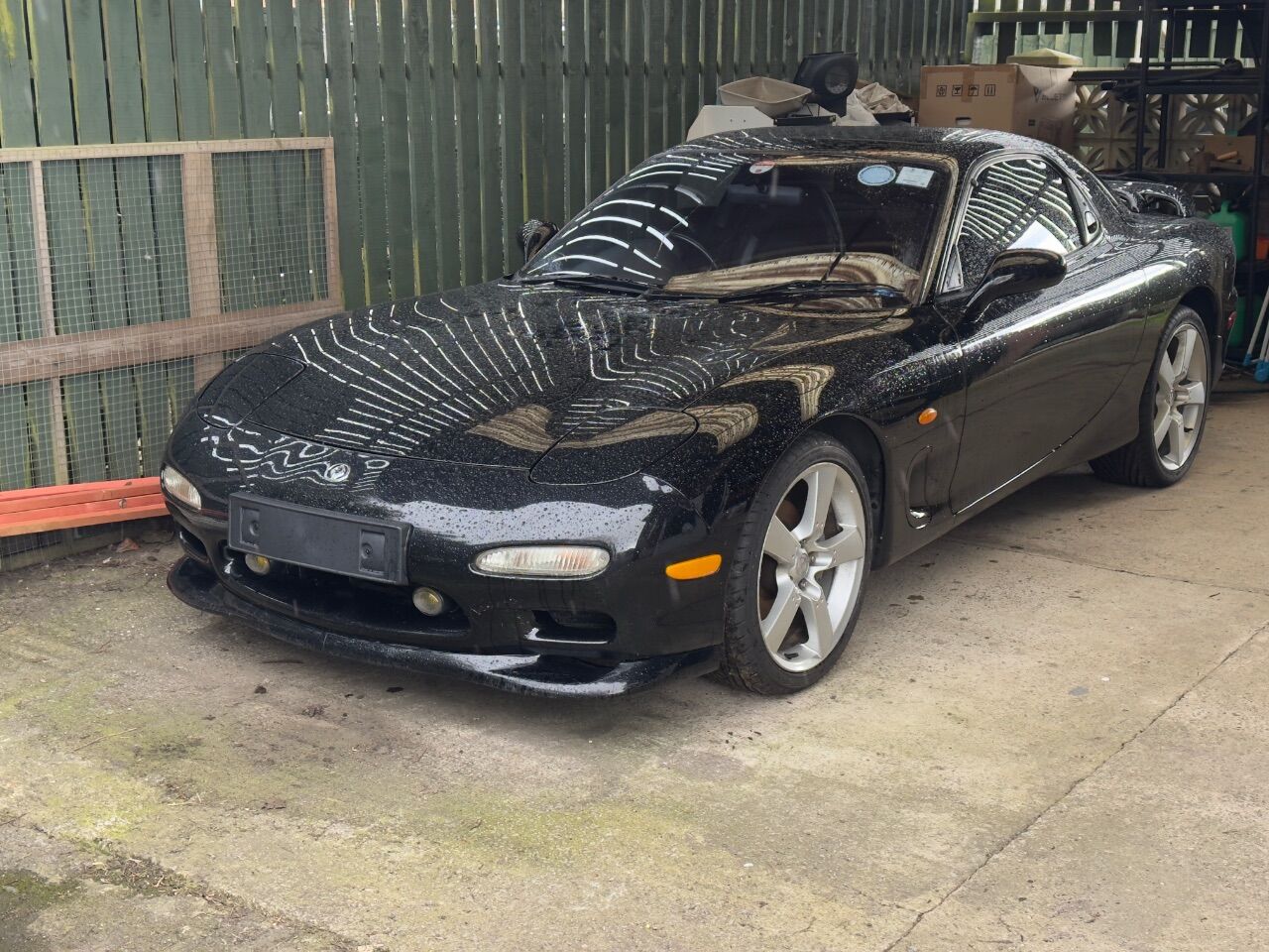

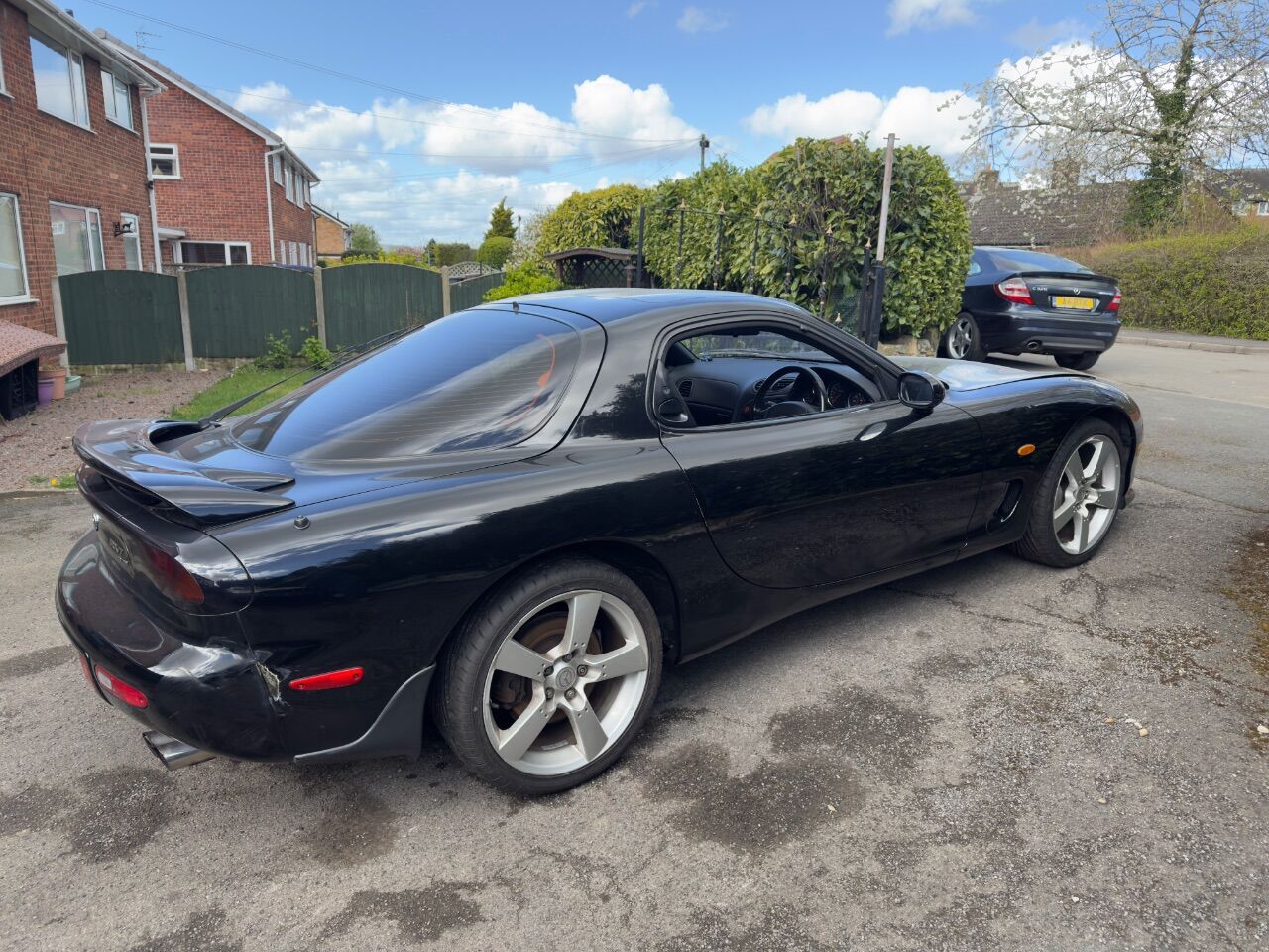

Now, to save up for a week to get a jerrycan of fresh petrol for the RX-7...
  • Bear changed the title to Bear's bangers: IT'S ALIVE! The RX-7 stops wetting the bed...
Acquire fuel: 10 litres of V-Power. Actually not as horrific as I feared. Glad I don't drive a diesel.
Looks happy about the first fresh fuel in 20 years!
Such a lovely profile.
Also lovely - it got to temp, behaved.
And it hot started just fine.
So for now it can vacate the garage and I can work on other things.
While I get a number plate, and then bring it in, torque everything up and double check it, and then... MOT time!

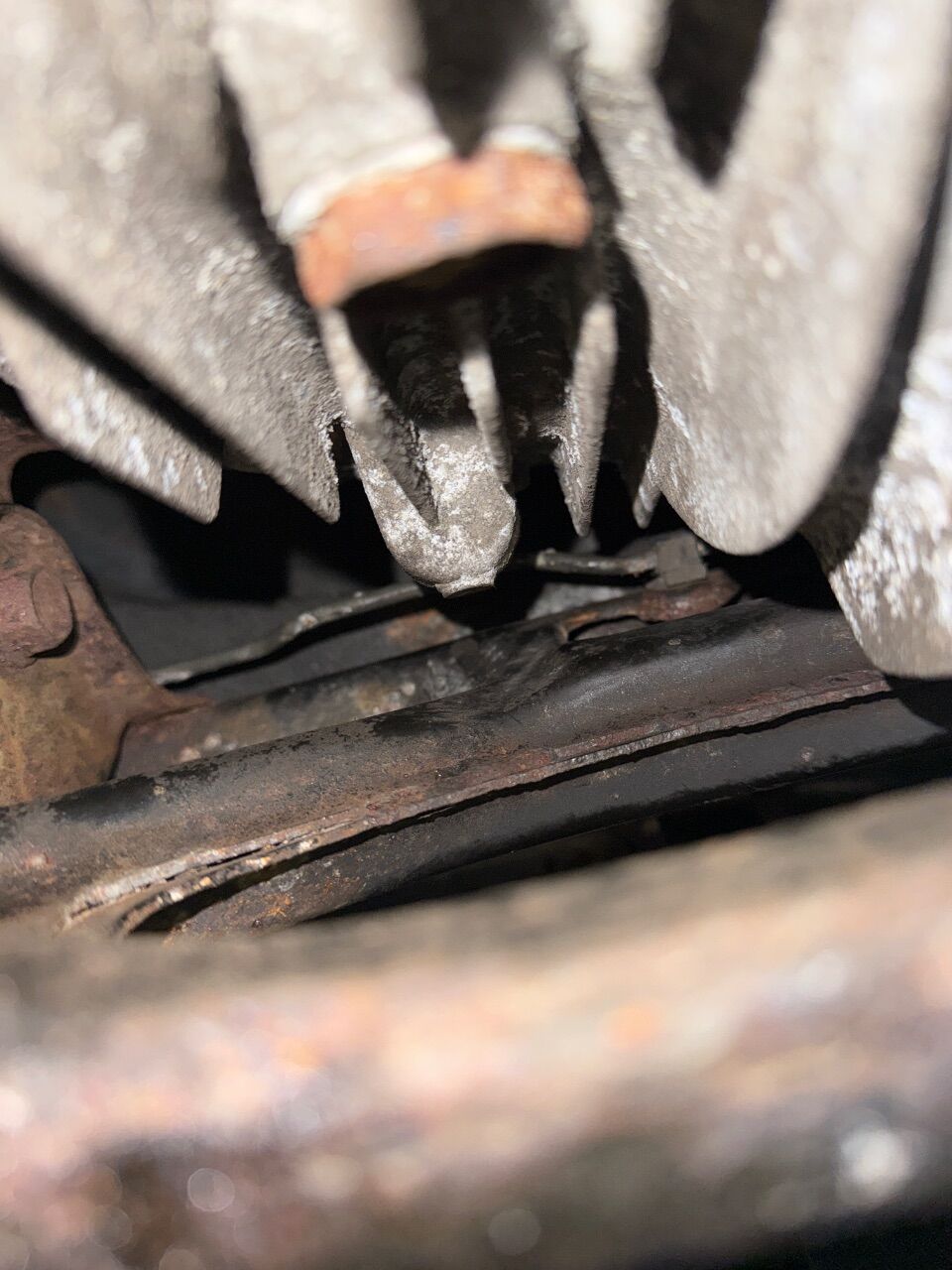

Greased the suspension top mounts with spray grease as they're squeaking, but I didn't want to buy new ones just randomly

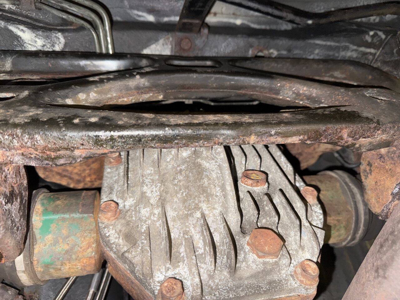

Stripped NSR brake and freed off adjuster, but suspect it has a warped drum
It's really clean underneath!
But there is a mystery whirring. Sounds like a wheel bearing, but I can't find any play in any wheel or the driveshaft at the hub.
So... my fear is, gearbox?
But the other thing is this car is bone dry and behaves well. No oil leaks. No horrors. After the oil and filter change the engine is super quiet and I'm alarmed by the fuel injector noise!

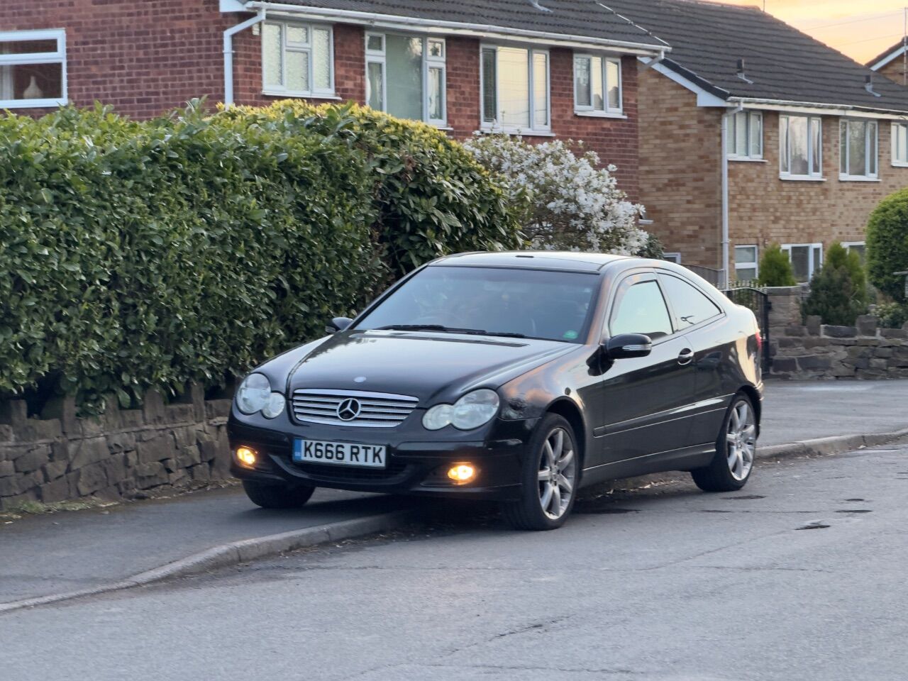

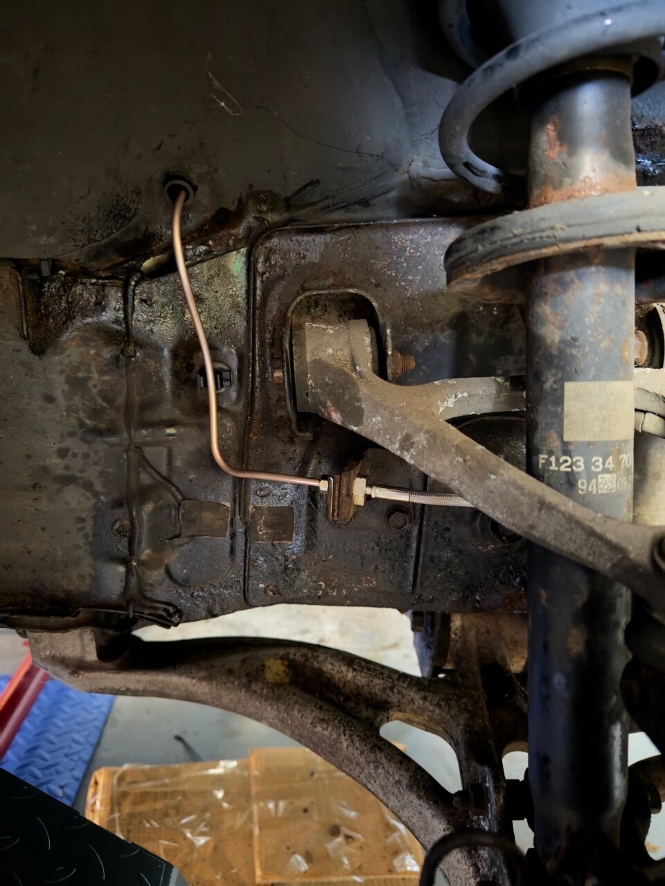

While cashflow is cash-no, maybe look at an "easy" fix I can do before contemplating seeing if the lift can wheel into the carport and support a Discovery...

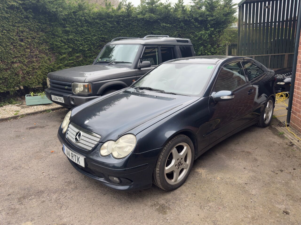

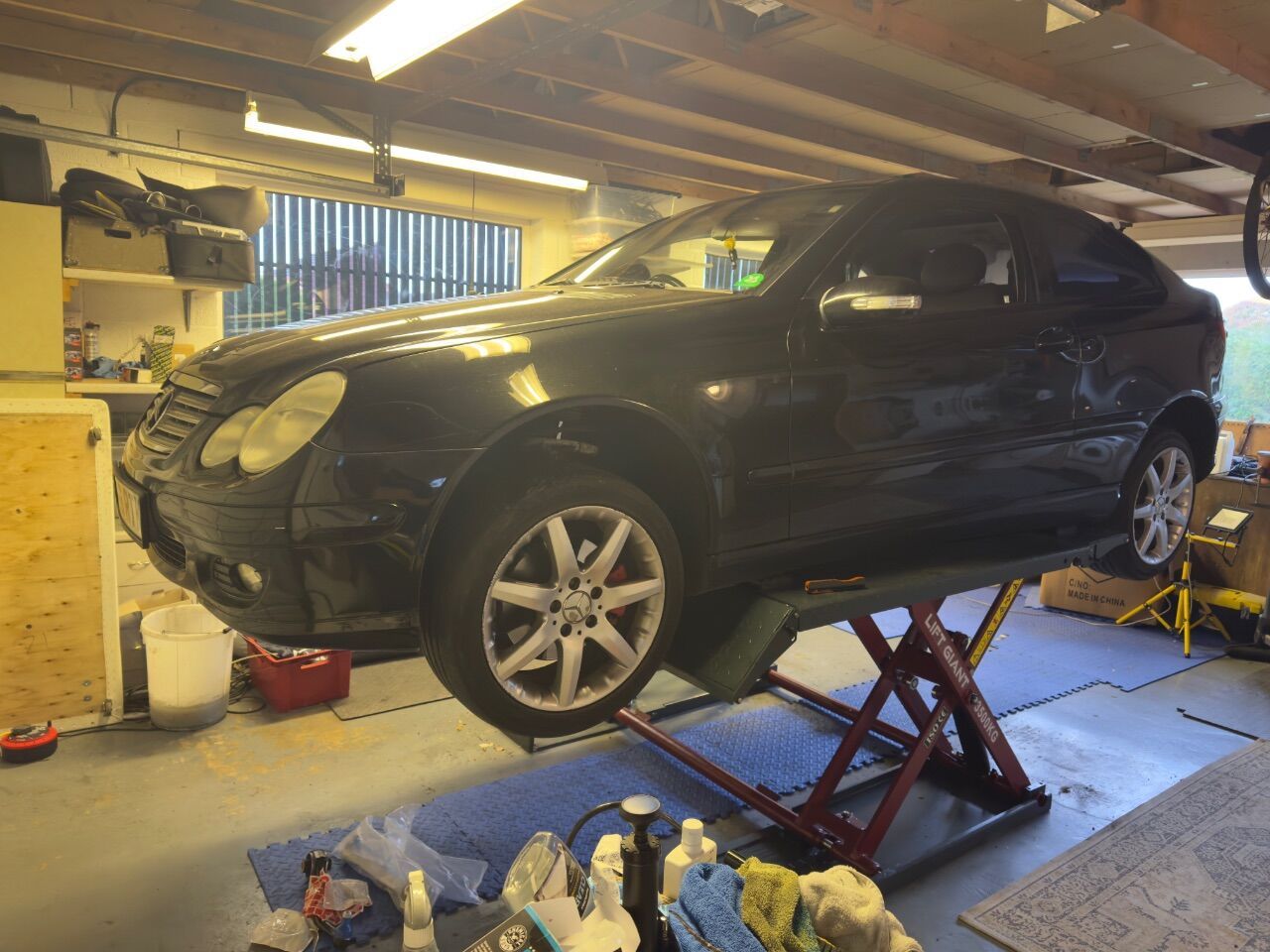

Tidy the greenish C320 a bit.
It has been enjoying the usual mod I do when I have too many cars to feed...
But the posh one - they were cheaper than I remember.
Meanwhile...
Everyone loves a go on the car ride.
These were in the boot when I got it.
I think they go here. The car does rattle and clunk an bit.

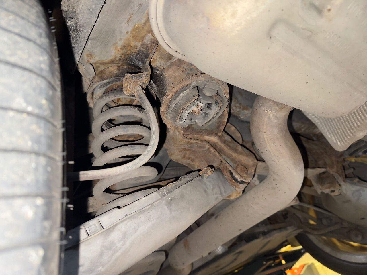

And I can do some rust tidying.

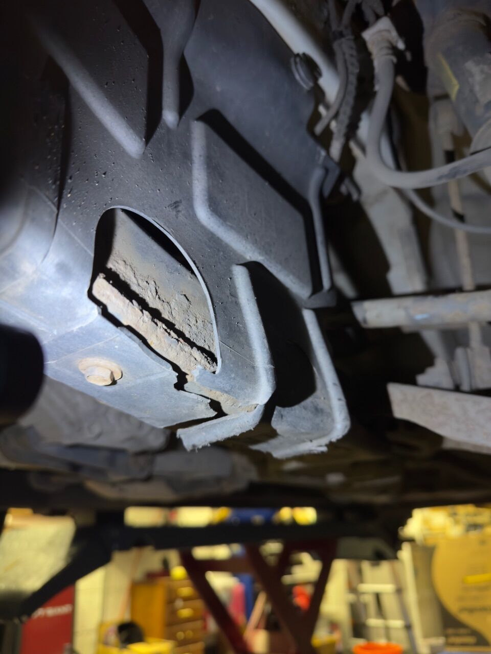

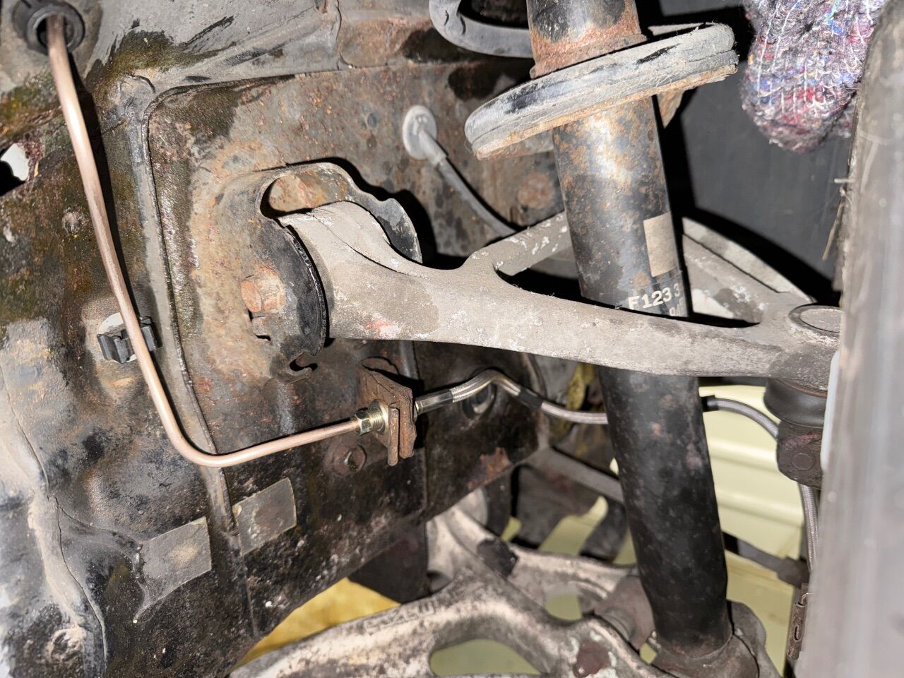

Not bad for a 21 year old Mercedes, but definitely not worth ignoring.

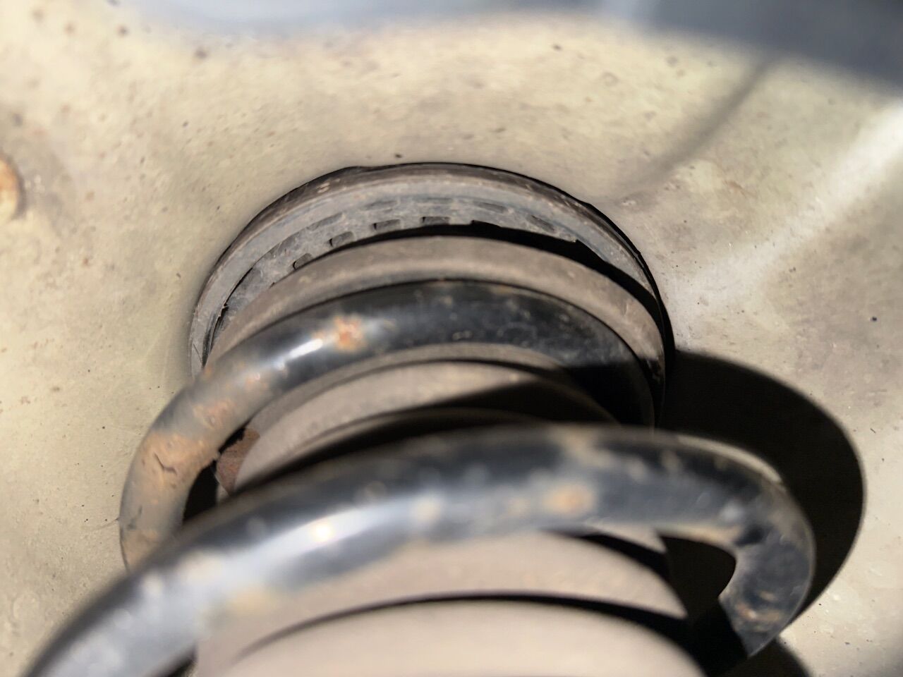

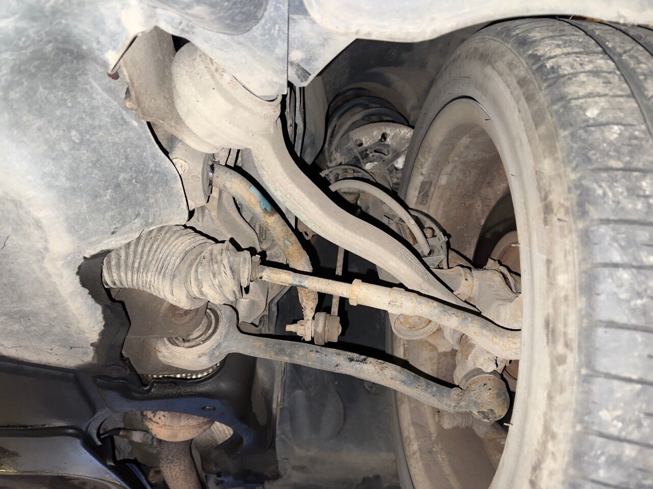

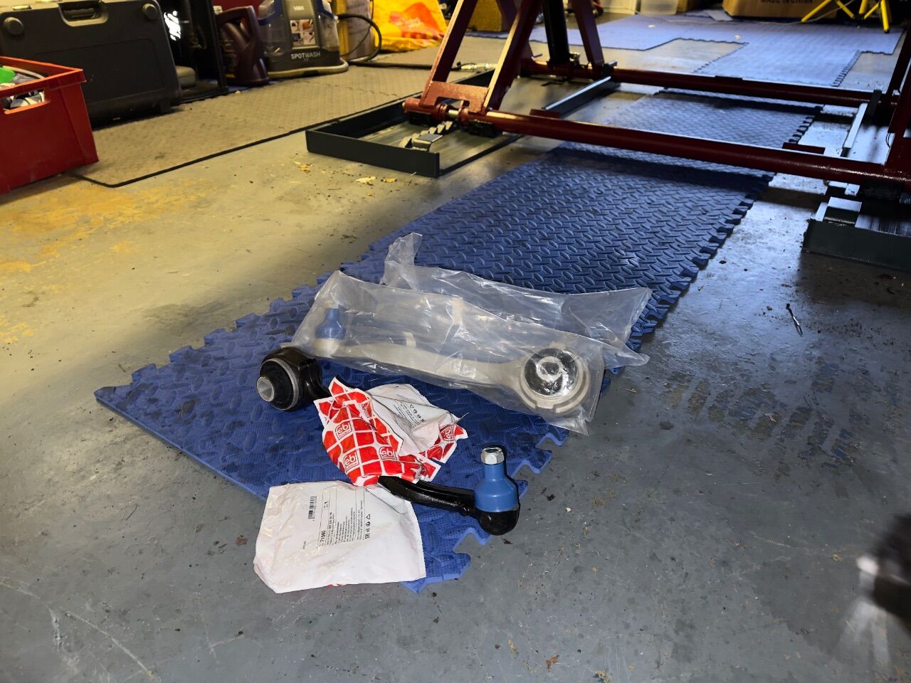

Except, the top bush on the nearside front sounds like opening Dracula's vault. I'm not sure if a strut bearing would cause the bad wear and clonks, but I'm fairly sure I can blame it for the occasionally heavy steering and it sounds Very Sad.
The arms do need the strut removing to fit apparently, so I guess the cashflow remains annoying and this one will be off the lift again until I can get mounts - but after I do some rust curing/prevention.
You might notice a marginally tidier garage... @alcyonecorporation please come and retrieve these Piazza mats before I'm tempted to shove them on eBay 😂

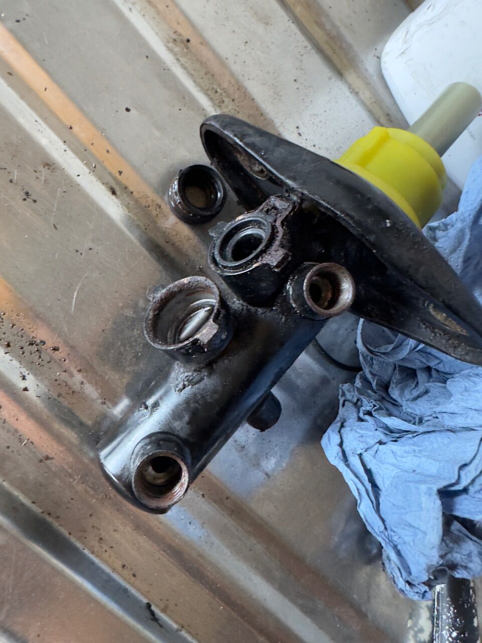

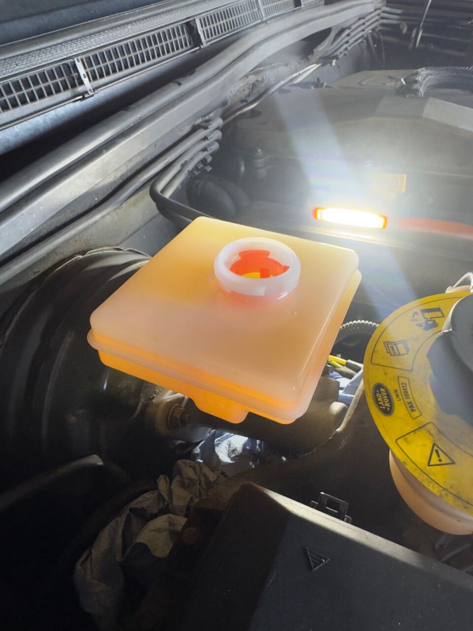

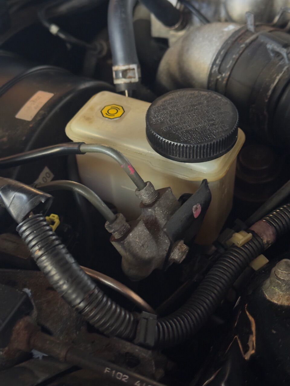

The original version stuff about crawling on knees and tightening nipples and sucking and golden showers, but I'll keep it clean for here - let's just say there is nothing kinkier than a Land Rover Discovery 2 braking system.
For starters, it bleeds backwards, except when it doesn't (when filling the system and the ABS module is depowered).

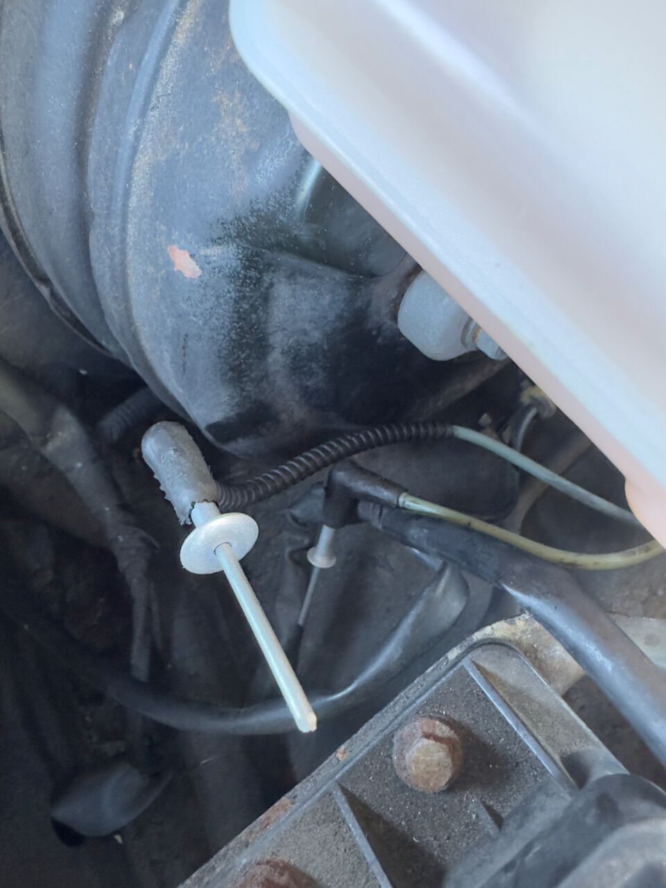

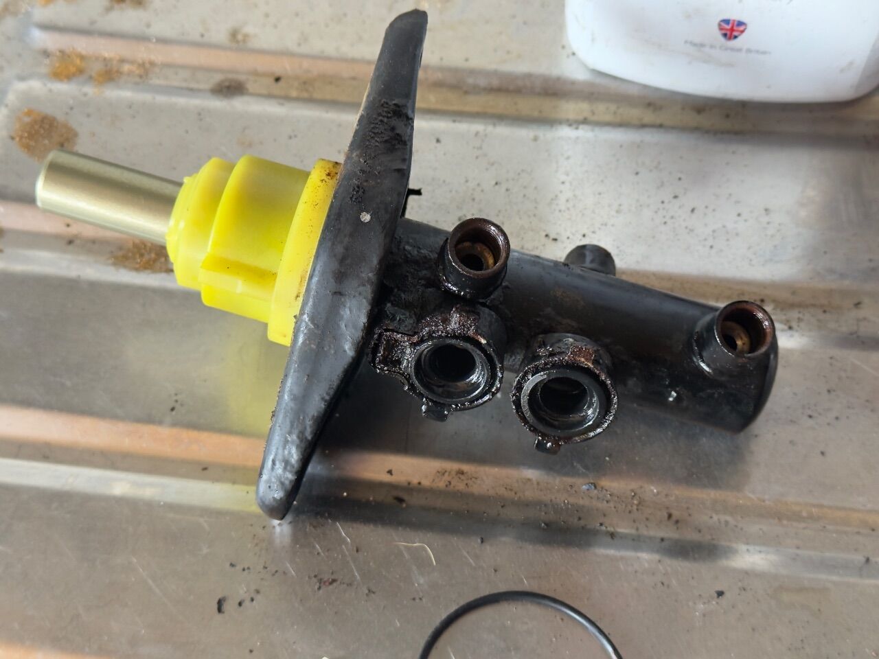

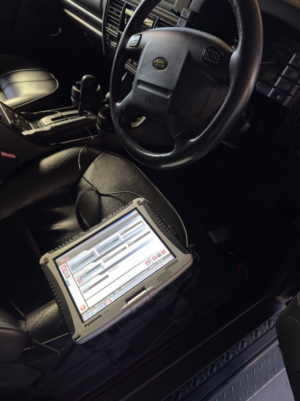

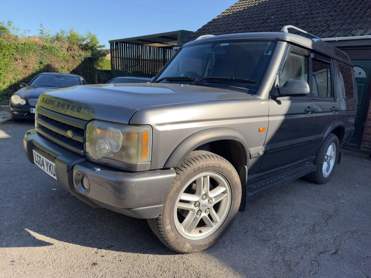

@mat777 dropped this delightful beast off with a few jobs to do but the biggest was - it's had new caliper flexis and wouldn't bleed. It had some brakes, right at the point the pedal ran out of travel and you run out of clean pants.

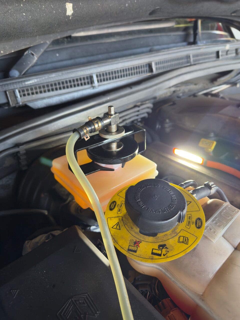

I tried the usual things - including making a pressure bleeder that worked because the quick connector was wrong - but because of the awkward nature of the ABS module and need of weird diagnostic stuff to officially bleed it, I felt like I wasn't getting anywhere.
As it happened, I was. When we first talked about the issue, and the diagonal failure mode was mentioned, I muttered something about master cylinders before conceding that this was old-school brain and I didn't know the ABS system at all.
So at first I'm proceeding like "well, the ABS is making it awkward". Meanwhile, attempts to two-man bleed were getting bubbles... going the wrong way!
I tried pressure. Vacuum. Swearing. Disconnecting everything and looking for bubbles in the tank. Cracking off the lines to the module.
Sometimes there'd be a satisfying hiss.
But hiss works both ways.
This bastard thing was creating a vacuum with the secondary chamber. Once removed, and pressed by hand, it spat from the primary outlet and sucked fluid in from the inlet - but the second outlet stayed dry and didn't draw fluid in.
Looking at the design in the manual I think the valve for the second piston has jammed shut so it moves with first piston pressure but evacuated itself during bleeding and then starting sucking in fluid rather than pushing.
New one fitted.
First, bleed ABS.
Five pedal presses, watch bubbles come up, repeat - then bleed from farthest to nearest.
Here's how to do that...
This would be nice, but...
This is shit.
However, I got a firm pedal so went for a drive.
With a hill.
Hill descent control, ABS unit gets a workout.
Bleed brakes. Reverse order - nearest to modulator first.
More air.
Pedal is rock solid now.
But the servo is not good.
Two vacuum lines blocked. Servo feels better :)
