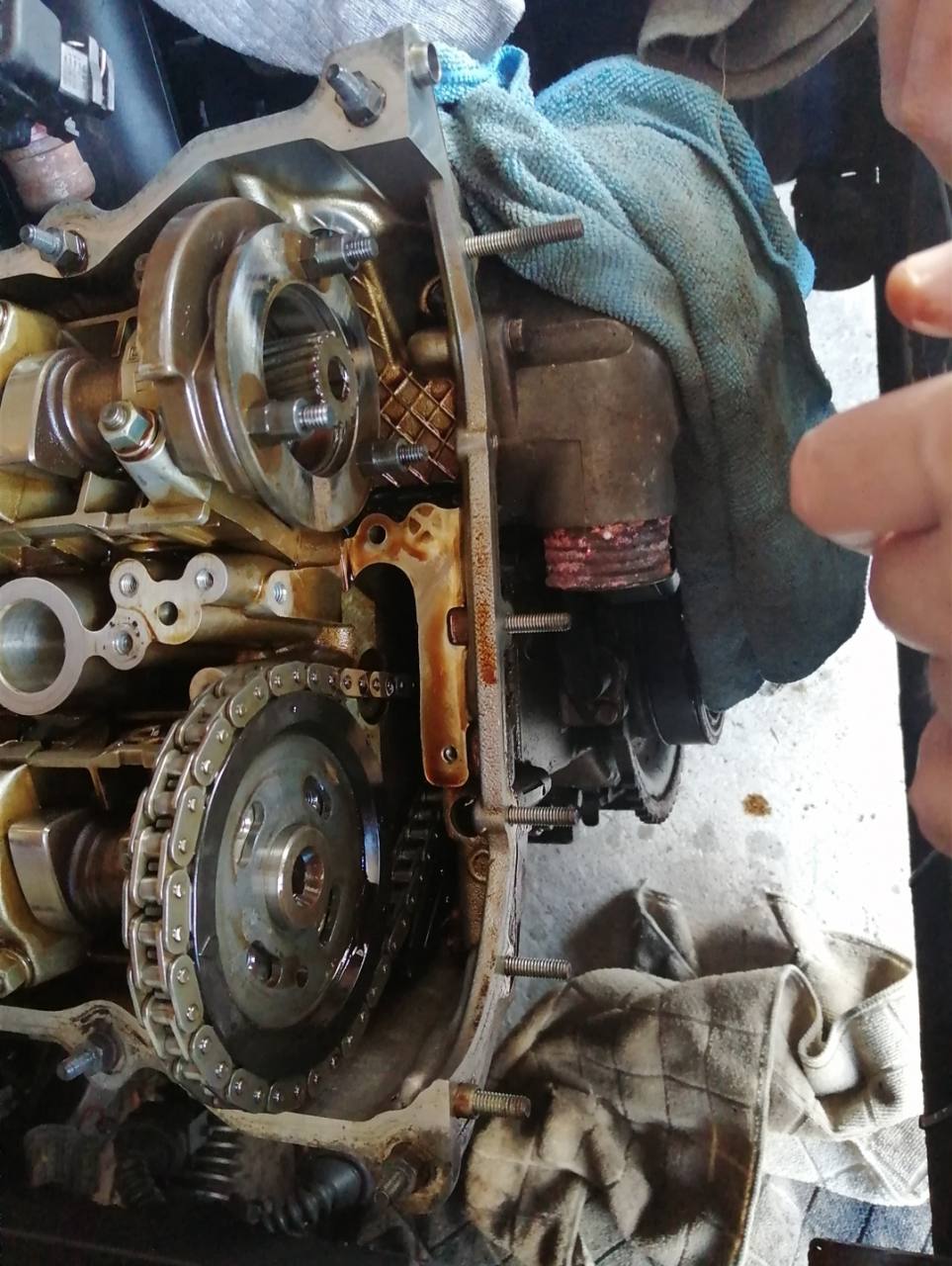

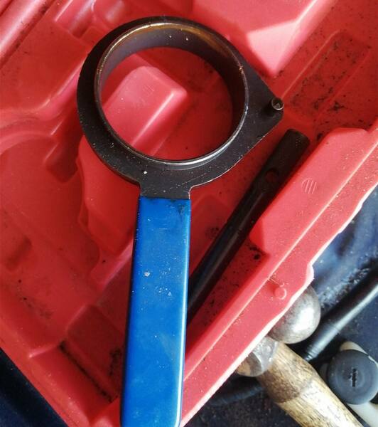

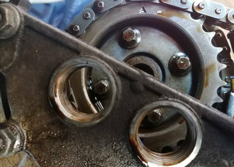

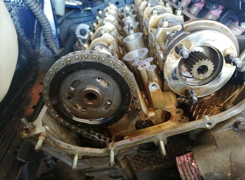

jaypee Posted April 1, 2021 Author Posted April 1, 2021 The further investigations began with having to remove the Vanos unit from the car. First off, remove the 2 blanking covers from the unit Which allows access to the lower 2 sprocket bolts on the exhaust cam. These 4 bolts were loosened, but not removed. Next up, is to depress the upper timing chain tensioner. So I briefly read it some Nietzsche.. Then held it down with a drill bit. It was then the turn (pun definitely intended) of the Vanos removal tool. Which fits neatly onto the exhaust sprocket. Once this has been test fitted, I removed the rest of the mounting hardware from the Vanos, when this has been done. The tool is put in and the sprocket (now loose) on the cam is rotated clockwise, this in turn, rotates the intake cam sprocket, which then, due to the helical gear set between the intake cam and vanos unit all comes together and pops the unit off! Here it is! You can see the gear, this is moved in and out, by the solenoid on the side, which diverts oil in or out of the chamber behind the gear. This then advances/retards the intake cam timing, depending on the load on the engine (rev range) That was the easy part done... Next was to check the timing...... Wooop. johngarty, Skizzer, Jim Bell and 8 others 11

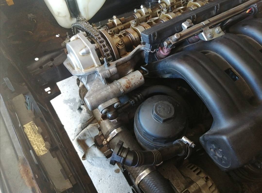

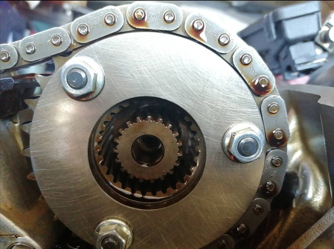

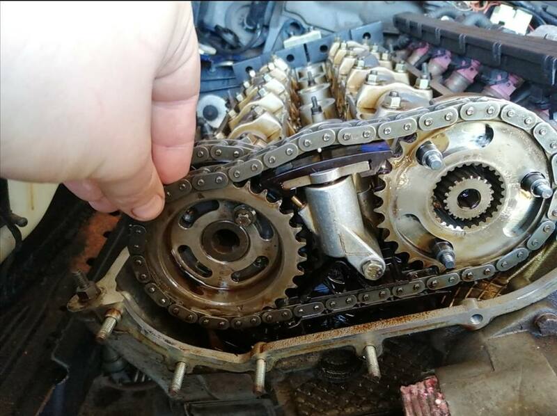

jaypee Posted April 2, 2021 Author Posted April 2, 2021 With the Vanos out the way, it was easy to access the cams. A better view of the helical gear that adjusts the timing These 3 nuts were removed, and this revealed a couple of spacers and a large spring washer. Which, when extracted, allows you to see the way in which the Vanos works. The sprocket on the intake, sits freely and has its movement limited by the pegs on the end of the cam, as the Vanos is activated, the cam moves relative to the sprocket, however the exhaust and intake sprockets are static in their relation to each other. There are similar slots on the exhaust cam, although this is locked to the exhaust cam with the aforementioned 4 bolts. It became clear on closer inspection, that in my haste to get it back together after doing the head work. I made a couple of booboos. The pictures below hopefully will explain, but, in essence, the 2 sprockets should be aligned in such a way that, when the exhaust sprocket is clocked fully clockwise, the intake sprocket is also at the fullest extent of its travel to the right. Woops.. Also woops Thankfully, this is a fairly easy fix, and I will explain later. It was then time (#pundown) to remove the sprockets and investigate the timing of the exhaust cam and the crank. Split_Pin, GingerNuttz, Lacquer Peel and 6 others 9

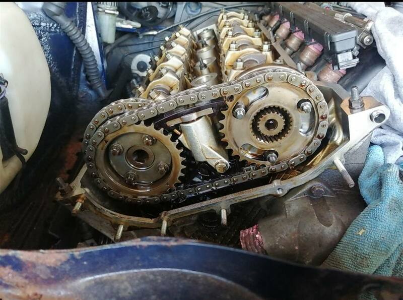

jaypee Posted April 2, 2021 Author Posted April 2, 2021 With the sprockets off, the upper timing chain tensioner and the upper timing chain guide could be accessed, and removed (microfiber cloth used to block and dropped bolts from falling down the hole into the block) That allows access to the exhaust sprocket, which is driven by a chain on the crank, there a couple ways to check the timing, one is there is an arrow, that should point up, when at TDC (not 100% accurate in this application, as the engine sits at a slightly different angle in the e30, compared to the e36. Although it's as near as dammit). The other is the location of the bolt holes in the slots. From here the exhaust sprocket can be waggled (Technically Speaking) off the exhaust cam to adjust the timing, now its time for booboo 2! Again, in an earlier fit of haste/ignorance, I had lined this up, without the tensioner in. Some Google research and YouTube video watching later, told me, that I had been a colossal clutz to do such a thing! It was recommended that a specialist BMW tool was used to set the correct pre load on the chain, however in my research I came across a creative solution! The tensioner on these engines has a spring inside, and is also regulated by oil pressure. The specialist tool, is a solid piece and puts an equivalent amount of tension on, as if the engine were running. The creative solution required a tensioner, luckily I had a spare, and a stack of small coins, also I had these. To provide a set amount of tension, the spring was removed and replaced by the non squishy coins. Giving the below With the 'new' dummy tensioner installed just past finger right, the correct level of tension is applied. When the tension is in place, the sprockets moves anticlockwise on the cam, the bolt holes should line up roughly in the centre of the slots (depending on how old/stretched the chain is). The pic below isn't great, I know, however, it should hopefully show. Once I was happy with the alignment, the upper timing chain tensioner and guide were reinstalled. Next up, the joys of realigning the two front sprockets... 😂 rainagain, Coprolalia, Jim Bell and 8 others 11
Split_Pin Posted April 2, 2021 Posted April 2, 2021 Crikey, you fair know these engines chap! A BMW 'specialist ' would probably charge towards 4 figures for that work, or, more likely, crap out of it altogether. 320touring 1
Jim Bell Posted April 2, 2021 Posted April 2, 2021 Fascinating. Cracking work and highly interesting man. Looking forward to seeing you get the sons of bitches correctly aligned. jaypee and 320touring 1 1
dome Posted April 2, 2021 Posted April 2, 2021 Excellent work dude. These vanos units used to give people the fear. Good to see they are serviceable without resorting to witchcraft 320touring and jaypee 1 1
jaypee Posted April 18, 2021 Author Posted April 18, 2021 On 4/2/2021 at 7:19 AM, Split_Pin said: Crikey, you fair know these engines chap! A BMW 'specialist ' would probably charge towards 4 figures for that work, or, more likely, crap out of it altogether. Hah, a little knowledge is a dangerous thing... Aye, not cheap to farm out. Thankfully it's at the flat, so I can fanny about at my leisure. Split_Pin, spartacus and 320touring 3

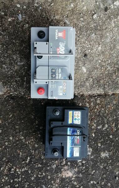

jaypee Posted May 22, 2021 Author Posted May 22, 2021 I also took the opperchancity to put the correctly sized battery in it, swapping out the spare one I had purchased new for @320tourings Clio, a couple of years ago, after I definitely didn't* lock it up, and slam the bonnet with the old, dodgy battery disconnected, then have to get a locksmith out, although, he only charged half price, as I assisted him with breaking into it! Anyway.... SUCH AMPS, MANY CRANKS... WOW! I had turned the car around to get some additional height to assist bonnet fitting. Which made it easy* to do unassisted, and without any lifting/holding apparatus.. Anyway, brute force, ignorance and a little ingenuity got it on. Battery also now installed. It seems a bit more eager to start now, although not as willing as previously, so more investigation is required. Exhaust was put back on and checked for leaks, all good. Now that it was back together, I took her out, all was well 😊. Due to her being a pain in the bum, she then decided that a continuous exhaust would be too passe, so, another leak was developed. Great* You can see the potential problems here, ably assisted by Junior @cms206's' toy moter' Ever since it's been put together in 2013, I have thought, I better get that gearbox, exhaust mount fixed..... That came to a head about 3 years ago, when I caught the centre box on a cobble on @320touring's Street and jettisoned the exhaust out through the rear valance.... Great* In the tradition of not rushing these things, she's getting a new exhaust built this incoming week at http://stainlessexhausts.com/ On the recommendation of @davidfowler2000 of this parish. Tickman, RobT, 320touring and 4 others 7

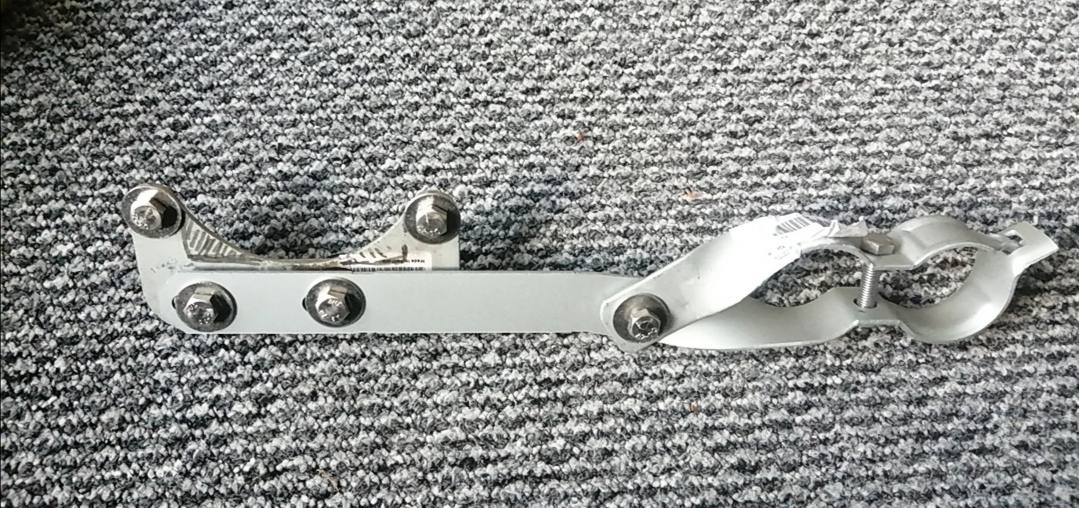

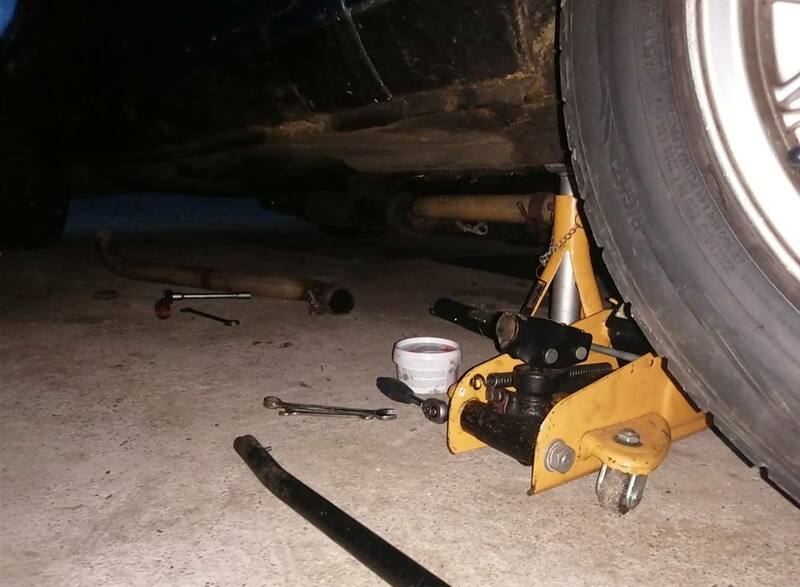

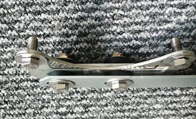

jaypee Posted May 25, 2021 Author Posted May 25, 2021 So, the e30 is going in for it's new exhaust tomorrow, I have gun gummed the blow back up again, to make it at least slightly less loud for the earlyish start. Behold the nearly 100 pounds of genuine BMW parts, 3 bits of metal and 4 bits of rubber. (this set up secures the down pipes to the gearbox, with some isolation) The bolts were not genuine BMW, as I need to eat this month! Being genuine parts, these just bolt on....... F*CK. The small bracket that attached to the gearbox is wrong, as it's a superseded part, I have marked out some bits to chop out to make it fit. This will also, hopefully help with keeping the exhaust in place, and tucked up off the road. The offending 'correct' bracket. Jim Bell, 320touring, Tickman and 1 other 4
