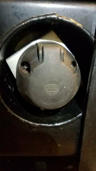

I've also fitted my reversing lights but not wired them up yet as I'm waiting for the gearbox switch to arrive. The 12N socket hadn't been fitted when I bought it, so I installed one that I'd previously removed from another vehicle. I mounted it to a neat little plate which fits in the PTO recess, which I'm hardly likely to use!
The socket is appropriately marked, which pleases me :-)

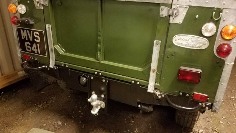

In doing this I've noticed that the drop plate is only mounted with M10 bolts. Google image searches show similar bolts for the top row, but the lower ones look like M16. Also the plate is not folded on the edges, so  seems like a home made affair. If I do end up towing anything I want it to be sturdy, so will replace at some point.
I have a pair of what look like standard 21W bulbs, but are 35W (standard reversing light fitment on mine). Can you get those there?

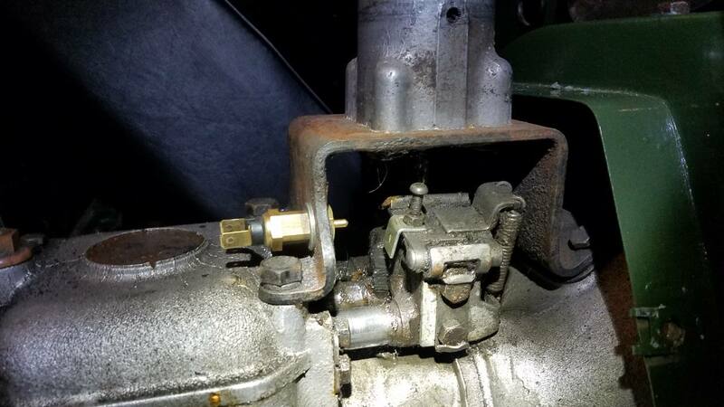

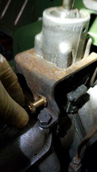

The hole at the lower right of the gear lever support I will fit the switch to, and then I can fix a tab to the reverse gate which will move the switch plunger.
I temporarily connected up the lights to check all was working, and they look like they'll do the job. No sign of burning with 21w anyway!
I've also fitted a rear fog light - mainly to cover an existing hole so only temporarily bolted in place! I thought it would look too new, but I reckon it doesn't look too out of place. Unless someone has a better idea?
Looks good to me.
Tow hitch should have M16 bolts for the ball, + M16 for the lower of the two chassis fixings and M10 for the upper, as well as appropriate spreader plates on the back of the rear x member.
That's what I thought, based on Google images, but this uses M10 for all four, albeit with a hefty spreader plate at the rear. I'll have to make up an M16 plate I think, or probably just take a slice of the current drop plate.

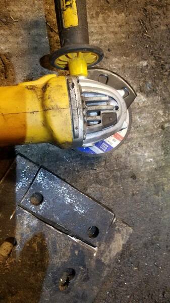

My new drop plate has arrived, but as I went for a hot dip galvanised one, I wanted to tone it down a bit. First I bead blasted it to key the surface, then gave it to my mate who does powder coating as a sideline.
After baking it looked like this :-)
I then wished I had a plasma cutter, after spending ages cutting out a spreader plate from the old drop plate.
Bolted it all up and job done!

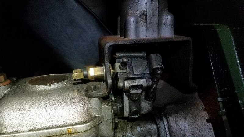

I've now finished off the reverse light install using a brake light switch mounted on the shifter mount. I fixed a tab onto the reverse gear gate, which flips up out of the way to allow the lever to move into the reverse position.
Then just a case of running wiring to it (sleeved for protection) and tapping into the existing fuse box.

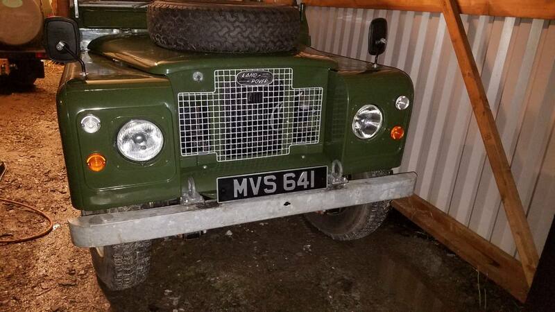

Tonight's task was to fit my 'new' old grille. The original way of supporting it was a pair of bent metal clips at the bottom, but when I looked at the price that second-hand ones went for, I decided to make my own!
https://www.ebay.co.uk/itm/Land-Rover-Grille-Retaining-Support-Brackets-PAIR-Series-2-2a-SWB-LWB-330150-/383787154365
Until I discovered someone on Facebook making them from stainless, for £5 a pair - not worth my time to try and knock them up at that price :-)
Helpfully, Land Rover had not changed the front panel pressing since the series 2A days, and the mounting tabs were still present.
To my surprise, the clips came with stainless rivets too, which were on the limit of what my cheap rivet gun (and hands!) could cope with. I guess owning both an Airstream and Land-Rover, I may need to invest in a better rivet gun...
 I cut some silicone tube to slip over the grille, to prevent it from rattling around - surely one less rattle is a good thing? Then drilled where the badge sits for the top fixings. I used rivnuts rather than plastic inserts for a more secure fastening, and will replace with security screws given what these grilles can fetch on eBay!
This is the finished job, and I really think it looks the part 😎20201214_222836.thumb.jpg.326c059025919cd4d8d1ddaf533ab0d4.jpg

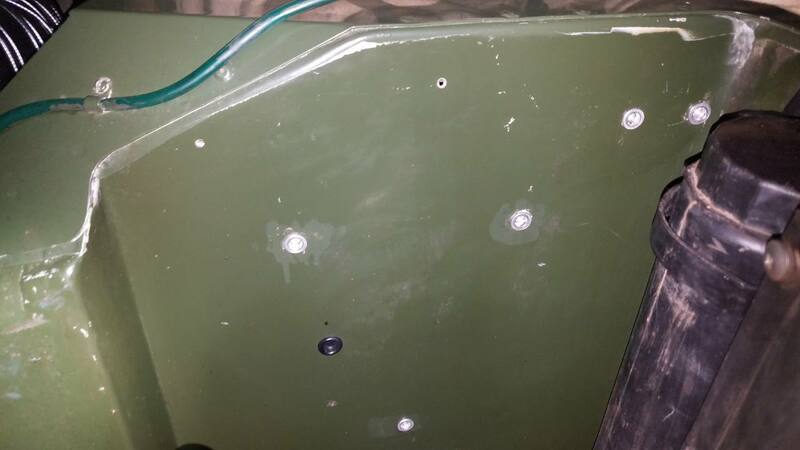

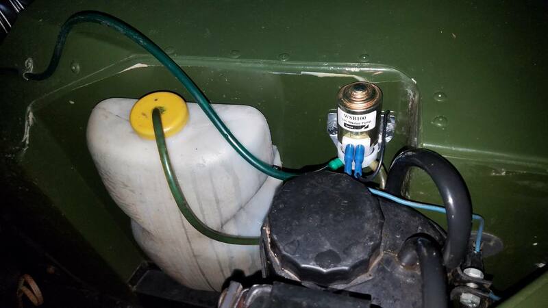

I took this on the 80 mile round trip to work on Friday, and it performed surprisingly well! It got a fair bit of attention in the car park too. One minor problem I was reminded about, given all the grime on the roads currently, is the lack of a working washer pump.
It appears to have seized up, and a new replacement is so cheap, not even worth the bother of investigating. The pump and washer bottle are held on with M6 screws and nuts inside the wheel arch - in my case very easy to undo!
To make it easier in the future, I fitted rivnuts in the holes after enlarging slightly. Means I only need the one tool, and keeps my hands cleaner.
New pump was then fitted (the correct way up!) and connected up.
The blue feed wire is non-original, and I can only think the old wire had become damaged somewhere in the loom and this was the replacement. It bugs me, partly because the colour isn't correct, but they haven't even followed the path of the loom! I will have to rectify at some point...
Anyway, the job in hand is now complete!
