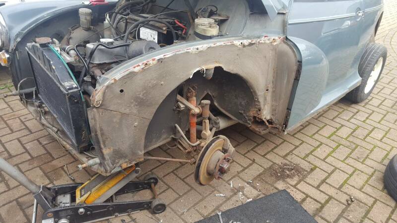

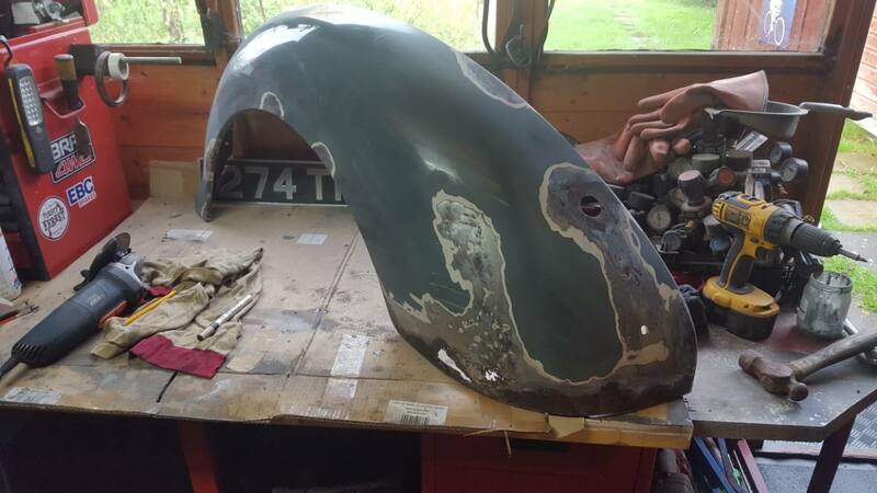

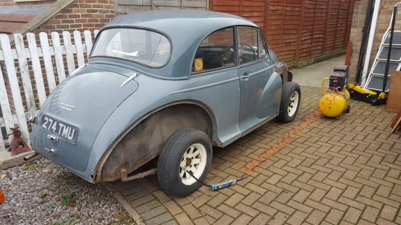

Joey spud Posted October 18, 2020 Author Posted October 18, 2020 I pulled the front panel off earlier thinking it would stop me removing the wings,it didn't and without it fitted the radiator is free to get intimate with the cooling fan so i loosely bolted it back on. The wings are held with a handful of bolts scattered around their perimeter which all came undone with little drama. Once they were off the full extent of the A post and floor/end of sill rot was futher exposed. Passenger grot. Drivers grot. This side the rot has eaten into the base of the A post causing movement and problems with shutting the dropped door. Anyone recognise these brakes, Midget or Marina ? I also need a bottom arm as i don't think its ment to have a big rusty hole in it. So it's definitely narrower than standard now and after a bit of rearrangement it's in pole position to go up the side of the house. 500tops, Jenson Velcro, CGSB and 16 others 19
High Jetter Posted October 18, 2020 Posted October 18, 2020 It might bluster a lot, but you can probably squeeze it through the gap

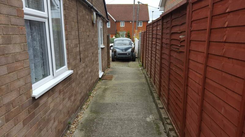

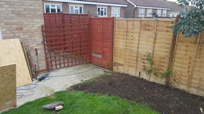

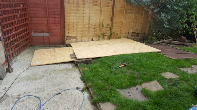

Joey spud Posted October 24, 2020 Author Posted October 24, 2020 So today was the day. Shrubs were dug up.. 18mm ply board was laid.. Tyre's were inflated.. What could possibly go wrong.. Well it looked like it was all systems go until i got about two car lengths from freedom (garden) when the tyres got wedged against the house wall and the fence's fixing blocks. Not happy doesn't come close to covering it. Banger Kenny, egg, beko1987 and 1 other 4
SiC Posted October 24, 2020 Posted October 24, 2020 Would stock tyres be a fair bit narrower? egg, Joey spud and Banger Kenny 3
beko1987 Posted October 24, 2020 Posted October 24, 2020 Wheels off and a dolly under each corner? Banger Kenny and egg 2
Dick Cheeseburger Posted October 24, 2020 Posted October 24, 2020 ^ This. Standard steels/tyre setup are Kate Moss-esque compared to your Wellers. Joey spud 1
Joey spud Posted October 24, 2020 Author Posted October 24, 2020 Yes i think if i can get hold of a cheap set of standard 4j rims with 145 or 155x14 tyres fitted instead of my oh so manly 185/70 x13's i might give me just enough wiggle room. Man maths in action. 155 vs 185 = 30mm x2 (aka 2+ inches) which should be winner,winner chicken dinner. egg, Christine, Banger Kenny and 1 other 4
Dick Cheeseburger Posted October 24, 2020 Posted October 24, 2020 Alternatively you could gently chip away a few mm from the lower edge of your house with a kango/hammer drill? May take a while though. I'm not an engineer, but I'd have thought it'll be alright. beko1987, NorthernMonkey, Banger Kenny and 4 others 7
Joey spud Posted October 24, 2020 Author Posted October 24, 2020 Pissed off really doesn't cover it. I need an inch at the very most to get through. I am currently sulking down at my local village Institute. I was watching the footy but its been interrupted by two bints singing along to a backing track (aka entertainment) so i am now sulking x100% I think if i can aquire some cheap standard wheels it'll just clear. I mean who builds a house that doesn't allow enough room for a moggy to slip down its side access ? Edit. They are now murdering Abba. Twiggy, egg, Vince70 and 1 other 4
High Jetter Posted October 24, 2020 Posted October 24, 2020 Can you borrow a couple of pallet trucks? Banger Kenny 1
lesapandre Posted October 25, 2020 Posted October 25, 2020 Pallets - put some small wheels under a couple of pallets and get these under the car front and back and push it down the alley with wheels removed? Banger Kenny 1
Joey spud Posted October 25, 2020 Author Posted October 25, 2020 16 hours ago, Christine said: turn the wheels around I have just tried this and it increases the track,nice idea though.. On the rear i could clamp the brake hose and remove the brake drums then bolt the wheels directly to the half shafts i think that would give me about half an inch.
