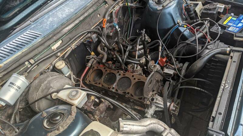

Nearly there.

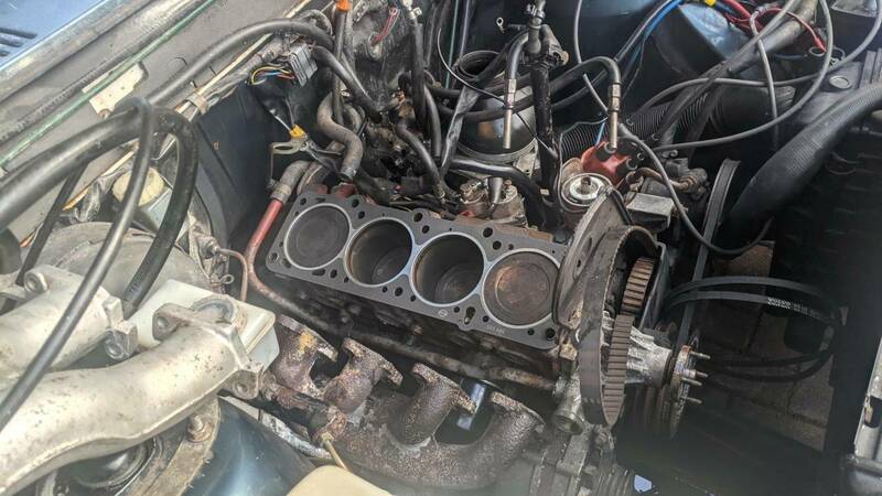

Block didn't look too pleased about being left out in the open, but that was sorted with an abrasive pad. Also drained the oil and coolant.
Gasket.

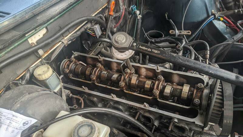

Heed on and torqued then angle tightened.
I seem to have lost one of the exhaust gaskets, and I need to try and compress then timing belt tensioner to refit it, so I did everything else I could then called it a day.
Can't feel my toes now.

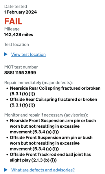

On to the stalwart C70 which I forgot needed an MOT until the last moment.

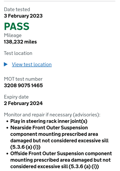

This car has been giving such little trouble I had to check what the previous MOT said.
The steering rack play comes up every year, and it changes from steering rack to inner tie rods to one of the track rod ends depending on where I take it for MOT.  The car has the tightest steering of any car I own so I think there's nothing actually wrong there. Maybe the rack adjuster needs tightened a bit, but for now I'll ignore it.
The sills were easy enough to sort. In fact I'm a bit annoyed they even made an advisory as there's nothing wrong with them. Simply, a tyre fitter has managed to fold over both seams of the sill.  But then this is the same place that failed a spotless 240 for DANGEROUS CORROSION because a rubber grommet was missing.

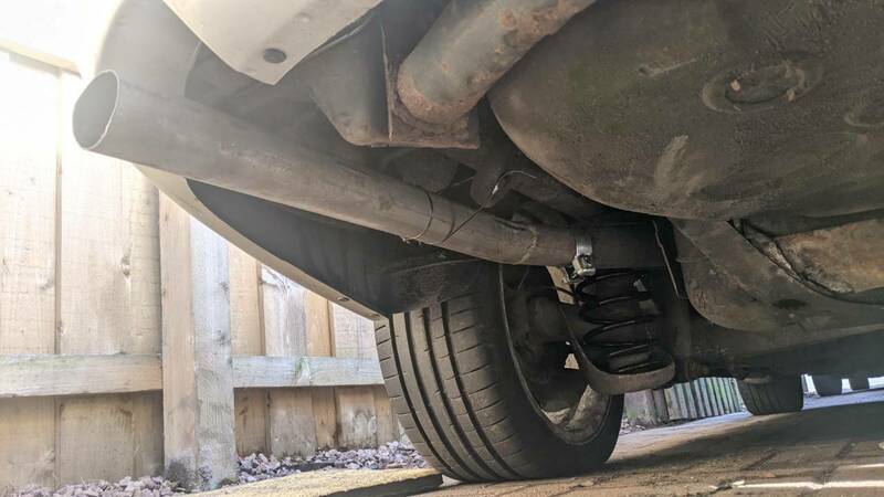

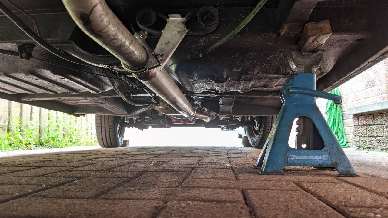

Last thing to sort was the small matter of the tailpipe having fallen off. Since there's no backbox on these it wasn't a big deal but I thought it was worth fixing.
I fixed this by HAMMERING A BIGGER EXHAUST OVER IT.
No, really, I found a bit of spare pipe that was marginally bigger than the exhaust and fit perfectly without evening having to cut it. And I just hammered it on.
Let's see how that goes.

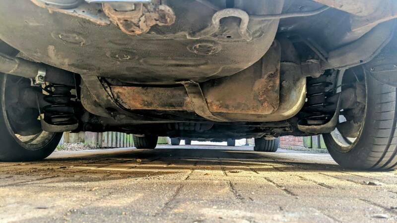

Ah.
Note how the steering rack play has switched to a track rod end this time, right as expected.

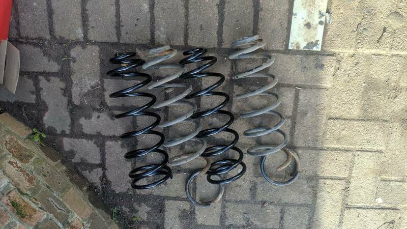

They've done their time I suppose. Pair of new springs £35 and half an hour of work.
I'm annoyed about the suspension arm advisories as I replaced them this time last year. 5 year warranty apparently. I'll test that!

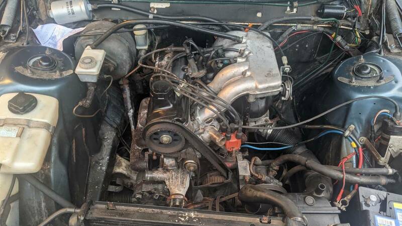

Wait a second...
No, really, @MrsJuular noticed that the Volvo branded spark plugs (which weren't cheap) looked like they were held together with glue.
I was doing a (yet another) spark test with them all lying out on top of the engine block, except this time it was starting to get dark outside. This time I noticed how thin and crappy the spark looked, which prompted a closer look.
Ironically I bought these spark plugs last year to try and sort the running issues that were likely caused by the burned #3 valve which I have now fixed. I hadn't thought those "genuine Volvo" plugs would contribute their own issues.
So I chucked on an old set of NGK plugs I had lying in the boot, and...
Running perfectly!

The big problem was that on the way to the test centre it started misfiring again.
FU. KING. HELL.
Again, to recap, I've been chasing this misfire for years.  The entire k-jet system has been eternally fettled with, almost entirely new fuel and ignition parts, every possible gasket and seal replaced, it's even had a new #3 intake valve.
At this point I wished I'd stayed in bed and left the 240 where it was.
Thinking ignition, I pulled the entire ignition system off the Amazon and installed it in the 240. Crazily, despite going from 1964 to 1988, it fits and works fine. But it didn't solve the misfire.
Final roll of the dice was to pull off the K-Jet metering head and take it apart.
Step 1: an uncontrolled explosion of springs and small parts.
I could only really find one thing wrong with the metering head and that's this O-ring which looked knackered, but on studying the schematics shouldn't even be there at all.
Regardless this was all cleaned up, and put back together with a new rebuild kit.
Sealed together with a very thin layer of permatex anaerobic gasket maker.
Back on the car, pressurised the system, no leaks. So all good on that front.
Started the car. Ran like a bag of absolute shite, but that was somewhat to be expected because I'd had to remove the balance screws from the injector ports.  So I ran the injectors into bottles to measure the flow rates.
Well that's definitely not going to work!
With much twiddling of the individual port adjusters, I managed to get it on a low idle injection setting that put out equal amounts.
Put back together, the car fired up on a half turn and idled beautifully. It has never been so smooth!

Some more Amazon tinkering. It's getting to the stage where most of the work I'm doing on the fleet is the sort of under-the-bonnet things you'd dabble with on a Sunday afternoon, which I'm really grateful for after what feels like a year of having to rebuild engines and tearing suspension apart.
Last month I thought I had problems with yet another aftermarket alternator, but it turns out I might have been a bit hasty to blame that.
To recap I was having some problems with glitchy electrics as throttle was applied / taken off. The last job I did to diagnose this was to steal the alternator out of @MrsJuulars Toledo while it was having its head gasket replaced. I checked that it was charging and drove around, but mostly in the daytime where I didn't notice things like pulsing headlights.
Recently I went a longer drive with @captain_70s to rake around some antiques.
Never had any problems in the 50-odd miles to the destination, but as it started to get dark on the way back, I noticed that the lights were still flickering as I came off the throttle, and that it was starting to misfire during the electrical glitches.  Very weird!
So for me that ruled out the alternator as the source of the problem. I spent a day going round the engine bay and interior electrics with a multimeter checking everything I could think of.
Here followed a fair bit of head scratching, as I ruled out wire by wire that everything was connected properly and that there weren't any strange resistances showing on any of the new wiring I'd put in earlier this year.
HT leads? Maybe one of them has broken down and is arcing off the block (or another cable) causing pulses in the voltage.
Alternator cable? Pulled that off and checked it, it was showing 0 ohms even when twisted and moved around. Mental note made to replace it in the future anyway.
Then I did another bit of diagnosis of which the results made no sense. I unplugged the alternator and the problem persisted. So it wasn't to do with the charging circuit at all.
Then one more test which made even less sense. I turned the engine off,  tapped the accelerator pedal, and the problem was still there! I could see the headlights pulsing against the garden gate, only when barely touching the pedal (like 0.0001% throttle application).  I also noticed the fuel and temperature gauges bouncing at the same time.
The problem has to be the throttle linkages somehow. Initially I thought perhaps the linkages were disturbing a wire or causing something to short circuit, but there was nothing at all in the way.  Then I spotted this.
There isn't anything wrong with this throttle linkage, but it struck me that all of the links are metal, and that they are quite chunky.  I also noticed that with the throttle snapping closed (where the problem occurs) the linkage would be coming to rest against the stop on the valve cover, at which point it would be providing quite a substantial ground path between the engine and body.
When rebuilding the car I installed a pair of 16mm2 ground cables between the battery negative and the engine block, but it's possible the throttle linkage is still acting as the path of least resistance when the throttle snaps shut, causing an arc and the subsequent electrical problems.
I then remembered that I removed the gearbox to chassis earth strap when I was welding, and I never put it back because I had to replace the bit of the chassis where it bolted in.  So it looks like I'll have to find a way to improve the grounding of the engine block, probably by adding chunky cables until the problem goes away..
