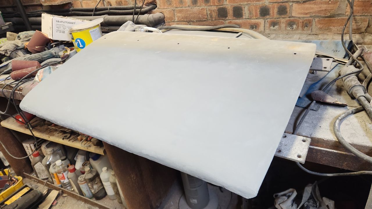

It almost seems a shame to paint this.

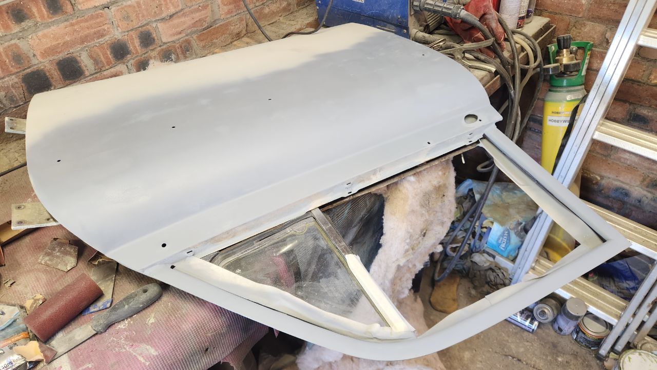

I reached the point where I ran my hand over it with my eyes shut to feel the flaws and was happy with it. It's not perfect but I'm not sure it ever will be.
On to the high build primer.
Then colour.
Despite being the worst door it's turned out one of the smoothest.

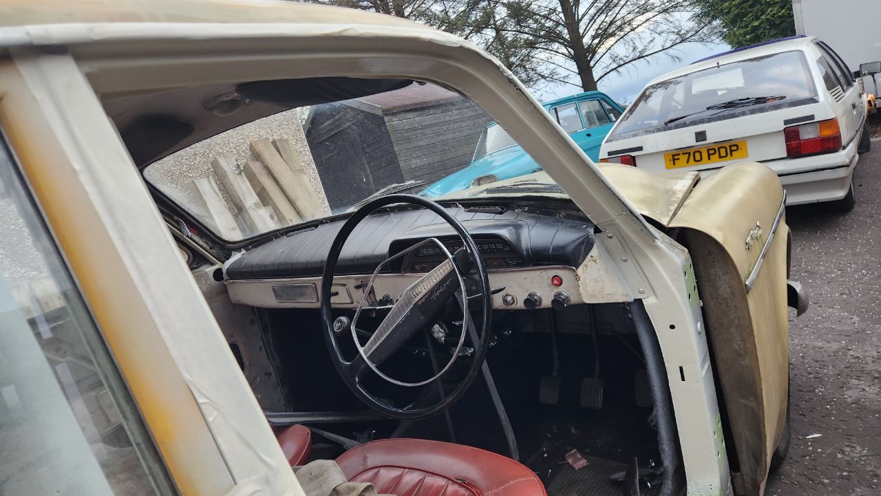

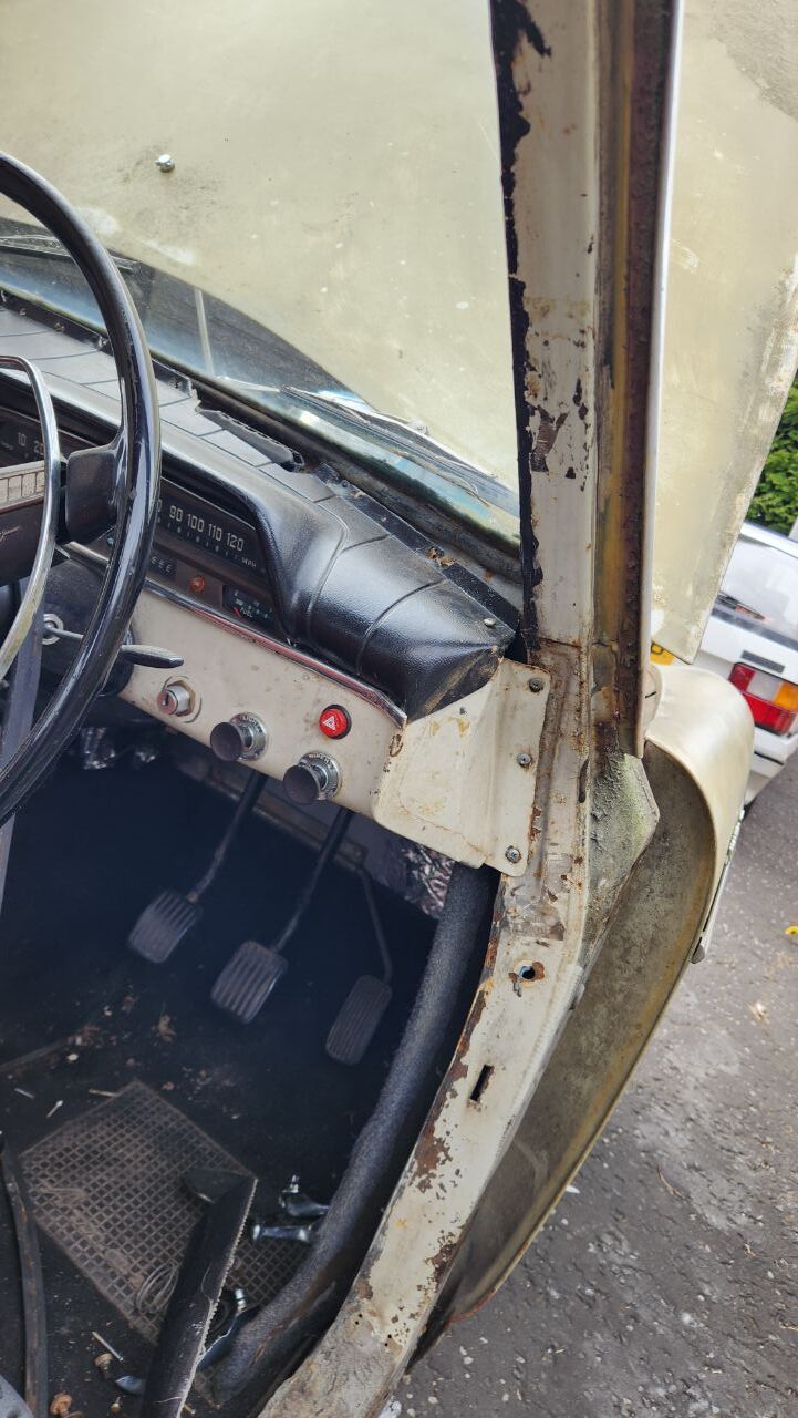

Then back to the car to sort the door frame.

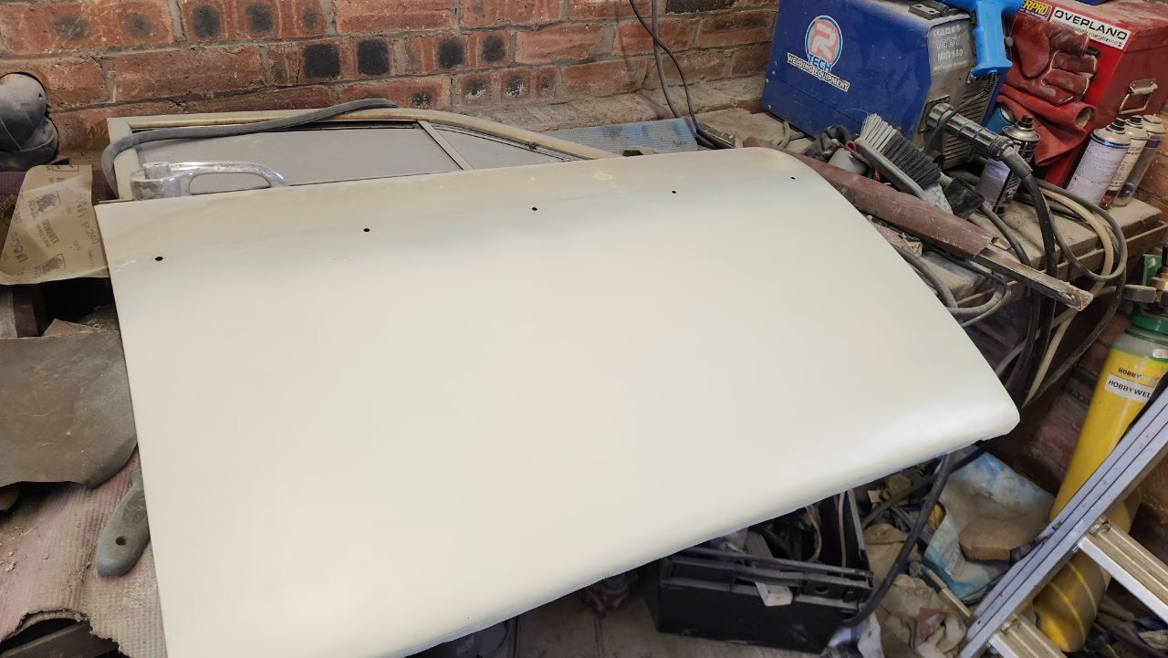

Before starting this I made an attempt to sort the rest of the door by taking some areas back to the metal where the paint was cracked or blown.
Then some acid and zinc primer.
High build primer.
Then here we go..

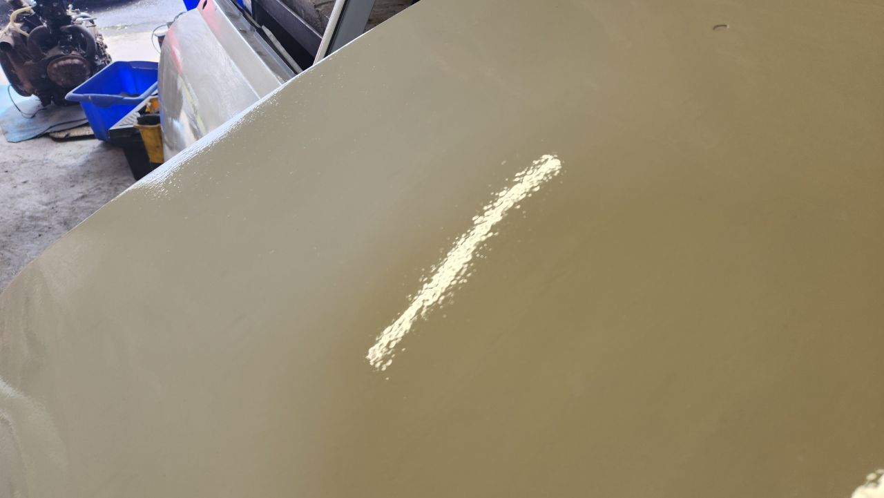

First impressions are that there's definitely a nack to it that took me half a panel to get into.
Not letting the brush go dry was the main thing. In the corner where I started I've missed a few bits due to an empty brush, so I will have to do a second coat.  I was planning this anyway so no big deal.
Secondly, the paint does seem to go a long way. I was worried that I didn't buy enough, but it's quite milky and the brush doesn't lift a lot when you dip it.  So I think I will have plenty.
It does seem to build up very well and I can't see any of the scratches and flaws that rattlecans seem to highlight.

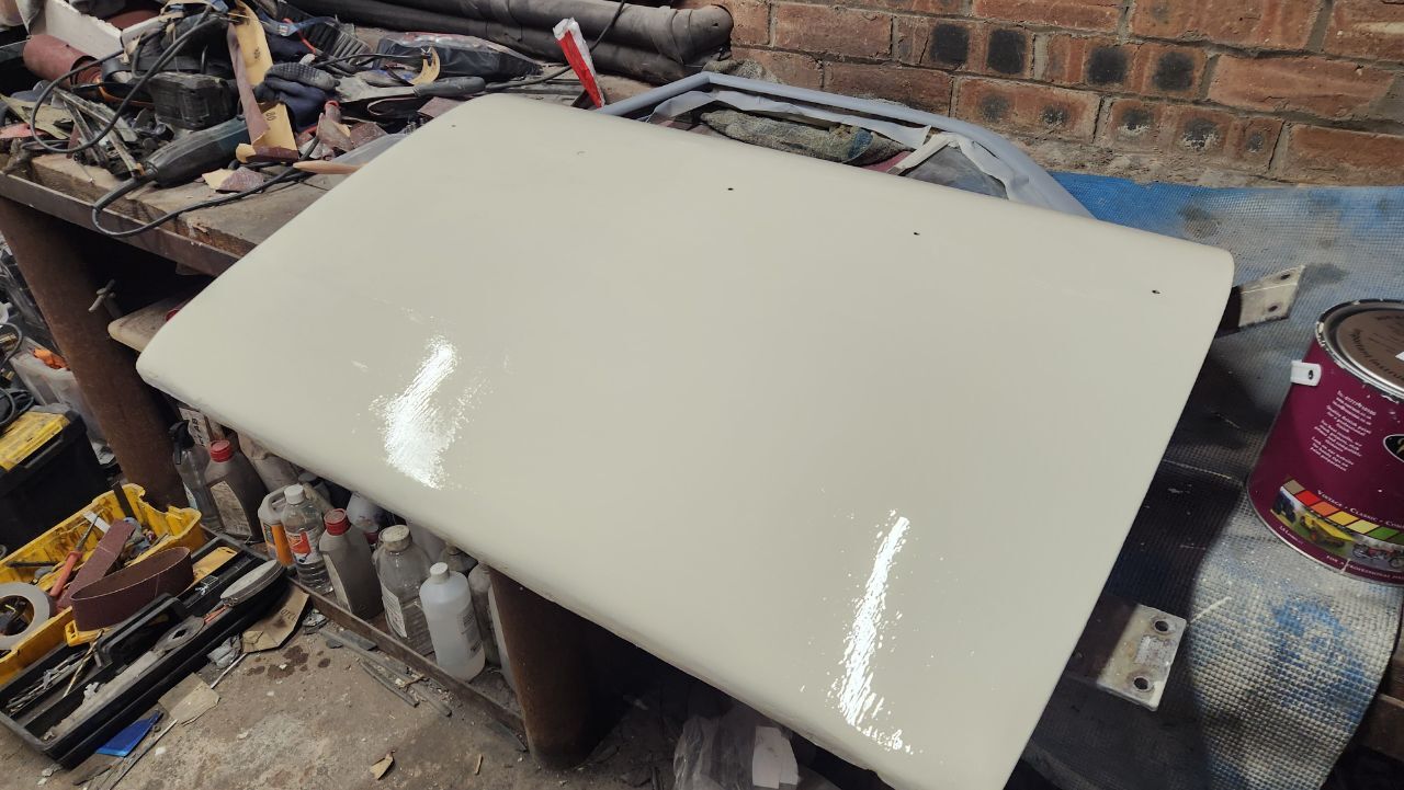

Also, bloody hell it's shiny!
After my first coat I could see brush marks galore. I did lay off the paint with vertical strokes, but as it was drying I could clearly see them.  It's supposed to self level as it dries, so we will see.
The shine on the finish is incredible, much better than I have ever achieved with rattle cans and clear.
Definitely a more enjoyable experience so far. I'm sure as I get some practice in the results will start to improve too.

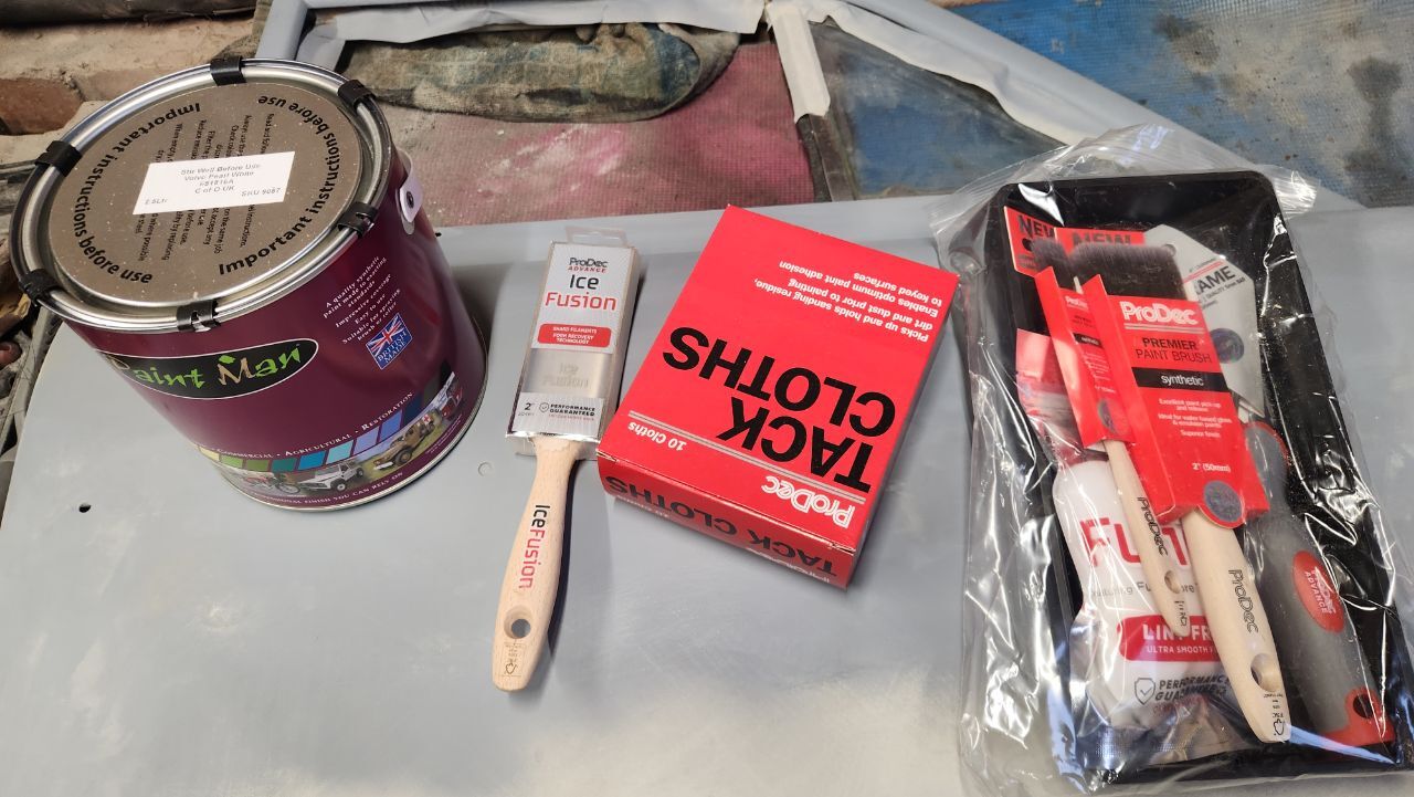

The downside is the drying time - 24 hours between coats. It might be worth getting the wings off and perhaps another door, and get them all painted at the same time.
At least the paint supplier sent me something to read while I wait.

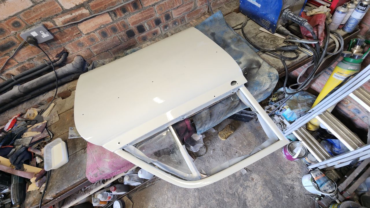

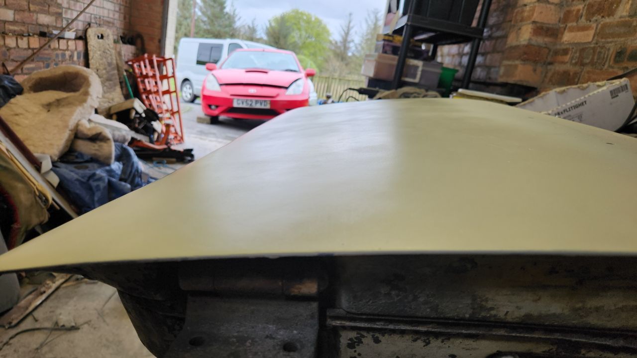

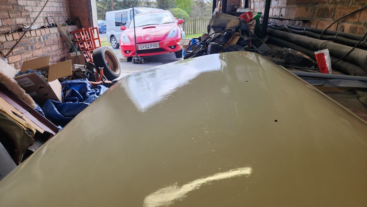

The results this morning:
It's not awful.
The brush marks have largely disappeared although the finish is quite uneven.
Entirely user error in this case as I hadn't kept the brush properly loaded.
I'm hoping a wet sand and a second coat will improve things.

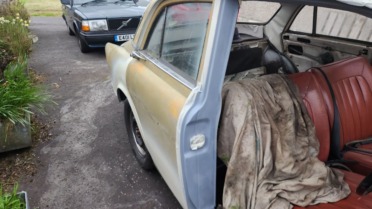

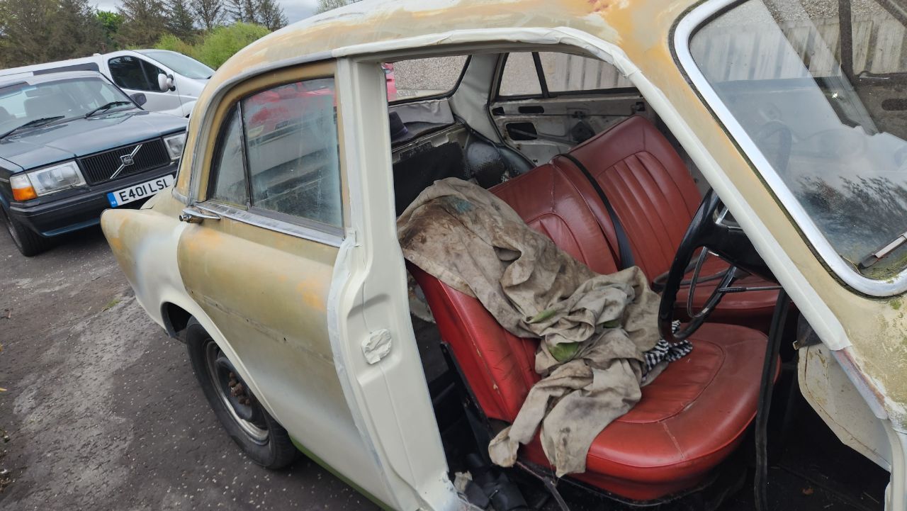

To think I had a look at one of my doors back in early March and thought, I'll vactan and fill that while it's on the car..
That's a transformation!
I spent a weekend hastily brush and roller painting our van a couple of weeks back with military paint and it looks so much better - however up close there are plenty of flaws.
A good enamel coach finish on a car of this era just looks right.

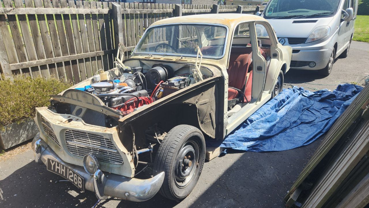

The original plan with this car was to wait until I had a detached workshop built that I could strip and paint it entirely indoors. Then I could take my time and do it all properly with a compressor and some decent 2k clear coat and primer.
The doors falling to bits every time I shut them kind of changed the priority from 'make it nice' to 'make it work'.
I don't really have the space to run a compressor and gubbins in my current workshop and I don't want to go to all the effort and expense just to have to do a half job - spraying things outside and getting them covered in flies anyway.
Since some of the fumes creep into my house I didn't think spraying 2k in this current setup would be a brilliant idea either.
As much as it was a fair heft of work, getting as many panels as possible off the car and going through them at the same time seems to be the way forward.

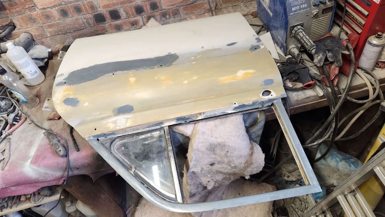

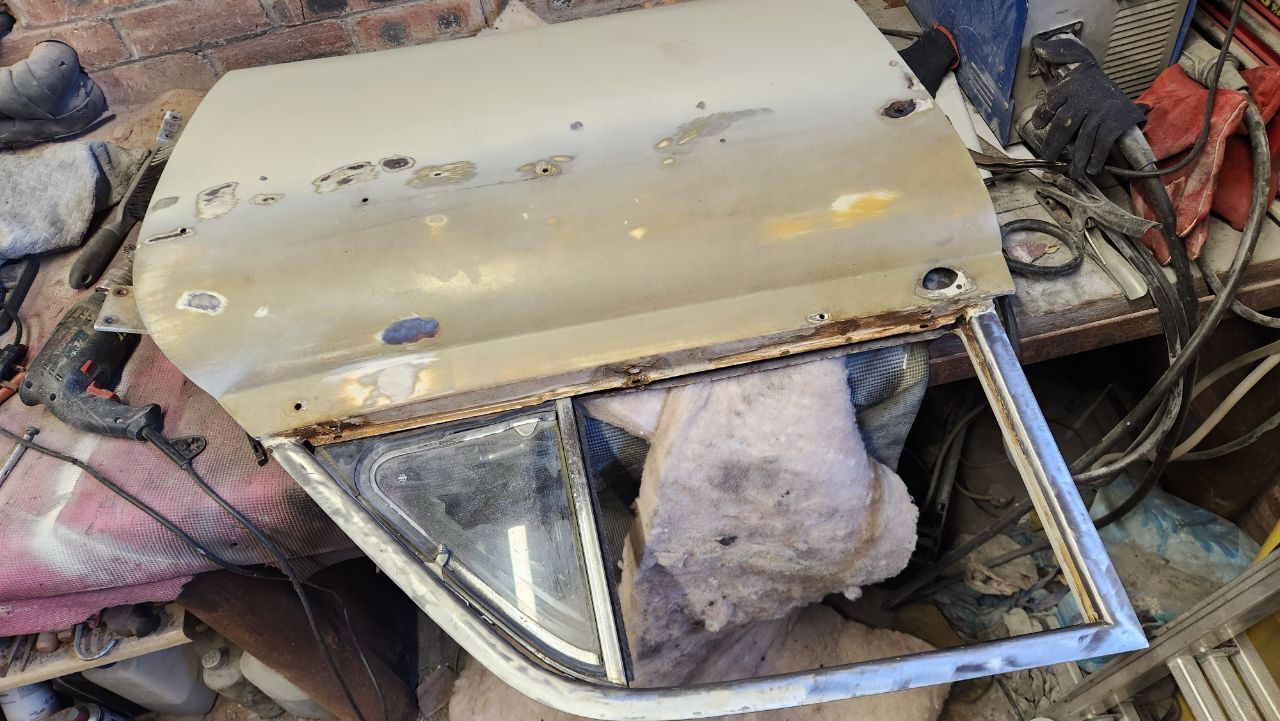

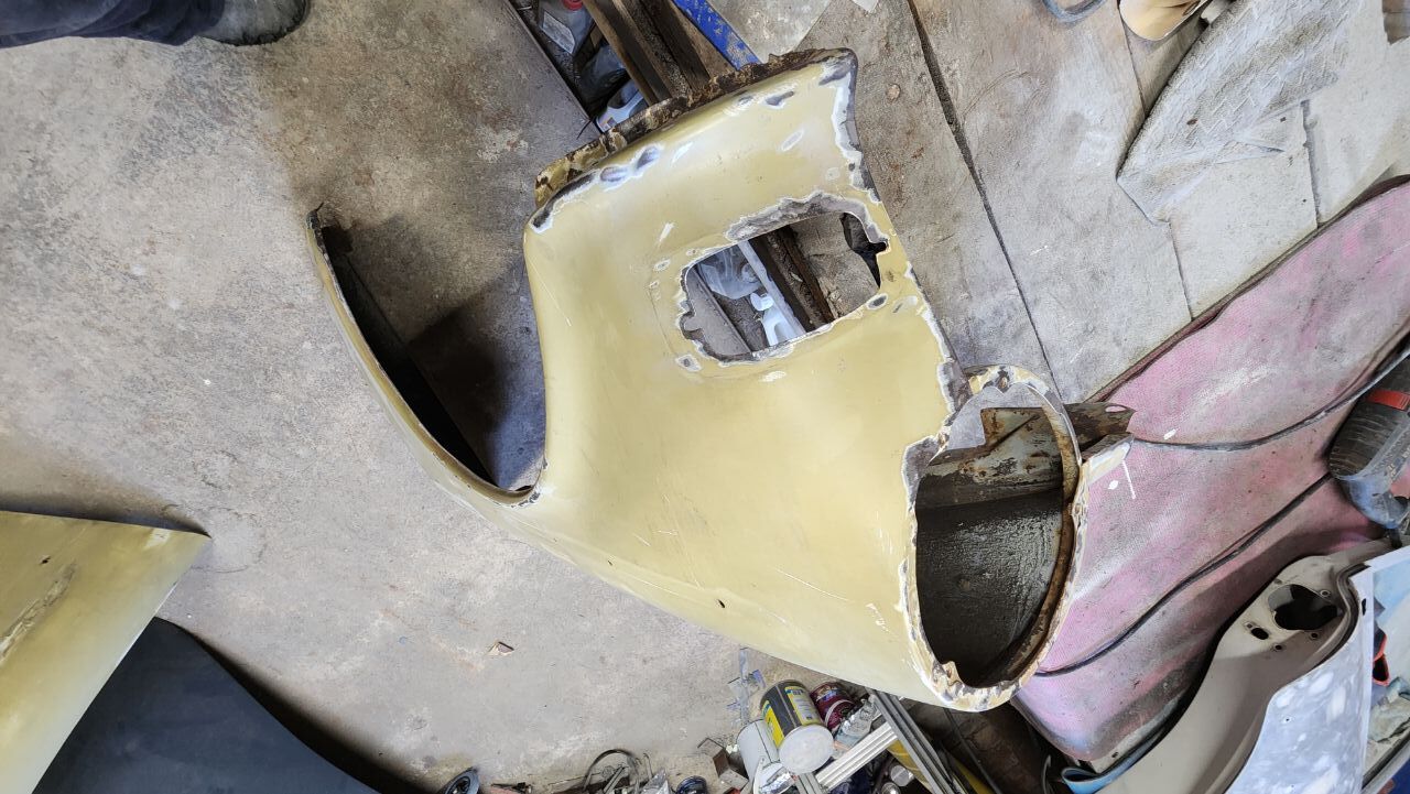

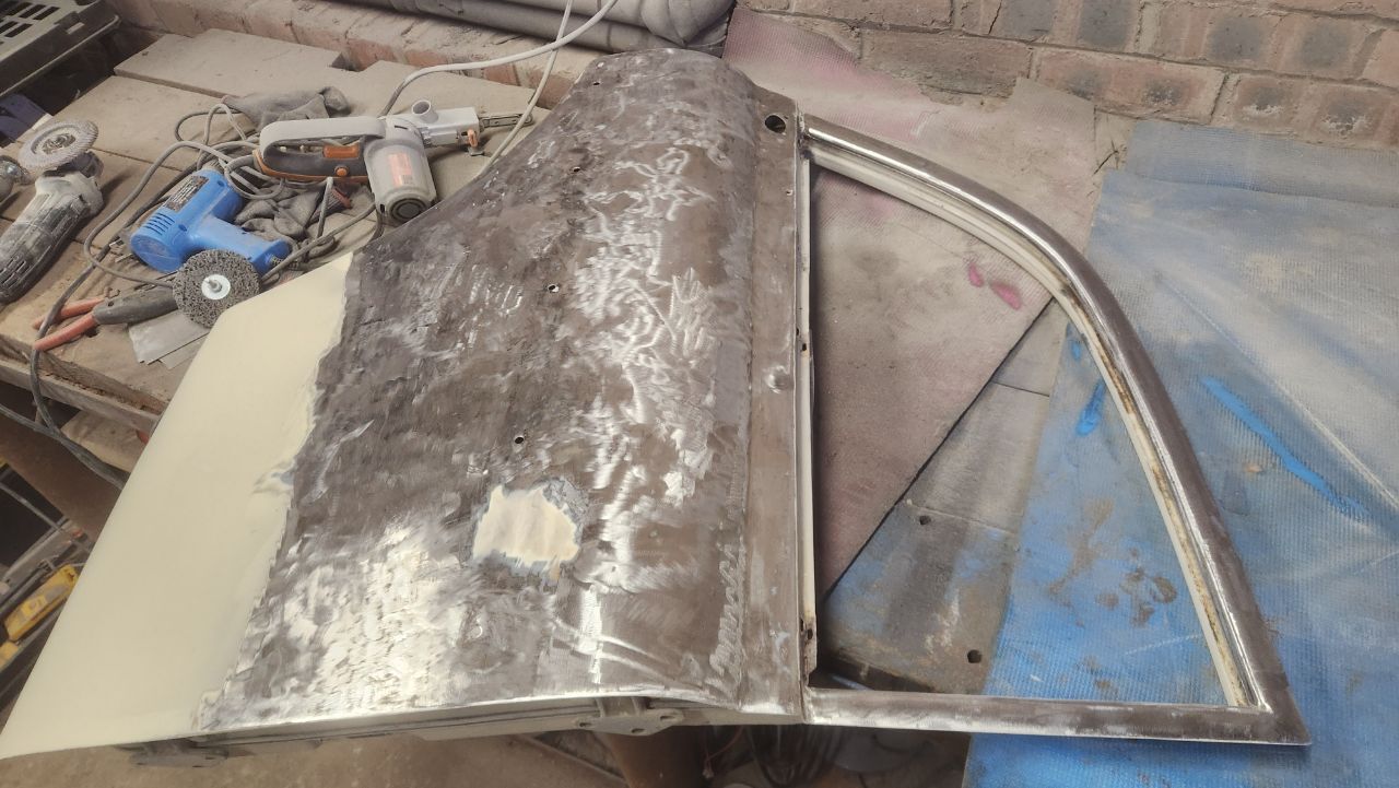

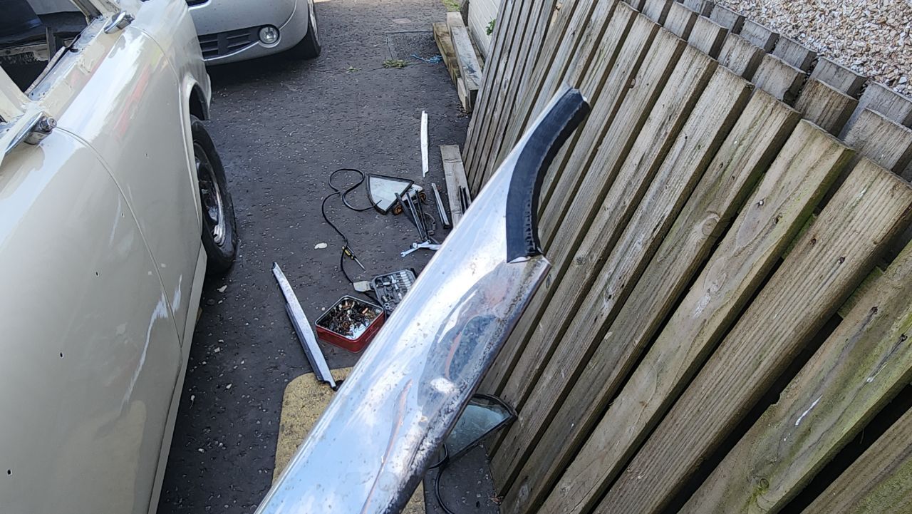

Made the stupid idea of taking some of this door back to the metal.
I noticed a bit of rust under the old filler.
So I ended up having to strip the lot.
This was a shit idea. Whatever the door was painted in was rock solid and even a knot wheel just bounced off it.
Ended up having to resort to a flap disc which was an even more shit idea as it dug into the metal in places and left divots.
Then I found a few dents with old filler in them that I had now wrecked.
So what followed was yet another full day of careful filling and sanding and losing the will to live.
But eventually getting a fairly straight looking door.
The front wings are in really good shape and just needed bits of derusting here and there.
And some glaze over scratches and dings.
Eventually this left me with two doors and two wings to coach paint which at least means I can do things in batches which will be quicker.

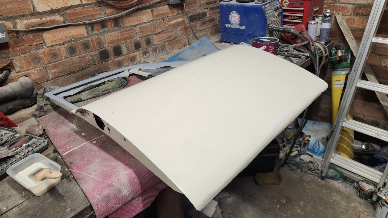

The first door which already has one coat got wet sanded with 400 grit which took some of the sags and brush marks out.
I then used a roller this time round, followed up by laying off with a dry brush.
Happier with that now. It has a mild orange peel effect but looks quite nice like a vintage steam roller. Which I guess is the point.

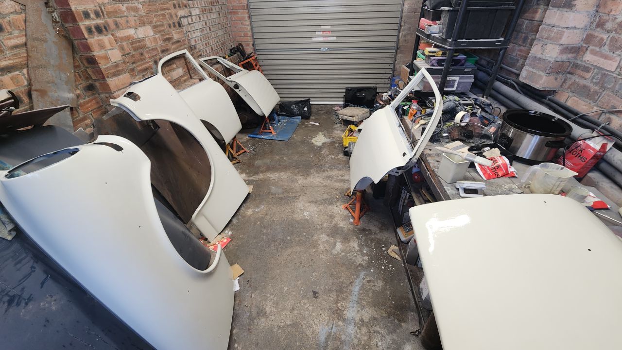

As you can see in the background I cracked on with the rest of the panels.
I'm getting marginally better at this, but the rear door does have a sag in the paint.
I'm finding the thickness of the paint a bit heavy and it does go tacky extremely quickly.
Might look into some brushing additives to see if they will help.
It's going to look like a different car

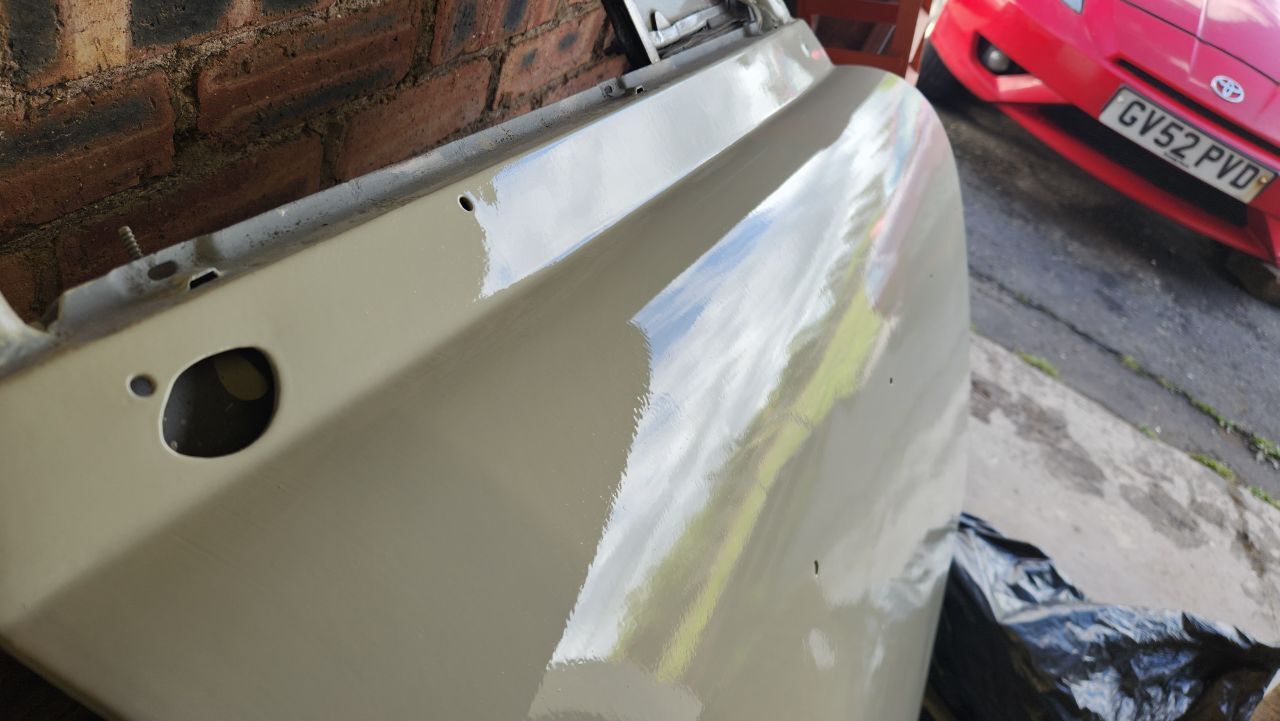

This isn't going as well as I'd hoped.
Thought I'd almost had it nailed down and was getting results like this, which I'm quite happy with.
Both panels had a couple of areas that I thought would benefit from another coat, so they were carefully given a final wet sand and another shot with the roller.
This last coat was a disaster and I'm not sure why.
What I'm finding with this paint is that it's very fickle and temperature dependant.
It was a little bit cooler which I thought would be better for painting but ironically this triggered the heating to kick on in the house. As the hot water pipes run through the garage I think it has actually increased the temperature in there significantly.
What I've been reading is that increased temperature causes a reduced wet edge time, and so the paint starts to dry before it has fully self levelled. The result is brush and roller marks galore.
It took rather a lot of wet sanding with 400 grit to get back to a reasonable surface.

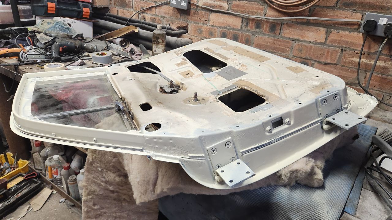

While I'm waiting for stuff to arrive it gives me a chance to prep the last two doors.
For some reason the filler in this area has bubbled up again and I had to cut it out.
I've stripped that right back to the metal and cleaned it with alcohol in the hope another skim will sort it.
The rest was cleaned up and treated as required. A few little areas of rust pitting needed sorted.

So, another round of rollering and laying off.
Still think that's a bit shit personally.
I have however realised that most of the brush marks are at the top of the panel.
The bottom is fairly smooth.
So, all of the brush marks are due to laying off rather than the actual painting.
I think this is screaming out to me that the laying off technique isn't right.
Rolling the entire door, even though it only takes a minute or two, is clearly still too long and is allowing the top of the panel to start drying before I lay it off.
The next approach is to go back to brush painting small sections and laying off immediately.

Amazon progress was put on pause this weekend due to 2CV racing at Mallory park, which in the end was so hot we had to give up and come home as we were getting ill.
Still, had some evenings and the odd bit here and there to experiment with paint.
The results from adding Owatrol and painting smaller sections weren't great.
What I saw is that the results you get as soon as you paint it are the results you get after 24h. There isn't much self levelling taking place.
It was recommended to me to heat up the paint.
So I stuck it in some hot water in a slow cooker.
The results from this were even worse.
I decided to do a little experiment.
Paint, straight from the tin. On one panel I rolled and laid off straight away. On the other I rolled and left it.
Laid off.
Not laid off.
The roller has left a mild orange peel but it isn't bad. It's way better than the laid off attempt which has honking big claw marks through it.
At this point I was getting a bit fed up and I decided I was just going to stop listening to anyone's advice and just do things my way.
Those all seem to be the best results I've got.
What I did was add 10% Owatrol to the paint, roller it on, and then very gently lay it off using only the roller applied as lightly as humanly possible. This bursts all the bubbles and leaves a very fine stippling that does dry flatter.

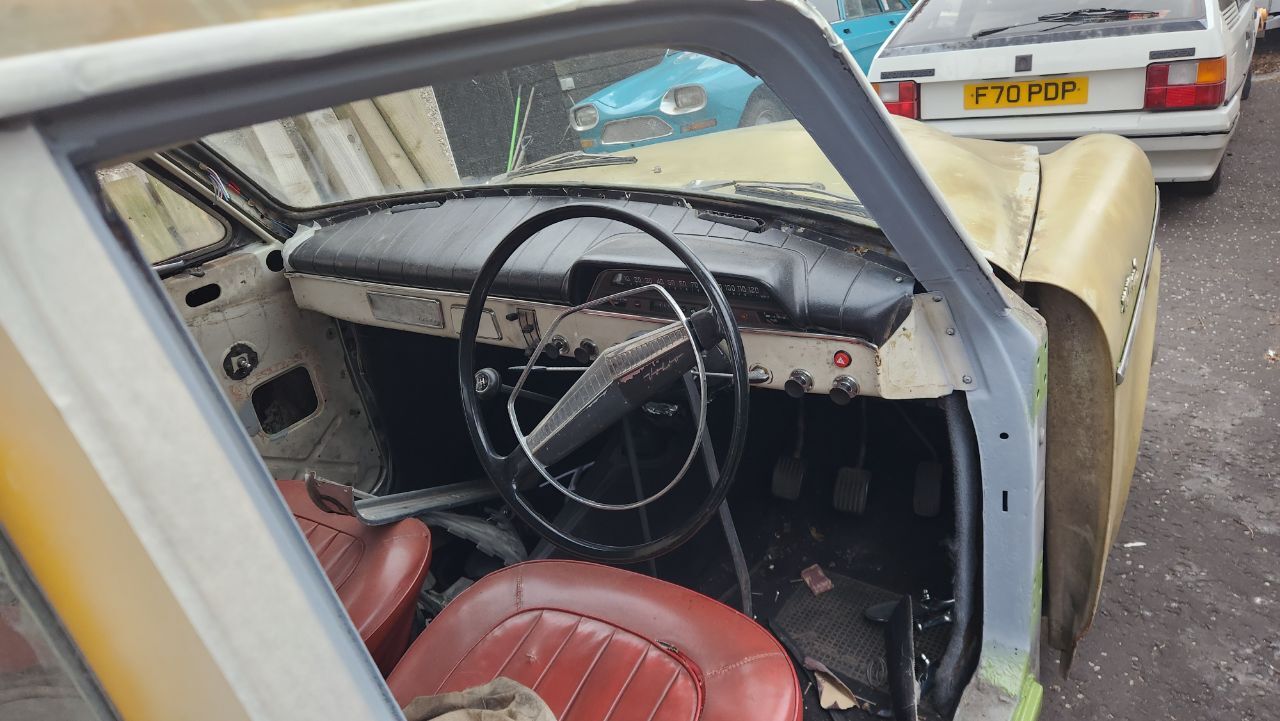

This leads onto the next chapter of self loathing.

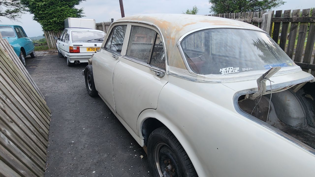

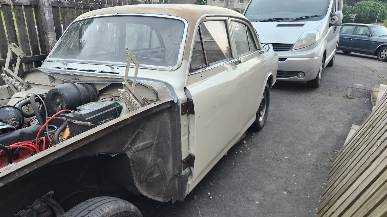

Stripping down the car ready for paint.
There is no way I could really get away with leaving its paint much longer. Some parts are blistering through quite badly.
Impressively none of the repaired areas are showing any rust. Yay for the magic combination of phosphoric acid and zinc.
Off with 60 years of patina.
As feared the paint was hiding some unpleasantness.
First step is to acid the hell out of it.
Then zinc.
Ive found that brushing this on and then flatting it with a roller gives a nice sprayed look.
Then some glaze, mostly to level off the surface with the already repaired areas.
Then filler primer.
Paint is getting tantalisingly close but I may need to back the car into the garage as the wind is slamming every seed, leaf and beastie off the surface.

Last days of sunshine, let's get this done!
I can think of no better way to attract and trap flies.
I only managed to get one coat on before the forecast started to change. However that's now the metal waterproofed until I can get the second coat on.
I used the last dry day to put the doors and windows back on so that I wouldn't have to tarp it and fuck up the soft paint.
This was a marathon. Even though I'd just taken the doors apart I completely forgot the order that things needed to be reassembled, and there is a very specific order or you have to start again.
Rage ensued.
By far the worst bit was reattaching the exterior chrome trim under the windows. These use spring clips that are under enormous tension to force the trim against the metal, and there was absolutely nothing I could do to reassemble them. I scratched the new paint quite badly in the process. I suppose thats inevitable. At least I can touch this up with a brush now!
As part of the chrome trim there's rubber finishers that stop the metal chafing against the paint. These all fell to bits when I took them off. Luckily I found a roll of stuff at the back of the garage that fit perfectly. No idea how I even came by it but it'll do.
In the end I attached these from inside the door frame using self tappers. Sue me.
I have also used an inordinate amount of cable ties to replace fucked spire nuts.
Anyway, much further swearing and losing the will to live ensured as I slowly built up the door internals, fitted the handles and locks and adjusted the doors individually so they didn't catch the paint.
I eventually got there at about 9 in the evening, having forgotten to eat.

The results seem worth it.
The entire crew were knackered.
I used both of the hinges @Ronkey sent me and they are perfect. The door shuts lovely now with a perfect snick, instead of smacking off the door frame every time. Once again, thank you.
I'm happy with the finish now. I may not even bother wet sanding away the orange peel as it kind of suits the classic shonky car vibe.
The enamel has a sort of glow and depth to it that I can't explain.  Base and clear from a spray gun seems a bit clinical in comparison.
Still a long way to go. Bonnet and boot lid need tidied up and refitted. Door seals need made. Interior needs reassembled. I will also clearcoat the boot lid and roof as they have a nice patina.
It's not bad for a paint job that cost under a hundred quid in materials.
It wouldn't suit a modern but it works here just fine.
