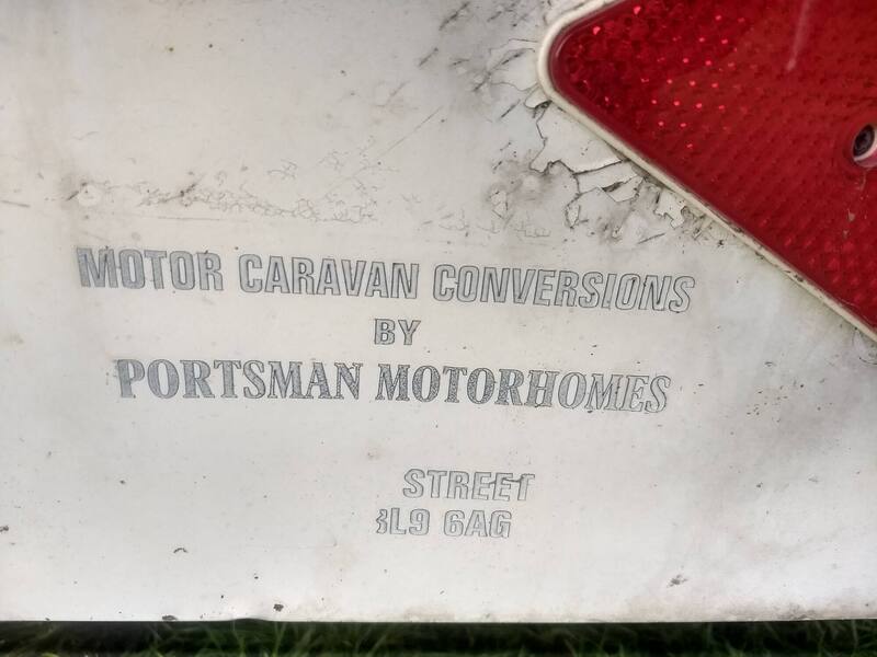

catsinthewelder Posted September 18, 2020 Share Posted September 18, 2020 Silly sod here googled Portsman Motorhomes before realising its Sportsman. Googling the postcode gets Bury in Greater Manchester where I had my first holiday without parents (East Lancs Railway diesel gala). LightBulbFun, Keymaster and 500tops 3 Link to comment Share on other sites More sharing options...
High Jetter Posted September 18, 2020 Share Posted September 18, 2020 1 hour ago, catsinthewelder said: Silly sod here googled Portsman Motorhomes before realising its Sportsman. Googling the postcode gets Bury in Greater Manchester where I had my first holiday without parents (East Lancs Railway diesel gala). I have to confess, had other goals on that inaugural experience in my life. Torquay hotel, honestly. Link to comment Share on other sites More sharing options...

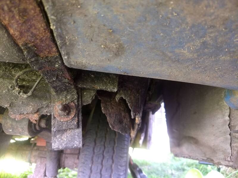

catsinthewelder Posted September 23, 2020 Share Posted September 23, 2020 Finally got a chance to do a bit more today, not used a saw to do bodywork before 😯 The plywood is mostly alright apart from around the gas cupboard, wheel arch and back end but with it removed fixing the sills is going to be loads easier and it gives me a chance to replace rotten framing. You can just about see the remaining bits of sill that need to come off. I'm going to drop the water tank too which will give me a chance to check it's clean and find out what's up with the pump. Mally, wuvvum, Mr Laurence and 5 others 8 Link to comment Share on other sites More sharing options...

somewhatfoolish Posted September 23, 2020 Share Posted September 23, 2020 Does not compute; there must be some kind of chassis in there, not just fresh air where a Sherpa floorpan used to be? LightBulbFun 1 Link to comment Share on other sites More sharing options...
catsinthewelder Posted September 23, 2020 Share Posted September 23, 2020 The van version has a fairly hefty chassis under the floor which appears to be in good condition, it's presumably less hefty than the chassis cab version though. I'm hoping to cobble something up with box section to replace the sills although being as the body rests on two rails that are bolted on top of the two chassis rails its quite tempting just to make a plywood box down each side. I'm certainly considering ways to make use of a space 25cm high, around the same deep and 2 metres long. Space to keep an awning? eddyramrod and LightBulbFun 2 Link to comment Share on other sites More sharing options...

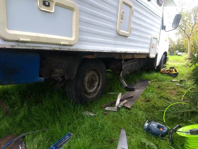

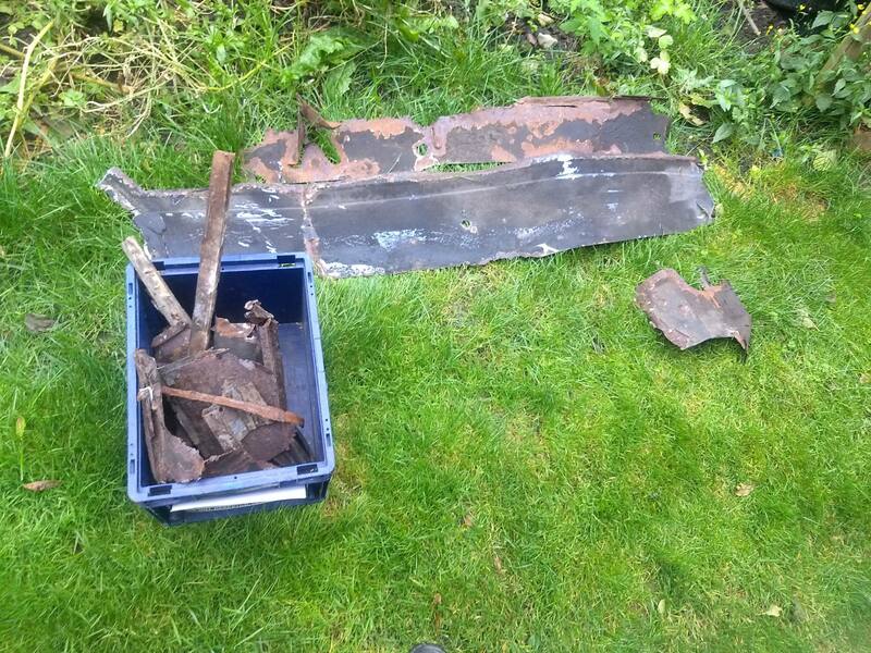

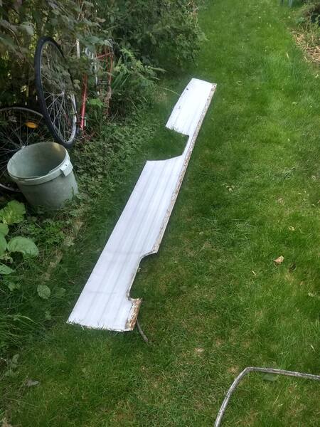

catsinthewelder Posted September 24, 2020 Share Posted September 24, 2020 Snatched a bit of spare time tonight and chopped this lot off. There would be pictures of the camper without it and sketches of what I need to replace it if a hailstorm hadn't sent me running back indoors 😂 phil_lihp, somewhatfoolish, Stanky and 3 others 5 1 Link to comment Share on other sites More sharing options...
