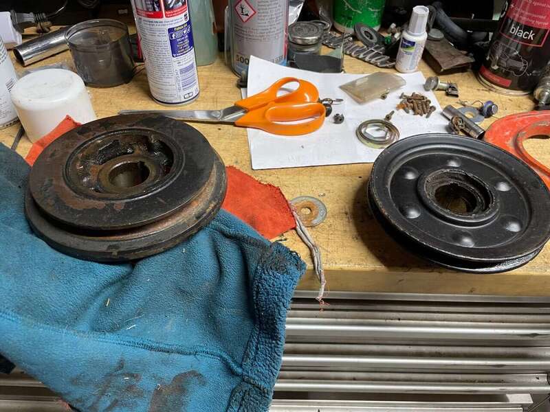

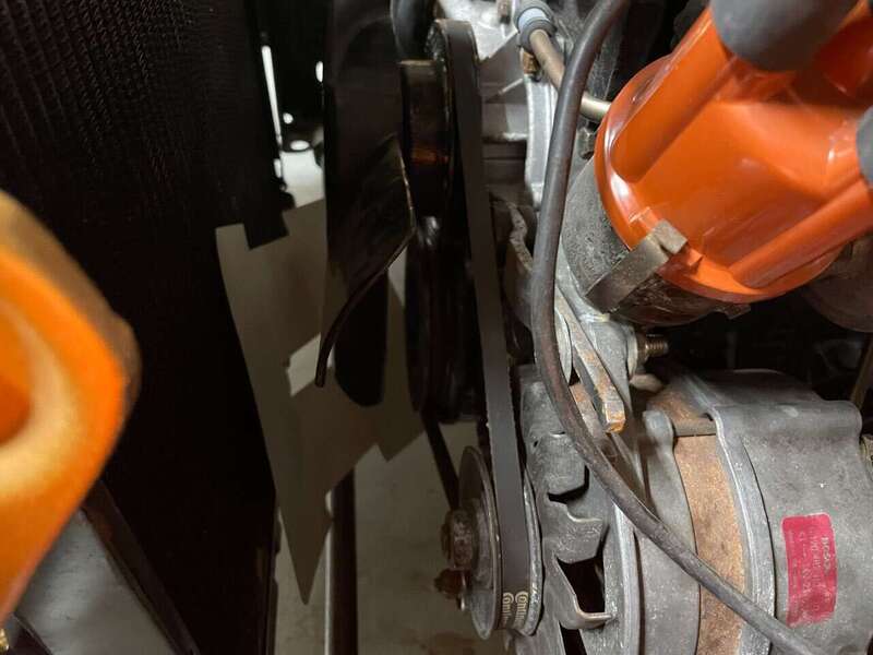

sutty2006 Posted February 11, 2025 Author Posted February 11, 2025 Another job ticked off the list. crank pulley looked like it was wobbling around. So I took it off. looks bent to me. just to double check, I got my highly calibrated tyre lever straight edge out. yep that’s bent. luckily I have a spare. It’s slightly different (has a dampener?) but it fits so it’s going on. that’ll do I’ll test it’s run out when I next fire her up. Shite Ron, JMotor, danthecapriman and 9 others 12

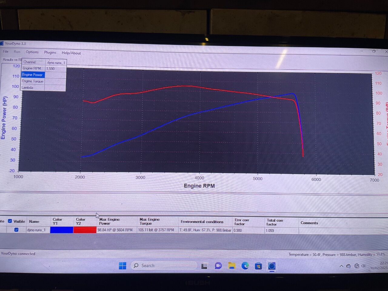

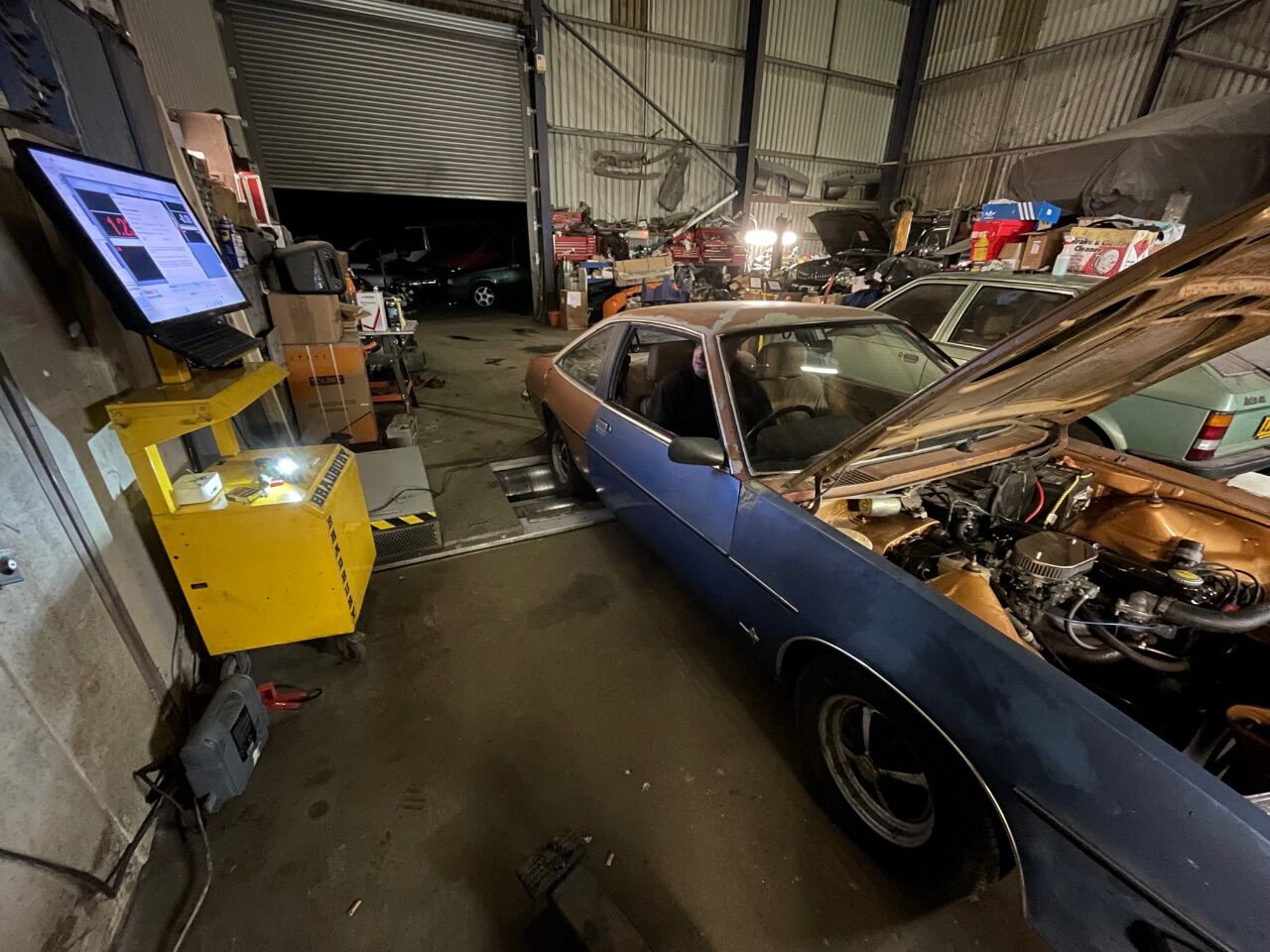

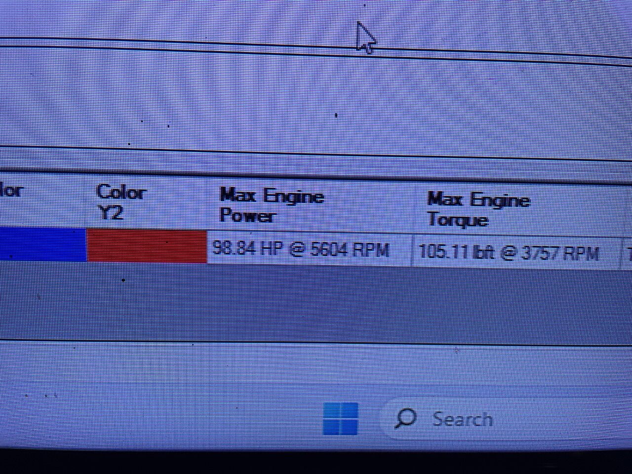

sutty2006 Posted March 12, 2025 Author Posted March 12, 2025 Last night it got tuned on a dyno by a friend who is local and really knows his stuff. once the timing was set, the carb was messed with and it was checked for remaining horses. second run produced 98 horses remaining of the original 100 that it started with. Scruffy Bodger, Matty, CaptainBoom and 37 others 40

jim89 Posted March 12, 2025 Posted March 12, 2025 17 hours ago, sutty2006 said: Last night it got tuned on a dyno by a friend who is local and really knows his stuff. once the timing was set, the carb was messed with and it was checked for remaining horses. second run produced 98 horses remaining of the original 100 that it started with. That can be rounded up to 99 shurely? Impressive either way 👍🏻🥳 djim, Snake Charmer, outlaw118 and 1 other 4
sutty2006 Posted March 13, 2025 Author Posted March 13, 2025 6 hours ago, jim89 said: That can be rounded up to 99 shurely? Impressive either way 👍🏻🥳 I never thought of it that way, but I’ll take it! 😁 Burnside, Snake Charmer and jim89 2 1

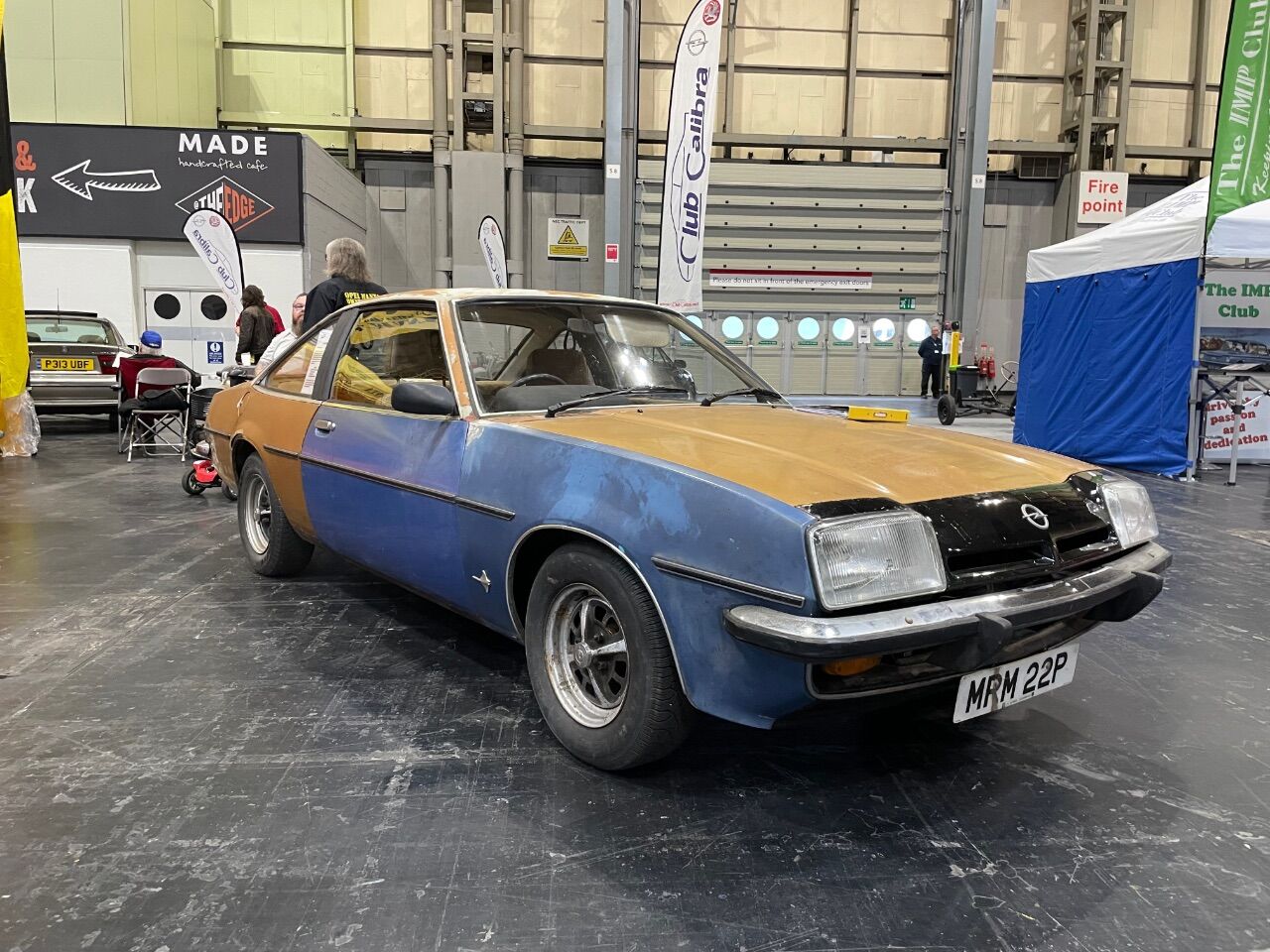

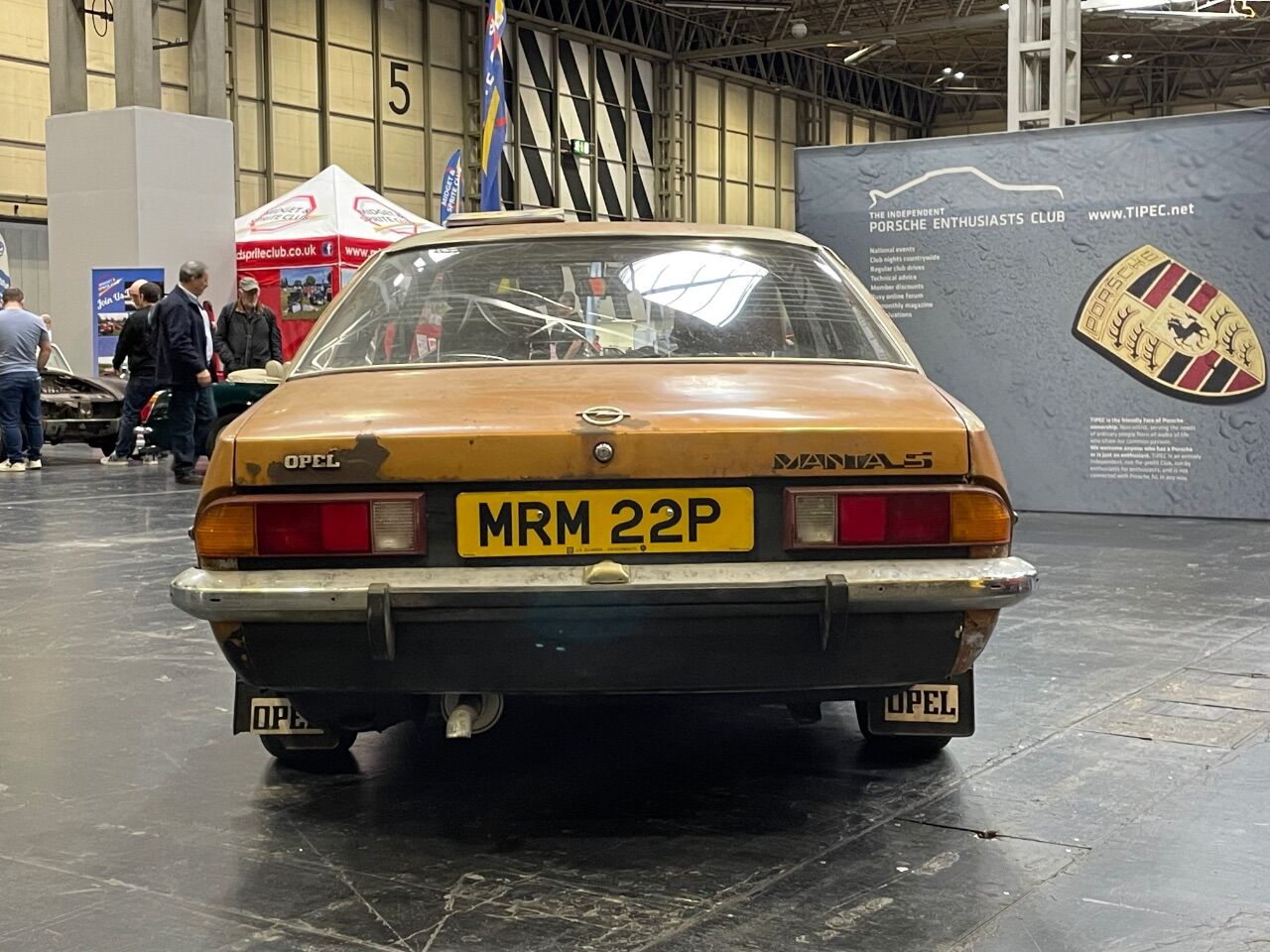

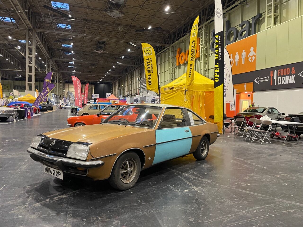

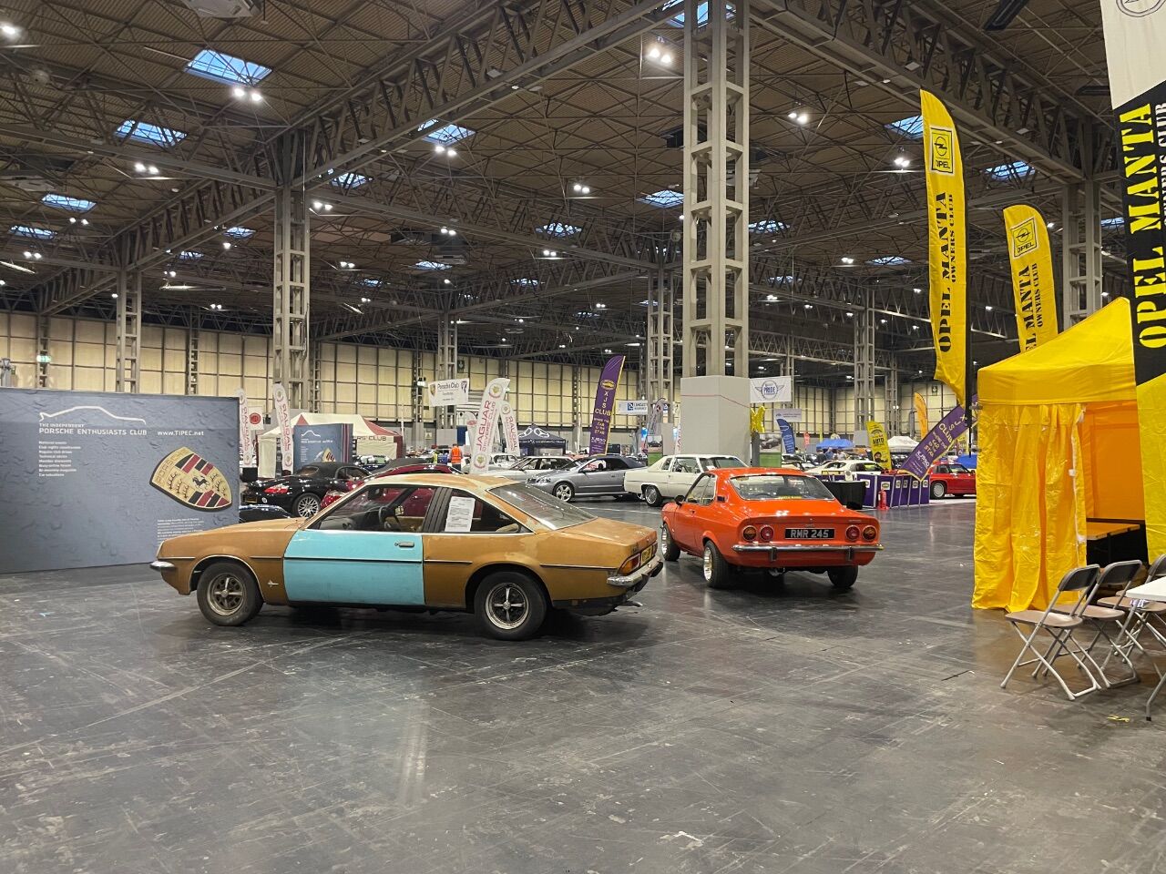

sutty2006 Posted March 21, 2025 Author Posted March 21, 2025 Well boys and girls. I drove this old banger down to the NEC yesterday. It made it here without hiccup. It’s still jerking when I let off the throttle in gear, but we will get to that. I got all this way, and heading into the NEC from the N12 car park it died. Won’t idle. It’ll start and rev up but didn’t idle. I made it into the show hall, allbeit having to constantly restart it after it cuts out. I’ve taken primary idle jet out and there was a tiny blob of crap in the end of it. I’ve cleaned it out, and cleaned the secondary jet too. Hopefully this will have cured that issue. im here all weekend, I’ll be hovering around the manta club stand over the weekend but this place is VAST and I’ve a pocket with cash in. So come and say hello 😁 HillmanImp, Burnside, CaptainBoom and 38 others 34 7
Matty Posted March 21, 2025 Posted March 21, 2025 17 minutes ago, sutty2006 said: Well boys and girls. I drove this old banger down to the NEC yesterday. It made it here without hiccup. It’s still jerking when I let off the throttle in gear, but we will get to that. I got all this way, and heading into the NEC from the N12 car park it died. Won’t idle. It’ll start and rev up but didn’t idle. I made it into the show hall, allbeit having to constantly restart it after it cuts out. I’ve taken primary idle jet out and there was a tiny blob of crap in the end of it. I’ve cleaned it out, and cleaned the secondary jet too. Hopefully this will have cured that issue. im here all weekend, I’ll be hovering around the manta club stand over the weekend but this place is VAST and I’ve a pocket with cash in. So come and say hello 😁 Fucking hero 👏 Snake Charmer, Popsicle, djim and 6 others 1 8
Tickman Posted March 22, 2025 Posted March 22, 2025 That looks ace. Enjoy the weekend and fingers crossed the idle is sorted after the clean. Snake Charmer and sutty2006 2
Skizzer Posted March 22, 2025 Posted March 22, 2025 12 hours ago, sutty2006 said: Well boys and girls. I drove this old banger down to the NEC yesterday. It made it here without hiccup. It’s still jerking when I let off the throttle in gear, but we will get to that. I got all this way, and heading into the NEC from the N12 car park it died. Won’t idle. It’ll start and rev up but didn’t idle. I made it into the show hall, allbeit having to constantly restart it after it cuts out. I’ve taken primary idle jet out and there was a tiny blob of crap in the end of it. I’ve cleaned it out, and cleaned the secondary jet too. Hopefully this will have cured that issue. im here all weekend, I’ll be hovering around the manta club stand over the weekend but this place is VAST and I’ve a pocket with cash in. So come and say hello 😁 I came over and drooled over this yesterday afternoon but I don’t think you were around — I’ll swing by again today. (I’m across the hall with the Rancho.) It’s FANTASTIC. ProgRocker, Snake Charmer and Saabnut 3
Surface Rust Posted March 22, 2025 Posted March 22, 2025 I somehow missed your most recent updates - congratulations on getting this back on the road. It looks great - period 1990 street scene material! Enjoy! sutty2006, Snake Charmer and Burnside 1 2
sutty2006 Posted March 22, 2025 Author Posted March 22, 2025 50 minutes ago, Skizzer said: I came over and drooled over this yesterday afternoon but I don’t think you were around — I’ll swing by again today. (I’m across the hall with the Rancho.) It’s FANTASTIC. This one? I may have shared drool Westbay, JMotor, rm36house and 14 others 17

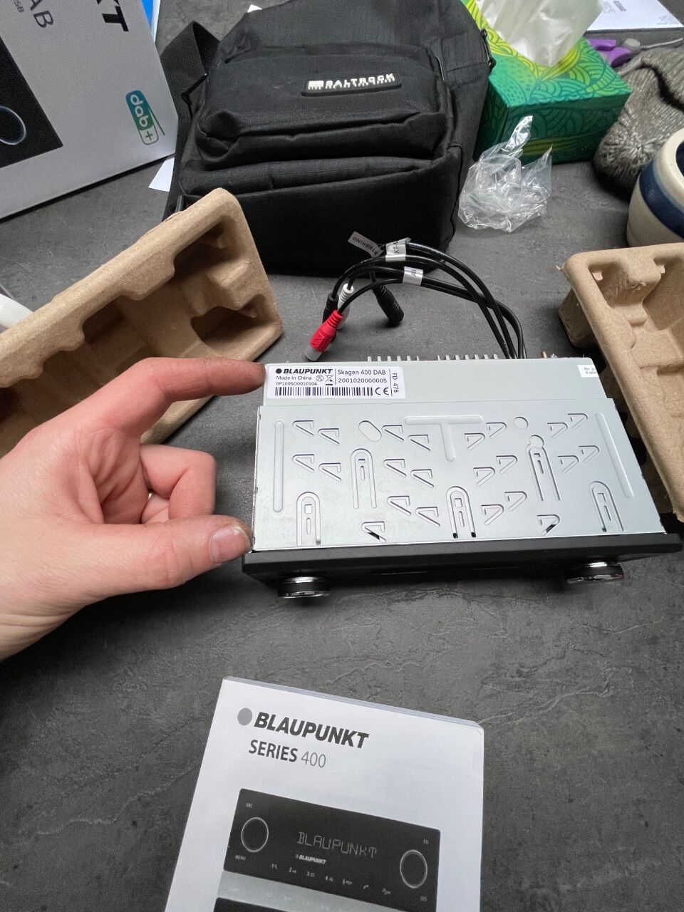

sutty2006 Posted March 25, 2025 Author Posted March 25, 2025 I was soooooo happy that the manta made it to the NEC (and back!) unaided, I bought it some tunes. long gone are the days of heading to Chapels (high lane) and buying some radio gear, and Halfords is wank. So I bought this nifty little number from CEN-UK. Blaupunkt Skagen 400, with a nice little pair of 4 inch speakers to complement it. lovely little thing! and it’s this big so it should fit snug in the dash without using an extender. Shite Ron, Dick Cheeseburger, andy18s and 10 others 13
Noel Tidybeard Posted March 25, 2025 Posted March 25, 2025 it might* have been me that suggested to matt furious that the manta may not be as found!😂
andy18s Posted March 26, 2025 Posted March 26, 2025 15 hours ago, sutty2006 said: I was soooooo happy that the manta made it to the NEC (and back!) unaided, I bought it some tunes. long gone are the days of heading to Chapels (high lane) and buying some radio gear, and Halfords is wank. So I bought this nifty little number from CEN-UK. Blaupunkt Skagen 400, with a nice little pair of 4 inch speakers to complement it. lovely little thing! and it’s this big so it should fit snug in the dash without using an extender. I have one of those extensions for the stereo kicking around in a bag somewhere,along with a Vhs of Manta Magic,2 Exclusive wheel centre-caps and a new rear diff gasket for a 1.8, because just in case ...... Bear and sutty2006 2

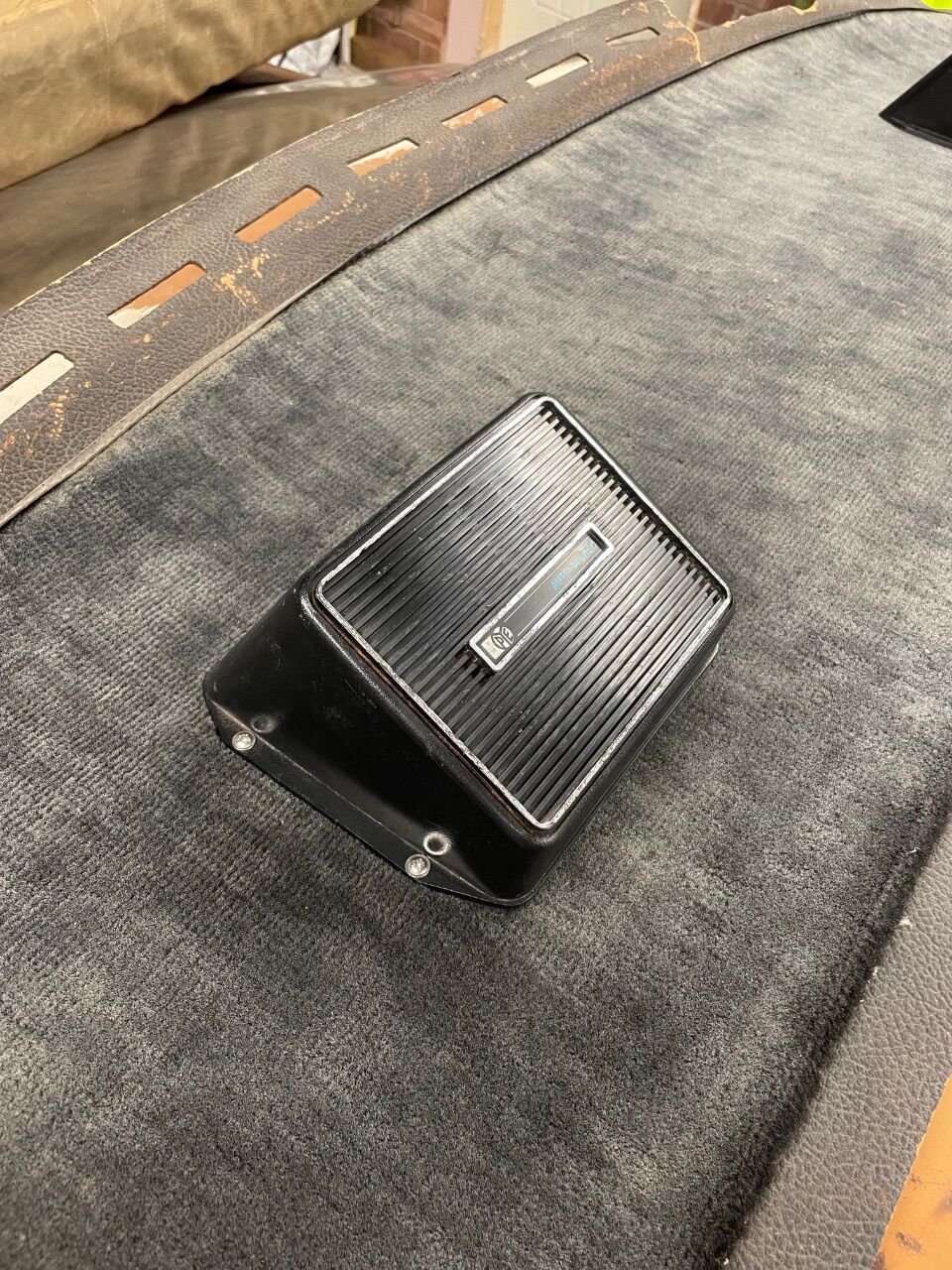

sutty2006 Posted April 1, 2025 Author Posted April 1, 2025 Started fitting some speakers to the rear shelf. these are new German made high quality speakers (hopefully) I had to space them out with silicone vacuum hose to clear the top of the speaker wired up and fitted. I’ve ran the wiring up to the dash. Need to wire up the radio now. Tickman, djim, Shite Ron and 9 others 12
