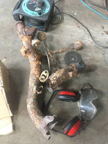

rickvw72 Posted July 5, 2020 Posted July 5, 2020 Hi all, I’m going to try to keep this updated as a diary of work done on my old Fourtrak. I bought this a few years ago but have only recently got going on it properly, with several other projects on the go, times been scarce. Ill start with the main job, the rear crossmember. When I bought the truck this tube had snapped on the drivers side. This ruptured the brake pipes, and ruined all the already tired suspension bushes. So, out with the crossmember... The original is round tube, the new 3mm wall box section, it actually holds the anti tramp bars. Yes the Fourtrak has a 5 linked rear suspension, and an LSD. Because race car! I didn’t take many pics at this time, so I’m trying to improve this and maybe a thread will motivate me to document it. RayMK, juular, 500tops and 14 others 17

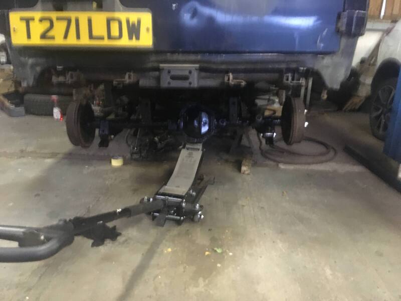

rickvw72 Posted July 6, 2020 Author Posted July 6, 2020 With the rear chassis welded, and the arms done, the rear axle could go back in to make it roll. This was fitted but not fully done up. The plan is to remove it again to treat the whole underside with an underseal or similar. Before this there’s other rust to sort, you can see some of the treats in store in the arches from these pics already. Close up pics to come, when I can bare to look at them myself! So, for the first time in a while, the beast was on four wheels, and was movable again. BlankFrank, juular, CreepingJesus and 10 others 13

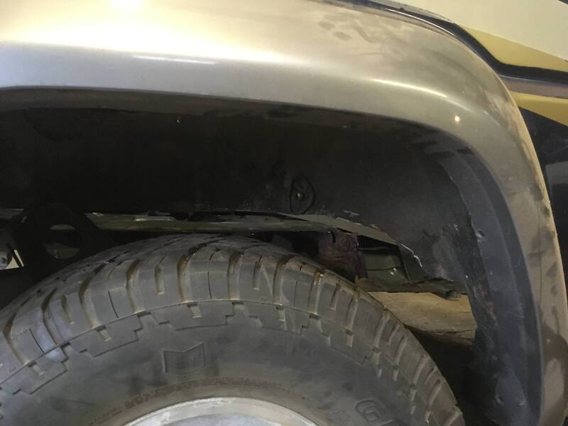

rickvw72 Posted July 9, 2020 Author Posted July 9, 2020 So, time to look inside. Being a Fourtrak, it’s had “a bit” of welding in the past. And a bit of bathroom sealant. Obviously the multiple layers of steel are roughly welded over the rust. theshadow 1
rickvw72 Posted July 9, 2020 Author Posted July 9, 2020 So, as I’m a sadist I decided to remove the previous repairs, and look for some sound steel to weld to. This was a bit like peeling a rusty onion. Obviously, being a total rust bucket, the job soon escalated a touch. BlankFrank, paulplom, Dick Cheeseburger and 14 others 15 2

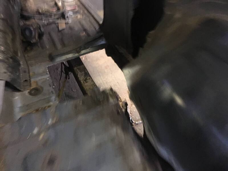

rickvw72 Posted July 10, 2020 Author Posted July 10, 2020 You can see in the boot, without opening the doors! MKT and theshadow 2

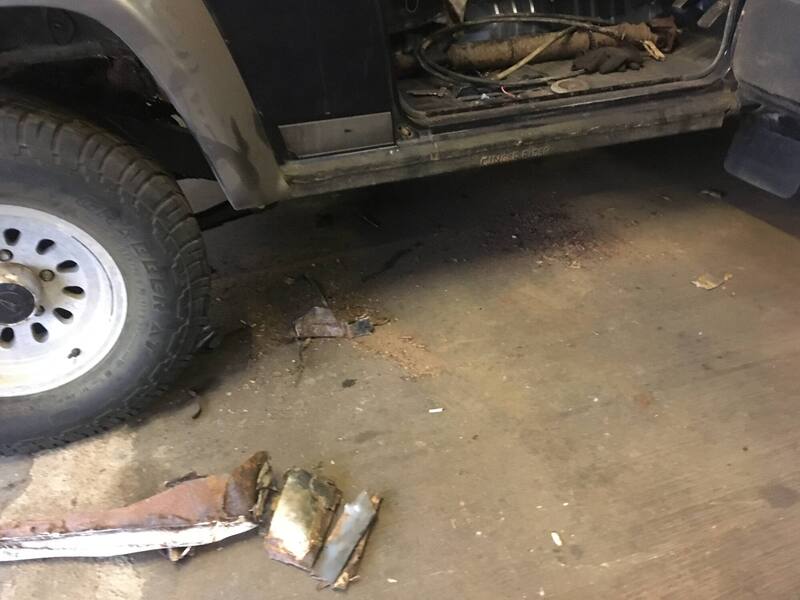

rickvw72 Posted December 9, 2020 Author Posted December 9, 2020 Realistically last update for the year, thought after 5 months it’s time, and threads that go cold with this sort of job often seem like they got abandoned. Truth being, I work In education, and since last update, work got a bit mental.. Back to the Fourtrak. More and more lumps of metal have come out, sound metal found eventually though. So I thought. What a turkey. Chopping all this out was great. So great the inner sill couldn’t wait so fell off all by itself. Bugger. Then a couple of months of work, Covid, catching Covid, work etc got in the way of progress. So a tidy up was in order. The old crossmember, which has the tramp bars fused to it, was chucked in the back, till more time was available. This was a great idea, as the sharp bit punched its way through the rear body mount, which promptly collapsed. So by this point I have a car with half the floor out, the sills falling off by themselves, and the body mounts collapsing.. essentially, I think the gearstick was holding the body on. There always comes a point where a decision has to be made.... After a short, soft think, clearly I’m gonna weld it up. Several smaller jobs are underway at the minute, hoping to get the welder out in the Christmas holidays if I get some free time. Will 2021 be the year it rides again? Burnside, mercedade, Jenson Velcro and 8 others 10 1
