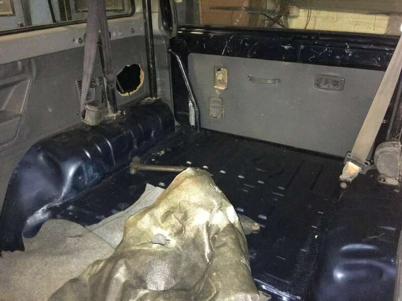

3B90AF6F-34E5-4237-8ADA-674D9497485D.thumb.jpeg.5a3d669de1f37b939e5df9adbec312f5.jpegso I painted it blue
a Fourtrak with a boot floor

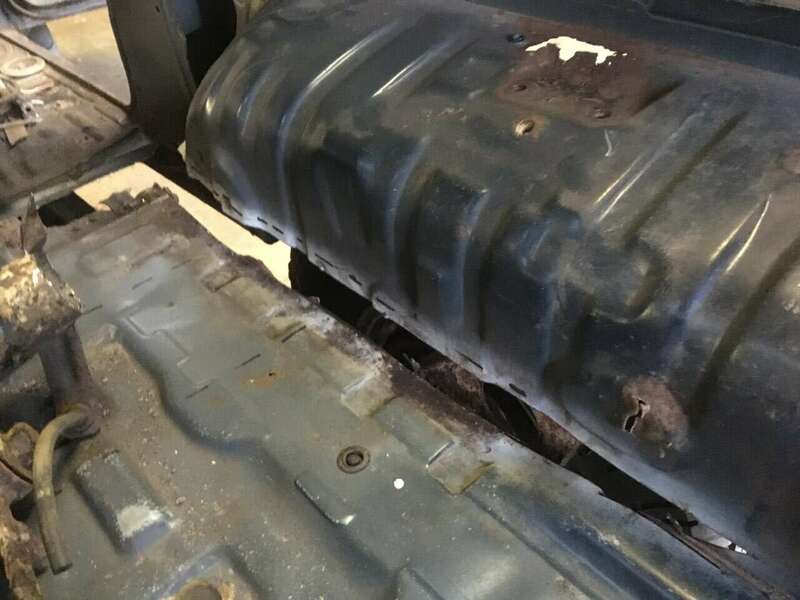

Under the rear seat and floor when I took out the trim
A7785534-C00A-4BCE-B299-2F29E259E81A.thumb.jpeg.eb2b11dc265dd8b61231249d2f2b4d71.jpeg Inner arch to boot floor seam. You can just about see rot around the roll cage and seat belt mounts here on top of the arch.

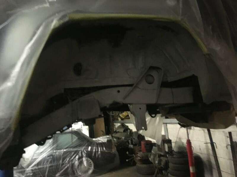

Not to neglect the under side
epoxy resin primer
3M Schultz final coating.
