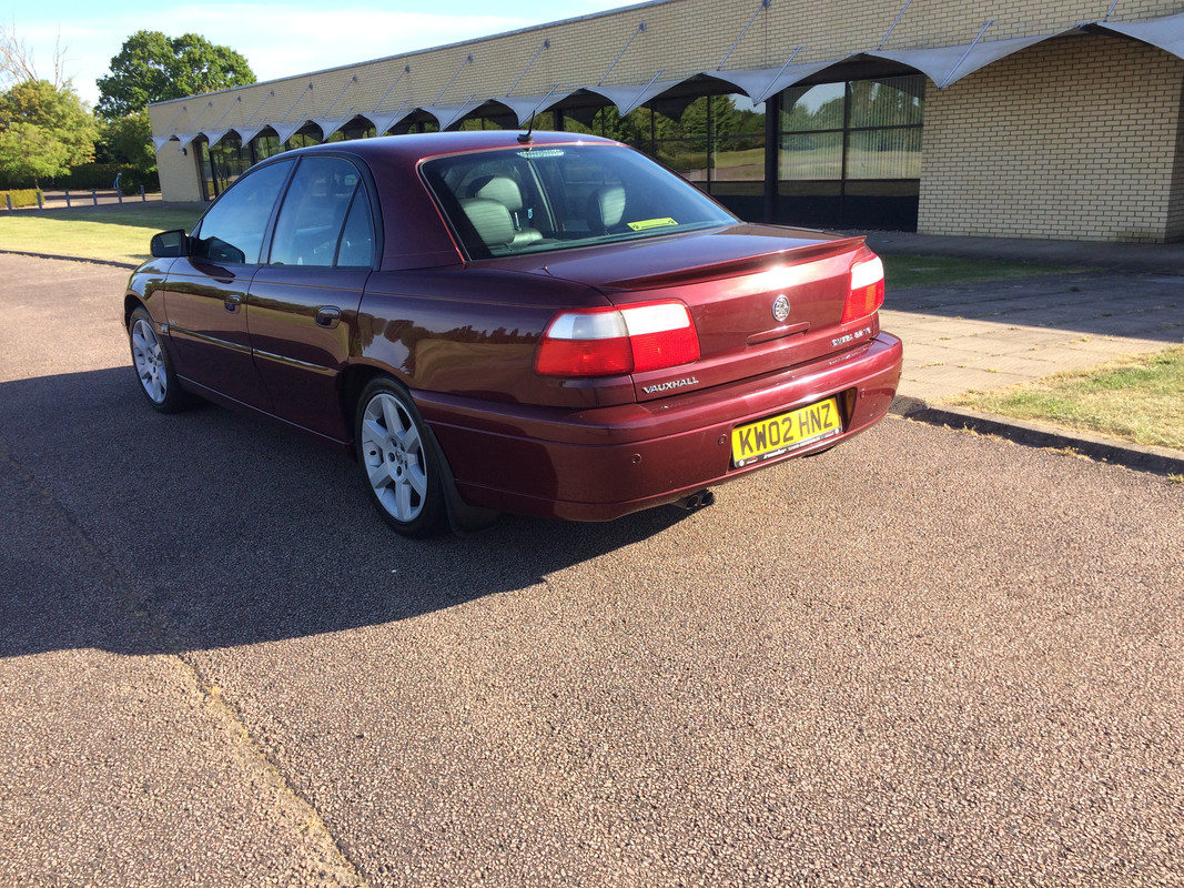

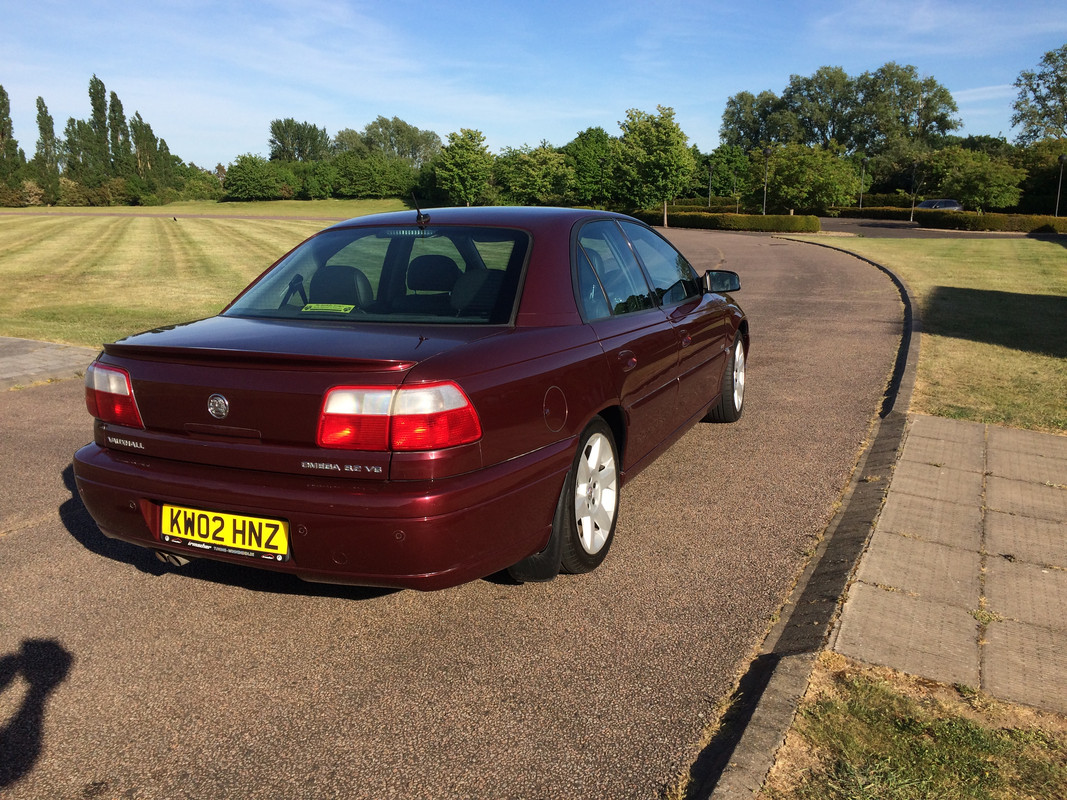

All Vauxhalls are shite. We all know this. Its in the forum Bible. So by this reasoning, I have set out to prove you can polish a turd. Even when its 18 years old, with 188000 on the clock.
Shiny shite.
Plum crazy.
It was a bit tongue in cheek. I love the old thing. Its a lovely thing to drive. Ive fitted ex police car springs & dampers on the front. Polybushed the wishbones. Fitted slightly stiffer shocks and springs on the rear and had four wheel alignment done to wheels in motion spec, rather than the standard figures.
Replaced all sorts of other bits and pieces to the tune of well over two grand, in the four years Ive owned it and changed the oil and filters every four thousand miles. Its not worth a lot, but I cant bring myself to get rid of it at the moment, so it doesn't matter to me.
Ive had quite a few of them, and this is the best one by far despite the age and mileage.

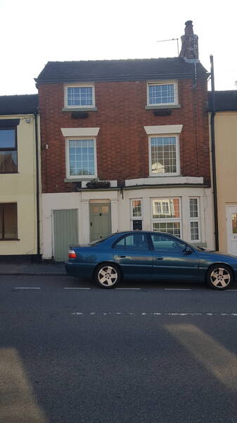

Very very very nice.  Lovely colour.  Are you on OOF ? Is it a 3.2 or 2.6 ?
Here's mine hidden by bushes.

The Elite is very soft and a bit wallowy in standard form. The common mod used to be to swap to MV6 suspension but that's rarer than rocking horse shit now. I was lucky enough to see an ad for ex police front struts just after I got the car so thought I would give them a try. I then realised that someone had fitted estate rear springs which made the rear sit too high. I knew from experience that elite rear springs are very soft indeed, so fitted a new set of standard spec springs. Then refurbed the wishbones with new rear bushes, balljoints and polybushed front bushes.
Then had the four wheel alignment done and was very pleased to find that I had ended up with an example that felt nice and tight, and handles superbly for a big barge yet had lost little of the ride comfort in the process.
Recently the self levelling rear dampers finally gave up. Only available from Germany at £500 a pair ! Fitted a new pair of Sachs rear dampers which has made the rear a bit tighter than it was, so still happy enough, although ideally I would have liked to have kept the self levelling.

In the interests of anorakness, I forgot to mention when replacing the front struts I also fitted Monaro top mounts to them, which are stiffer.

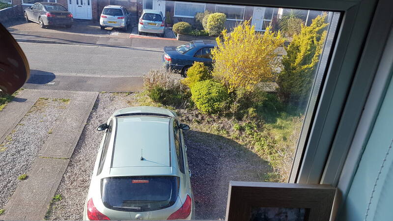

Here's some more pictures of a 3.2
