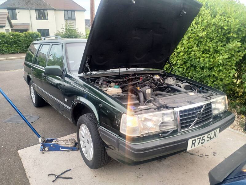

KitKat Posted June 15, 2020 Posted June 15, 2020 18 hours ago, philibusmo said: I got it a couple of days ago, and its a very useful size for taking stuff to the dump and storing Fiesta front wings. I'm pretty certain it needs a new gearbox as 5th is utterly borked (so if anyone has a Volvo M90 manual box hanging around then let me know) but it drives smoothly. I'm not sure how long it will hang around to be honest as it's not really me. I keep buying comfy barges, but I prefer cars that offer swivel eyed lunacy. However it is a magnificent beast, and green. Unusual the gearbox is borked, especially on such a low mileage 940. These M90 boxes are renowned for their strength. Is it only jumping out of 5th gear, or is it noisy too? If its just a issue selecting 5th then it could just be a problem with the linkage
phil_lihp Posted June 15, 2020 Posted June 15, 2020 It's been a while since a 940 graced that driveway! Although I recall at the time you weren't much taken with mine either. Shame about the gearbox, would a fluid change help? KitKat 1
philibusmo Posted June 15, 2020 Author Posted June 15, 2020 5 hours ago, sickboy said: Unusual the gearbox is borked, especially on such a low mileage 940. These M90 boxes are renowned for their strength. Is it only jumping out of 5th gear, or is it noisy too? If its just a issue selecting 5th then it could just be a problem with the linkage It's not noisy, just if you pop it into 5th it pops straight back out again the majority of the time and if you attempt to waggle or push it in then it just graunches and grinds. I haven't really looked into it properly yet or checked to see how the linkage goes together, but it initially feels like it has successfully found 5th before immediately heading back for neutral.

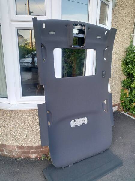

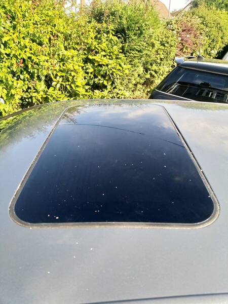

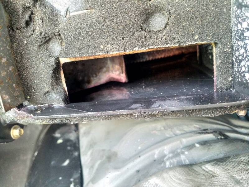

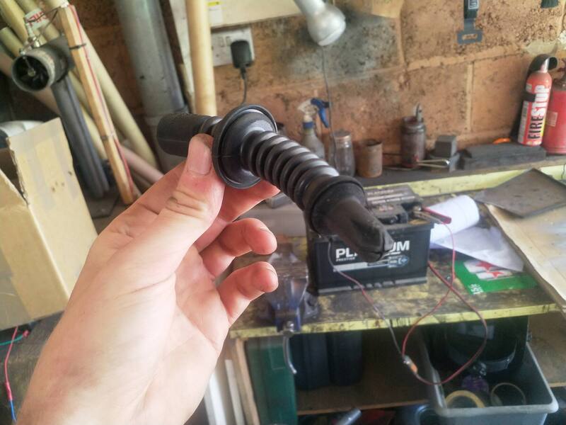

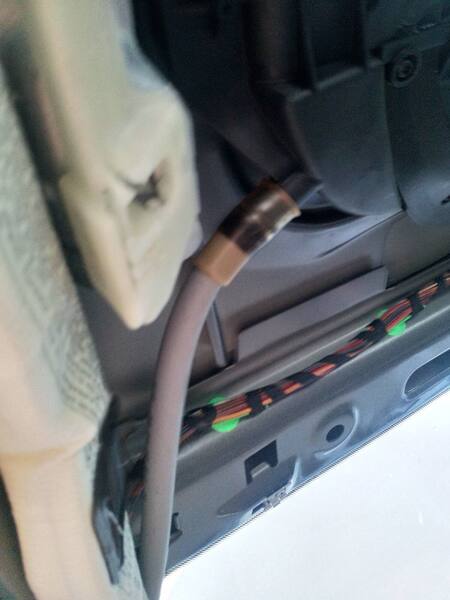

philibusmo Posted June 16, 2020 Author Posted June 16, 2020 Golfs water leak is fixed. The sunroof drain tubes go into these funky nipple type things at the bulkhead, which then go through some sort of empty, uninhabited, chasm under the windscreen before appearing into the scuttle area. I pulled them out on both sides and both were blocked with about an inch of mud which is now deposited into the hedge at the edge of the drive. (Battery being charged on the background as it doesn't take well to having all the doors opened for 8 hours) Getting these things back in place was a bit of a mission as you've got to push them in behind the corner of the dash, where you can hardly get your hand on them and then thread them through the void and into the hole into the scuttle area. I managed in the end by threading some parachute cord through them and nearly getting my finger stuck multiple times fishing around to pull it through into the scuttle. Meanwhile, my very attractive significant other (the exact wording has been dictated to me) was cleaning up the dashboard and generally making it feel like you could live for more than an hour inside with the windows shut. A bucket of soapy water with a cloth and a tooth brush is making it come up quite well. Finally I put the headlining back in, along with all the grab handles, courtesy lights and sun visors that are attached. Only the B pillar trims put up a particular fight to be pushed back into position. I know there is a lot of VW hate on here, but I can't really understand why. Having worked on multiple Volkswagens and Audis, I've consistently found them to be well thought out cars made out of good quality materials, and really not bad to work on compared to what the Frech come up with. Iknow some of the more modern stuff is a bit pish, but I'd genuinely rather have a Mk4 or Mk5 Golf over any other similarly sized car of the same vintage - so obviously excluding the Talbot Horizon. Finally, the tape around the sunroof left a right sticky mess, which has been taken care of with a rag and WD40. Hopefully the forecast torrential downpours will arrive tomorrow and prove that this car is now watertight. rainagain, theshadow, Twiggy and 15 others 18

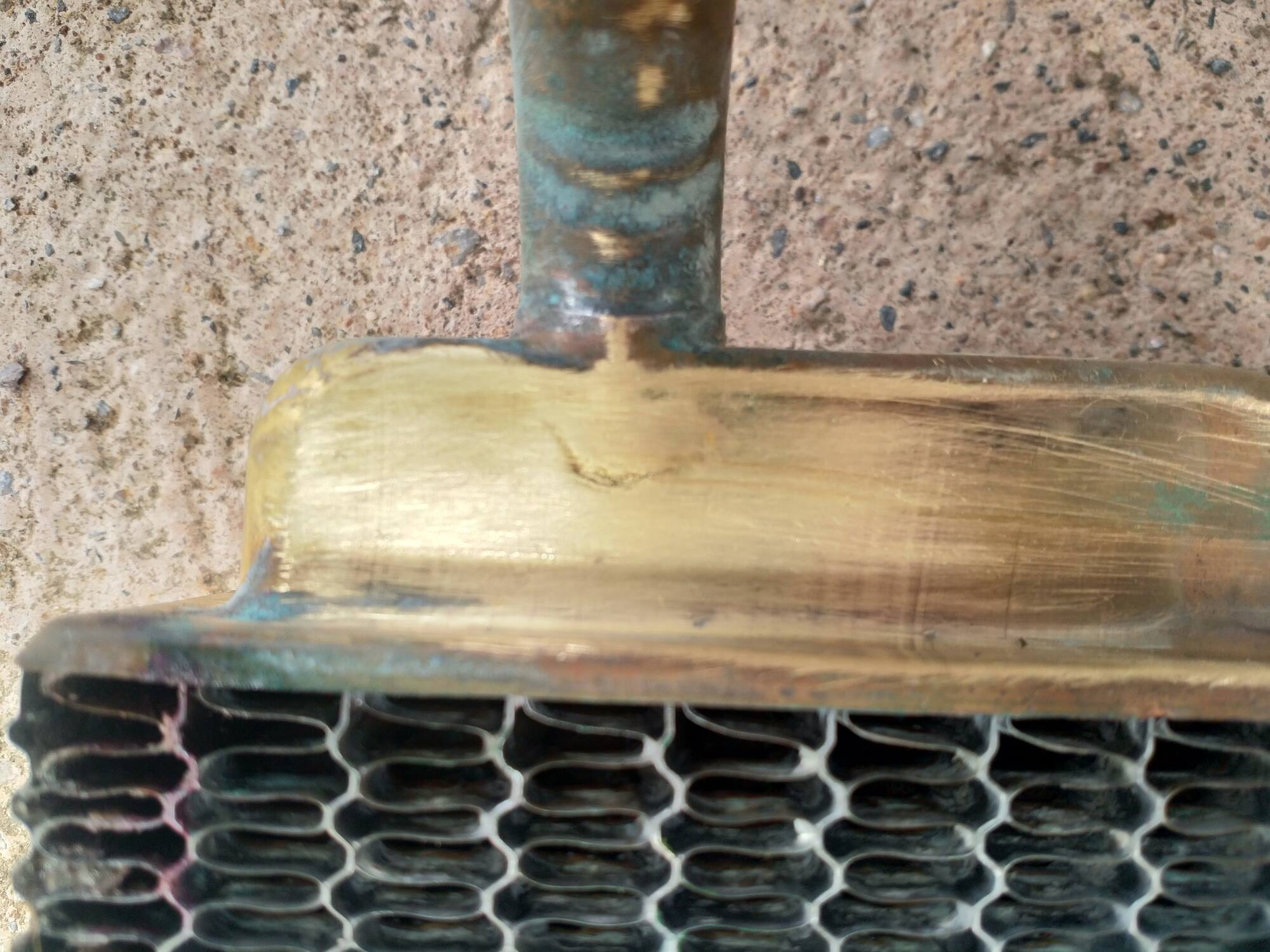

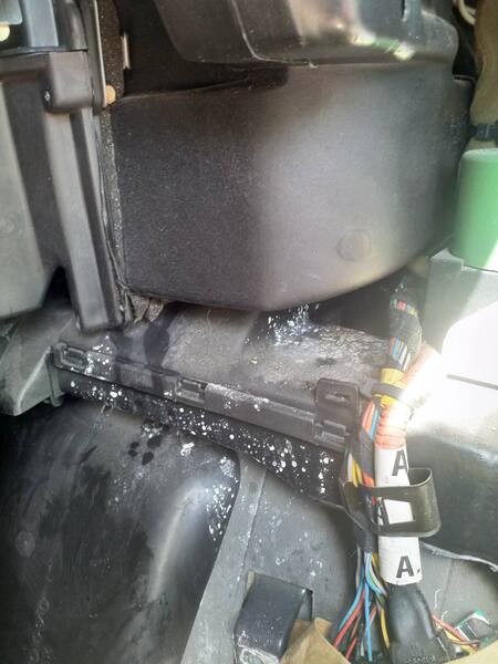

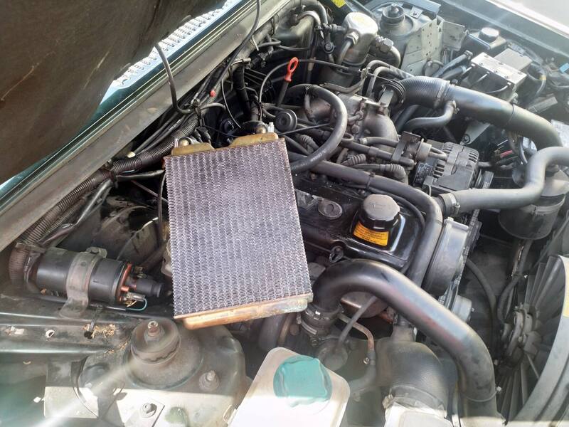

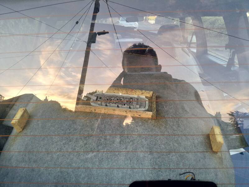

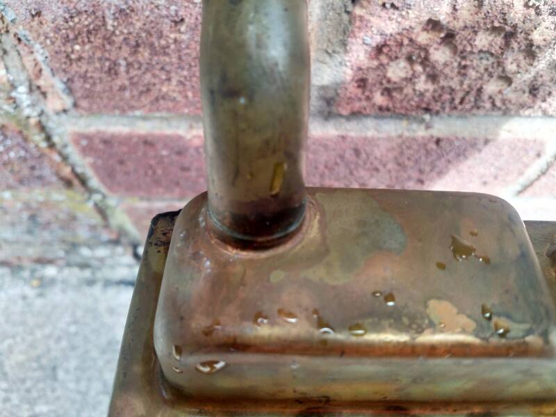

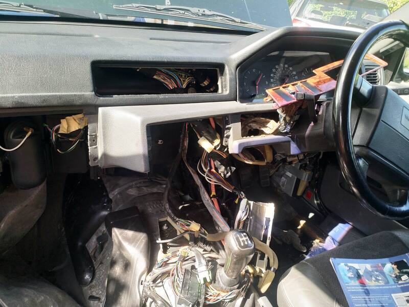

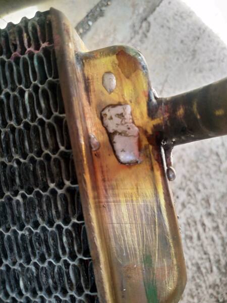

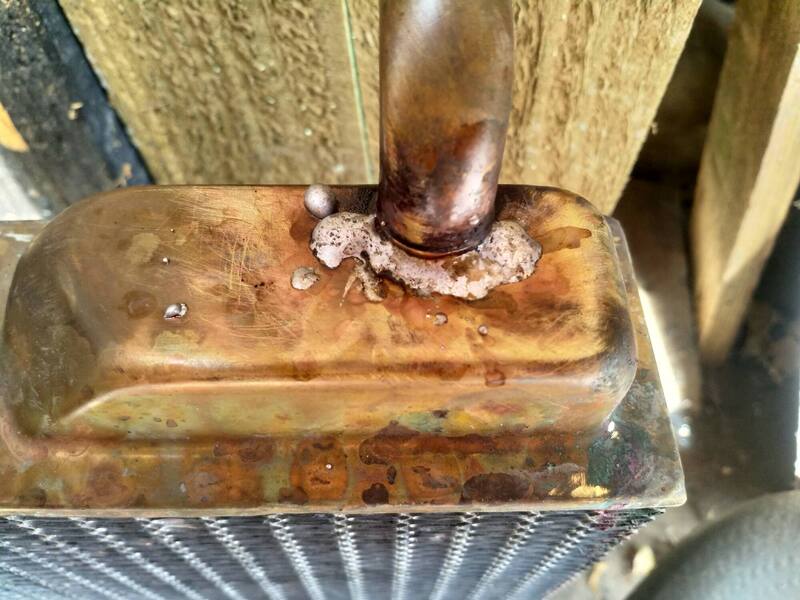

philibusmo Posted June 22, 2020 Author Posted June 22, 2020 This morning the heater matrix came out of the heater box. It's a tight shit fight to remove with 5.5mm screws in the most inaccessible places possible, but with enough perseverance it was freed. With a little cleaning off of the old dried coolant I found two cracks in the tank bear the inlet to the matrix, one around the pipe and one in the body of the tank. A very thorough "pressure test" was conducted by squashing a hose pipe onto the outlet, setting it going and sticking my thumb over the inlet. Water shot out of both of the cracks as well as around my thumb, drenching me, but otherwise it seemed to be watertight. With that, out came the blow torch and the solder. Five minutes later. It looked like this: My dodgy pressure test was employed again, and it was deemed a success, but to make sure I slapped it onto its hoses but languishing in the engine bay, topped up the system and ran it up to temperature until the fan kicked in. Still water tight, top job. It's all been reassembled now, other than the radio which is in need of a code which I don't have. I've just run it up to temperature again and the air blasting out of the vents is nice and hot, and the footwell is still dry so I think it might be a success. I'll flush the water through tomorrow and put proper antifreeze in it assuming the footwell doesn't have a puddle tomorrow morning. Of course that is too neat an ending where everything is fixed and we all live happily ever after. Despite only disconnecting the radio, fag lighter and heated seat switches, the air bag light has now decided to stay on, so I have no idea what I've disturbed and as this is a late OBD2 car, I think I need a copy of Volvo Vida to find out the code or reset the light, which of course I don't have. phil_lihp, Burnside, bunglebus and 9 others 12
danthecapriman Posted June 22, 2020 Posted June 22, 2020 Nice job on the brick’s heater matrix, they’re a bitch aren’t they! It’s a nice car though.
Mr_Bo11ox Posted June 22, 2020 Posted June 22, 2020 Nice work man, thats an impressive effort at a proper repair for £0 outlay which is my favourite scenario. I took the aircon controls out of my S80 which made the airbag light come on and flagged up half a dozen nonsense fault codes. I did read a load of warnings about it on the Volvo forum but I thought it sounded like bollocks so I ignored them. Luckily I had the knockoff delphi diagnostic thingy which put the light out again.
phil_lihp Posted June 22, 2020 Posted June 22, 2020 That is some top quality work. Likely to be a better fix than a cheapo ebay replacement too.

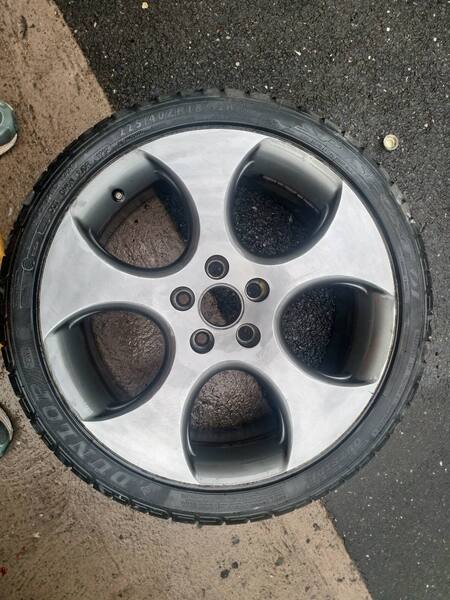

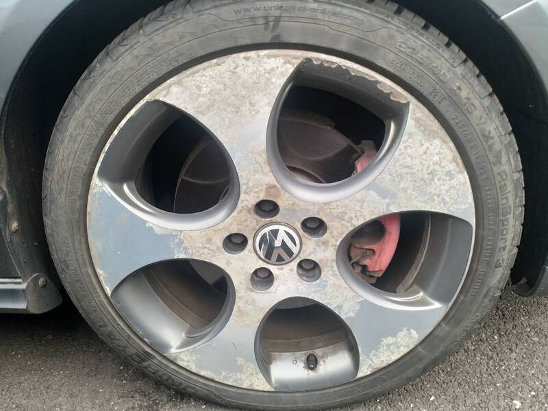

philibusmo Posted July 14, 2020 Author Posted July 14, 2020 Bit of an update, the Golfs wheels have been refurbed and now it looks much snazzier if you don't look at them too hard and see that my efforts at 'diamond cutting' them look more like they have been attacked with a very sharp cheese grater. Oh well, my work mate who knows fuck all about cars commented that they look much better completely unprompted when I turned up at work on Monday, so they must be better than before. I've also fixed the cruise control by changing the indicator stalk - which also houses all the switches for the cruise control. This involved taking the air bag off, and the steering wheel and then the cruise control/airbag control module and the steering angle sensor and finally the stalk itself. There was a couple of hidden clips which I had to look up to find, one of which required a very thing and long alan key to remove which a faff and overall it was a bit of a rush job as I was doing it mostly in between the three qualifying sessions of the formula 1 on Saturday. Didn't George Russel do well? Anyway, it works now which has made my commute slightly more relaxing. What isn't relaxing is that the Mini Cooper S (R53) has started having an alarming rattle which sounds like its coming from the timing chain side of the engine. The optimistic side of me says that it is just the serpentine belt tensioner as they apparently do die regularly and while we changed the belt, we didn't do the tensioner or idler when we were servicing the supercharger. I've sorted out the purchase of a backup car next Monday, in case it is the timing chain or its tensioner or guides that is causing the racket and hopefully I'll get to have a play with it and find out at the weekend. The oil and filter was changed about 1000 miles ago and still looks at the right level and clean so I don't see why it would be the timing chain causing issues as they're not known for it, unlike later models. DVee8 1

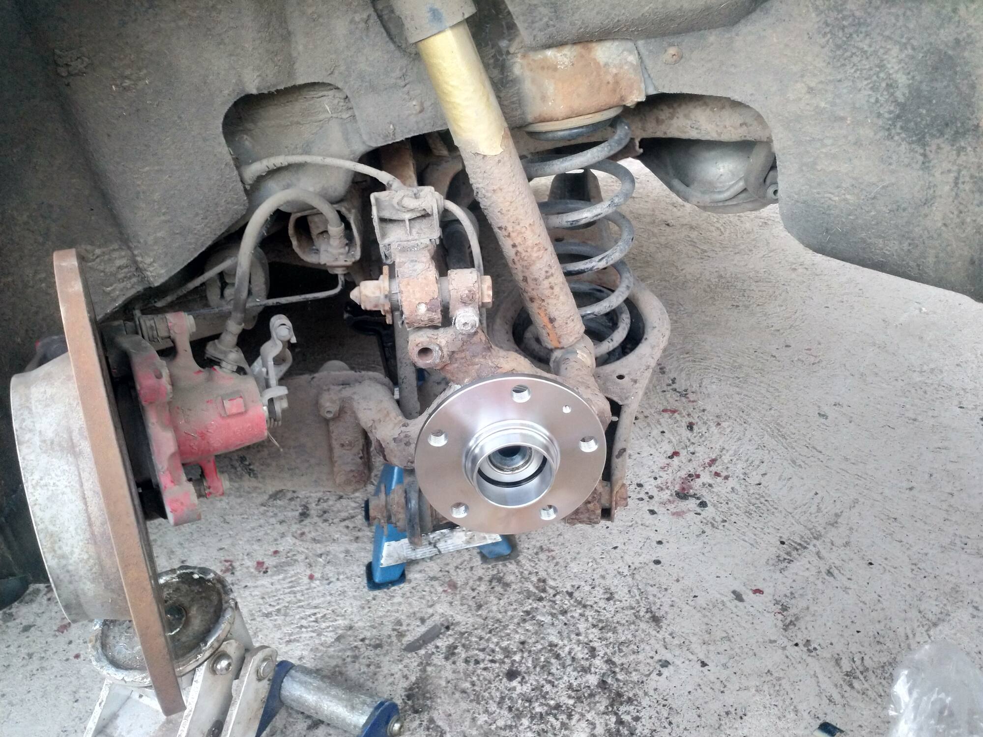

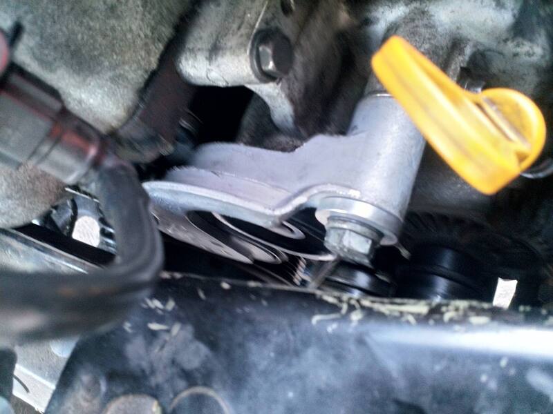

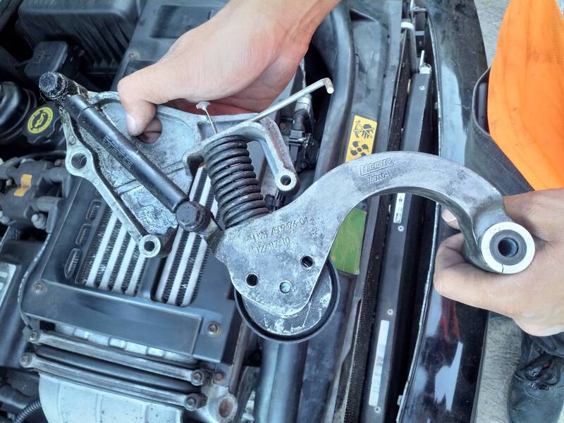

philibusmo Posted July 22, 2020 Author Posted July 22, 2020 Mini is fixed. It was the aux belt tensioner, which was a bit of a fiddle to remove. The other half set to pulling the front clip into the service position to make it a bit easier to remove. A bit of juggling the engine and struggling with a crap eBay detensioning tool which didn't work and it was off. The new one turned up today, bolted in place and it's back to being fairly quiet again. It seems like a stupidly over complicated piece of design to me but there we go. While he was taking it apart, I set to the whipping off the Golfs rear bumper and changing the parking sensor. Easy job really as it simply unclipped and a new one clipped in its place and the bumper was not more than a few torx screws, with only a couple of awkward ones in the rear arches. Apart from the air con needing a possible regas, this is now basically a fully functioning car which means I'm mostly bored of it and it might be for sale soon. Additionally there has been a new arrival in the form of an Alfa Romeo 159 2.4 JTDM Sportwagon. OMFG it's a modern! Ban him! Move it to the moderns section! Bitch about him on that other forum! But seriously, don't. More hot Fiesta action will be along soon, plus this isn't exactly a factory fresh example. We're hoping it's big enough in the back to sleep in so we can go on a couple of exceedingly cheap holidays around the country this summer, but in Italian style. I think the rear bumper is a slightly different shade to the rest of it and there is an annoying rust blister on the leading edge of the bonnet, but on the plus side it pulls well, is very comfy and the air con works very nicely. The interior isn't a bad place to be either, although it could do with a clean. A few pieces of random plastic already found floating around the footwells. It's getting a new thermostat and a service this weekend, and hopefully we'll fit because if not then it maybe up for sale again a little sooner than planned. Although it is still a good looking and useful sized car which is easily managing 40+ mpg on a speedy motorway run. Anyway, back to the old stuff shortly. HillmanImp, DVee8, Burnside and 2 others 5
