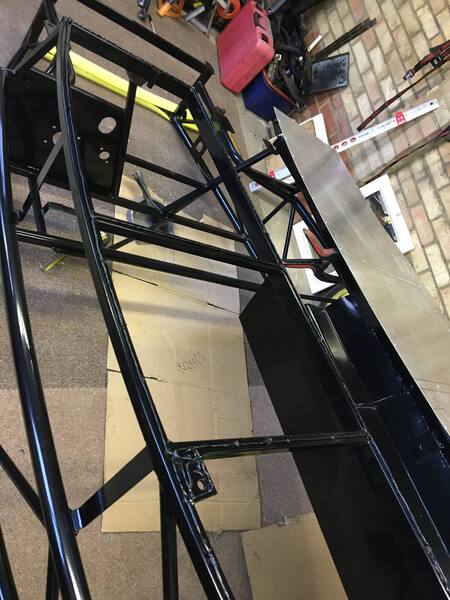

job one : break out @paulplom's blowtorch and despatch the knackered bush off this

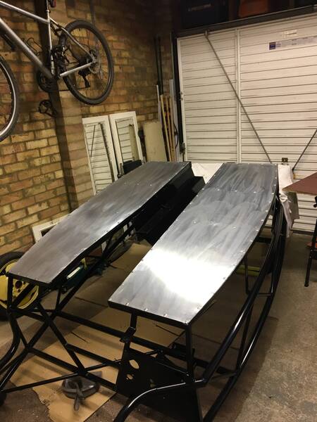

hit it hard with the wire wheel and a couple of coats of magic paint - noice :)
then get busy with the black and decker

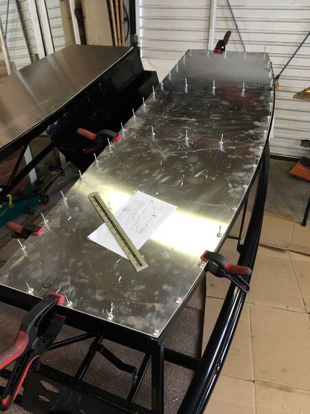

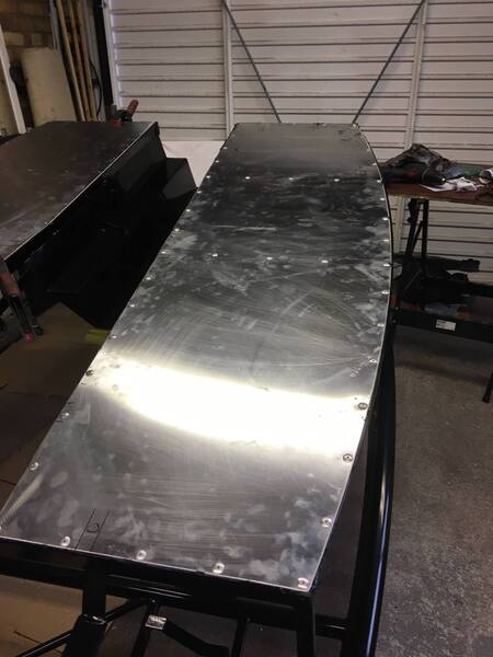

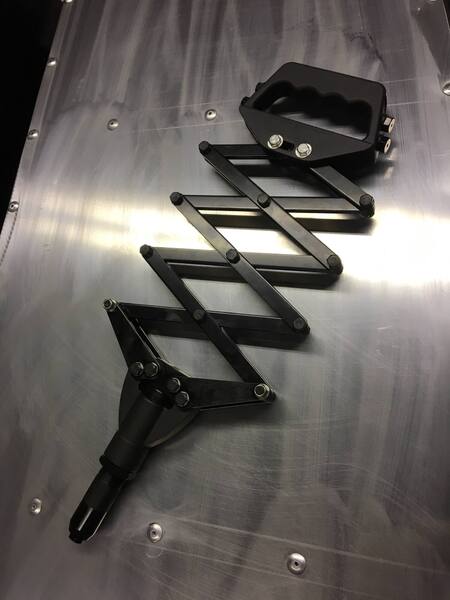

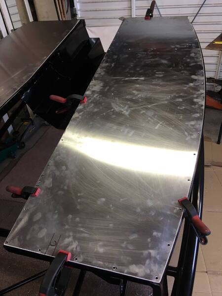

90 x 5mm holes were drilled
and rivits were inserted thus
and then took out again 'cos I'd forgotten I need to run a bead of sticky black gunk first
rivits were reinserted
and today's tip top top tip tool was employed in a rivit-tastic manner
and the floor is done
I'd been a tad generous with the tigerseal so a healthy amount of thinners was needed to clean up but look at that - I've actually made a start - should be on the road next week :)

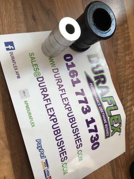

my replacement pollybush arrived this afternoon (which I haven't paid for yet, the guy said he would email me an invoice but must have forgotten)

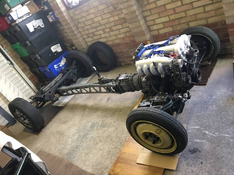

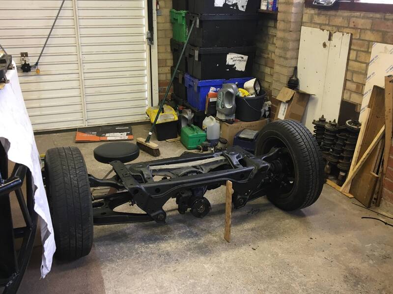

tools were assembled (the giant washers I used last time are now back in use as a vital part of the front subframe, i improvised with hub nuts and jam jar lids)
which enabled me to rebuild the rear subframe again
attached the ppf (power plant frame)
and reunited the front and rear sections
as soon as my brake and fuel lines arrive, I can join the two halves :)

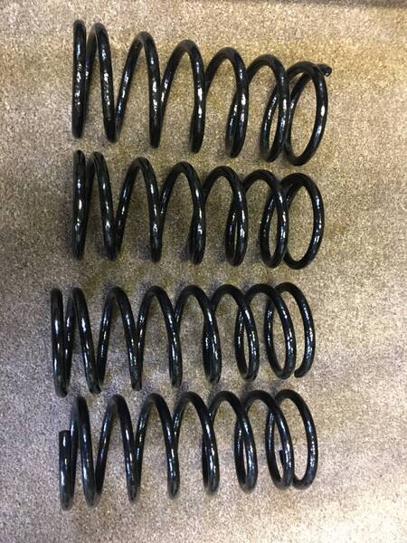

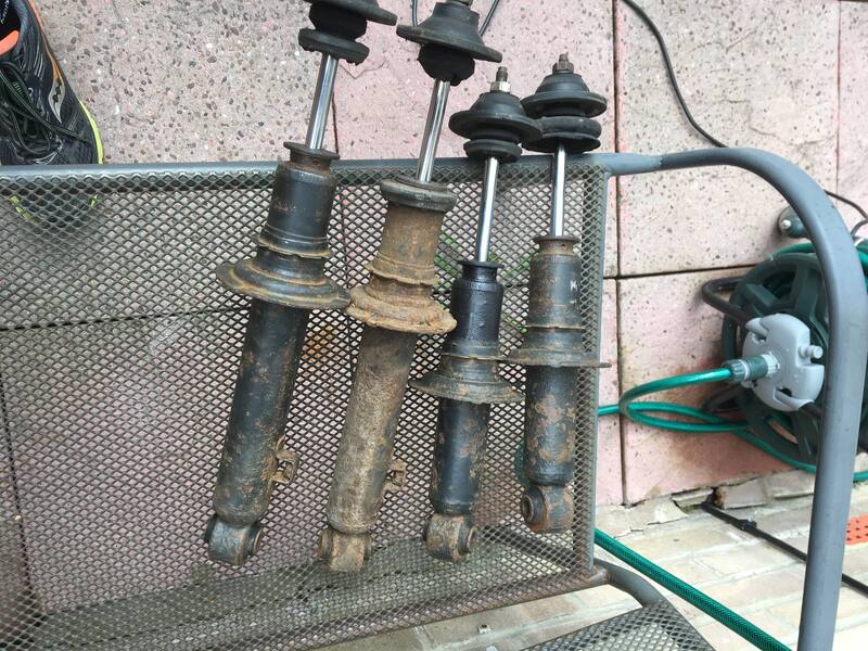

The only progress over the weekend was to strip the suspension - these are the kyb shocks and eibach lowering springs I was using on the mx5, going to need a lot of work to make presentable :( worth it though, the car did drive very well with this combo

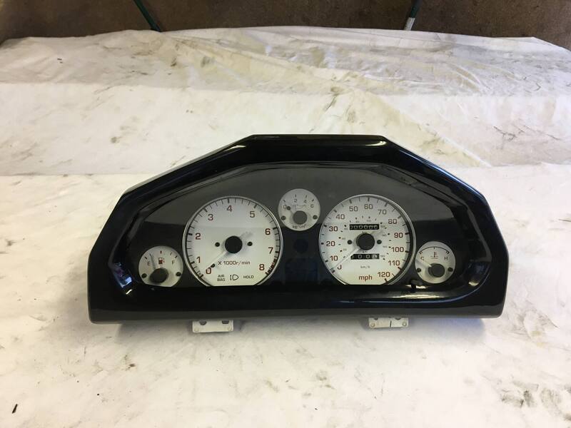

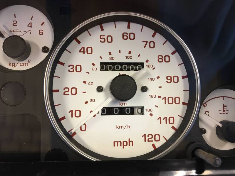

but i dug out the dashboard from storage and gave it a clean and trial fit in the fibreglass housing
you will note that I have "done a Quentin"
which was suprisingly easy to do :)
i wasn't keen on the the 'red on white' dials and had thought about finding a set of 'white on black' originals but they don't look bad when fitted in the pod, they can stay for now, it's not like they are going to be in use any time soon

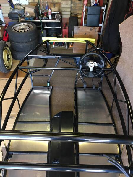

When I was looking for the dashboard cluster, I happened across the pedals so thought they might like a trial fit too
yes, the car is still upside down :)

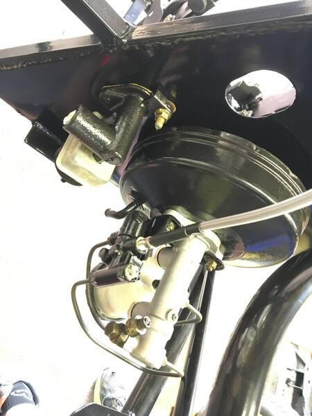

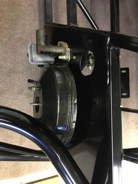

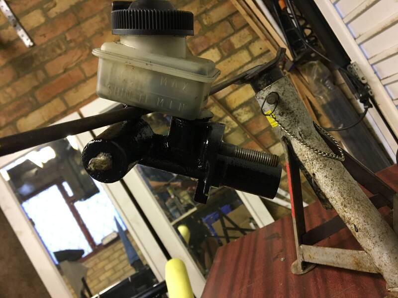

that clutch cylinder is rather letting the side down

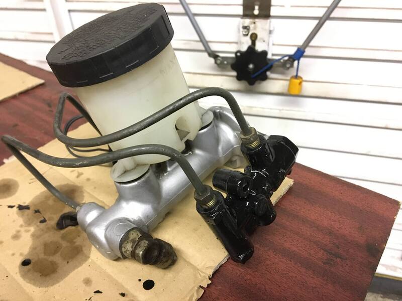

might as well do the brake bias valve while I'm at it

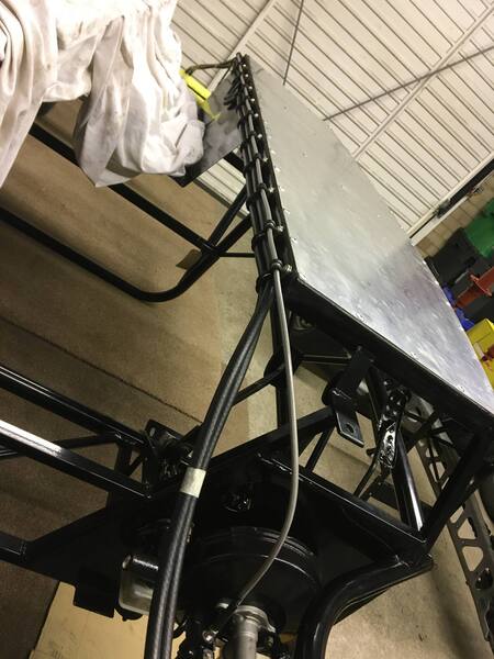

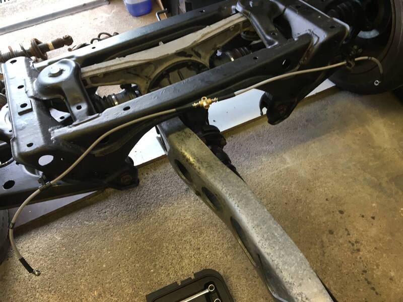

my brake lines finally arrived yesterday :)
rather than fannying about with copper lines and flairs, I've gone for braided flexis all the way from master cylinder to callipers (master cylinders scrubbed up well)
i'll fix these once the chassis is assembled (and I find some callipers)

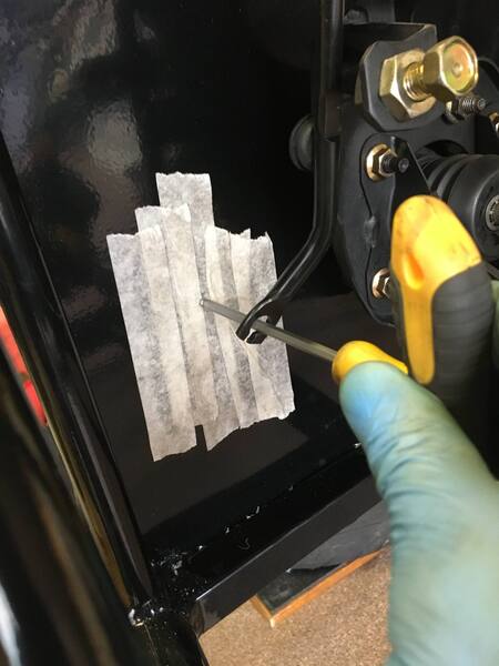

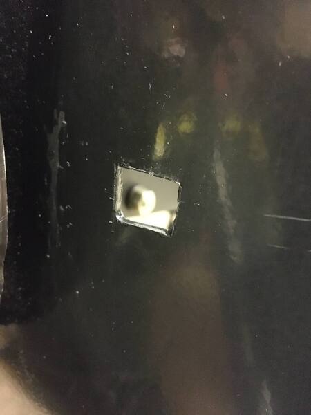

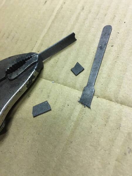

and with a bit of spare time on my hands, I had a go at making the hole for the accelerator cable - how hard can it be to drill a hole and file it square ?
that little sod took over an hour :(
perfect* fit
my little file has seen better days, maybe I should invest in a dremmel type thing :(

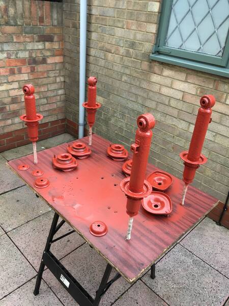

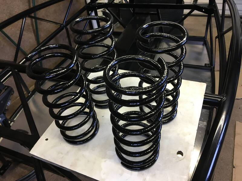

I decided that I will use the shocks and springs that came off the mx5 on the exo, at least until it's built, then I may treat it to some shiny new coilovers.
but the mx5 shocks are minging :(
so it's time to get busy with the wire wheel again
three down, one to go
set up a painting table and fling on a couple of coats of lidls finest primer
at which point it started raining and I had to carry that lot back into the garage without covering myself in orange gunk

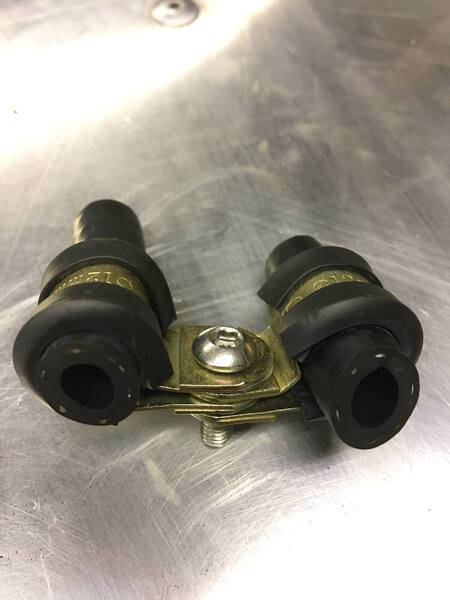

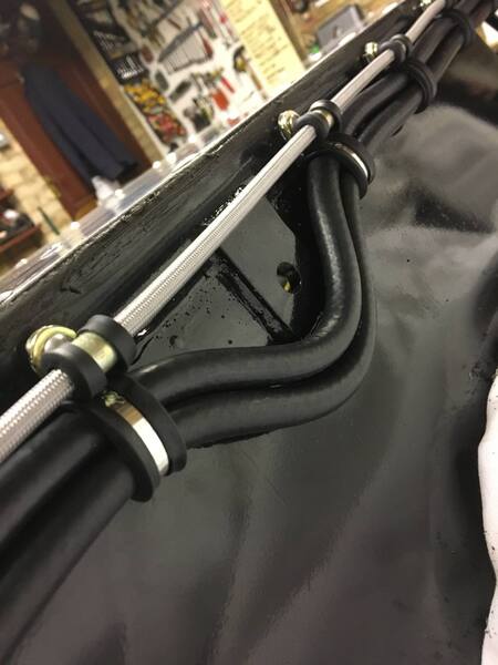

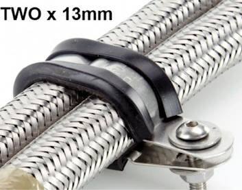

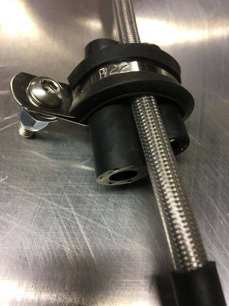

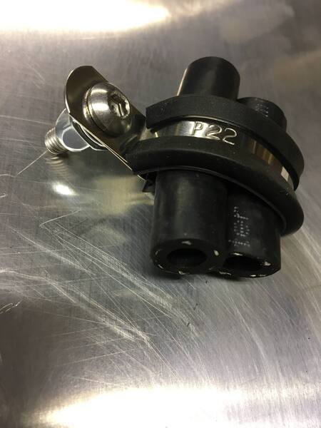

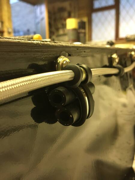

last week, I ordered up a whole load of P clips to fit the fuel lines, there needs to be a send and return line for the mk1 engine which proved a bit awkward with the brake line already taking up vital space along the transmission tunnel
doesn't leave much room for this arrangement
back to the drawing board then :(
but then I stumbled across these twin clips
0018727_stainless-steel-p-clips-twin-13mm-pack-of-5.jpeg.9d39dc718b26a31d1db14fb679b03c84.jpeg
stuck in an order on Sunday and they arrived this afternoon
hmm, I wonder........
nah, mebbes not :)
but this seems to work

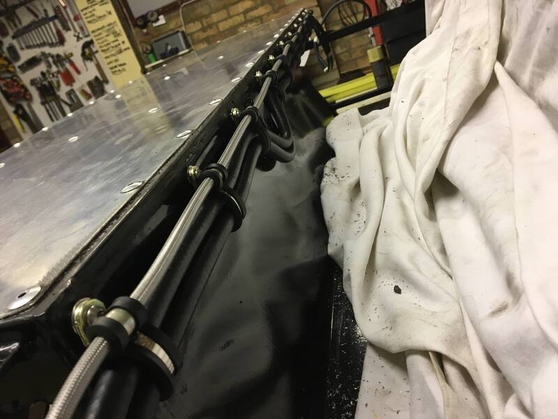

minor mishap when I snapped the 'ball' end off my Allen key but a tickle with the grinder sorted that out
so at close of play, we have both brake and fuel lines fitted :)
what's that kinky bit in the middle all about ?
bloody seatbelt mounting point - bah !

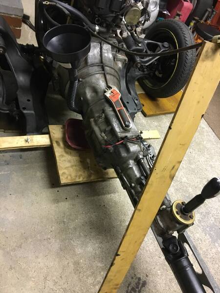

last job for the day was to rig up a shonky arrangement to fill the gearbox oil - didn't spill a drop !

After a successful family day out in Durham, I managed to squeeze in a quick coat of paint on those scabby shocks
manky, scabby shocks are now shiney, scabby shocks

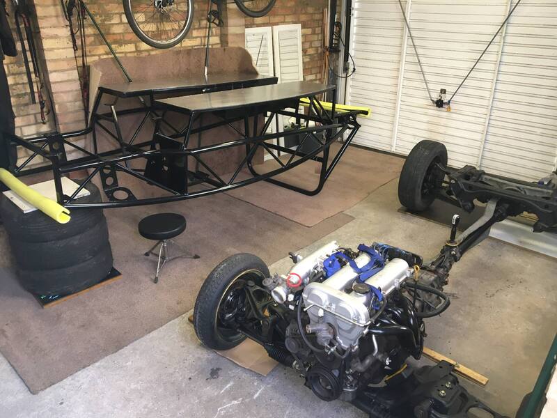

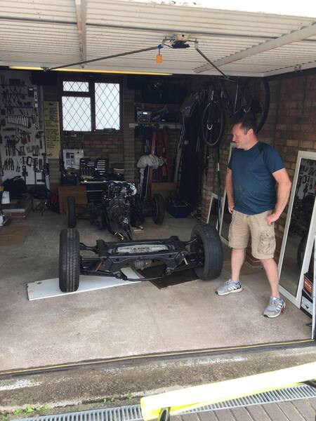

@paulplom came round for a visit and we flipped the chassis over :)
Steering column will be lower than this

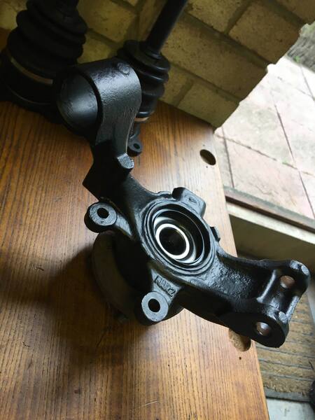

Remember these manky old bastards ?
well, a whizz over with the wire wheel was never going to cut it :(
but it turns out that my neighbour along the street (who also owns an mx5 (mk2 drifto spec)) works as a powder coater and sneaked these in with a bigger job at work ( mega thanks, Liam )
so shiney, very boing !
Which means today I can rebuild the struts and we are one step closer to a rolling chassis :)

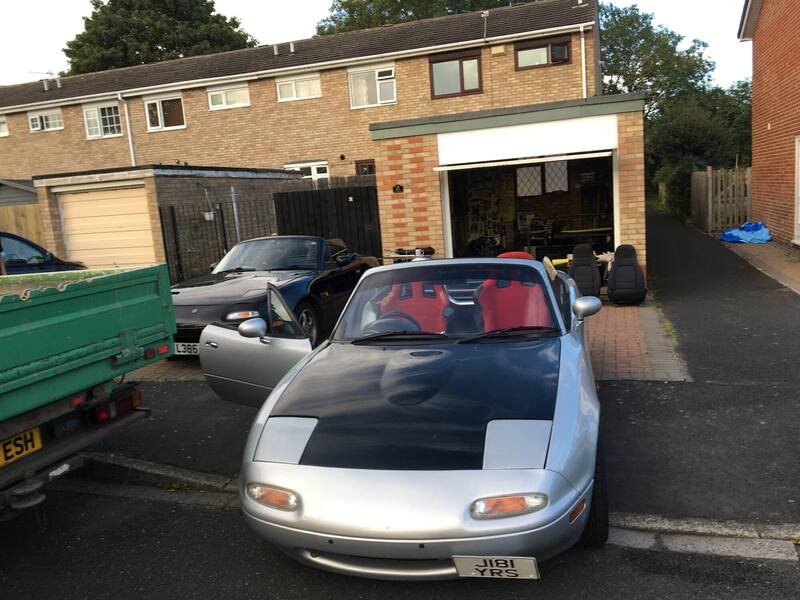

Another visitor this evening

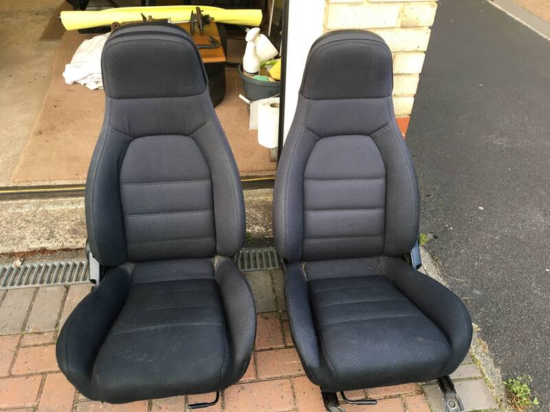

Connor in his mk1 collecting bucket seats (too low to make it up the kerb onto the drive)
he left his old mk1 seats behind as part of the deal
which will go in my mk1 and the mk2 seats I don’t like can go to a new owner
