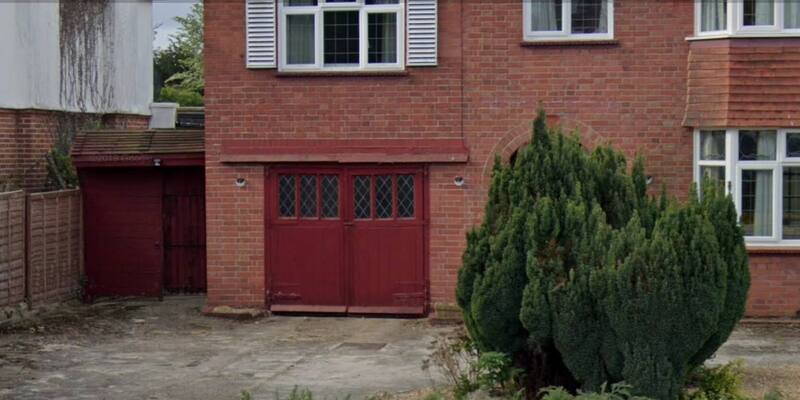

RobT Posted June 12, 2020 Author Posted June 12, 2020 On 12/06/2020 at 07:58, BeEP said: Nice to see the tip of your speedo ribbon is still red. Most go orange/yellow over time as it's the only bit permanently exposed to the light; I suspect your car has spent most of its life safely cocooned in a dark garage! Expand Ah that's interesting, I never thought of that. Like this one. As for the garage, it lived in here from 1979 to January this year, in a leafy suburb of West London. It's doing a typical A-series and dumping a noticeable amount of oil on my garage floor, so the giffer must have garaged it literally all of the time as I can't see any stains on the driveway. The weapons-grade level of stalking continues, as it lived in here from 1968 to 1979. I imagine that house was fairly new back then. Apart from the old V5 which has enabled me to do the above, there's no other history with the car unfortunately. I almost feel obliged to start anew, by recording every time I grease the knuckle joints, fill it up with pez etc! LightBulbFun, BeEP, HMC and 16 others 19
