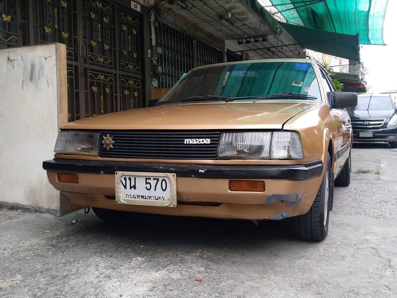

so lockdown has happened and its come to this......Mazda 626 1985
Nice to see an 'old shell' lifted on the sill edge/jack notch....
Gave this a quick wash. Can't have dirty car, can you. Even if it is chod.
I'm thinking about having few cans of paint match for touch up. For whatever reason they don't stamp the paint code on the identification plate. The rear badges have not been nicked, I removed them so I can restore the peeling paint a little bit.
Still got to clean out the inside as well, it's so dusty despite brown colour hiding everything.
It's for Department Of Provincial Administration. Which is kind of a governmental office in which it's worker are mostly old farts not doing anything much. I know it's more of a local reference but I can tell you that you would totally see this sort of car in their car park. ?

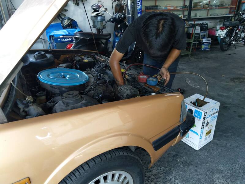

Aircon regas. It's blows cold, iceberg cold. The system's already been converted to r134a. Wait and see how long it gonna last.

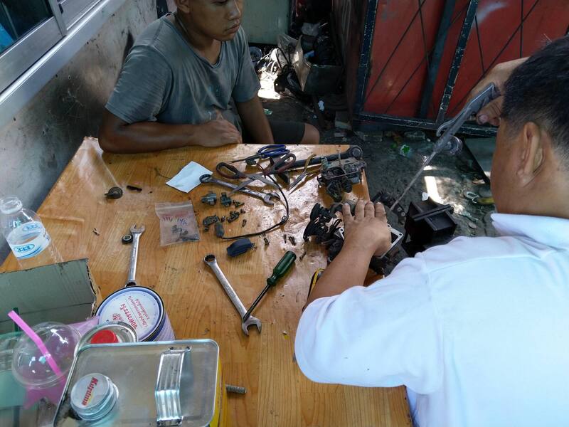

The bastard thing died on me yesterday. First FTP.
I was driving down the motorway going to Department of Transport to get logbook update. It suddenly loses power going slowly, or going quickly for that matter. I nursed it to a safe location and called motorway service breakdown mechanic. The ignition system seems alright, as I've pretty much changed everything in that regard. It only dies when it's really hot. They found that the carb is dirty and fuel filter is old. Seems fuel is not getting in.
I nursed the car off the motorway with much difficulty. 10km where the car would run only for few hundred meters at time before losing all power. I got off the motorway and removed the fuel filter making the hose going through directly. It still wouldn't go properly although it was driving better. I nursed the car a few km more and decided maybe I should get it towed. But then a shabby looking garage was spotted and so I let them diagnose the car.
I have to say the garage might looks incredibly shabby and outdated, proper old school no health and safety stuff. But the carb was cleaned and reassembled in less than an hour . It was also found that the electric fuel pump which some mechanic* in the past mounted to the engine cylinder head and receiving all the heat from it was dying. New used fuel pump was sourced, along with new fuel filter and fuel hoses. It runs great now but the throttle cable seems a bit loose so I'll have to go back again.
Also today I vacuum the interior which makes all the difference. Now the car runs better than it has ever been. Hopefully the running issue won't come back. The air-con is staying cold also I guess that is a win.

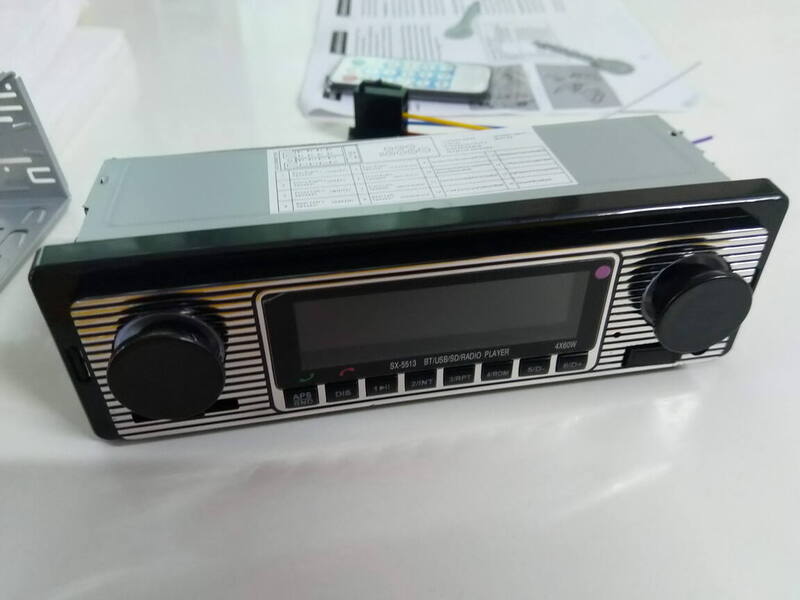

This radio is period correct and all, but the on/off button is missing and the cassette doesn't work.
94393178_2907754442639437_2525887107344367616_o.thumb.jpg.a191ab20072413c6206f07344efc69d5.jpg
So, I went on the internet and ordered a cheap new stereo that doesn't look completely shit last week and it arrived today.
Mad colour matching and wire soldering and boom now the car has SD Card/USB/Bluetooth/3.5mm Aux support.
It might not be completely period correct but it works great and looks kind of correct. It even sounds a bit what I'd imagine the 1980's sounds like.
