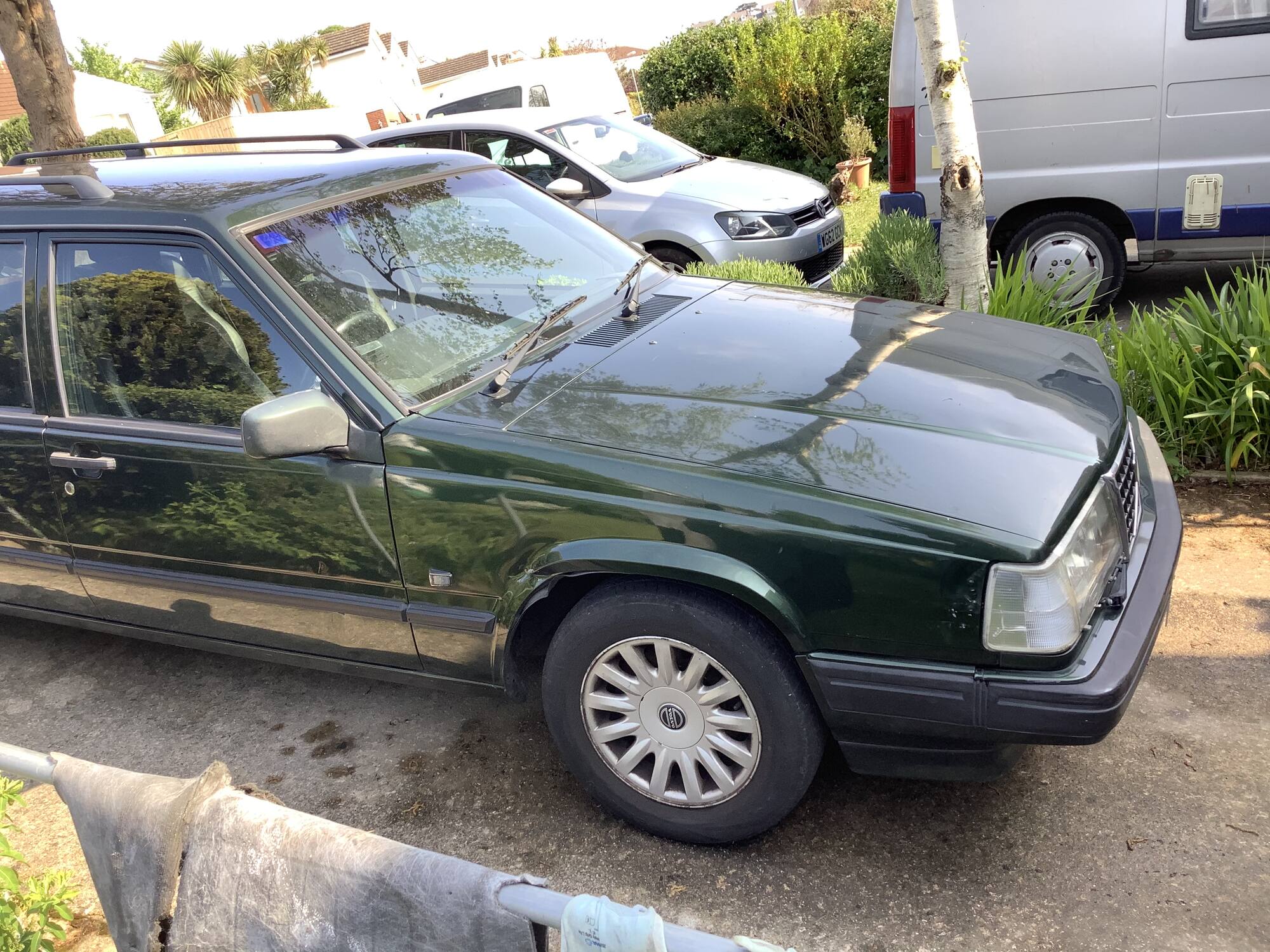

Anyway, some (pre-cleaning) pics.
During 3 hours of hoovering: Dog, sand, pebbles, rubble, etc.
Not sure what the bit dangling off the side of the drivers seat is.
Dicky seats appear unused. Spare wheel well beneath has some surface rust and lost paint but everything seems solid.
These pictures struggle to illustrate how much cleaner it is after 3 hours of hot Henry action. Still filthy, mind. Might have to dig out the wet carpet cleaner. Seats have come up alright though, and the really sticky stuff on the boot carpet (Gripfill?) picks off ok with a little effort... just all very time consuming.
