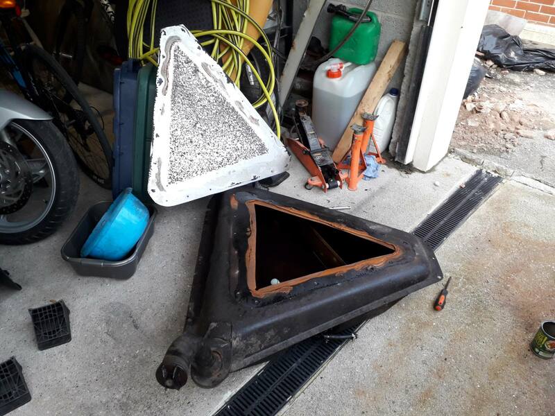

I've been busy this weekend and as a result the Princess is looking a bit sorry for itself at present.  A rather large item has been removed and is now at the painters.

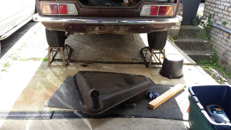

I also dropped the fuel tank out ready to be cleaned out.  I'll see about fixing the fuel sender and it'll then go to the same guy for a repair on the small leak that's appeared.
I'm just a bit tempted to paint it green so it looks like a Quality Street triangle.
He reckons he can fix this quite easily.  Its handy that the tank has a removable lid, not so handy that it turned out to be full but I now have a large quantity of petrol which can be distributed around the fleet once its settled in the container.

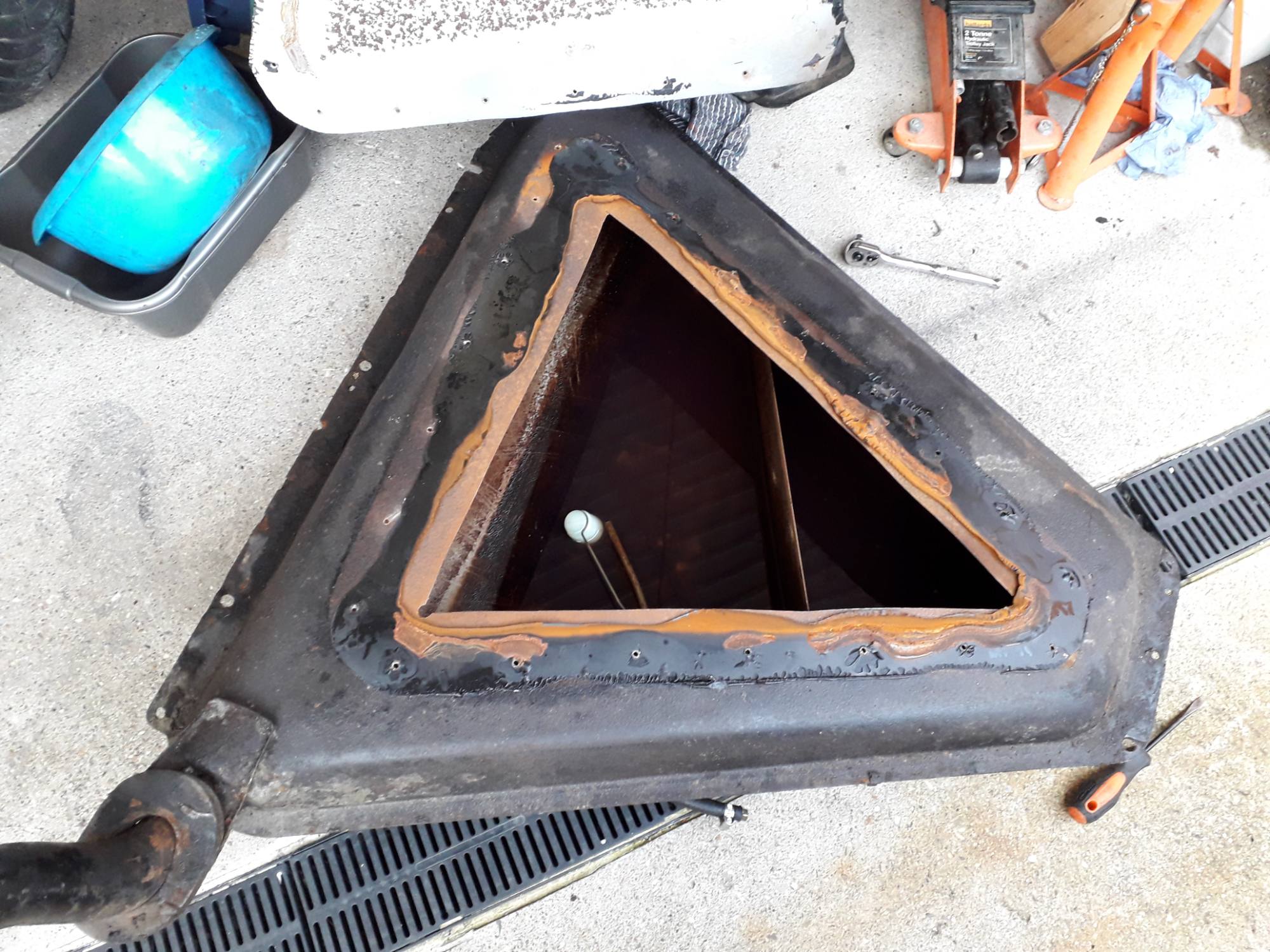

You might be right but the car is so original in every other respect, had the same owner from 1977 until 2019, was parked up untouched from 1992 and there's not much sign that the tank has ever been out so I'm inclined to think this might be an original feature!
Although now I look at that photo again, it does look a bit home-made, doesn't it?
Assuming there's a large opening underneath it, it's going to make cleaning the tank out a lot easier at any rate!
Or imagine if you took it off and it was just bolted on straight over the original top surface of the tank.
Well now I'm curious because it's exactly the right shape for a road sign!
To be perfectly honest it might have come out of the factory like that anyway, maybe they grabbed a tank off the production line, used it during a walkout when they couldn't find an oil drum and then bashed an old road sign over it before it was fitted to the next car on the line.
We'll find out at the weekend!

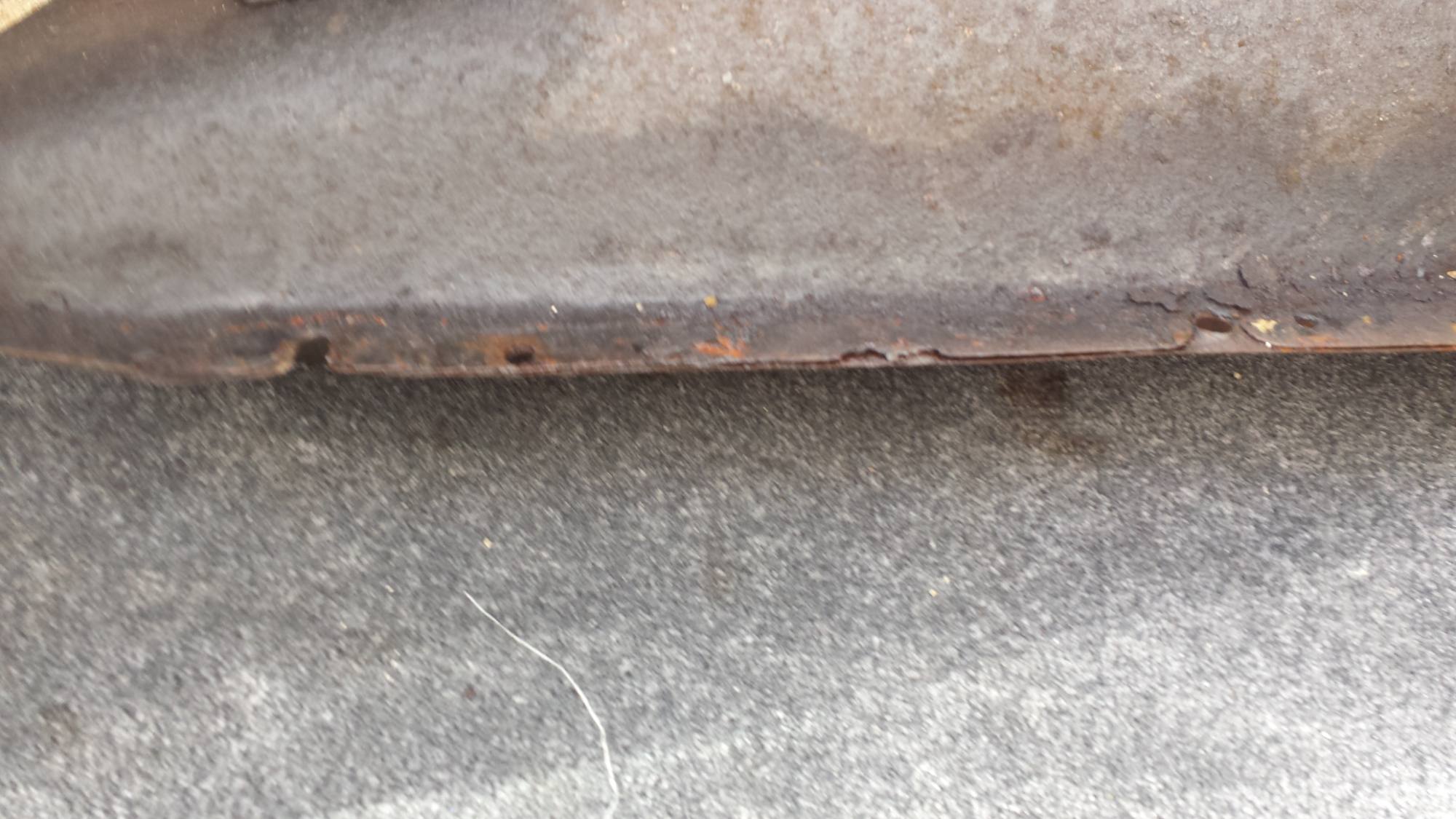

That tank panel is a new one on me too.  These tanks do rot out on the underside and the flange when they're left stood for a while but usually the tops stay pretty good because they're well protected from the elements so I don't know why someone would do that.  I wonder if it was something to do with the tow bar installation, maybe it got damaged in the past and this was the repair?  No idea, very odd.  Definitely do paint it metallic green before refitting it now you've said that.

I think we can say for sure this isn't factory but I can't begin to work out why on earth this has been done.

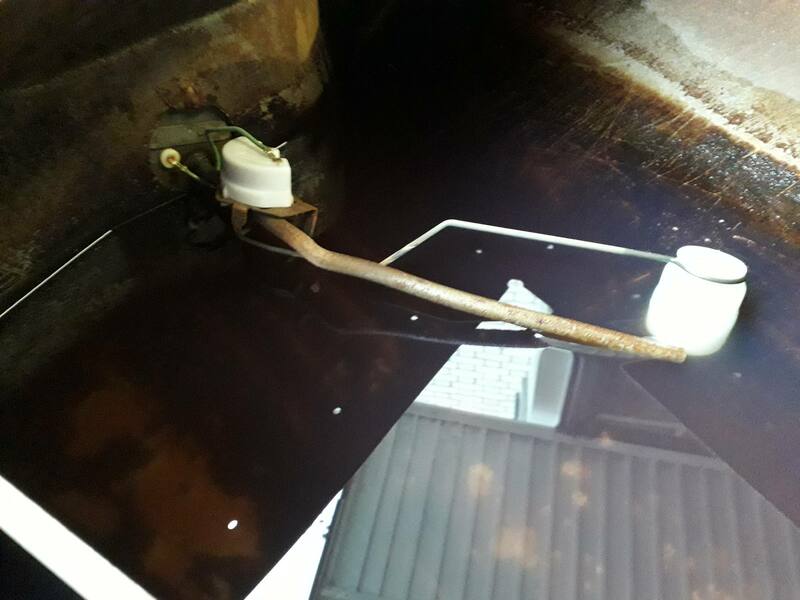

Any guesses as to why the fuel gauge doesn't work?
Why didn't they put that triangular 'door' on the bottom of the tank? Would have been much easier to access then. Honestly! F***ing idiots man.
They didn't just cut a massive hole to get to the pump, surely?  Since the sender isn't even in the right way around it makes even less sense to cut a massive hole in the top.  I'm so confused right now, this is so confusing.
There is no pump, it's in the engine bay.  The whole thing makes zero sense.  But they did manage to bend the pickup pipe around the fuel float so it's stuck down.
I did manage to pump all the dregs out at least so next job is to clean it up and pull out the sender before it goes for a small repair on the seam.
I see what you mean, the sender is in sideways!
I'm moderately certain all Princesses had the pump (SD1 pump is the same) in the tank.  If that's the case it looks like the brackets that would hold it to the pick up tube on yours are gone too.  If not, you'd have a mechanical pump fixed to the engine somewhere and, since it's a B series, you should be able to retrofit one anyway which is generally more reliable than any sort of clacky electric pump screwed into the engine bay.
It has a mechanical pump on the engine, it just doesn't work at the moment hence the electric one mounted on the inner wing.
