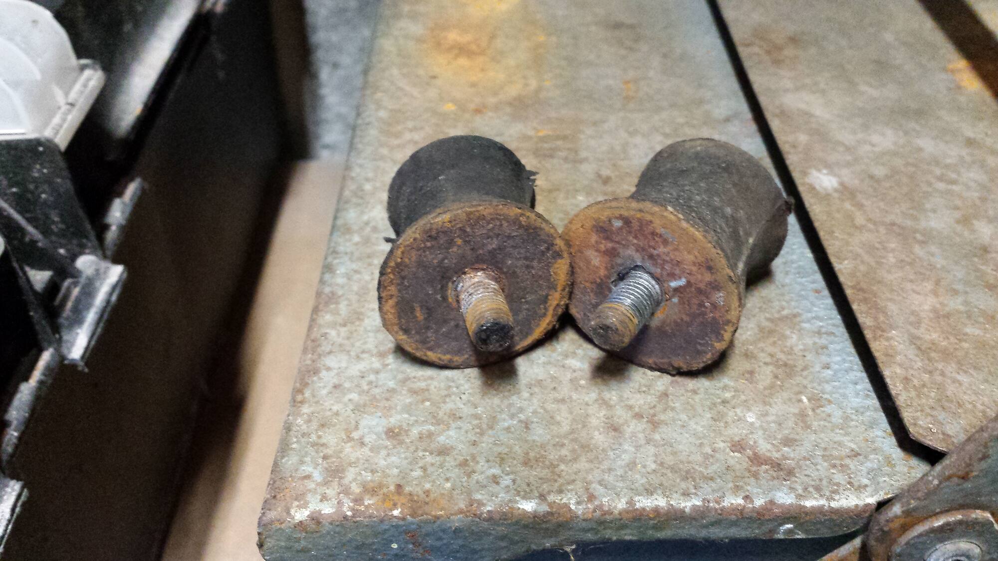

vulgalour Posted August 18, 2020 Posted August 18, 2020 Those Mini ones are what you want. The Princess uses the same gear selector unit as the Mini, just with longer selector rods. plasticvandan, eddyramrod and phil_lihp 3

SiC Posted August 18, 2020 Posted August 18, 2020 There are holes to the side of them. Is it a captive nut or is the nut accessible on the other side? Hopefully accessible and then shouldn't be too bad a job! ? phil_lihp 1

Angrydicky Posted August 19, 2020 Posted August 19, 2020 If they do screw into captive nuts, the remains should be shiftable with heat and molegrips. If there's not enough sticking out to get onto them, I'd try rotating them with a hammer and chisel, and if that fails, cut a slot in the bottom of the slot with a hacksaw (or dremel) then use a big screwdriver. But heat will be your friend if they are captives. Hopefully there's access from the top to the nuts. phil_lihp 1
phil_lihp Posted August 19, 2020 Author Posted August 19, 2020 I don't think they're captive, the nuts on top are accessible(ish) so I have some hope this won't be too difficult to fix. What could possibly go wrong? On the plus side, the car's at least high enough off the ground to make this easier now! I have ramps as well though. somewhatfoolish 1
2flags Posted August 20, 2020 Posted August 20, 2020 On 8/19/2020 at 1:20 PM, phil_lihp said: What could possibly go wrong? You are about to find out!!!! Get the swear box out and expect to be able to fund next years holiday! Hopefully the nuts will release, if they do it will be easy. If not...…..
phil_lihp Posted August 21, 2020 Author Posted August 21, 2020 Well I got the bobbins off the selector easily enough last night but the top bits in the frame just spin with the bolt so I will have to get a bit more inventive over the weekend with a Dremel. Jim Bell 1
Mr_Bo11ox Posted August 21, 2020 Posted August 21, 2020 you might be able to clamp em in position with a really tight molegrip and undo the nuts that way with a bit of luck phil_lihp 1
phil_lihp Posted August 21, 2020 Author Posted August 21, 2020 I did wonder about that - access is not the best with the wheels on the ground (although massively better than it was!) so it will go up on ramps at the weekend for another go. I tried drilling the rivet but mostly just made a lot of noise. I have to say I'm impressed with the thick coating of underseal on this car - it's a good few mm in places, still sticky and oily after several decades and has not dried to a hard crust which I gather is when it will end up promoting corrosion rather than preventing it. It is making this job particularly unpleasant as I got quite a lot of it on me but it's clearly doing its job, the underside is pretty much perfect until you get to the corners of wheelarches/sills where a bit of rot has set in. I will get my mechanic to spray it with oil next time it goes to him for something (probably the MOT next month) as he's done that on a couple of my cars and it does seem to work.
phil_lihp Posted August 23, 2020 Author Posted August 23, 2020 Well, after several hours lying under the car getting covered in dirt and underseal I had to admit defeat on getting the broken bobbin stubs off the car. I tried every conceivable method of clamping them to stop them rotating with the nuts on top, I tried chiselling them off, I tried drilling them but all I got was a sore neck from contorting myself under the car for 3 hours - it was up on ramps but it was still very cramped. The main sections came off the gear selector easily enough though, so I thought "what would BL do?" and the solution seemed obvious. Perfect. It actually works fine but the car can go over to my mechanic who can grind the stubs off and fit the new ones which, yes, look to be spot-on replacements. He can also have a crack at getting the exhaust joint to seal as I can't quite get it 100% and am bored of lying under cars for now. Today I attacked the front seats with some APC and a steam cleaner - quite pleased with the results, it took most of the grey dirt off them and let the yellow nylon really come into its own. The camera flatters them but they are a lot better, I'll probably give them another run though as rubbing them down afterwards turned a white towel brown. The fuel gauge has never worked so I earthed the tank connection and confirmed the gauge and wiring is fine, as it slowly rose to the Full mark for the first time in 30 years. I cleaned up the connection as it was caked in underseal but still no joy so when I get around to flushing out the tank I'll have a look at the sender unit. Hopefully new ones can be obtained, I'd like to hope it's a generic BL part. Resplendent with clean seats and a bodged gear selector, this afternoon I took it on its longest trip yet, 10 miles down the road to see my parents. Verdict: mother not impressed, father moderately keen, passer-by loved it. Instead of driving straight home I decided to take a few detours and as it seemed to be getting better and better with more use, ended up doing around 50 miles with no problems whatsoever. It definitely seemed to enjoy having its legs stretched and the new suspension is a joy, it rides smoothly, irons out bumps nicely and can be hooned quite readily - body lean is quite controlled and I can say wholeheartedly that it was worth every penny to have this done. I stopped for a little photo op next to an old steam vessel called the SS Freshspring which has been tied up on Bideford Quay for the last few years gradually being restored from a rusty hulk. Seemed appropriate although it's definitely got better paint than the Princess. Perhaps it'd have been better to have parked it a couple of hundred meters further down next to the Ionia, an ex-Thames tugboat which has been tied up in the same spot for over a decade and has been deteriorating steadily ever since. brownnova, angle, Steviemillar and 29 others 32

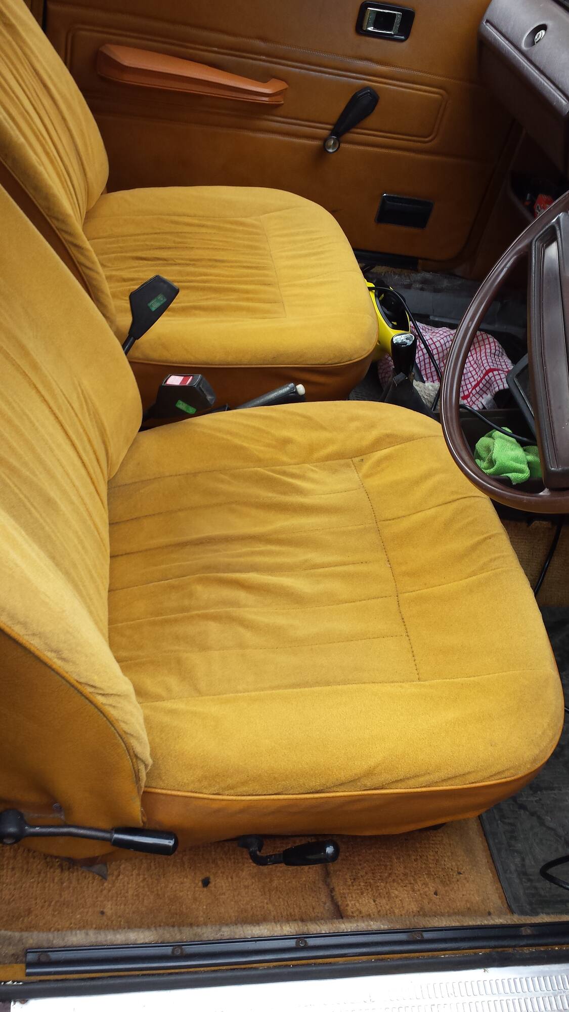

phil_lihp Posted August 28, 2020 Author Posted August 28, 2020 Thank you, kind words indeed, next thing I'll look at is bodywork/paint but that will be a slow burner. Yes the foam is disintegrating on the seats and they're definitely not as good as they should be - is refoaming them a big job? I'd really like velour but aside from the top of the back seat they're in decent condition otherwise so probably better to keep the originality, plus even if I did swap for plusher seats they'd probably be just as knackered inside.
vulgalour Posted August 28, 2020 Posted August 28, 2020 The HL seats are probably the most prone to shedding, the HLS ones seem to fare better. To sort out the foam you have to strip the seats down which is a fairly involved job. It's probably the scrim foam (like a thin sheet of foam) on the back of the fabric that's falling apart, possibly also the structural foam block of the base. The bulk of the work is getting the old covers off and cleaning off the disintegrating foam, actually putting new foam in isn't too bad unless you've got to carve the whole base piece from scratch. Reassembly is also going to be pretty annoying since it requires strength and dexterity to get everything tensioned properly. It's not very autoshite of me, but I'd recommend giving this sort of job to a professional to do purely because of how much hassle it can be. A professional is going to have the experience and tools to do the job well and quickly and then all you need to do is remove and refit the seats, because it's not a full retrim it shouldn't be horrifically expensive, the seat covers do tend to be quite robust. phil_lihp 1
phil_lihp Posted August 28, 2020 Author Posted August 28, 2020 Yeah, back seat top aside the nylon's in good nick. Will look into it but the rest of the interior's shabby enough that I'm not overly concerned for now, it's clean and tidy-ish which suits for now and the seats are acceptably comfortable if not quite as good as they could be.

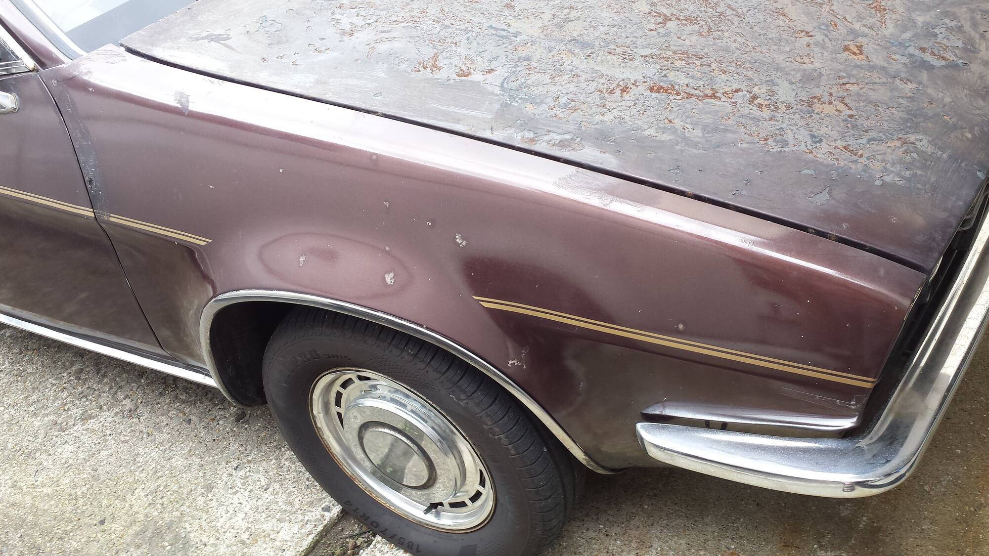

phil_lihp Posted August 29, 2020 Author Posted August 29, 2020 I wasn't intending to do much, if any work on the Princess today but ended up doing quite a lot. Picked it up from the mechanic this morning with its new gear selector mounts installed, so the gear change is back to its recalcitrant norm. Ran a couple of errands, got home, had lunch, decided to have a crack at tidying up what's left of the paint with some wet sanding. I'd bought some 2000 grit wet & dry but never tried it before, guessed I couldn't make it much worse and might get some of the vactan mess off it as well. I did the driver's wing, part of the roof and the very tired bootlid as a test and I'm pretty pleased with the results. Before... After... A corner of the heavily oxidised roof... It's a lot of work to wet sand, wash, dry, T-cut, rub down and wax but worth it - I will eventually get around to the rest of it. The bonnet is beyond all help so I will have to look into getting that resprayed before it starts to dissolve. I then flushed out the manky brown water that's been passing for coolant - I chucked some detergent in here a while back which has hopefully got rid of most of the muck. I stuck a hose in several pipes and kept flushing until the bottom of the radiator ran clear consistently, then refilled with Halford's finest. For some reason I then started mucking about with electrical bits around the interior - with a lot of sanding of corroded contacts, a good splash of contact cleaner and a new LED bulb (it's all I had) the interior light now works. There's no lense on it and I believe they're unobtanium - the light unit itself is quite fragile and crumbly, I reckon though there's probably a way to 3D print stuff like this if you've a printer and a mind to. I then had a look at the non-functioning brake warning light test switch - pulled it out, tested the switch (pass), tested the wiring (fail), repaired a damaged wire, replaced the little bulb in the switch, reassembled, wedged the broken bit of dash facia back into place to get rid of the unsightly hole...fixed. Tested the clock wires - they work fine, the clock is dead but I'm not pulling the dash apart to fix that. The only other thing left now that doesn't work is the fuel gauge which I know is the sender unit - really must fix that, I went out for a drive and it almost died on me in the middle of nowhere, I thought it had plenty of fuel but evidently not. It was kind to me though, we just about made it to a tiny 24/7 Texaco in the middle of nowhere which I've never used before, splashed in some premium unleaded and had no further issues. Loving this car! colino, vulgalour, Shite Ron and 14 others 17

vulgalour Posted August 29, 2020 Posted August 29, 2020 The Princess ones are unique to the Princess, annoyingly, and one of the hardest items to get hold of these days, the plastic they're made of just crumbles away, usually accelerated by the interior light getting too hot. Impressive work on the paint, that's coming up really well. phil_lihp 1
